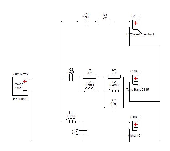

Hi again!
Because I promised, here the final version of the xo.
It´s really simple, but I of course like how it sounds.
R2//L2//C3 lowers the mids in the range of about 700 Hz-1.4kHz, so you can tune your system by simply shorting R2 for example and elevate this range - I will try it too.
Also, you can set the level of the highs with R3, obviously... 😀
So, here it is, feel free to build it 🙂
A short report regarding sound of this new version... As I wrote, I use now completely different parts, after some testing, listening, etc.; I use foil inductors, 20w Mundorf resistors, ClarityCap/Jantzen Super-Z/Mundorf/Audyn caps.
Also, the wiring ist much better and I improved the mechanical stablity too.
This results in my ears in an even better sound, period 🙂 The bass ist tighter but deeper, I really feel it in my chest, the mids are better in terms of separation of the instruments and the highs are just clearer, crisper.
So I recommend to use premium parts, you won't regret it.
Cheers
Istvan

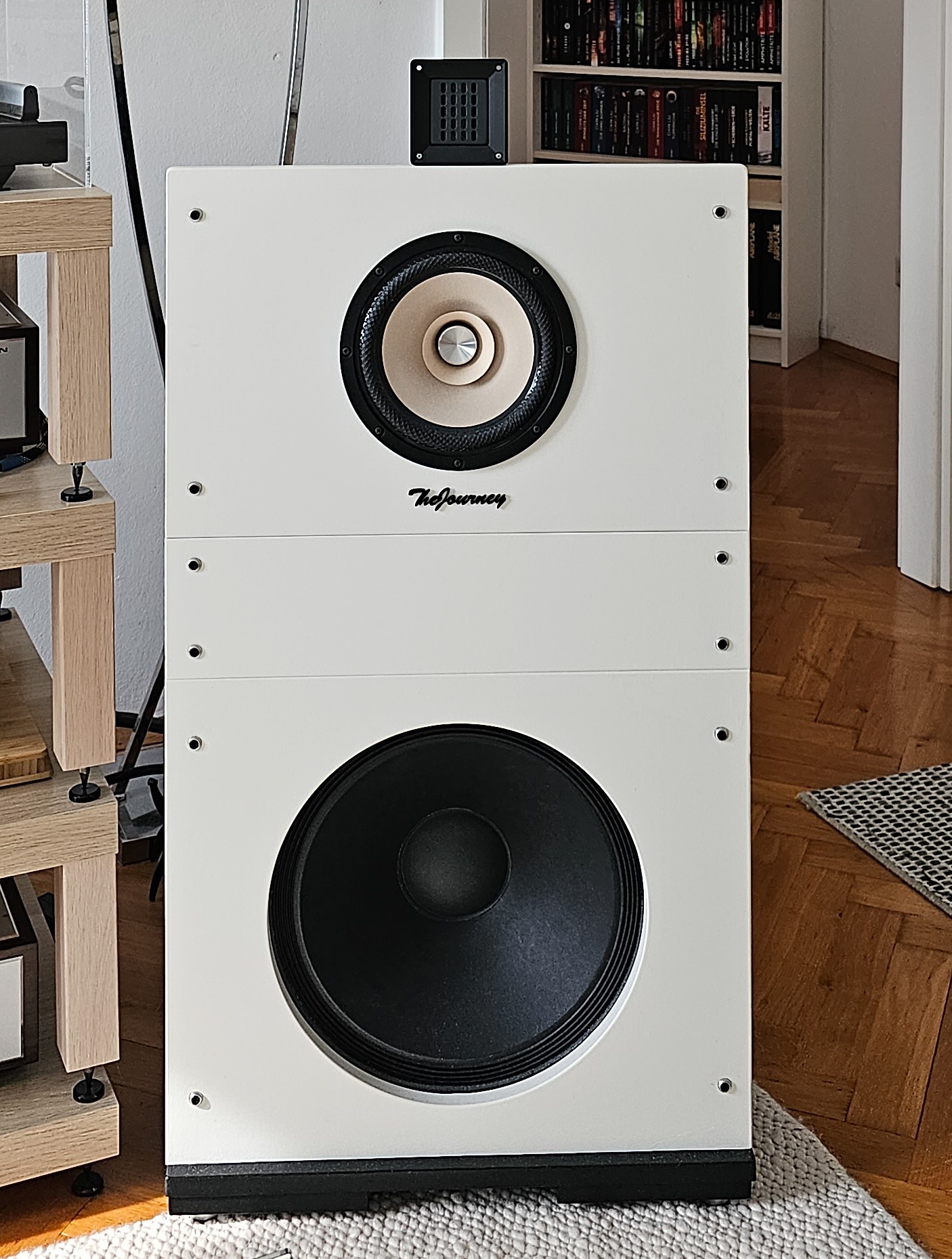

A friend of mine, who also has Magnepans, listened to my speakers and was thrilled by the openness and spaciousness, and that the stage is not only wide and deep, but - like with the Maggies - also high.
Hi Pfarrell,

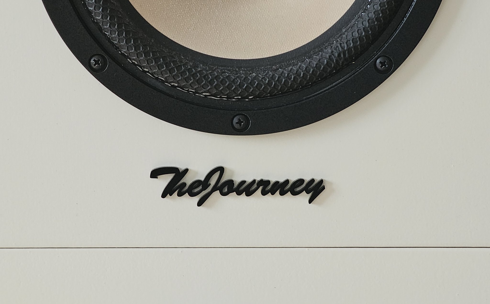

many thanks, I was about to reply, but you already found the pictures 😀
So all that remains is the script, I ordered it from Callie, a company in China. It is acrylic, they have 3-4 colors, and is self-adhesive or with screw fastening, the quality is surprisingly high.
This weekend I will share the dimensions of the baffle too.

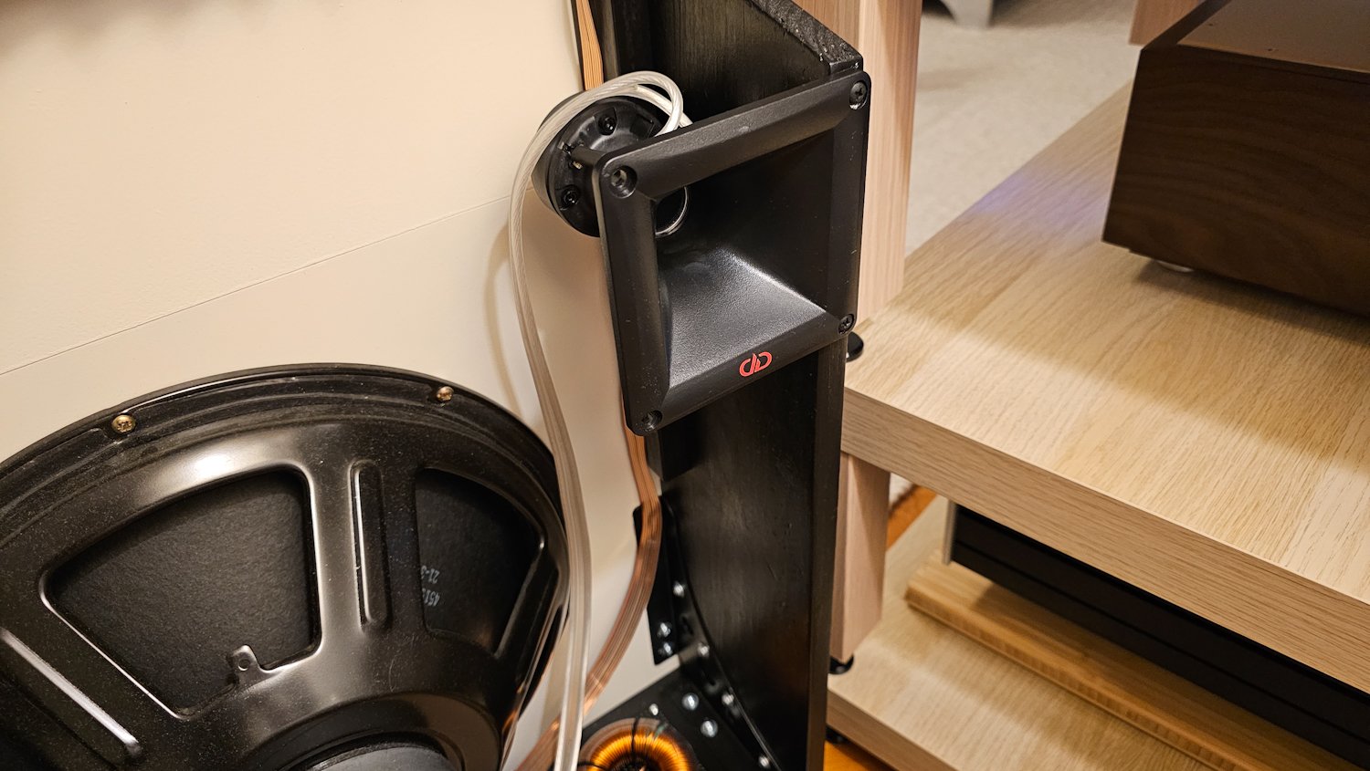

Hi again!
The thing is... even a finished speaker is never finished
I thought I could try to use backward-firing ambience tweeters. I experimented a bit and went back to previous trials and errors, and now installed a Dayton Pro 8 in horn, crossed at around 7 kHz. The effect is great. Wider stage (starts to the left of the left speaker and ends to the right of the right one), nicer staggering of the instruments, more feeling of space, a little shine without sharpness, voices are clearer, and the sound is more stable. I didn't expect this effect and I'm very satisfied.
