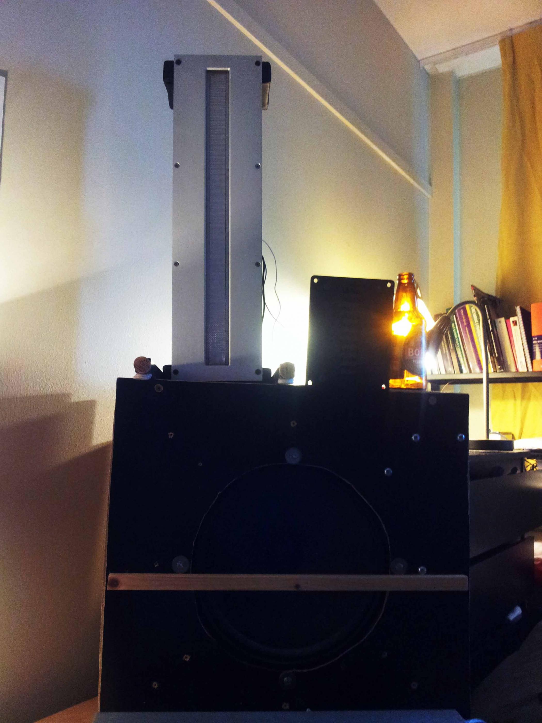

There's no tweeter, the B&G RD75 goes all the way up.
We will see about this. 🙂 Want to try to integrate the 50cm/1" Transmission audio ribbon tweeter soon?
Where did you buy the Transmission Audio ribbon tweeter. It may be an option to the RD75.
I got lucky in England. A PA guy crushed his giant setup for a show - magnets attracts! - and then he gave up when he realized they don't do well with wind. I bought what he could salvage, and he lashed the rest. "Learning experience", he called it.
Prepare to spend 20 000 SEK for a pair, if Bo Bengtsson can be arsed to make them. He is quite the rough customer. 😛
The PA guy in England had problems with delivery times, I recall.
I don't see how he could have used them for PA anyway. ~90db 1W? They are so fragile and unsensensitive compared to the TPL-150. I would not want to pump 200W straight into true ribbons.
I bet you can get the same thing from RAAL. The principle behind true ribbons is fairly simple. I think the hard part is to make a good ribbon speaker transformer. RAAL's very sensitive (109dB?) seem exciting, but somehow it feels unnatural to push so high sensitivity from a true ribbon. Not sure how it works at all, though.
I tried with home made graphite resistors to make them transformerless. It was hard to get any significant volume with a 40W solid state amp. Tried 4 ohm, and 1ohm. 4 ohm was like whispering at 40W. 1ohm was speaking volume at 40W. The Dueland resistor that should be the same thing, is said to take only 15W. I wonder how the ribbon reacts to exploding pencil resistors!
My impression with the Transmission Audio drivers are that they sound really good. With resistors instead of transformers even better, but so quiet! They are much more detailed than the TPL-150, which make me want to replace the TPL-150 with them, but alas!, they don't go as low. They sound strained if you go too low, so I would just keep them where they are comfortable. Don't ask me where that is yet, because I am just about to setup the Minidsp 4x10HD for the first time.

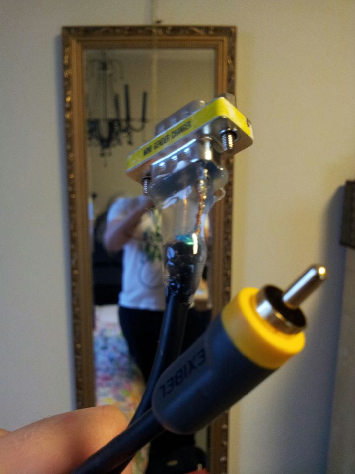

In other news - I just soldered myself my very own SPDIF breakout cable for the Lynx L22 to connect to the Minidsp. *busy*
