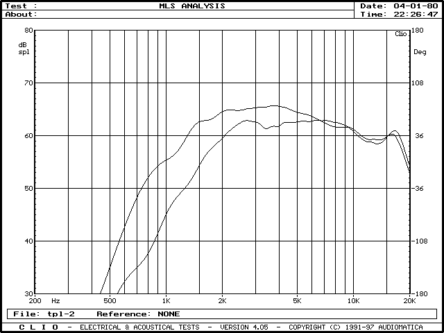

I have a pair of questions about the TPL150.
If its used with a 12" down to 1000-1200hz and a sensitivity below 95db/1w are needed. are there any reason to use the H version?
Are the Aluminium version of the horn still aviable or are the plastic horn the only option?
There are three main reasons to use the H version
1. More LF extension
2. More controlled diretivity
3. Better efficiency
See the measurement below comparing the 150 with the 150H, both measured with no baffle. With a baffle, both of them will get more LF extension, but anyway you see the relative difference.
There is as far as I know only one TPL150H version, and the horn is aluminum. You can't buy the horn as a separate product either.
