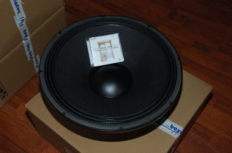

Time is the main problem now... and the 21" Beyma woofers have not yet arrived. I've redesigned it a little bit to avoid too many weird angles, making it easier to assemble. The MDF boards are sitting in my garage right now!! Hopefully my and my buddy Lars will have time to work in the project again next week.

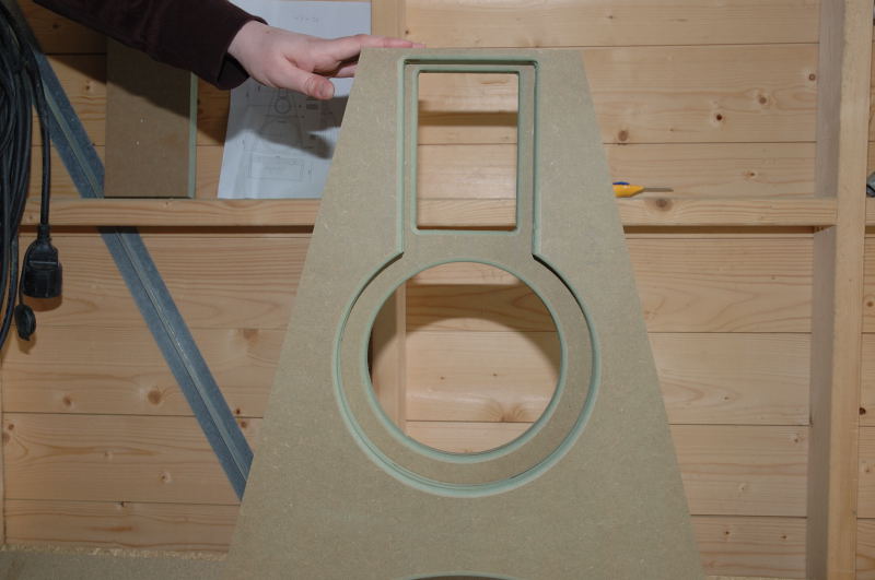

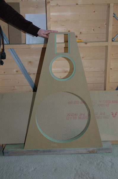

Finally! I've had time this weekend to work on the second prototypes. The driver cutouts differ at bit from the drawings I've presented, partly because they would be too much work...
Here are some photos of the baffle plates. More will follow when its all assembled!
