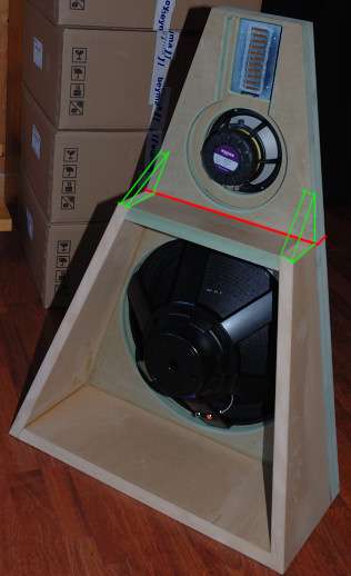

Updates:
The baffle we build works great for the woofer and tweeter. The mid however, does not have a very good on-axis frequency response and the extension below 300 Hz could be better. We did have better measured performance on our previous prototype. The main difference was that we had "wings" for the midrange as well.
An other thing is that the baffle still vibrates too much, and its the lower midrange thats the problem now. We are going to try this:
1. Add "wings" around the midrange, this will stiffen the baffle.
2. Add damping - heavy bitumen (asphalt) damping sheets.
3. If this is not enough - mount the driver without contact with the baffle, like Linkwitz did in Orion+.
Regarding point 3.... Linkwitz mounted the midrange driver on a bracket attached to the magnet, with the driver not having direct contact with the baffle. This will still transfer vibrations through the bracket, although not directly to the baffle.
We would like to go a bit further. We are thinking of using foam seal around the driver, just like Orion+. The "new" idea is to suspend the drivers rear side with rubber bands or maybe steel springs to avoid any vibration transfer. Anyone tried something like this before?

We tried out one thing here. We attached small rubber pads to the driver frame (the rear side..), and held the driver in place by hand. Almost all vibration in the baffle disappeared, so its quite obvious that isolating the driver from the baffle has a dramatic effect.
We then fastened the driver loosely with two screws. The effect was gone, vibration was transfered through the screws.
Isolating the driver frame from the baffle is simple - just use rubber or foam seal. The problem is how to hold the driver in place without transfering too much energy.
The best solution would be to suspend the entire driver. How to do this is the challenge here, so any ideas are appreciated.

I would try to make two completely seperate cabinets. One for the 21" and one for the rest. Then make a cool steel stand for the mid/high box.
Naim, in some models, mount the mid and tweeter on separate sub-baffles, and then de-couple these from the box with radially arranged leaf springs. Low resonant freq of only a few Hz.
David
David
Lindells proposition looks very elegant. Before going to such expense, you could try to divide the main baffle along the red line (same as Lindell does) and mount it again with the green triangles. The joint between the H frame sides should be really vibration free.
If you feel any vibration at that point, it probably is due to the whole construction rocking back and forth. Did you recognise that you don't prop up the baffle against forward movement at all?

That will not solve the problem, the midrange will still make the baffle vibrate.
The bass is not the problem here. I have strong vibrations in the upper part of the baffle even with the bass driver turned off.

Not nearly comparable to the vibration of a woofer, esp a 21" one.
Maybe you can try with a second layer of wood/mdf?
Here's what I will try - just let the woofer H-frame wings continue all the way up. It should add some stiffness. Next is to add damping to the rear side of the baffle.
This will only *reduce* the problem, not remove it...
I've had success with the brute-force method in sealed boxes - a lot of bracing and a lot of sand for damping and mass. Sadly, thats not so easy to do here. The baffle is already two layers of 30 mm MDF.
