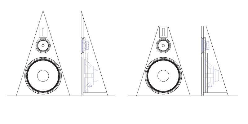

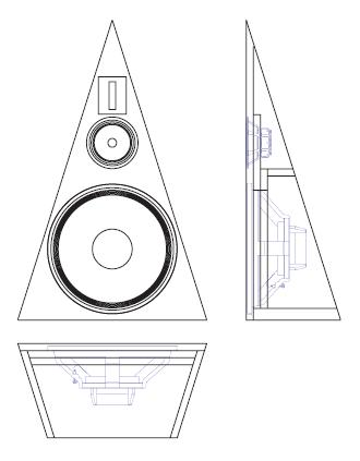

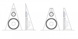

Ok people, we want some help with the looks of this thing! The main problem is that the 21" woofer is big... very big. The speaker need to be wide, as the bottom at least.
We have made a simple drawing of two possible solutions. Its important for us to keep the design relatively simple to manufacture, thats why there are no fancy shapes.
Please let me know what you think, and any suggestions are welcome!

The magicians hat is my favorit too.
WRT the right proposal: Inevitably someones wife will ask for a top plate to put some plants on.
Hi StigErik,
I think the design looks great!
I have another suggestion, though: I understand that you like to Seas W22 a lot, but it has by far the lowest sensitivity of the drivers chosen. Have you thought about a more efficient mid-driver or maybe to use two drivers? Just a thought...
Best regards
Peter
Best regards
Peter

I like your trapezoid (with plant pot option...!) but I can see how the "full pointy hat" triangle will have some sonic benefit. It would be very interesting to compare the two baffle shapes if you can be bothered to build two pairs and do all the driver swaps and measurements... please!
I definitely recommend asymmetry wherever possible. Symmetry is the beautiful enemy!
Any open baffle system I have experimented with always benefits sonically from asymmetry.
The "Variable Path Length" (VPL) cancellation really helps a lot between 100Hz and 400Hz. It reduces the peaks due to the U frame or H frame dimensional step.
Your angular sides will have a similar effect, the VPL just allows you to have deeper sides therefore more low frequency or low mid range reinforcement without the penalty of the "cuppy" lower mids and boomy bass you get from straight sided deep U or H sides.

StigErik said:What about this design?
I f you do kind of U frame bass you might have to cross too low for your mid.

StigErik,
there are two different (or almost contrary) roads you can go in dipole design. The easy road is wide baffles and/or wings, which keeps efficiency up and the power demand on drivers low. What you sacrifice that way (not only due to the need to place drivers off axis on wide baffles) is a constant and symmetric dipole radiation pattern.
The alternative road is along the findings of people like Linkwitz and Kreskovsky, who try to keep every drivers working range below (or at least not much higher than) the first dipole peak of the baffle area where the driver is mounted.
Your triangular baffle would be perfect for the second approach, but wings must be limited to the woofer area. Midrange driver and tweeter should see a plain baffle only. John Kreskovsy has given some information in his Dipoles and Open Baffle Design considerations. By following his (and SLs) rules you can achieve an almost constant horizontal directivity pattern from bass up to the TPL 150. The price you have to pay is the need to equalize the 6 db/oct dipole loss and the adjacent dipole peak for every driver on the baffle.
It would help if you could explain the design goals and limitations behind your dipole project WRT these alternative roads.
Rudolf
Rudolf
Rudolf, what we want is something that will offer a good figure-8 polar response over as wide a frequency range as possible, thus reducing lateral room reflections and improving room bass response. Any amount of equalization is not a problem, since we will use DSP for this project.
