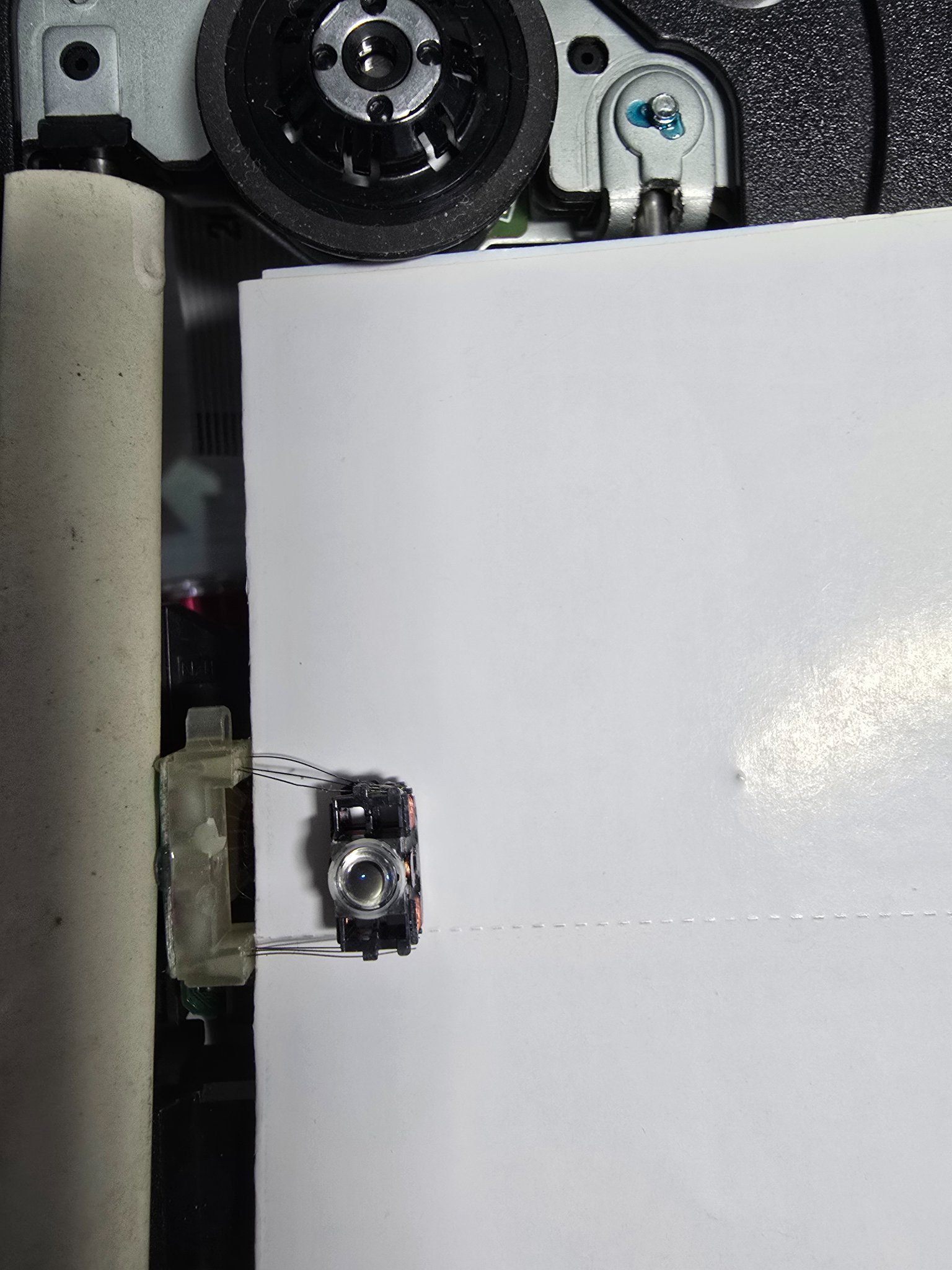

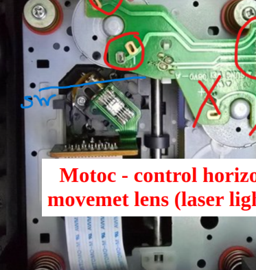

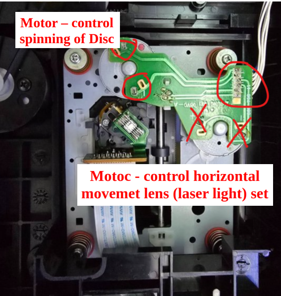

Now the Lens/Laser light can move up and down. Still no red light is found.
I have dismantled an old computer CD burner/writer, including its lens. Please see attached screenshot. I connect the 9V battery to its leads but there is no red light found. Is it not the correct way checking it? OR this lens is also defective?
You can't do that... it could lead to instant zapping of the laser diode. The current through the laser diode is very tightly controlled. The laser diode is also highly susceptible to static damage if handled incorrectly.
I think we are outside your comfort zone with this one tbh 🙂
Reactions: weissi
OK 🙂
If the lens is moving up and down to try and focus then do check carefully for laser light. It is a very very dull red and only a pinprick spot, its nothing like you see on a camera shot which 'sees' much more of the infra red than we do.

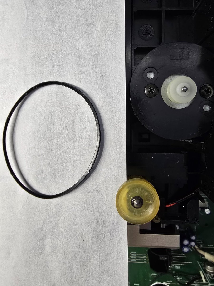

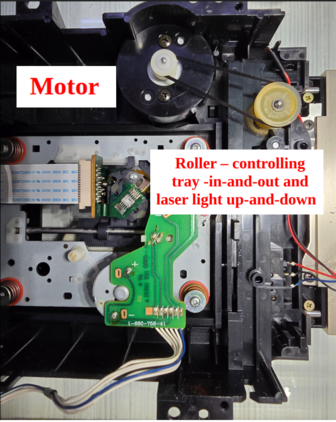

Hi Mooly,
Pls see attached screenshots
The rubber band connecting the roller and motor lost elasticity. That is why the tray didn't moving in-and-out and the laser light set not moving up-and-down.
I'll see whether I can find its replacement on computer components shop
