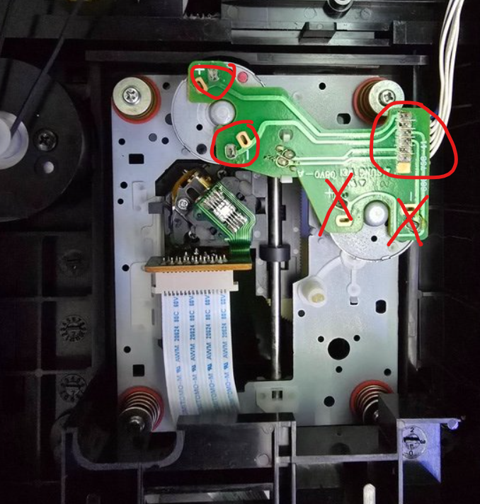

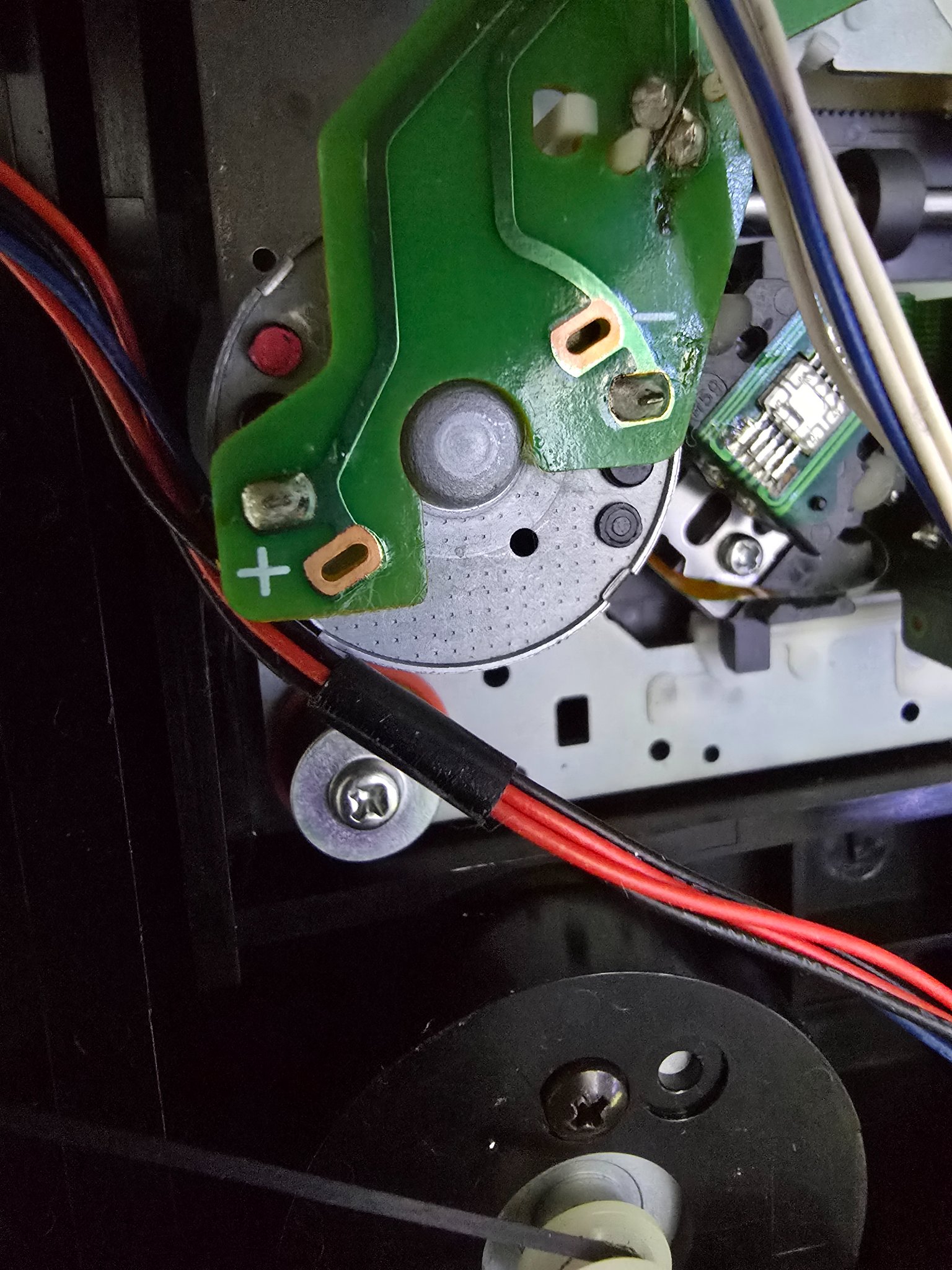

I have checked thoroughly on the CD Player device but couldn't find the motor connectors. I suppose the motor is soldered to the printed circuit board. Please refers to the screenshot attached.
I found the '+' and '-' holes. I suppose they are connected to the motor. Can I try them with a 9V battery. I'll purchase a 9V batter for testing.
Please advise. Thanks in advance.

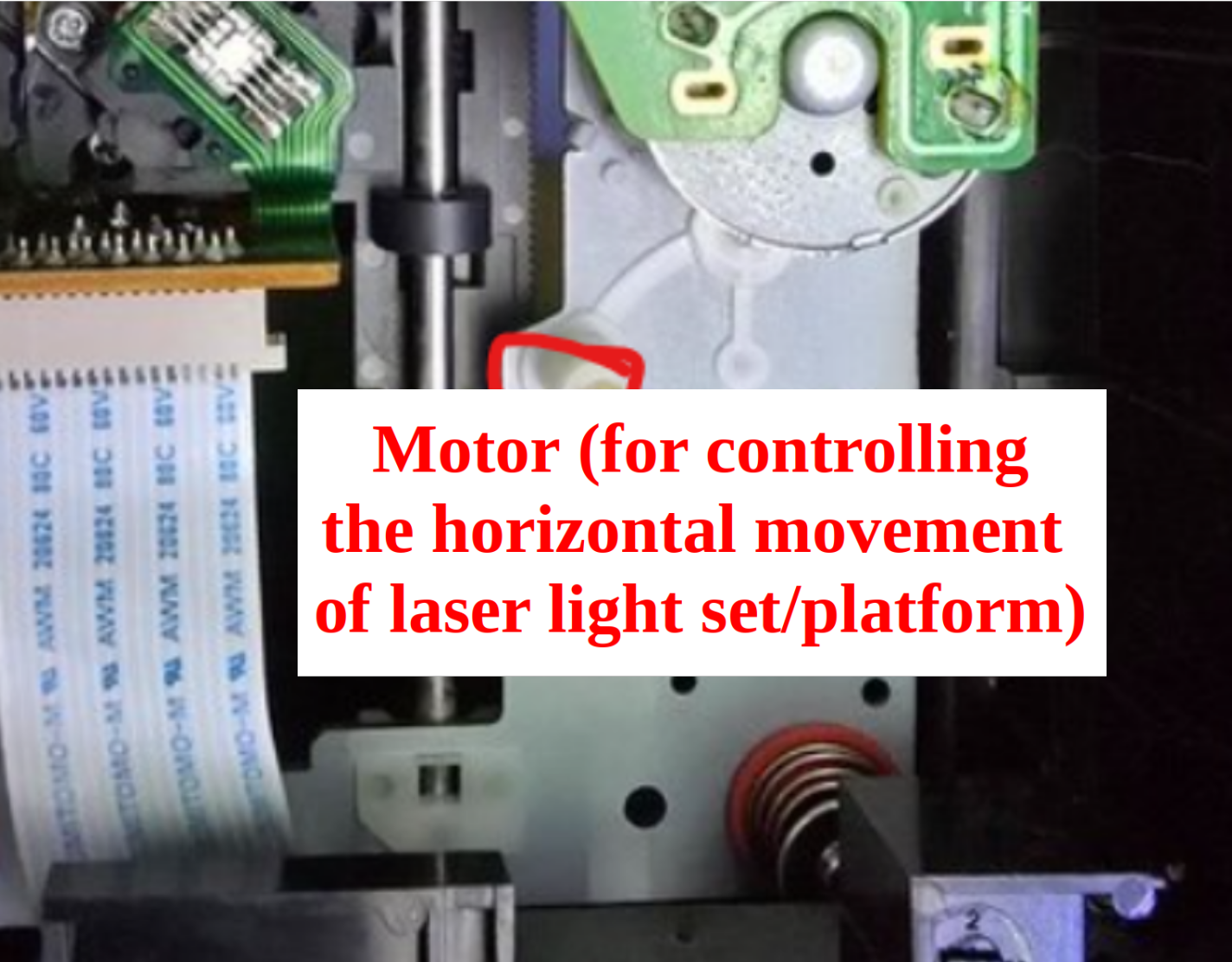

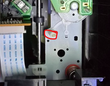

The laser pickup type in your pictures looks like a common KSS variant (the exact type should be on the label on the pickup). Changing the pickup is only a few minutes work but it must be the correct type... and all that assumes the pickup is defective in the first place.
You can often remove them with little to no dismantling. Push this plastic retainer over and slide the metal rod forward to fee it at the other end. Then lift and pull the rod out carefully and the pickup is free. That large white plastic gear is removed by squeezing the plastic clips underneath and just pulling it out.

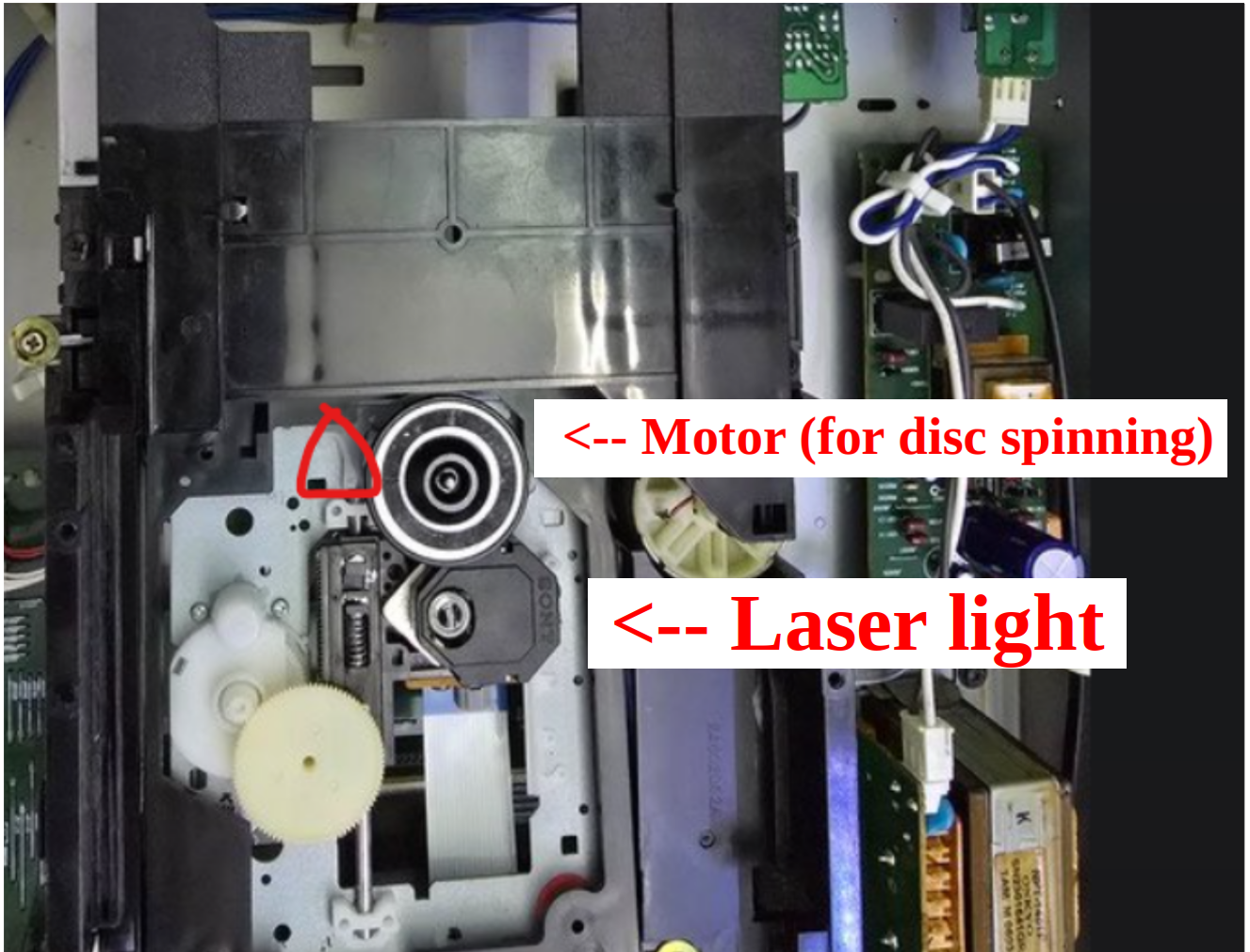

Hi Mooly,
Please see attached screenshots.
I won't take any action before checking the motor for disc spinning with battery. The motor controlling horizontal movement of the laser light set is working.
Any method checking the laser light?

The only easy check on the laser is to see if there is light during those 2 or 3 initial up/down movements of the lens as it performs a focus search routine to see if a disc is present. So keep onpening and closing the tray and see if you can see it lit. It is a very dull red and very dim because most of the energy is in the infra red end of the spectrum. Don't look to closely (30cm or more) and look at it slightly off axis.
Hi Mooly,
I used a mobile phone recording video of the laser light. Kept moving the disc tray in-and-out and pressing the start-key on the remote control simultaneously. But there is no red light recorded on mobile phone. Is it he problem of the laser light?. Also it is not moving up and down, only staying stationary there.
Regard
When you close the drawer with no CD in place the pickup should be in the innermost rest position and the lens should move up and down (usually three times) as it performs a 'Focus Search' to see if a disc is present. This is the only time you see the laser light without a disc in place.
The lens (laser light) does not move up and down. Previsouly the lens move up and down. That is what I'm trying hard to find out the problem.
