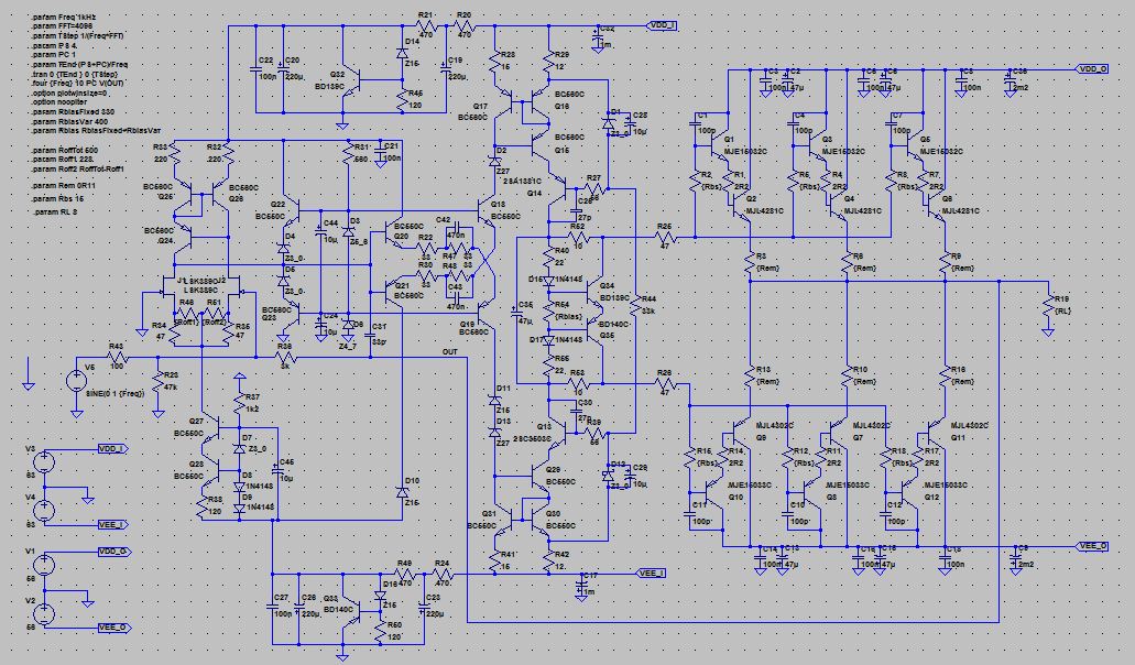

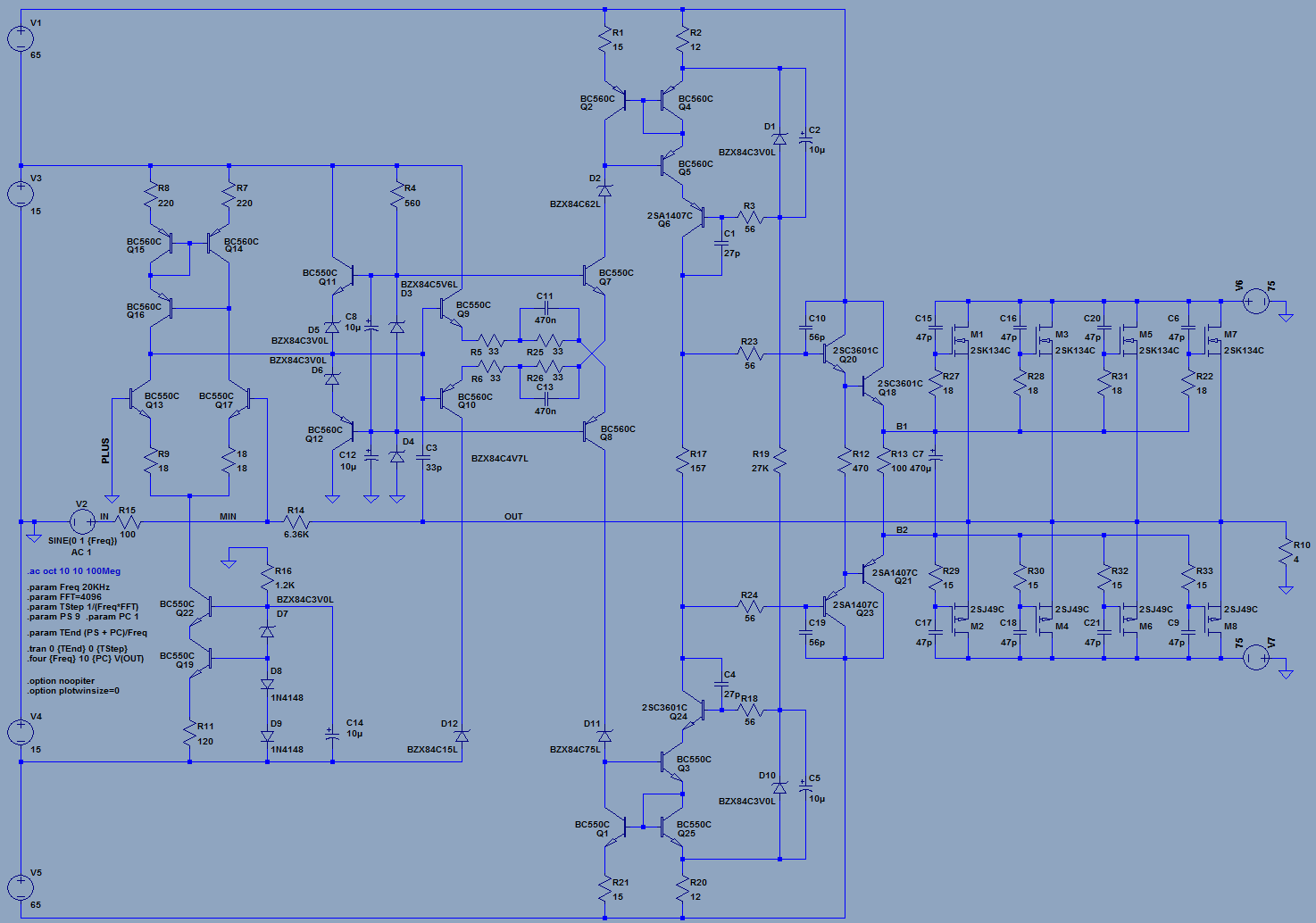

These are really impressive numbers that you are achieving! We really need to see a loop-gain plot!
See here for a good guide:
https://sites.google.com/site/frankwiedmann/loopgain
Simpler tasks (apologies if some of these don't make sense from a circuit operation, as opposed to optimisation, point of view; I have not had a chance to study your circuit or description of operation):
Referring to the component references from the schematic in post #79:
What happens to the THD numbers if you: remove Q16? If you change the Q19/Q22 current source to a two-transistor negative-feedback current source?
Both of these changes reduce component count so I'm interested to see what differences they make.
Also R7 and R8 look very small. Noise performance improves if these are larger. Can they be made larger (e.g. up to 330R) without upsetting circuit operation?

Hi Harry,
Thanks for commenting 🙂 I've tried a few of your suggestions. Removing Q16 worsened THD by only 0.000005%. I also tried with an input cascode in the past but that didn't seem to bring improvement so I left it out. R7 and R8 could be increased without impact; no change to THD. I haven't tried yet a different CCS though.
Meanwhile I made a scaled up version that does 250/8, 500/4.
Here's the THD for a 500W 20K sine 😀

The schematic uses 4 output pairs (though these really need to be 200V types) and a double buffer.
I read the link on loop gain and noticed that LTspice comes with an example too. I'll look at it and apply it to my circuit and see what it comes up with 🙂
As for those drivers, that's really a bummer they're no longer made. I'll see if I can find models for the ones you suggested.

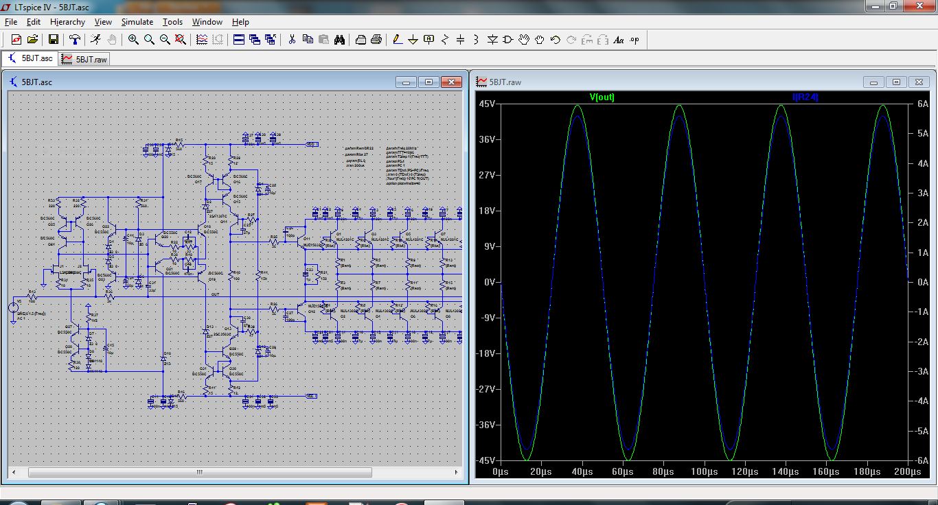

I'm VERY (period) unexperienced using LTspice, so probably I did not do everything in the right way. Anyway, I changed the input trannies to be my favourite Dual JFET, adjusted R7/8 and built an OPS based on a massive load of OnSemi's (again massive) BJTs and increased the rails a little (in a real world design I'd probably go for a shuntie for VAS and also the +-15V would get a more clever reg 😉).
From what I was able to sim the 20k output looks real good, though I dunno how to measure THD etc. I attached a plot as well as the asc, just in case someone would like to play or comment.
5BJT_20kHz.JPGView attachment 5BJT.asc
Next step I'd like to try is to reduce BJT count to 3 (should still be stable on 4R loads) and to introduce distributed drivers, something I really love to play with.

It looks like you included the parameters and directives too so the THD is already measured for you on each .tran run. Just hit CTRL+L to view the error log, that's where the THD results are written to.
It's fun trying different output stages and power levels; now we have base THD values with an ideal OPS, it becomes fairly easy to see differences.
Meanwhile I'm trying to get the loop gain. I have to duplicate the circuit for that hah.
I see you have two .tran directives, one from my schematic and a separate one. You'll have to uncomment or delete the one on the left. A THD output is added only when you do a transient analysis, not an ac analysis.

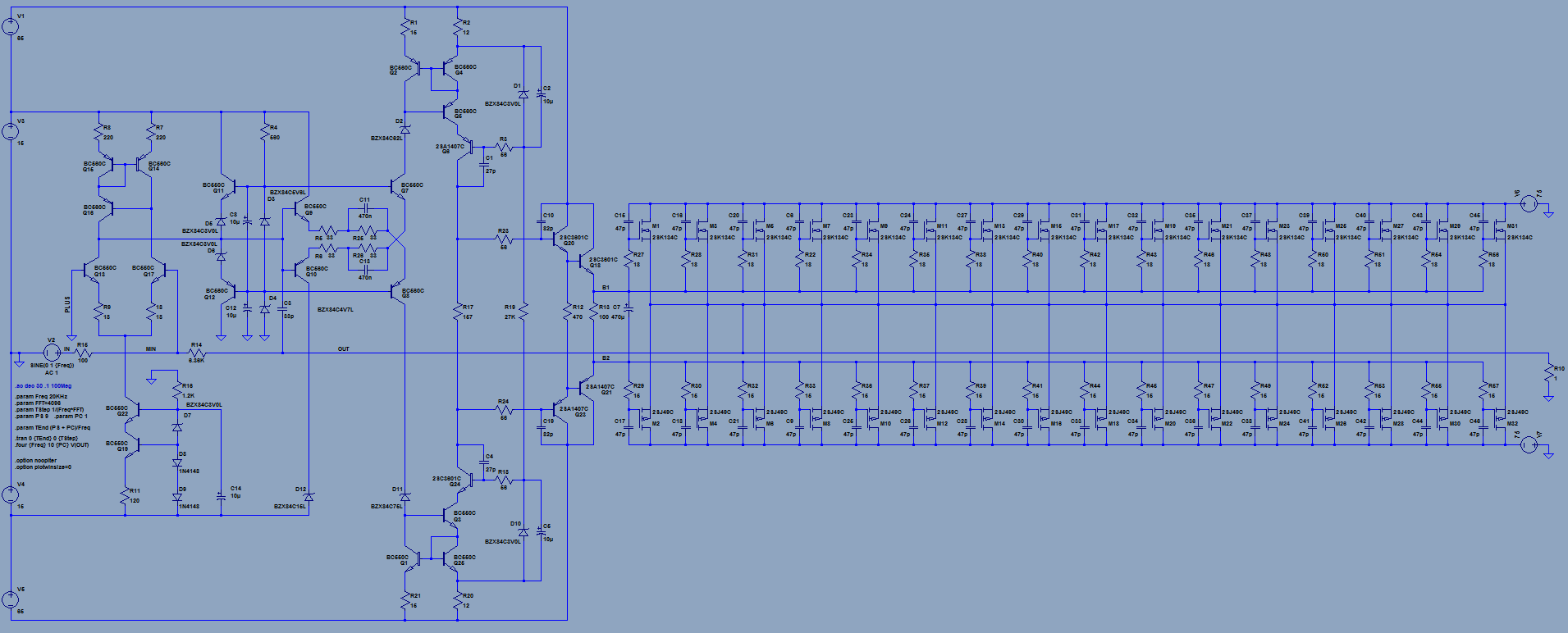

Meanwhile I thought: Let's get crazy and load up that VAS already. So here the previous schematic with the quadruple amount of output devices for a 2000W into 1 ohms. I had to slow down the buffer slightly to make it stable again. It's still sub-ppm. Don't laugh at the rows of trannies 😛

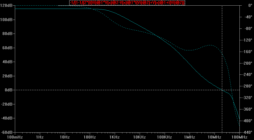

Sorry guys, I'm still struggling a little with LTspice. I've now implemented example LoopGain2.asc and added the function to my plot.defs file.
But the question is, how do I plot it? Do I use the function name in the 'Add Trace' dialog?

On your loop gain plots, please could you turn off phase unwrapping? If you do this, there will be a discontinuity in the phase plot at ±180 degrees, making it easier to see phase and gain margins.
Talking of which, yours are scarily low. You need to make the unity loop gain frequency lower in order to increase your margins.
Now that you can do the loop gain plot, you can try doing it at different operating points. For example, you can try different DC operating points by AC-coupling the load with a large capacitor (e.g. 1 kF) and then adding some DC bias to the input signal. This will adjust the DC-voltage operating points of the circuit without also increasing the output current. You can also test at different current levels by adding an ideal current source from the output to ground.

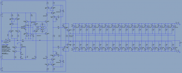

I also played around a little. Modifications:
  • 3 BJT pairs with distributed drivers
  • Simple regulators for +-15V input stage supply (+-68V for VAS to be powered by good low-noise reg)
  • Offset and Bias adjust added
Very nice A - AB transition behaviour and very stable (though 2R loads would need more OP pairs).
Will play a little more with various level/freq sims tomorrow and also start a PCB layout if and when everything looks fine 😀

Meanwhile I've tried to improve the gain and phase margin, but the only way I can succeed in that is by increasing the IPS emitter degens. This makes the OLG drop and THD increase severely. I wonder if I can remove the phase dip around 1MHz in a different manner.

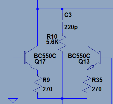

Here a new OLG plot. I've been able to create around 60 degrees phase margin, a gain of 40 degrees compared to the OLG plot atop this page 🙂 Unfortunately I had to sacrifice THD for it.
The changes were an increase of the LTP degens a big deal, and a snubber network.
