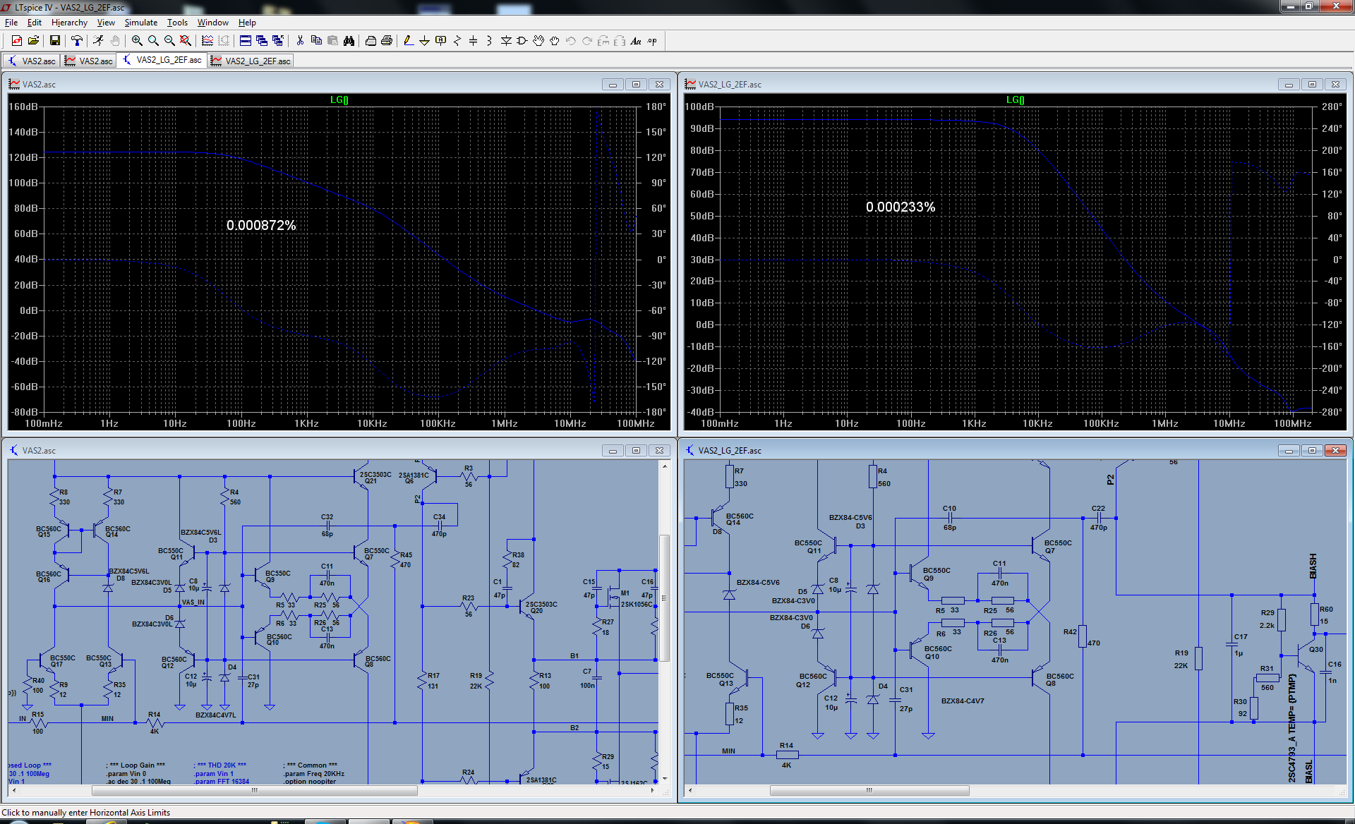

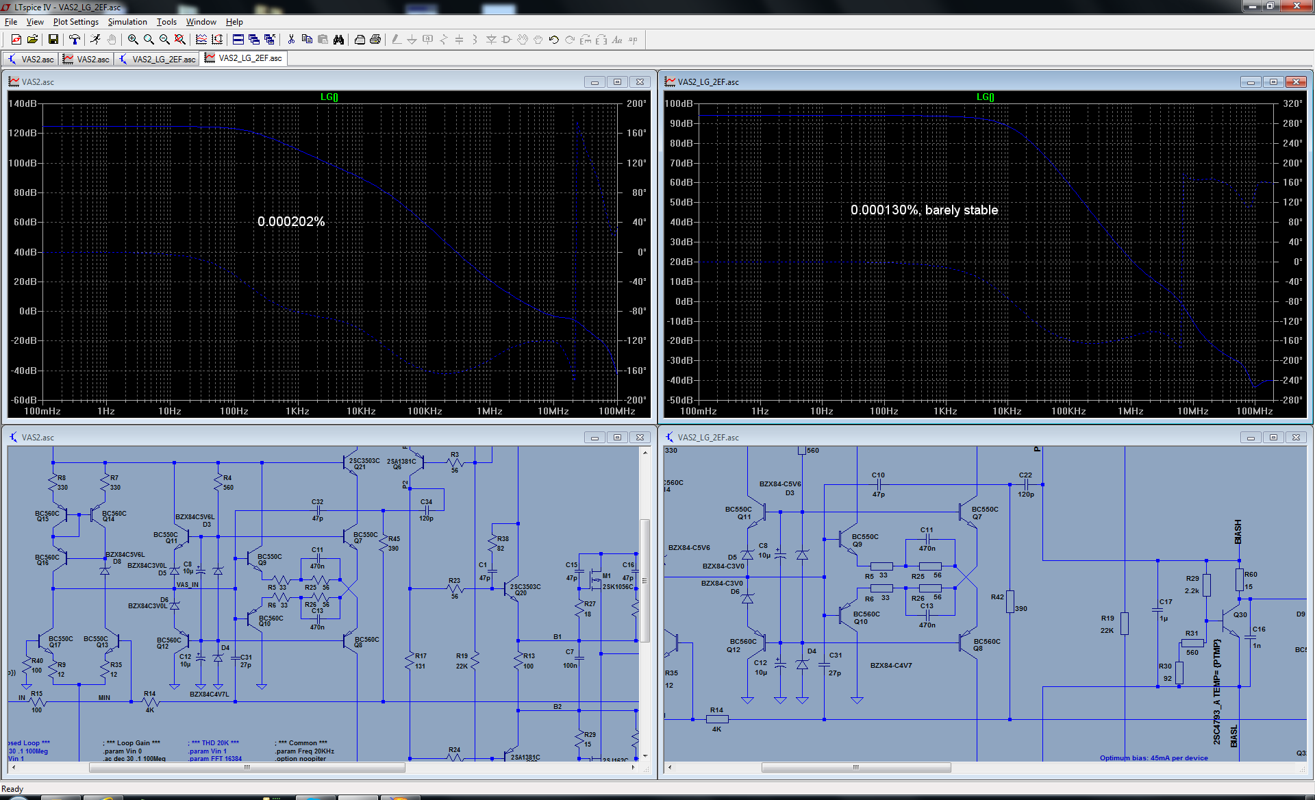

Well, I can now present 3 graphs that show a direct comparisson between the two output stages I've been focussing on. These are the standard buffered MOSFET output, and astx' 2EF BJT output.
As a starting point I took the schematic with the compensation and THD astx posted here.
The images show on the left, the MOS stage loopgain and compensation network, and on the right, the 2EF loopgain and compensation network.
With all comparisson and optimization attempts I had one simple rule: Get the phase margin at or above 60 degrees, as astx' version starts out with.
The first image shows the TMC network with values optimized for the 2EF. It shows a nice 0.000233% THD. When these values are used for the MOSFET output, you'll see that THD is much worse. However, when you look at the phase margin, it's clear these values are an over-compensation for this output stage and as such, sub optimal.
The second image shows the same TMC network, now with values optimized for the MOSFET stage. 0.000202% THD while a phase margin of 60 degrees is met. These values put in the 2EF version show a barely, if stable at all response. 60 degrees is no longer met.
This goes to show that with the same network, when optimized for the specific output stage, the THD figures are in the same ballpark.
When you compare the gain slopes, you'll see that the phase turning for the MOSFET stage sets in at a higher frequencies, with a zero showing up in the ULGF region unlike with the BJT output stage, further extending phase margin.

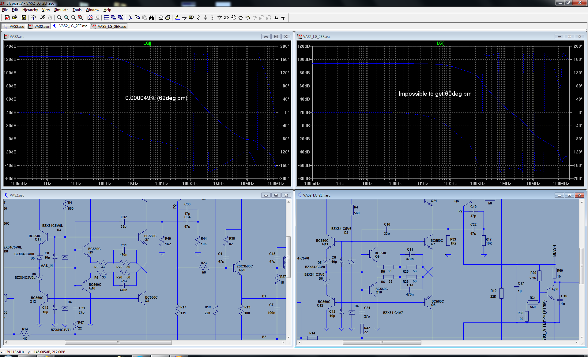

Now I went to apply the compensation I developed last, where I reverted back to the combination of Cherry with TPC, though with a T-filter instead. This compensation network is shown in the final, third picture. It pushes up available gain considerably, after setting in with a sharp decline past 100KHz. Due to less phase shift, I was able to meet a 62 degrees phase margin with this compensation. The 2EF seemingly lacking an inherent zero can't cope with this type of compensation. I tried many ranges of values, moving poles back and forth to no avail.
I think the third page shows, that at least, in this case, a higher bandwidth can be achieved with the MOS output stage. And as a result, yields better THD.
Another conclusion one can draw is that the OPS has a significant impact on the effectiveness of the compensation network used. Whether to use TMC or TPC and variants isn't always clear-cut and should be empirically figured out. But, that's probably not a surprise.
As it stands now, I'll go for the MOS output stage. Maybe more so because I still have 16 pcs of ECX10N/P20 laying about here 🙂 I think this will be a nice basis for a prototype amp. I think an actual schematic and a PCB are up next 😎

It would seem that you have been focusing solely on phase margin. Only one of the circuits you present has a decent gain margin.
Hi Harry;
The lower gain margin is inherent to the buffered MOS output. Only when overcompensated severely, gainmargin could be made do be 12dB+.
Still, the minimum margin is around 8dB. I thought 6dB was the minimum.

The circuit with 0.000049% THD has 8 dB margin? It looks like less than that to me?

Edit: with a bit of stretching the gain margin at cost of some THD I now ended up with 0.000097%. Still not bad.
