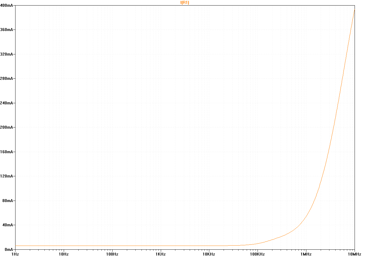

If he injects the error current source into point A no much difference, result swamped by speaker wire. But when injecting into point B the wiring of the preamp GND determines whether the voltage drop induced by this current is inside (green) or outside (red) the feedback loop.

I think that what you are measuring is the injected current that is flowing through R1 (load) and into the output of the LM3886.
No, that's not the case. Have a look at the attached plot, it shows the current through R1. This current comes out of the LM. Maybe you can try it for yourself, attached the sim file, too.
While this current path does exist, its impedance is several orders of magnitude higher than the main path, so it's contribution to the voltage drop accross the load is neglegible. The voltage drop along the main path is important is it is an input signal not corrected by feedback. The amp operates in inverting mode for this error signal.I think that what you are measuring is the injected current that is flowing through R1 (load) and into the output of the LM3886.
Thanks for the file.
The injected current is negative and that is why you see a positive output current.
I measure 6.3 mA through R1 leaving 993.7 mA through the ground return.
This is close to what you might expect from paralleled 8.05 and 0.05 Ohm network.
