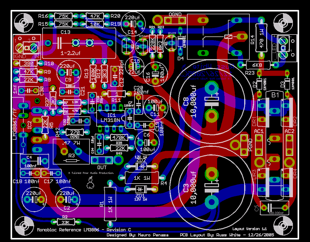

My new monobloc layout for Mauro Penasa's MyRef Rev. C
Its been a while now since I first laid out a PCB for Mauro's "My Reference" revision C. The first layout was largely a product of taking Mauro's suggestions for a monobloc version and running various iterations past the forum to get as much input as possible.
Well since then literally hundreds of people (maybe more I do not know) have built or are building MyRef. This has given me even more feedback about the layout and spawned some new ideas. Also Mauro has given some guidence on how to make the circuit, and the layout a little better. I have taken this new experience and applied it to a new layout. Here it is for your pleasure.
Major changes:
1) More flexible input and led interfaces allow for terminal blocks, pinheaders, IDC connectors, etc..
2) Bigger more flexible cap space to allow for MKP cap on input.
3) Allowance on power supply for monoluthic rectifier (as in the original) or TO220 types such as MUR860.
4) Additonal output solder holes for direct soldering of large gage wire to the PCB for OUT and OUT-GND.
You can still build the circuit exactly as before, or take advantage of the new features, its your choice. You can also still build the circuit as "Rev A" without much fuss.
Also, the layout has been changed to eliminate as much as possible any sharp angles in the traces. This may not do anything, but I like it better. :) Also many traces are widened, and some little things like silkscreen changes have also been made.
Only circuit features which adhere to the circuit designer's philosophy and intent have been included in the layout, and nothing else ever will be included by me as the circuit is in my opinion, simply put, often imitated, never surpassed. :)
Thanks to Mauro for a design which will forever change the way we look at chip amps.
Note: This is the 2 side version which Brian and I have produced, but I am working on a single side version which I will make PDFs for and share freely so those who would like to etch it for yourselves can.
Here it is:
Cheers!
Russ

Hi Russ,
to be flexible with 4 Ohm and 8 Ohm loudspeakers I want to use an 2x18 Volt or 2x20 Volt transformer with the RefCKit. Do I have to change something in the layout due to the limited voltage?
Maybe an improvement for next layouts:
In my opinion wire wound resistors in signal path are not the best choice. There are a lot high quality (Manganin etc.) resistors on the market which have TO247 packages. You should bring the resistor mounting holes to the front of the PCB so that mounting of TO247 resistor directly on the heatsink will be possible.
Arne
The circuit has been tested very thoroughly with a single sided version and the previous production PCBs, but since these are two sided PCBs(which I do not like to etch myself) I will not have the oportunity to build a production version until the PCBs get here. :)
The new PCB is not a large change from the original, so there should be no issues. But the first thing I do when I get in a set of PCBs is electrically check them and then build one up quickly to be sure they are OK.
Cheers!
Russ
