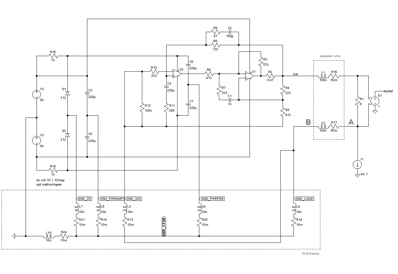

Here's one more thing I stumbled upon with the simulation. Please have a look at the schematic.
I've included the parasitic resistance and inductance of some idealized PCB tracks, the absolute values are not that important. I've also included a run of the inevitable speaker wire. The big quesion is: Where do I put the stimulus? If I put it "on the PCB", so to say (point "B"), I get pretty much the same results that Tom got. Layout makes a huge difference here, see the red and green traces "B" for comparison.

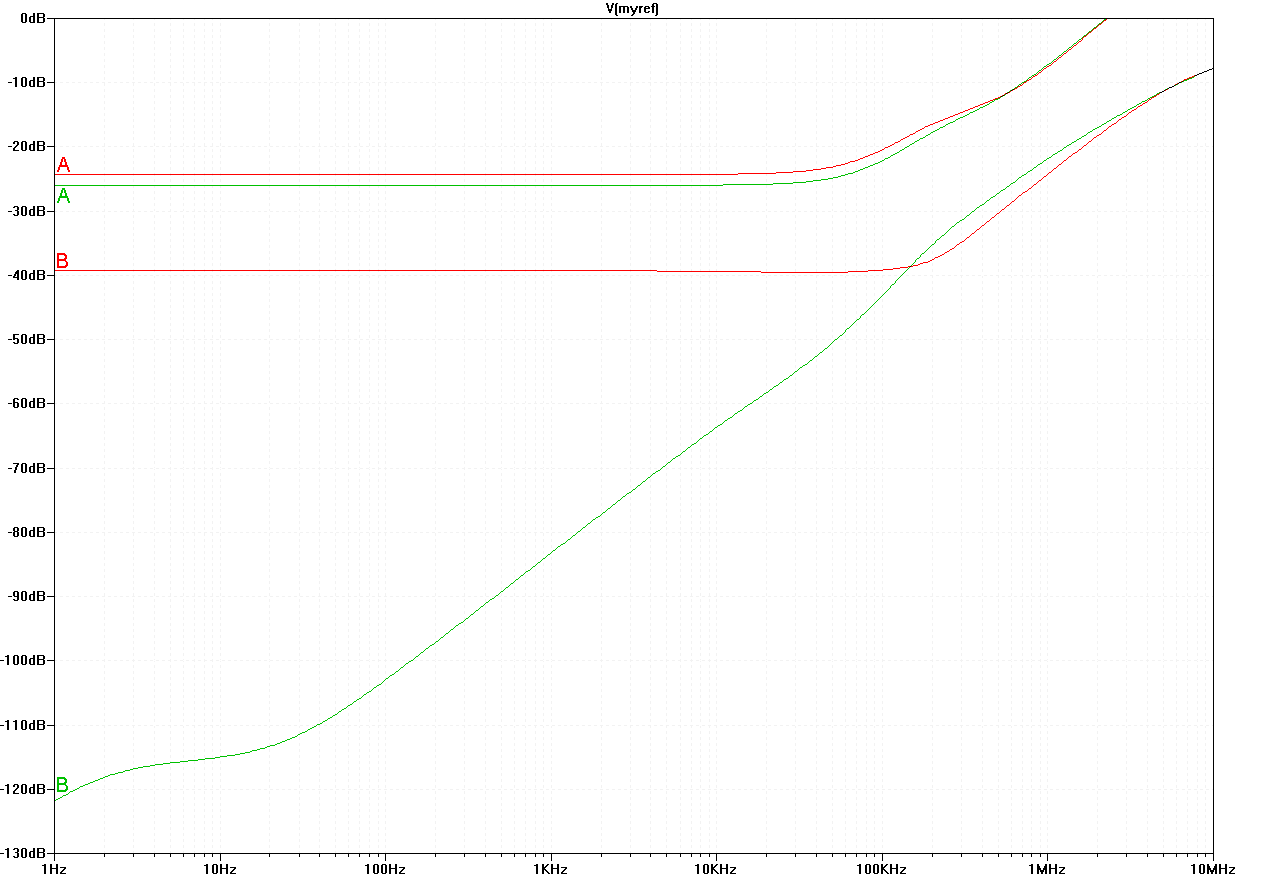

If I include the speaker wire though and put the stimulus directly at the load (point "A"), the differences in layout routing get mostly swamped by the speaker wire. Compare red and green traces "A". The result looks rather bad in both cases, so there's not much to be gained with careful routing.

The green traces show the "layout" like it is shown in the attached schematic. All Grounds are connected to a ground star, which itself is connected to the power source, except for the signal ground, which is connected directly to the speaker return. The red traces show basically the same layout, but now with all the grounds connected to the ground star (like how I did it on the boards). "A" and "B" respectively depict where the stimulus was connected to.

Are the A plots where you applied the stimulus across the load, R1?
Whereas the B plots have the stimulus applied from the top of the load (R1) to point B at the other end of the speaker cable?
What does it look like when the stimulus is applied from out to B, i.e. at the start of the speaker cable?

No. The A plots have the stimulus (I1) connected from point A to "simulator ground", like is seen in the schematic. The B plots have it connected from point B to sim ground instead; "left" from the speaker wire so to say. Points A and B are both on the negative side of the load and thus the stimulus is not connected across the load.

No. The A plots have the stimulus (I1) connected from point A to "simulator ground", like is seen in the schematic. The B plots have it connected from point B to sim ground instead; "left" from the speaker wire so to say. Points A and B are both on the negative side of the load and thus the stimulus is not connected across the load..............
Do you mean between A and the junction between V2 and V3 ?
and between B and the junction between V2 and V3?
What are these measuring?

In the simulation, the inputs to the amplifier are grounded to GND_SIG and an AC current is injected into the GND_LOAD net. This represents the current returning from the speaker load. The return current results in an error voltage developing across the ground nets, part of which is amplified by the LM3886. The simulation uses a voltage controlled voltage source (VCVS) with a gain of 1 V/V to measure the resulting error voltage developed across the load. The resulting error voltage is plotted in dBV. Recall, the goal here is to have as little error voltage developed across the load as possible, as this error will degrade the THD performance of the amplifier.

explain what the graph scales mean?

That's one. The other is frequency range, pretty self-explanatory. Not sure what you're after... :confused:

My argument is, that the routing of the speaker return track becomes more or less negligible if you consider the parasitics of the inevitable speaker wire - unless you build an active speaker, of course. In my opinion those couple of inches are merely a short extension of the speaker wire and thus the speaker wire as a whole must be considered in the simulation. Tom did not model the speaker wire in his simulations at all. I resembled his sim from the pictures seen on his website, changed the circuit topology to the MyRef, and added some parasitics for the speaker wire.
Now I was not sure where to put the stimulus there, because I didn't come up with the sim, but merely copied it. There were basically two options, which I called A and B. In B the results are pretty much the same as Tom's, which seems reasonable, because the load itself and the speaker wire are "out of the loop". In A however, the current of the stimulus now has to pass through the speaker wire and the PCB track, which makes the results a lot worse to begin with. Now the routing of the track makes only a difference of a couple dB, compared to 80+dB in B.
I'm not 100% certain which way is right, though. That's why I posted the results here after all. But then again, in my opinion, the speaker IS the signal generator, because the current has to pass through it and anything induced by back-EMF originates there, so the stimulus has to be placed directly at the load itself.

The simulation shows you the voltage between the speaker return (point A in the schematic) and the non-inverting input of the amplifier circuit, which is basically at signal ground. This voltage results from the 1A stimulus current and the parasitic resistance/inductance of the speaker wire and the PCB tracks between those points. Since this error voltage is seen by the amp input, it gets amplified and added to the output signal. At least that's how I understand it. Maybe Tom can chime in and enlighten us all.

Can I look at the other end of your stimulus input.
Why is there an idealised PSU with zero impedance feeding the four voltage outputs?
Why have you shown the Signal Ground separate from the injection point?
Why is the "star ground" not used as the injection point.
I don't see how applying the impulse to the idealised PSU is replicating a real amplifier.
Doesn't make a difference in AC simulation to use a more elaborate PSU model.
Because in a physical build there is a lossy trace between those points, whose parasitics are modeled with resistance and inductance.
Because the injection point, IMHO, is the connector at the cabinet of the speaker. This can not be the star ground, because there's the speaker wire in between. If, on the other hand, the injection point and all the other grounds are connected to a single star ground (only possible in the sim), you get an ideal result far below -200dB, which surely not resembles reality.
The PSU is not important here. And the sim is not supposed to replicate a real amplifier. It is only supposed to show how an error voltage due to the load current develops and gets amplified by the amp. This alone could be achieved with a much simpler simulation schematic I guess, but then again the sim should somehow resemble the actual circuit AND PCB layout.
