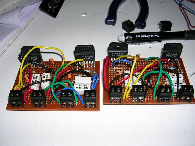

my new lm3886 amp!!!!!!!
i have finally finished the main boards.
its a p2p type board.
i know it looks pretty ugly but hey, its only my 2nd project till now.
hey can u guys please tell me how i can add a simple volume control to this thing

need help i have grounded pin7 of the lm3886 wut do i do with pin 8 (mute pin) do ground directly.
i am using carlosfm's unregulated psu.
below in the notes he has written use 100nf+100uf caps on chips psu pins.
that means i put one pair between +v and ground. and other pair on -v and ground.
but as i am using br100 schematic. do i have to do this to the second chip's psu pins too?
that is total of four pairs?
hey guys come on reply me pleasseeeeeee!!!!!!!!!!!!!!!
ok i have setteled with the mute pin. now i can hear the sound from the amp. it works fine!!!!!!!
but the thing is i have used a 35k resistance between pin 8 and -V. will this reduce the total out put ?
and also the thing is i am not much satisfied with the hi frequencies of the amp. i was expecting more. i have addes a zobel. and used the br100 schm from the an-1192 file without any modifications.
and i am using carlos fm's unregulated psu.
does any one have any suggestions, so that i can get more crystal clean sound. any filters or something like that?(please post a link or schematic)

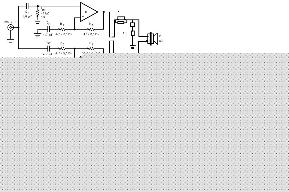

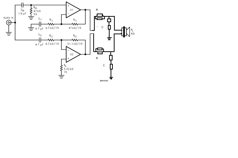

i am using the br100 schematic. and i have just added 2 zobel networks
at the outputs of the two chips on both boards.
i have done p2p connections. i am using carlosfm's unregulated psu for chipamps. i have also added 100uf + 100nf caps between -v &ground and +v & ground.
i havent added anything at the input. do u think adding caps at the input will help?

There seems to be some mistake in the way you up-loaded your schematic, because I can see only half of it.

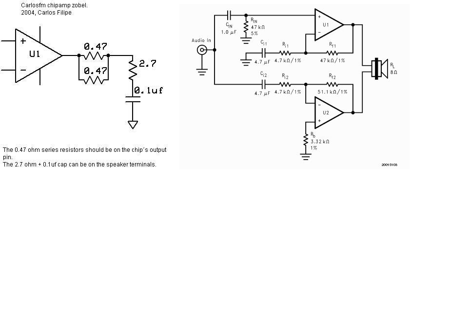

But there's something you should eliminate right away: the zobels. Listen to the amp without the zobels, then with them. And put them BEFORE the output resistor, not after it.
What series resistors are you using at the outputs?
Did you match the resistors to the specified values?
The problem with the specified circuit, IMHO, is that the amps are not exactly the same, but use different gain resistors to compensate for the configurations. Using a transformer or a balancing chip (like DRV134) and matched resistors on the same configuration amps (inverted or non-inverted) would be better.
Using p2p connections on a bridge is not the best option, I think, as there are too many parts and places to do a mistake. A prototype board would have been better.
No, adding caps at the input would not help. But if you did have a parallel cap at the input it might be working as a low-pass filter, and then cutting the highs.
One way to accurately see where your amp's highs are falling is using a 'scope or doing some measurements. Can you do that?
Your amp is a bridge, so it's quite likely more powerful than the HK. If you are using the supply specified in BR100 (+/- 26V) you are delivering 100 watts onto 8 ohms. Your speakers are quite likely less then 8ohm types, so the power delivered may even be larger.

The zobel is a specific application low-pass filter.
Why is it impossible to take the zobels off if it's hardwired p2p? Then your arrangement is being just the opposite a p2p design should be: easy to modify.
Do try to take the zobels off because I think that might be the trouble you are having.

hey it workssssssssssssssss!!!!!!!!!!!!!.
it finally came alive on both the channels.
the highs are crystal clear since removed the zobels.

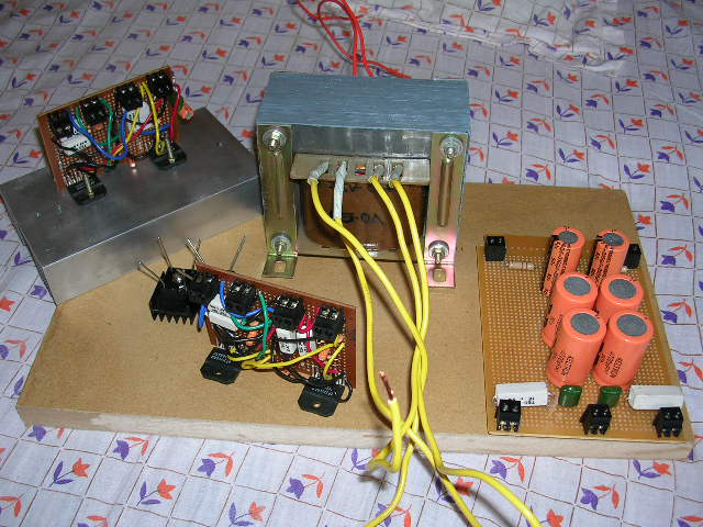

hey but the thing is it is getting a bit hotter than before.
is that because this time i am using both the channels in paralell with the trafo.? because the resistance must have reduced because of the parallel combination.
the trafo. is also getting hot. i am plannin to use a 12v fan. the fan is rated 2.2w and 12v. so can u tell me the value of resistance that i should use? then i will connect the fan with a series resister to the +30 rail and ground.
but wut i dont understand is that my heatsinks are facing outwards that is they their fins are outside the box. and the trafo. is inside the box. so i cant practically cool 2 heatsinks on two opposite sides, than i will need 2 fans which in not possible.
so like if i put a fan it will on cool the trafo. so will coolin the trafo help much?
