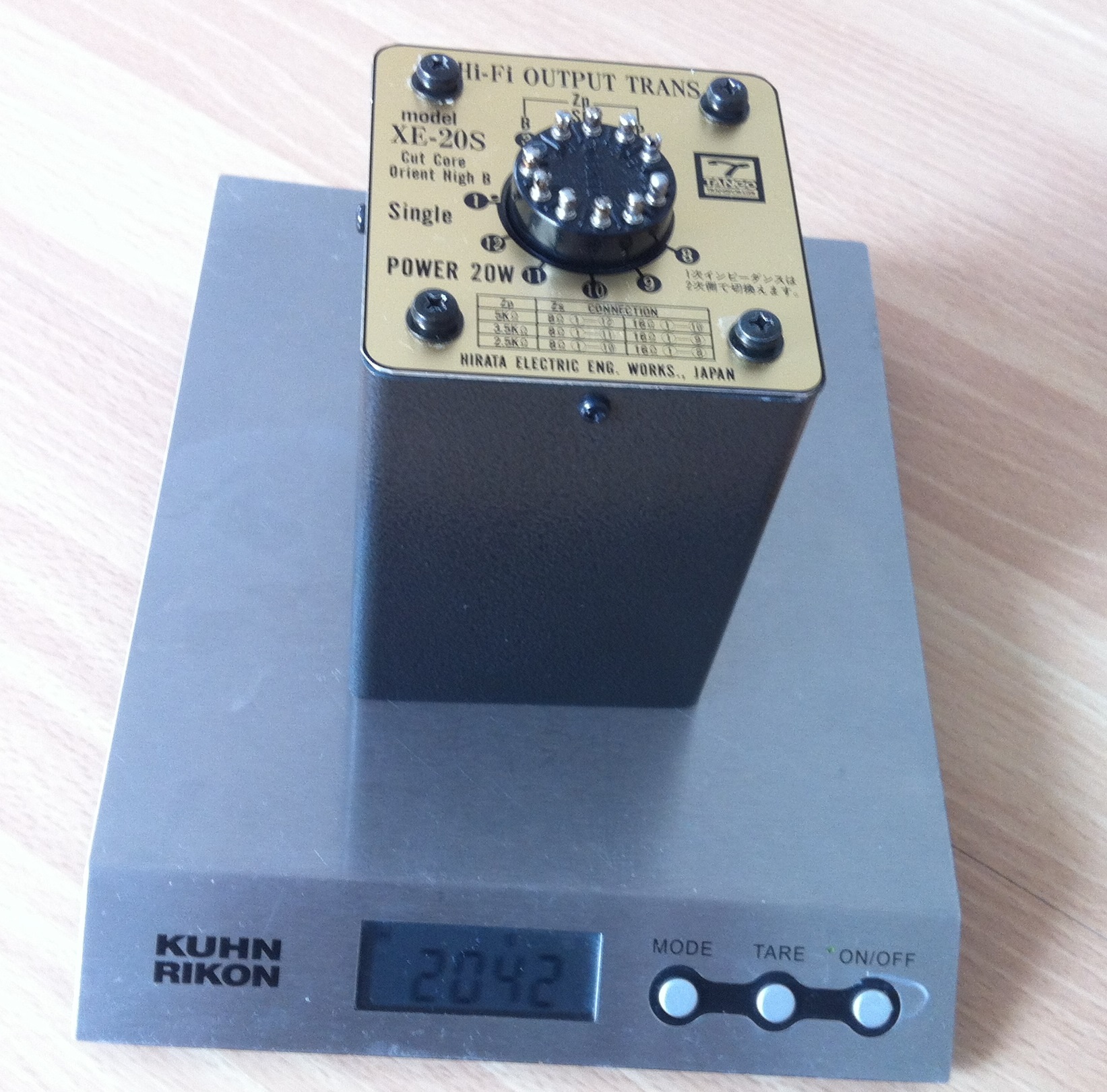

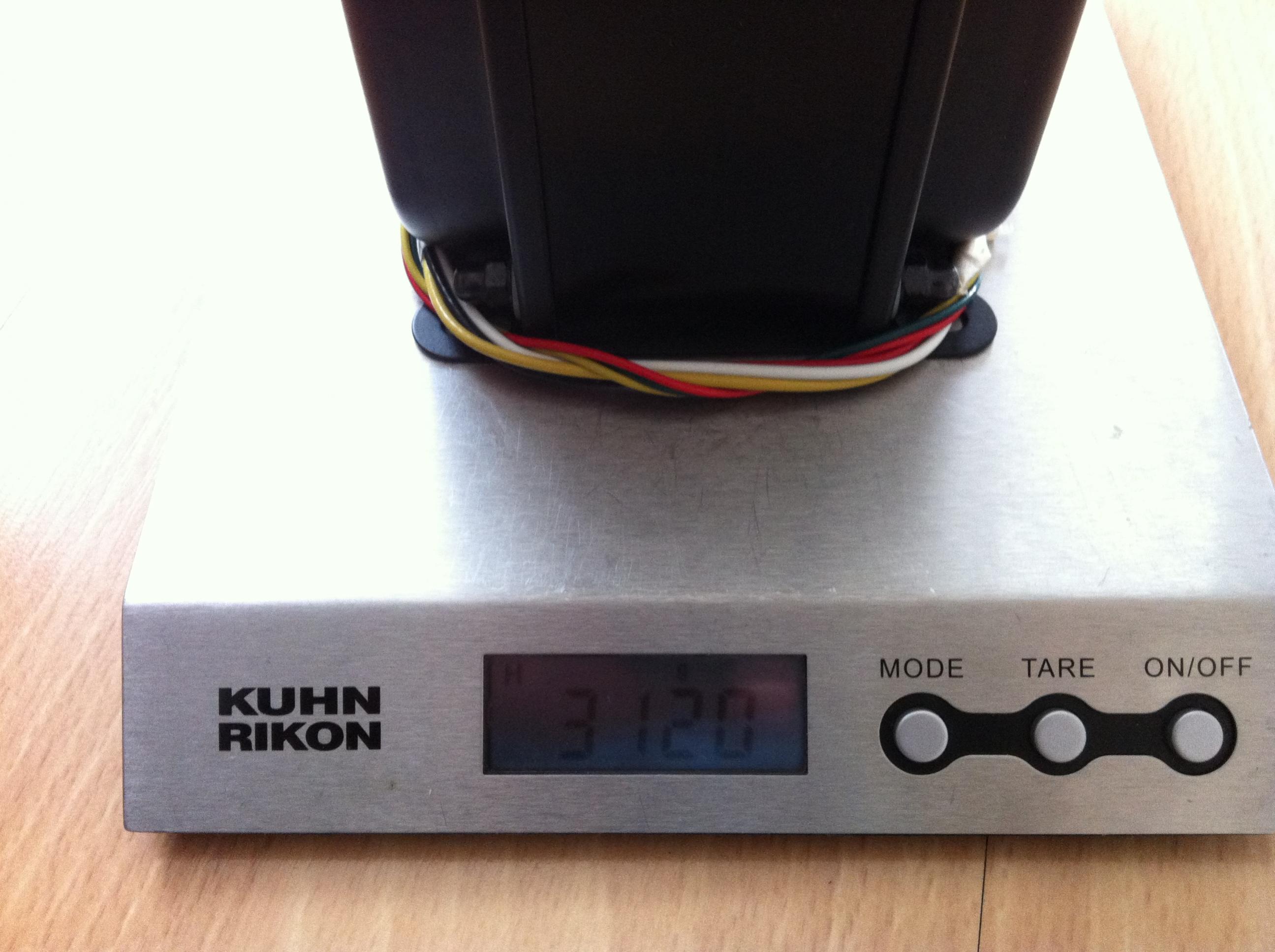

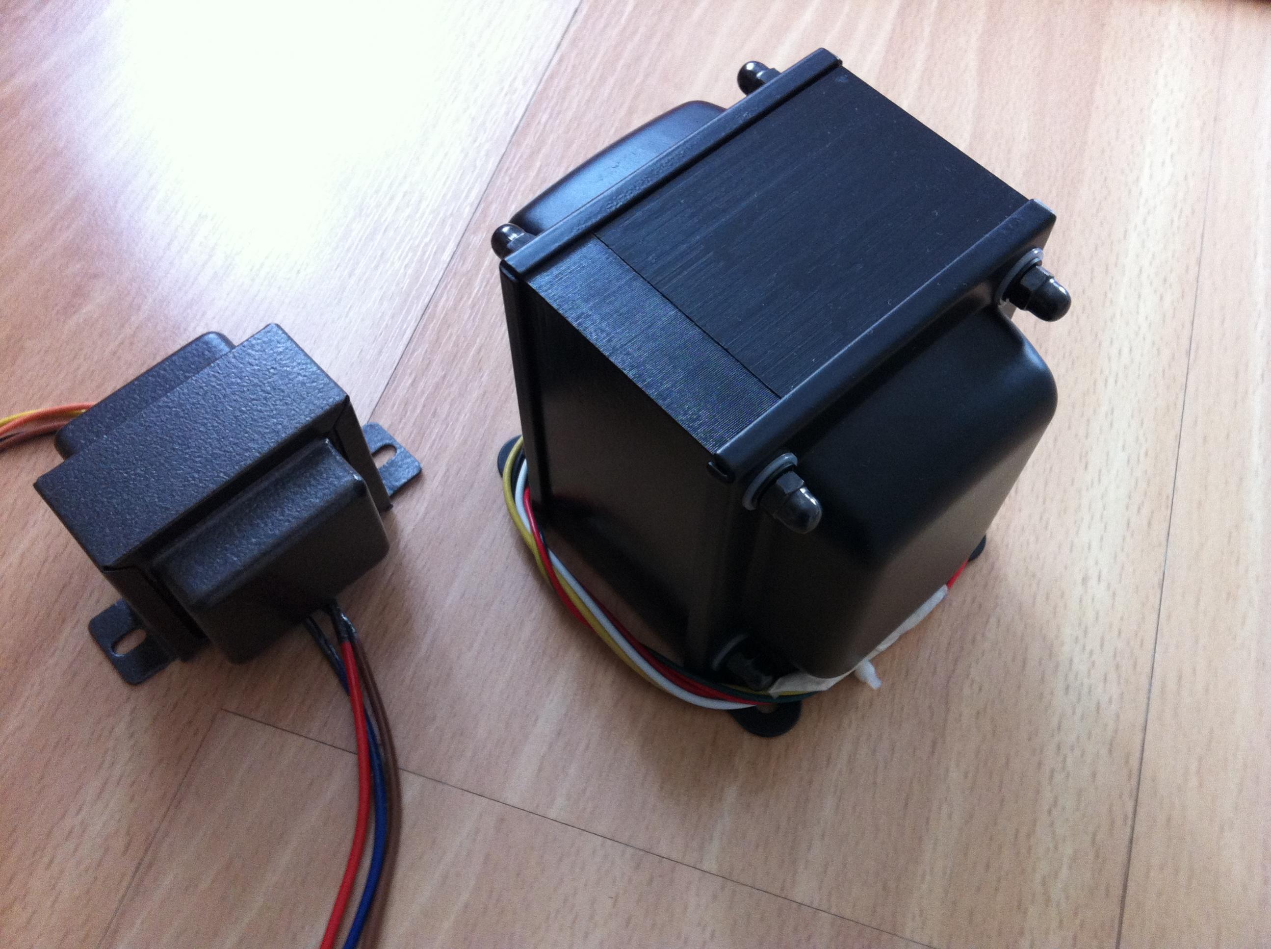

Well I finally got around to hooking up my Tango XE-20s OPT's to compare with the J&K ALIS-5SE. I had both set to 3.5k:8 Ohm outputs just to make the comparison as fair as possible.
The J&K transformers can be found here: J&K Audio Design while Iso Tango is unfortunately no longer in production. The chief reason I waited to compare the two was to give the J&K's time to run in.
Its always hard to be subjective about these things. I must admit that I love Tango OPT's, especially the FX-40-5 (for P-P) and the XE-20s (for SE). With this design they don't dissapoint. The XE-20s weighs in just over 2Kg and has enviable sonic characteristics.
Its really hard to pick a winner here. When I play vinyl, close my eyes and relax, it feels like the musicians are rigtht there in front of me. Even CD's sound really life-like.. I would perhaps say the XE-20s has a slightly more delicate, forward presentation. The ALIS-5SE has a slightly more impressive, richer sound stage. Bass response is steady and firm for each OPT, and both freely pass all the musical details and transients that surprise and delight a listener.
I prefered the ALIS-5SE for popular music over the XE-20s because of the slightly more impressive sound stage. Pink Floyd and AC/DC never sounded so darned good. The slightly more delicate presentation of the XE-20s was the winner for solo guitar and female vocals. It sounded like Diana Krall was in our living room. Lots of goose-bumps were felt with each OPT... The differences are very small and quite subjective though - highly dependant on source too.
I also hooked them one to each channel, and played some mono recordings. Darned hard to tell which one I would prefer. Thelonious Monk, Vienna Quartet, mono Doors and Hendrix... All sounded fresh and like I had never really heard them before.
The XE-20s takes up less space and is a whole Kilogram lighter than the J&K. I would probably chose it if space and weight are a concern. That said, the XE-20s is not in current production and I hate auction bidding wars. I think if space on the chassis is not a concern then the J&K is an excellent choice.
You need to give new OPT's time to run in though, and there are other superb winders out there. Its wise to investigate, ask questions and compare first.
Just as a reference, I hooked up the little Tomiko OPT's again too. Surprise suprise, they sounded pretty darn good! Lively and fun, but they don't compare to the other two which are in a completely different league...
Hope this is useful for others.

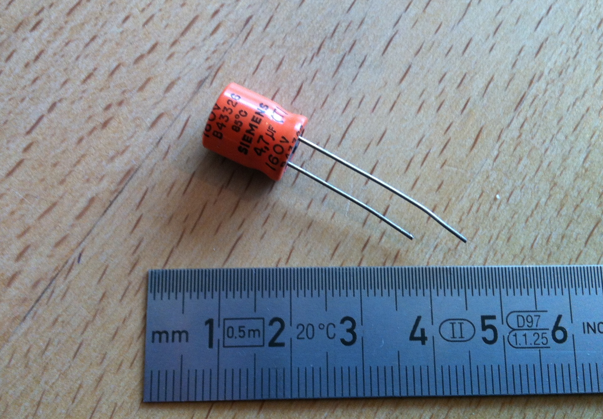

Ok, long awaited here is the 2nd generation power supply.....
What type of capacitor is C4? I assume that C3 is your usual ASC motor run.
JM
Hi JM
C4 is the only electrolytic capacitor, and you only need it on one channel. I put it on the right channel. All other capacitors are motor run or polyester film.
The value of C4 is not very critical - 10uF would also be a fine choice. It should be at least 100V rated. Mine is rated 160V. It is used to reference the 6SL7 heaters to 65-70V.
