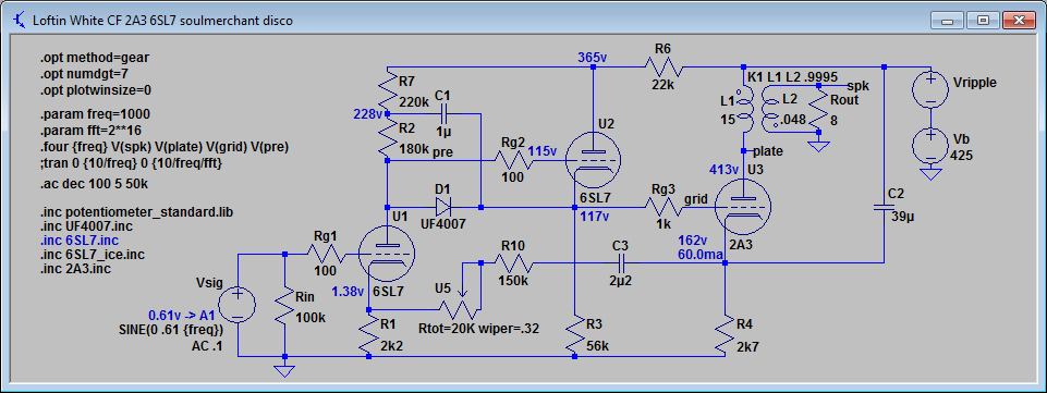

Ok, here's a scheme for your 2.5K OPTs.
I used the datasheet operating point for the 2A3 and lowered the B+ to 425V (for increased current draw, 60mA thru the 2A3). Please double check after re-wiring.
Note the bootsrapping cap on the 6SL7 must be increased to 1uF to yield proper bass extension and damping down to 20Hz. The optimum value for the ultrapath cap is 39uF. This provides the flattest response down to 20Hz, and does not compromise damping.
I will sketch up a variant with some nfb later.

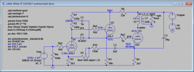

C1 is 220nF in Soulmerchants setup, could it be causing phase shift in the lows?
I'm asking because of my compact build it's hard changing parts.

C2 (39uF) should be equal to the last cap on the PS, is it not? The nearest stock size would be 47uF electrolytic I guess...
I double checked and indeed, when it comes down to damping, there seems to be little difference in using 1uF of 220nF. 1uF however gives a nearly perfect linear frequency response and less phase shift. With 220nF there are some dips or around -0.3dB in the low bass.Whatever that means to your listening setup.
39 µF is a standard size. Jantzen cross cap are available for less than 10€ each in that size. There are also some motor run caps in 39 or 40 µF.
I wondered what the setup procedure is. In my case the 2A3 is powered from a not center tapped 2,5Vac incorporating a hum pot [33R - 25R ww pot - 33R]. With the hum pot I can cancel out all residual 50Hz on the speaker output. Is the variable U5 to be used with an oscilloscope?
First , null out any filament hum. Then null out any residual hum using the "U5" trimmer in the L-W network. Then, optionally go back to the filament humbucking pot. If you can't hear any residual hum, it's probably good enough. Otherwise, a simple multimeter connected across the speaker terminals could probably be used as well. Connect a speaker or dummy resistor before you go!

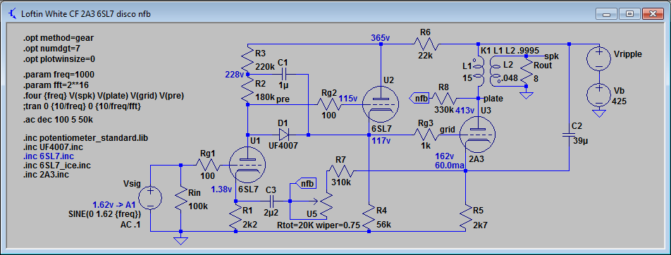

Here's a possible way to include some nfb, without going 'round the opt. Damping factor rises to ~4. Phase shift is reduced as well, but beware the frequency response can get worse if your opts are not top quality! If you're using rather mediocre opts, it's probably better to include them in the feedback loop.

Well, I'm confident in my tranny builder's knowledge, no worries there, but I think the feedback is complicating the topology which main feature was independence from PS quality. If you predict stellar results I'm happy to build it but not for the experiment's sake :p
Perhaps Ian has some experience to share... cuz whatever I tried the bass response remained not linear. A further dropping of the 6SL7 current raises ri while amplification diminishes, not helping the triode factor.
There's exactly one more resistor in the NFB circuit, not really complicated. OK, the signal passes a cap as well, you might feel critical about that. The L-W compensation however is not impaired in any way.
The effect is kind of hard to predict, it probably depends on your speaker combination above all other things. But since you were talking of boomy bass, that's one area most likely to improve..
There's a reason I used 35uF film for C2 - it was closest to optimal value. If I had 40uF in the right size I would have used that instead. ASC X386 40uF caps exist - but I didn't have the smaller 330VAC ones in my supplies stock... I would not consider 47uF electrolytic.
