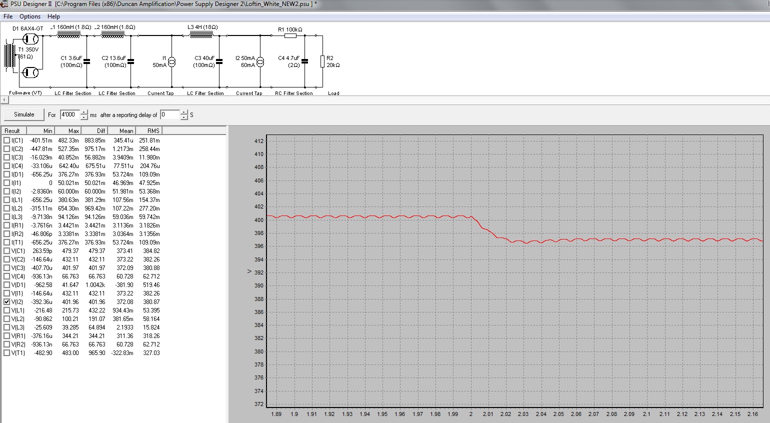

Ok, long awaited here is the 2nd generation power supply. I will admit it is still not ideal but it is pretty darn good.
Its a flywheel type using two Lundahl LL 1694 Filament Chokes, then splitting right and left channel to a Lundahl LL 1638. The LL 1638 I had here is the 8 Hy version, so each channel is using 4 Hy. If I had a 10Hy LL1638 it would be better.
PSU II can't do a very good job at modelling the effect of each channel, so I put in a current tap after the 2nd choke to simulate the effect of the other channel.
I use the soft start option in PSU II since I am using Damper Diodes. The real measured B+ voltage is around 404 volts right now. Each 2a3 is drawing a little over 48mA. I will probably make some more adjustments.
You can see that a significant change in current draw results in a pretty clean 20mS response. The serial resistance is really low and the response is FAST. The most significant way to reduce the response time further is to go to solid state diodes, but then this simulation immediately shows significant overshoot, and you lose the slow start-up (which is very important). The plate resistance of the 6AX4 damper diode is around 120 ohm while the 6AU4 is less at about 80 ohm, so just by using 6AU4 the B+ can be set higher.

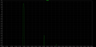

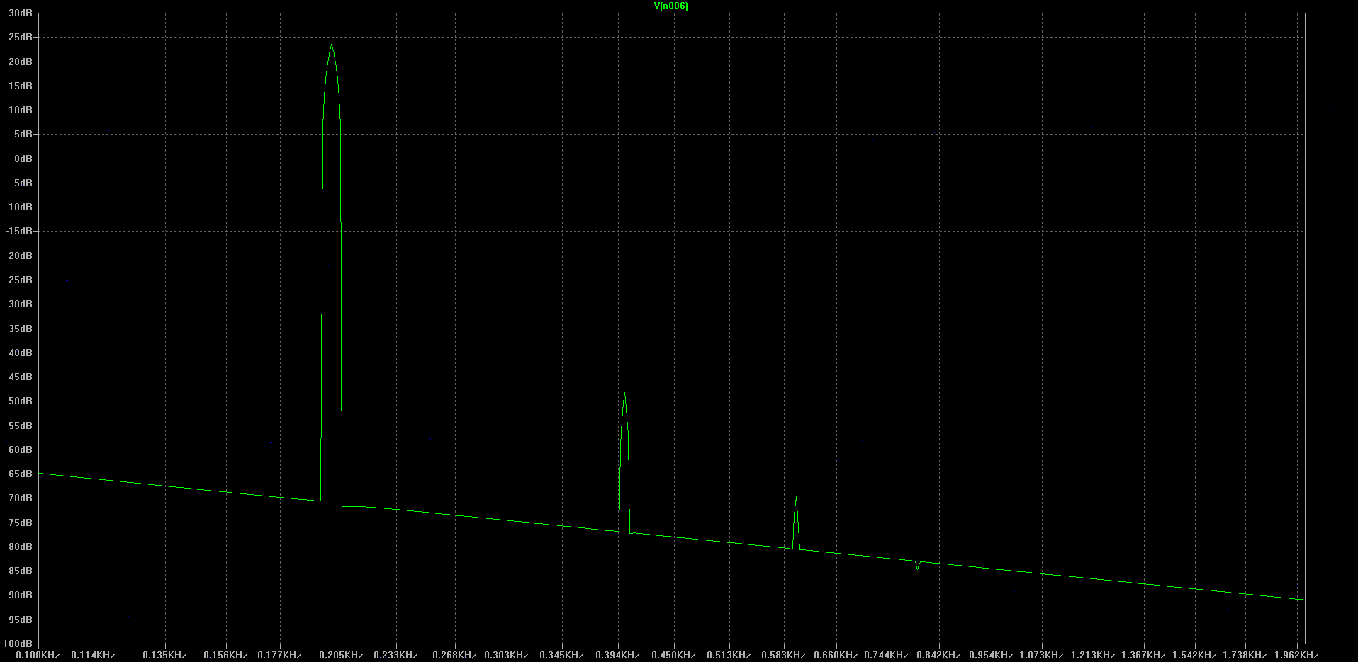

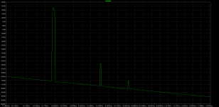

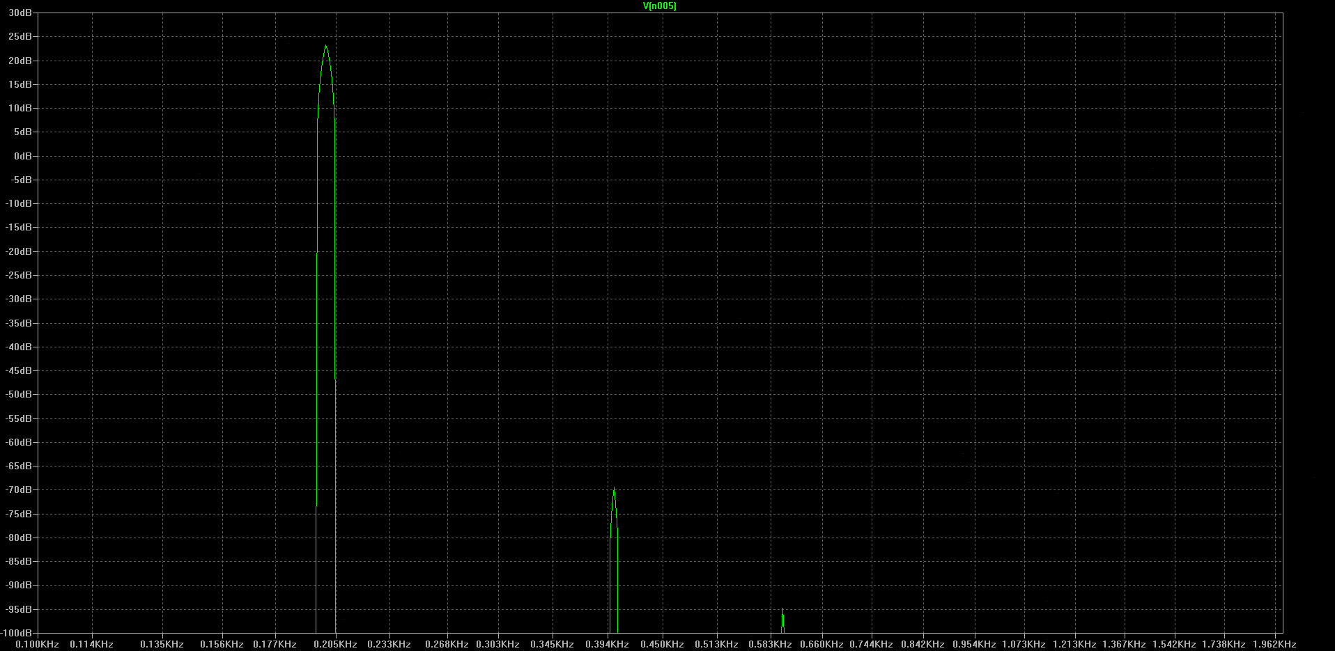

I simmed the Darius follower version and the gyrator loaded (no follower) version. Same input, FFT taken at 2A3 grid.
Although the Darius follower appears to generate a suprisingly high plate load for the input stage (very impressive actually), there's a significant difference in harmonic content as can be seen; about -20dB.
I also simmed with a 6 VAC component in the B+; the gyrator circuit seems to have about 55dB ripple rejection. I can't comment on whether this is good or not, since I always regulate B+.
I made some sims and formulated a response before realising that you were talking about the power stage while I was talking about the input stage. I myself use gyrator plate loads on all tubes, but most people think it's practical only in preamp stages so that's what I was thinking.
I'll first respond regarding input stage, then the power stage.
