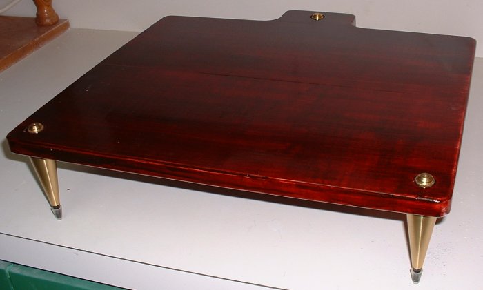

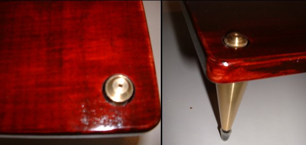

Case laquer
Here the suspension plate with MinWax Laquer Red Mahogany.

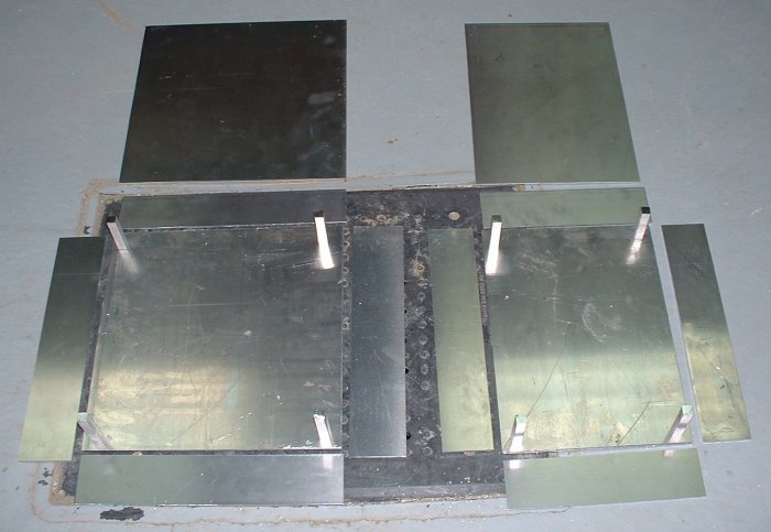

Case Metal just starting
I completed the cutting of all the aluminium plates for the case. Don't forget there is 2 cases for just one ONO. One for the transfos and unreg supplies, the other for the reg psu and ONO Preamps pcb. I cut 2 complete sets, one case for the ONO the other for my SuperDAC.

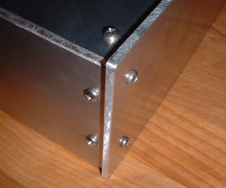

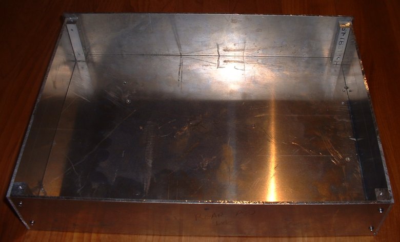

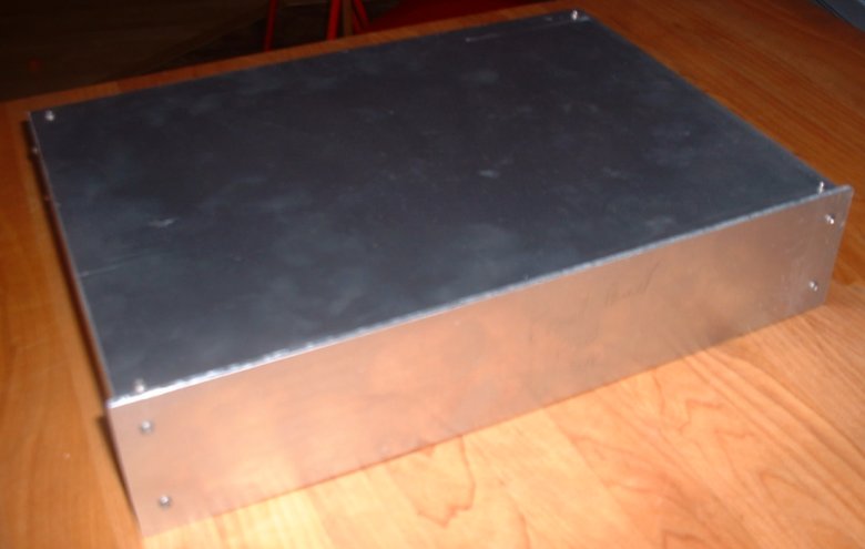

Inside detail. The case is made of 1/8 inch aluminium. I used 3/8 bar in each corner. All the screws are 4-40 Stainless Steel.
The finished enclosure a pretty rigid but the top cover rings like a bell. I will cover all inside surfaces with bitumen type pad to kill the vibration. I used a piece of scrap alu for the bottom. This is why there is scratches on it...

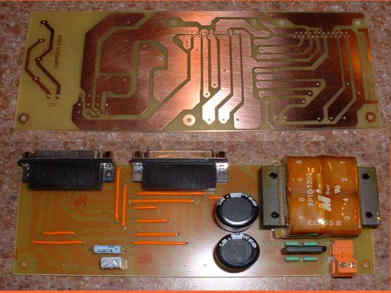

Since I'm also working on an Aleph X preamp clone, I wanted to use the same connectors and connector pins pattern as used into standard PassLabs power supply products. Their power supply can supply a X1 preamp and an Ono at the same time. The PS supply +/-40V and +/-10V for the digital, all unregulated, are available on both DB25M connectors
To be able to do so, I design a new PCB for my power supply section. Both +/-40 Unreg Power supply will connect there. There is also a new +/-10V Unreg Digital supply added on that PCB. Finally it can supply the PS front blue led. All supply voltages are available on both DB25M connectors. Since I'm using fully dual mono supply, I made each L and R power supply bigger traces (lower impedance) on each L and R connectors. So I'll be able to use this supply for my X preamp if I wish to.
Here this PCB
