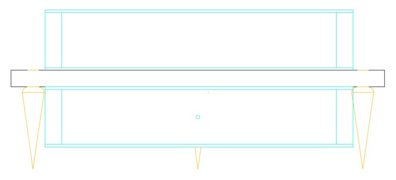

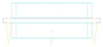

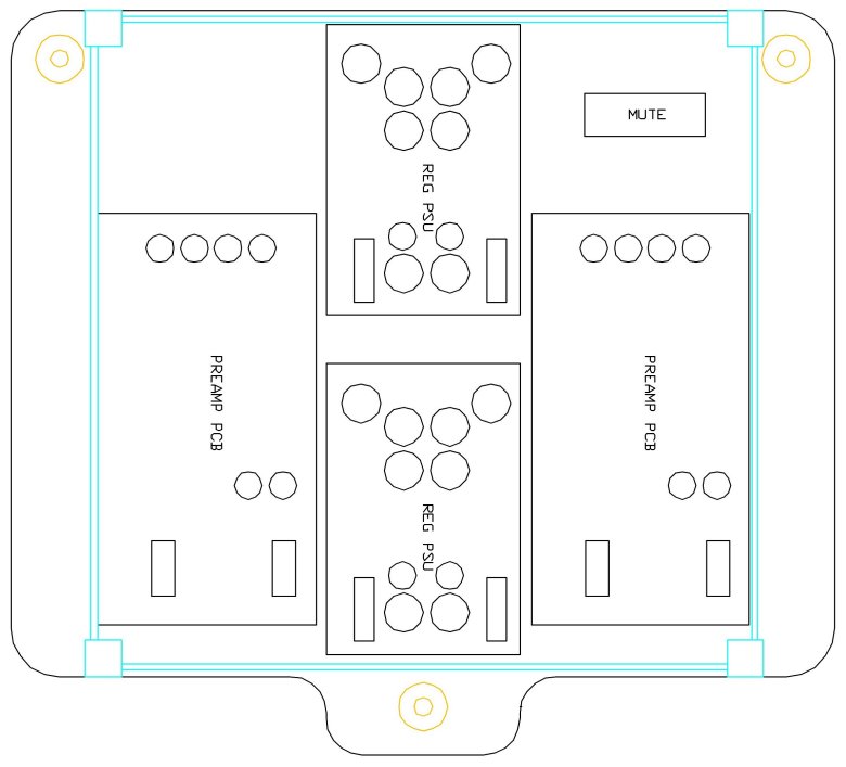

The Concept of the ONO Enclosure
This is my concept for the enclosure that I want to build for my ONO preamp.
It will be a two boxes connected to a common vibration insulation plateform. The plateform will be made of 1 inch tickness laminated maple plank.
This plank will be suspended on 3 long spikes, solid brass plumb bob with steel tip.
Both boxes will be made with 1/8 aluminium sheet and 3/4X3/4 alu bar.
The 2 boxes will be connected to the plank. The preamp and regulated power supplies will be on top. The main input, the two shielded power transformers and the unregulated power supplies will be in the bottom enclosure.
The 40V voltages will only cross between both enclosure without using connector
A blue led will turn on on the supply module. The power switch will be on the back part of the Main socket.
Here the AutoCAD front view of the enclosure.

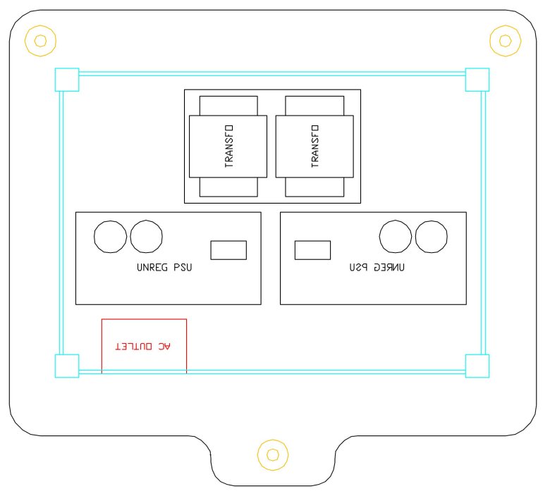

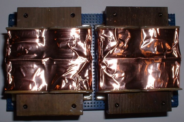

ONO - The Dual transfo
Here the dual transfo that I choosed. They are from Hammond, dual - split bobbin design. Same kind of transfo desing used by YBA in their integrated. I have it also in my Bryston preamp that I like very much.
This transfo desing offer Low primary to secondary coupling, balanced windings, no electrostatic shield required and low EMF radiation due to semi-toroidal design.
In addition to that I installed a shield around the transfo windings using 3M EMI shielding cooper tape.
There is one transfo per channel (dual mono supply). The model closest to the needed specs was the 229D56, 2X28V, 0.857A
I got a nice +/-40V using it in this application.
Here a picture:

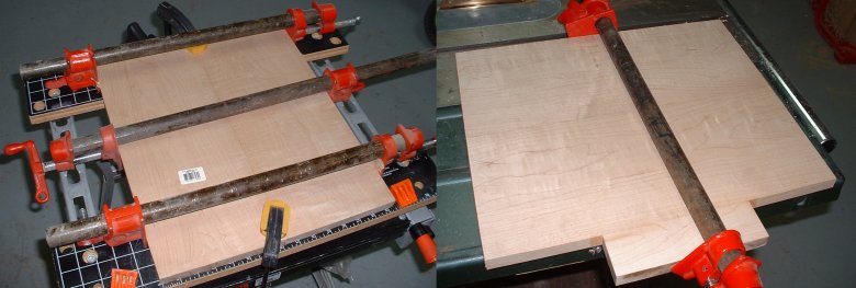

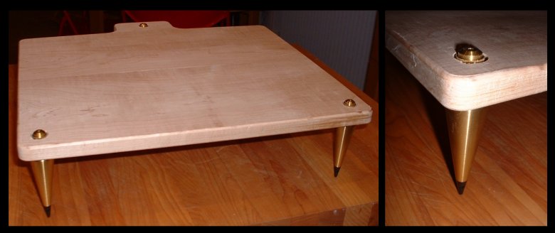

Case beginning
I'm beginning to build the case shown as a concept previously.
Here I pre-cut the maple pieces and glue them.
Dried maple is rather expensive. The wood needed to build two plate, I will build the same case for my Super-DAC, cost me 40$ CAN :bawling:
But nothing replace the smell, touch and look of real wood.
The problem there is that your wood has a bar-code on it. Wood with bar codes is always much more expensive 😉 .
Seriously, you can get much better deals on hardwoods if your search out a local sawmill than if you buy it at Home Depot. Find out where local woodworking shops, cabinet-makers, etc. get their lumber.
