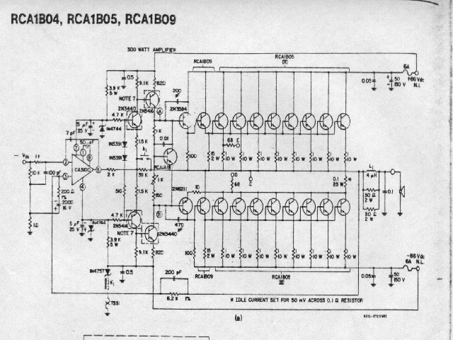

hey guys! anyone already tried to build this amp? it was already discussed before on the forum...

I built the Tigersaurus and it sounded awful. (used the SWTPC boards too.) I think that I still have the issue of Popular Electronics from the 1970's. (was it popular electronics, one of those consumer mags.)
straight from the rca transistor manual....
lots of power huh? that amp should be fine for pa system work!!! i have the complete rca transistor manual with me.....that circuit came out with two other transistor type outputs if i am not mistaken....

"I built the Tigersaurus and it sounded awful. (used the SWTPC boards too.) I think that I still have the issue of Popular Electronics from the 1970's. (was it popular electronics, one of those consumer mags.)"
A problem of some sort. Probably oscillating. These amps sound absolutely killer when done right.
Mine oscillated at 2Mhz when first powered up. Sounded like an electric shaver and got real hot.
It was the solid tantalum input coupling cap.
daniel meyer's tigersaurs, radio electronics magazine dec.1973

i still have about ten sets of boards, the 40410/40409 rca transistors can no longer be found here in manila, even the shop selling them has long closed down....this amp is prone to oscilations, probably the reason for the 100ohm resistor feeding the bases of the output transistors, but even with it, there is still oscilations evidenced by power amps get hot sometimes even without signal and biasing is just right at about 50ma idle....
