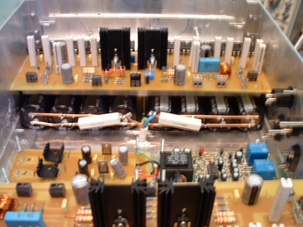

hey guys! anyone already tried to build this amp? it was already discussed before on the forum...
lots of power huh? that amp should be fine for pa system work!!! i have the complete rca transistor manual with me.....that circuit came out with two other transistor type outputs if i am not mistaken....
I think you better have a look at the amp that matth built, it packs a lot of power and as he said, it is stable for pa and he actually used it for a party too.

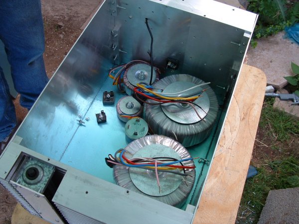

built my first tube amp in 1968...
you bet, i have a collection of "audio"; " popular electronics": and "radio electronics" magazines this is where i learn most of the stuff...i also have lots of NS, TI, Motorola data books collected over the years....i built my first solidstate amps in 1972....
boy, you sure have a lot of amp collections there man .
