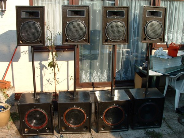

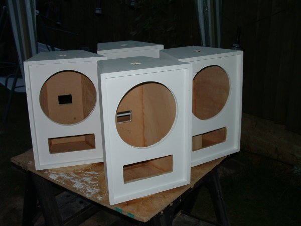

Thanks again, I don't have a picture of the finished Tops but this should give you an idea, they are now finished the same as the subs with top-hats and mounting poles:
They contain a motorola compression driver and a Eminence Bata12. Crossed over with the subs at 310Hz. I am setting the whole setup up in the garden on Friday so will post a pic of the entire rig then.

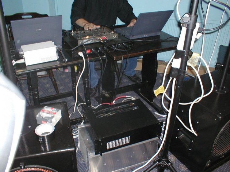

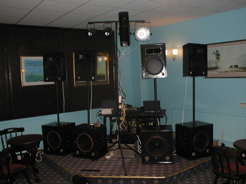

The disco went well (very loud
I did take a couple of pics of the setup in situ but the camara is still buried at the bottom of a flight case under the rest of the system (I will attempt to dig it out and post the pics).
Whilst performing the burn in tests on Friday afternoon the main amp went bang with a good puff of smoke 😱 we cut the power and inspected the damaged 😕 a decoupling cap on the power rail had exploded. Upon futher inspection I realised my mistake, one cap on both boards was 470uF @ 63v instead of 100uF @ 100v (both identical size!) it was a wonder that either held at all on the 81v rails 😱 .
I replaced the caps in both boards, rebuilt the amp and away we went with no futher failures. Thank goodness the cap didn't hold out any longer!!
We set the ip to the amp to limit the maximum op to about 300watts into 4Ohms and the tops amp at about 200watts into 4Ohms so running about a kilowatt total, we didn't get it passed about 80% full volume😎
Anyway the girl enjoyed her 18th.

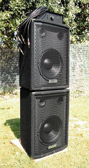

Here is a pic of my very modest 'party rig'. I bought the speakers for £140 when Maplin had them on special offer, and the amp (sitting on top) is a two channel bridged LM3886 with limiter, made mostly from junkbox parts. I posed a pic inside it here:
http://www.diyvideo.com/forums/showthread.php?postid=152474#post152474
The sound quality is pretty mediocre, but this system produces more than enough volume for most big living rooms, and has been used for vocal PA outside with good effect. Since the amp has the LM3886 chips directly mounted on a heatsink with forced cooling, and with its limiter, I can leave it unattended without damage.
