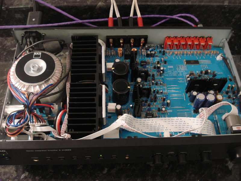

My NAD C515BEE is finished.............

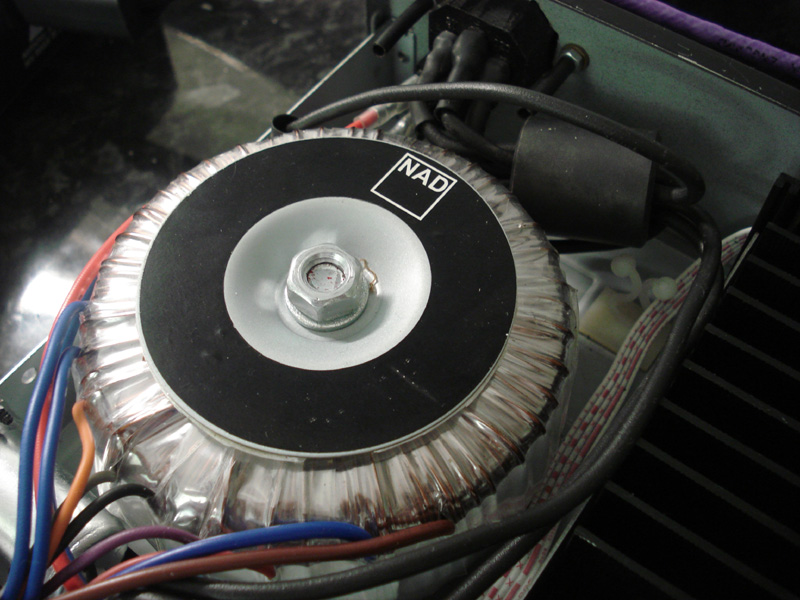

Why dont you post some more pics of your lovely amp to take your mind off it. I would be interested in particular to see the transformer and main power supply.

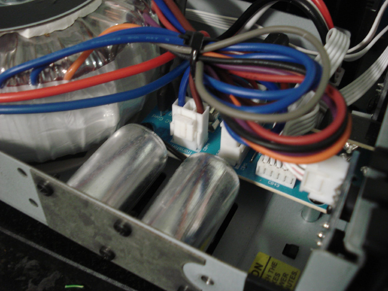

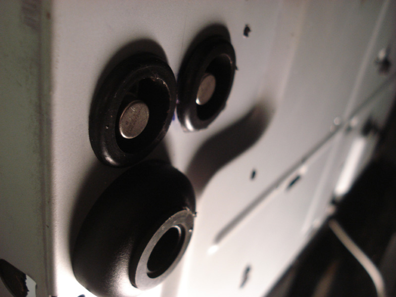

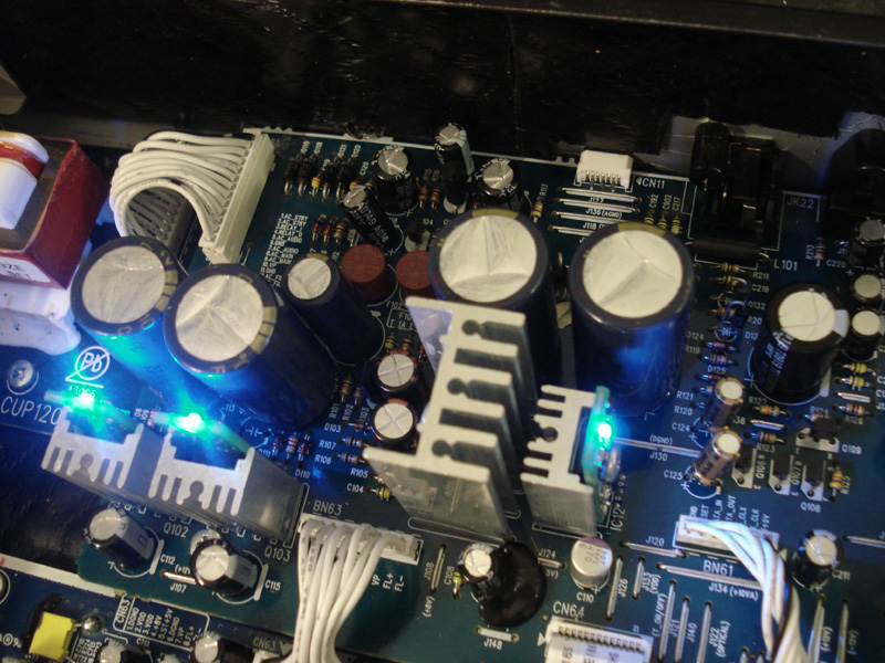

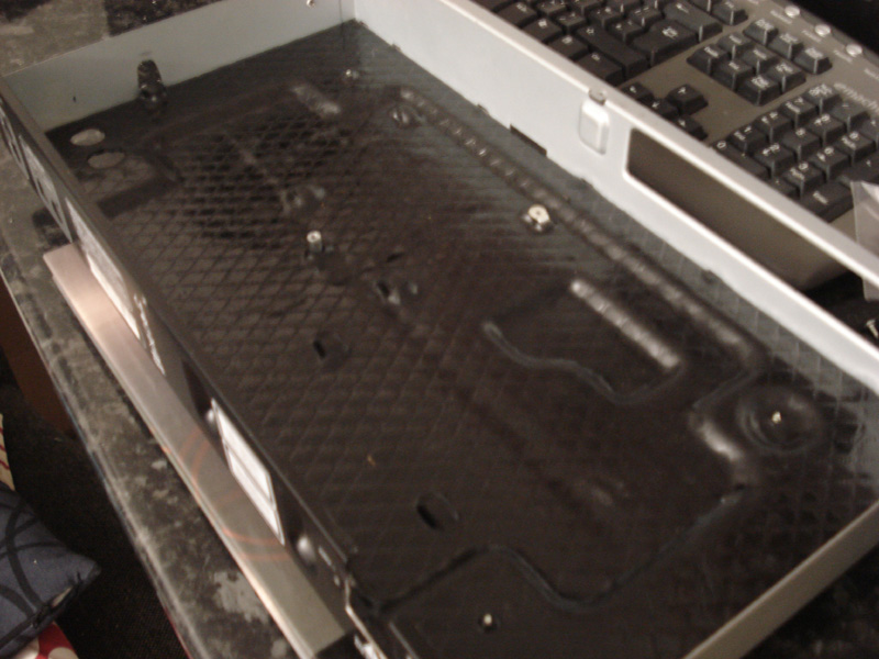

More pics......

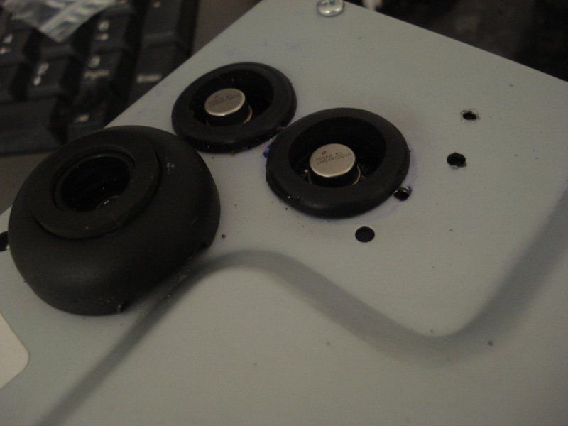

Pic #1: It was all there last time I saw it.

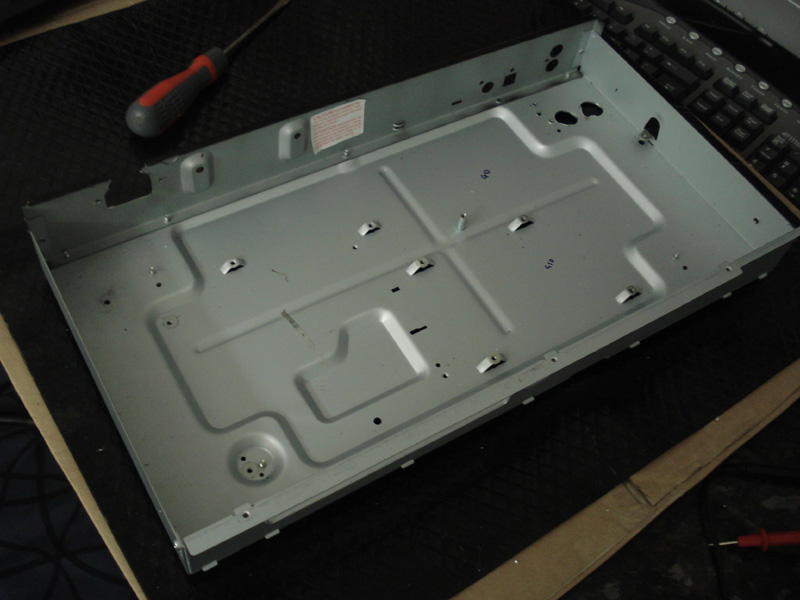

Pic #2: 1st bit of damping.
Pic #3: Putting it back together and hoping it still works.
Pic #4: LME49720HA's poke out the base.
Pic #5: Where's that bloody cap gone in the tidy mess?

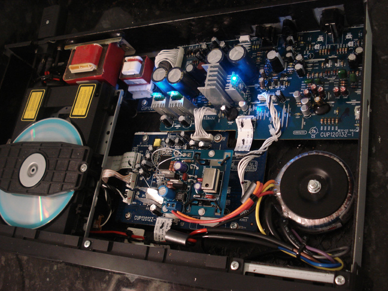

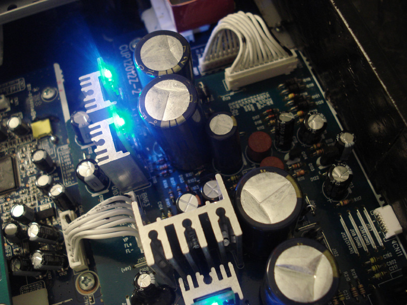

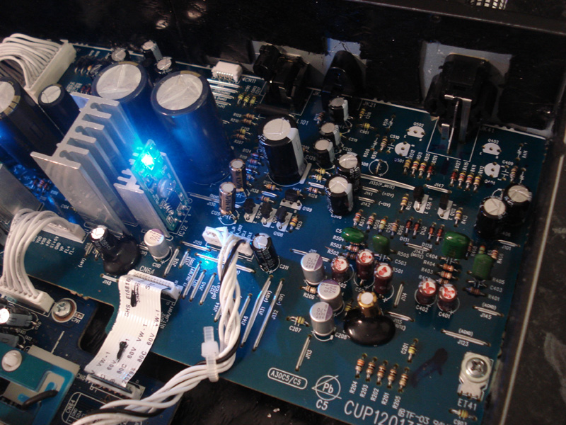

More photies!

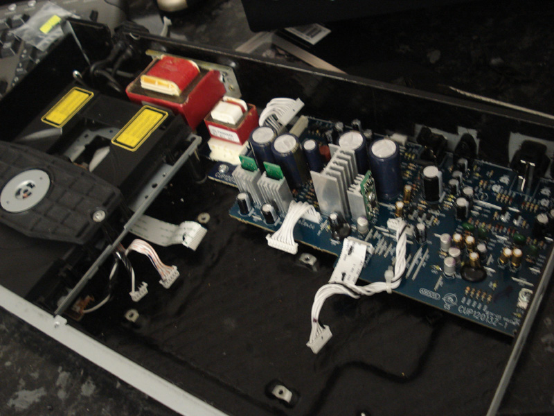

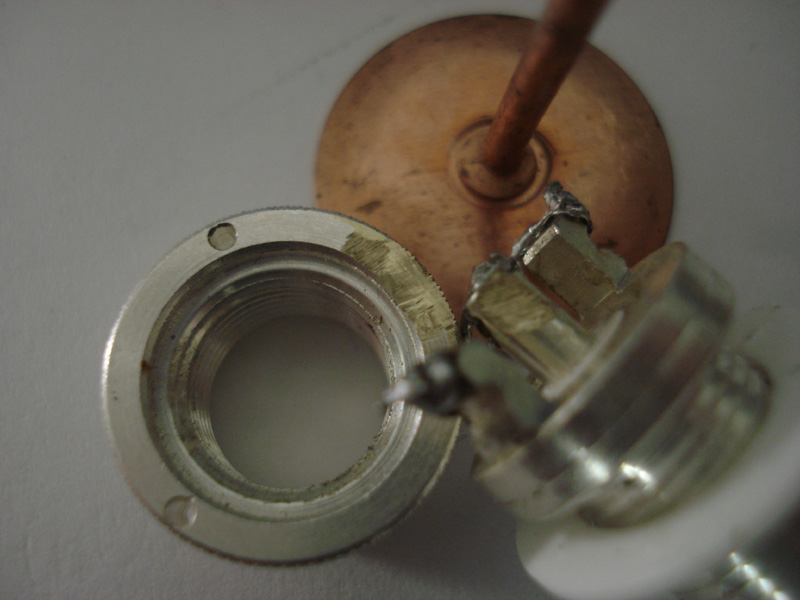

Pic #1: Fake 'pure copper' CMC's contain no copper, just brass!
Pic #2: Back together and it works well!
Pic #3: Output.

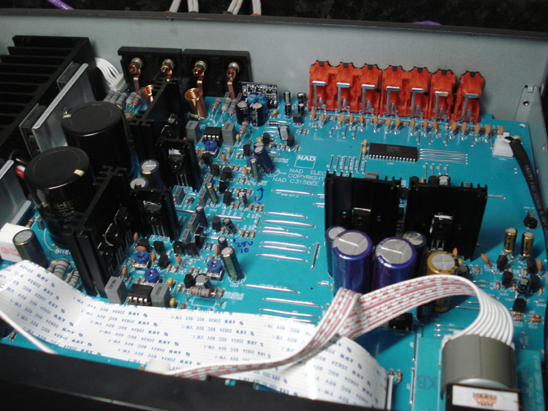

Pic #4. Main, opamp and digital Class D regs with Panny FC decoups.

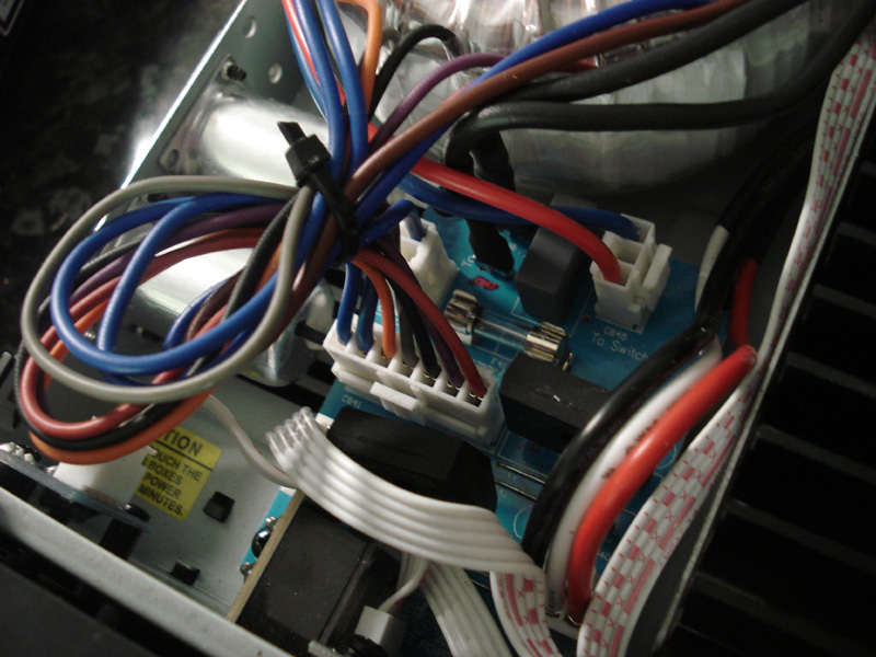

Pic #5. 230~12v trafo for clock (top right).

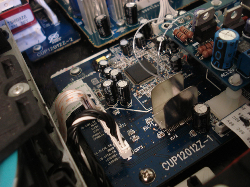

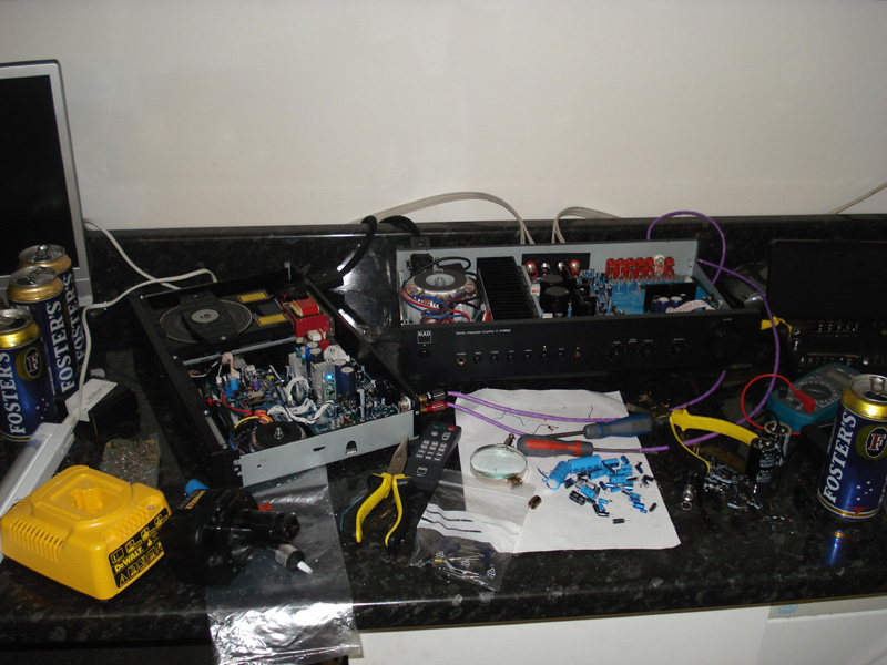

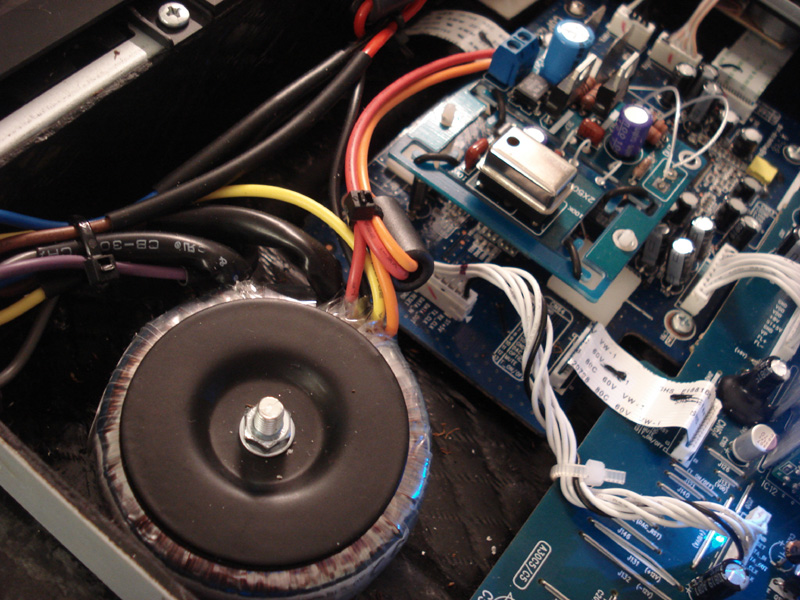

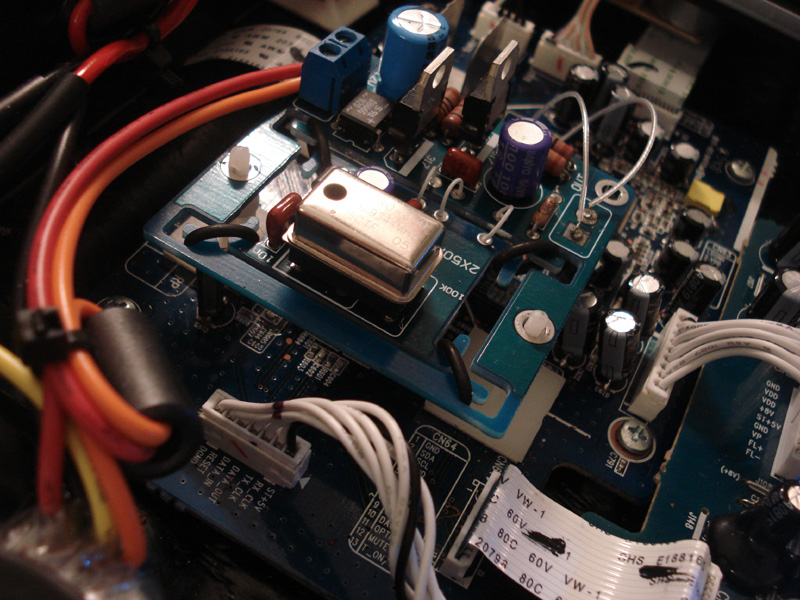

More 2!
Pic #1: Wu's clock.
Pic #2: Schurter in-line.
Pic #3:Tosh IC and Ruby ZA's.
Pic #4: More decoup, Panny FC's, Ruby ZA's & Nichicon MUSE.
Pic #5: Another 'too big for this chassis' opamp.

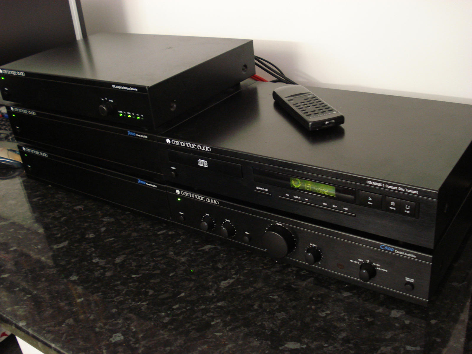

Do you like Cambridge?? I've got a CA system kicking about that you might be interested in seeing, or maybe not. Do you want me to post a pic??
What model/s?
EDIT: Thanks! Its taken a lot of effort so far.
I've got a whole collection of systems and components but I don't normally like to say what I own as some think I'm either bull shitting or boasting, but what the F***.
Primary CA system..........Discmagic, Dacmagic, C500 & 2 x P500's.
There's many, many more too
