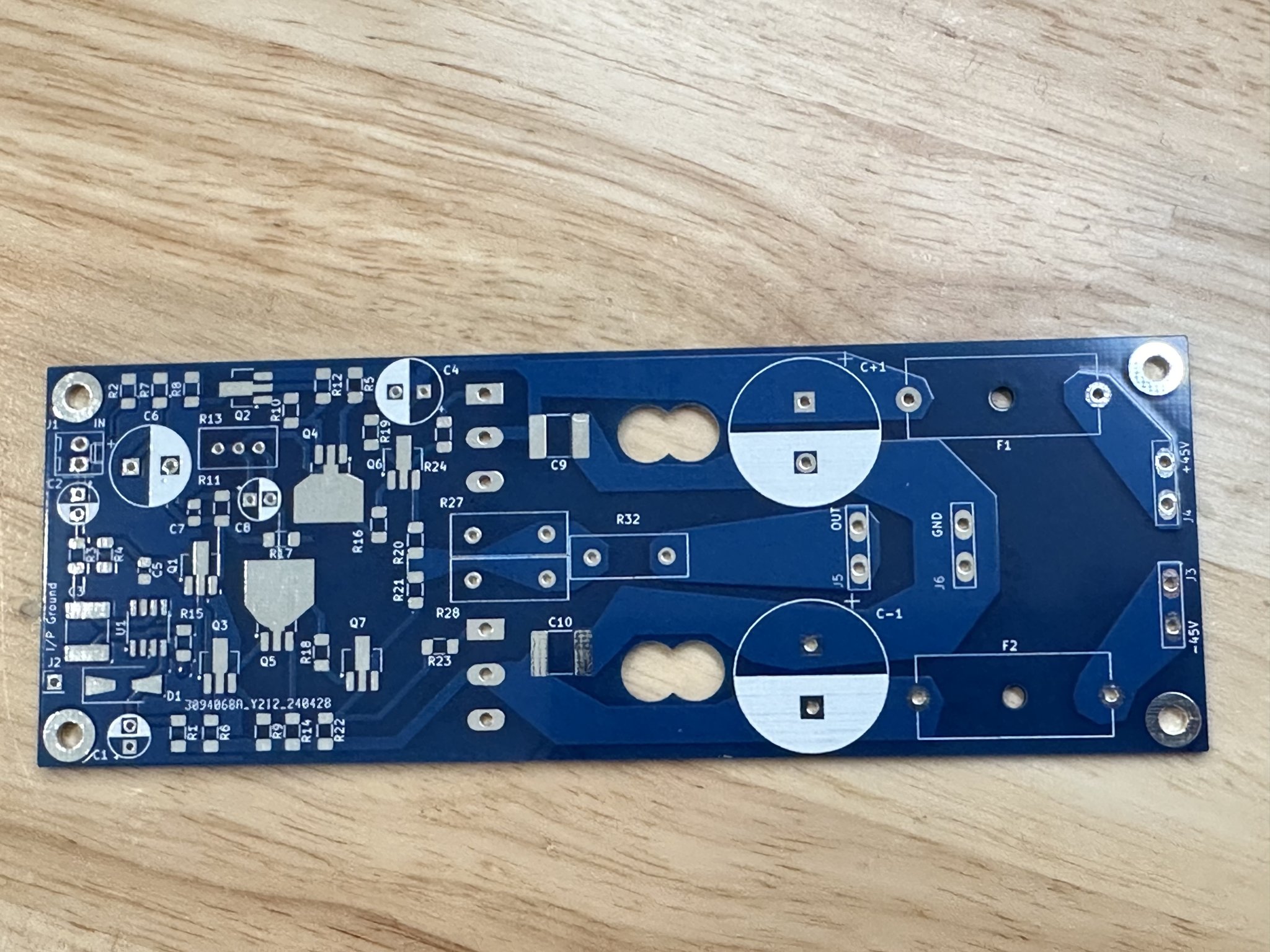

It's good for 3.2A. On single die devices, That's pretty much the same as the fuse you're likely to be using. Under normal use you won't pull anything like that. As you say, it isn't difficult to beef those traces up with solid copper wire.🙂@geoffw1,
It’s a good thing I use my amplifiers domestically, not foreign.
I could always add a p2p piece of solid core copper wire to “beef up” the traces.

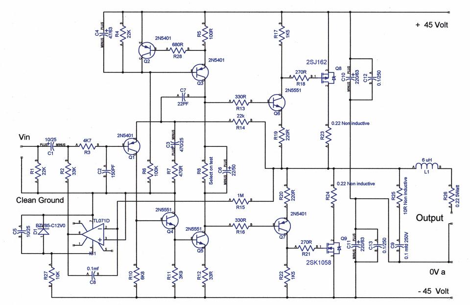

To confirm,
The inductor on the output is in series with the 0.22R resistor rather than in parallel with the inductor as one typically finds at the output of SS amplifiers?
If so I need to order some new pcbs....

Yes, but: there's another one with 10 ohms in parallel with the inductor. Do not omit that one! The single, series-0.22R may be omitted if you have the inductor//10R in place.The inductor on the output is in series with the 0.22R resistor rather than in parallel with the inductor as one typically finds at the output of SS amplifiers?
4.5H is fine. I did not bother measuring the inductance of my coils at all (they're probably much lower in value).

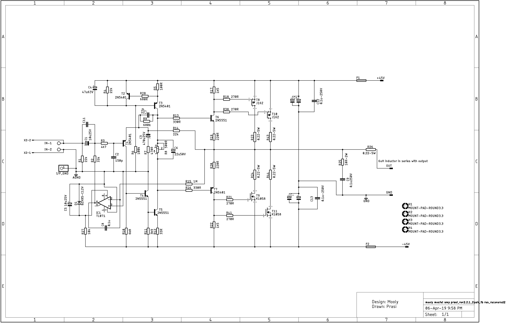

That is what I thought, however it isn't present in the schematic. Of course now I remembered that Mooly states this at the very start of post 1.....Yes, but: there's another one with 10 ohms in parallel with the inductor. Do not omit that one! The single, series-0.22R may be omitted if you have the inductor//10R in place.
I notice that in the schematic on the first post, the 0.22R resistor R26 is after the coil.
On the Prasi board R26 is before the coil.

Any of those are fine. Its a non critical part as long as you don't use a wire wound for that one.
The 0.22 ohm is a very deliberate part of the design and while it raises the output impedance slightly it also makes the main output node (the feedback take off) less susceptible to RF/HF/noise/hash ingress.

But if left out it won't compromise amplifier stability, unlike the 10R in parallel with the inductor.The 0.22 ohm is a very deliberate part of the design and while it raises the output impedance slightly it also makes the main output node (the feedback take off) less susceptible to RF/HF/noise/hash ingress.
Since the 0.22R is in series with the inductor, you may even place it (or ''bodge it'', whatever you prefer 😉 ) right at the speaker binding post.
The inductor makes the amp essentially 100% stable into any normal load, that's true enough. The 10 ohm damps the coil and reduces the ringing and overshoot that you see particularly when square wave testing.
The 0.22 alone (with no inductor present) is enough to isolate a load and preserve stability on this design. It really is one of the key components of the design that helps make it what it is.

Turns out, I am going to order the latest version boards. I made a dodo mistake and used the earlier Gerber version with part designation labels that don't match Mooly's original schematic. 🤪It's good for 3.2A. On single die devices, That's pretty much the same as the fuse you're likely to be using. Under normal use you won't pull anything like that. As you say, it isn't difficult to beef those traces up with solid copper wire.🙂

I've sourced all the parts together with the latest version board (with 2oz copper). Grand-dad duties are getting in the way of further progress for the moment plus its in a queue behind an update for my pre-amp (I need to implement a new front panel TFT display/controller in place of the current 4x20 LCD one).Turns out, I am going to order the latest version boards. I made a dodo mistake and used the earlier Gerber version with part designation labels that don't match Mooly's original schematic. 🤪

Startup procedure as given by Mooly:
"Hi Space,
Sounds like you are nearly there. I will be away most of tomorrow from about 8.30AM, so here are a few things to check.
First make sure the pot is set to zero ohms, not 470. It must read dead short from collector Q3 to collector Q5.
You need at least -/+ 20 volts or so even for testing, but with the outputs disconnected nothing will go pop.
1. Run it up without the FET's connected-- all 6 wires disconnected.
2. Confirm pin 7 of IC is connected to ground.
Confirm pin 4 is at -12 volts --- if you are using a low supply voltage you may need to drop R27 the 10 K feeding the zener to around 5K6 but only do this if the 12 Volts is low.
3. Confirm the output is at Zero volts to within a few millivolts.
4. Confirm that there is 0.6 to 0.7 volts across R5. This will show the current source Q2 and Q3 are working correctly.
5. If that is OK read on DC volts across R17. If you now adjust the pot the voltage across R17 will vary going from zero to perhaps 6 or 7 volts or so. The voltage across R22 should vary in the same way but the two readings will not be equal until the outputs are connected.
If all that is OK then all that remains is to connect the outputs but first set the pot back to ZERO again so there is no voltage across R17 and R22.
Refer to the picture I posted for the pin outs. The 2SJ162 is the top one connected to the positive rail. The 270 ohm gate resistors must go on the FET itself, not on the PCB. The source which is the middle leg goes to the positive rail. The drain goes to the 0.22 ohm.
Do the same for the 2SK1058. Again the middle leg goes to the negative rail and the drain to the other 0.22 ohm."
