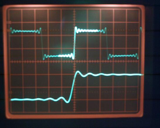

Although nothing to do with the amp design I have attached a shot of a 1 k h z squarewave as reproduced from CD. That kind of puts it into perspective really. Any player will reproduce this the same. Many many years ago Nelson Pass did some tests with slew rates off vinyl which is a system without the absolute bandwidth limitations of CD. I think I am correct in saying the figure was around 2 Volts / microsecond at 100 watts. (Hope I have got that figure correct Nelson 🙂 )
Personally I am not a great fan of super extended bandwidths for audio amps, much prefering to see a nicely tailored and controlled response with no "nasties" on squarewave testing.

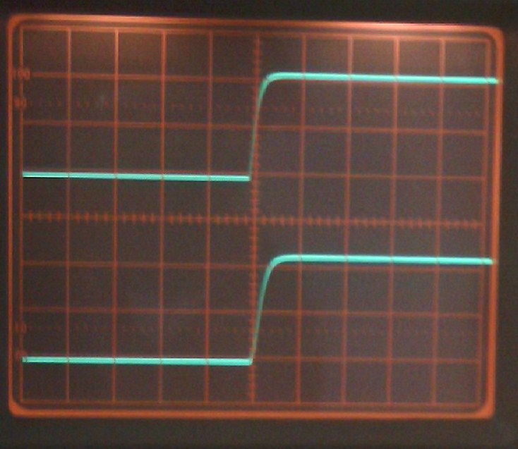

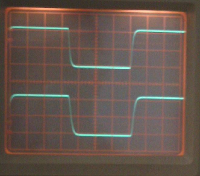

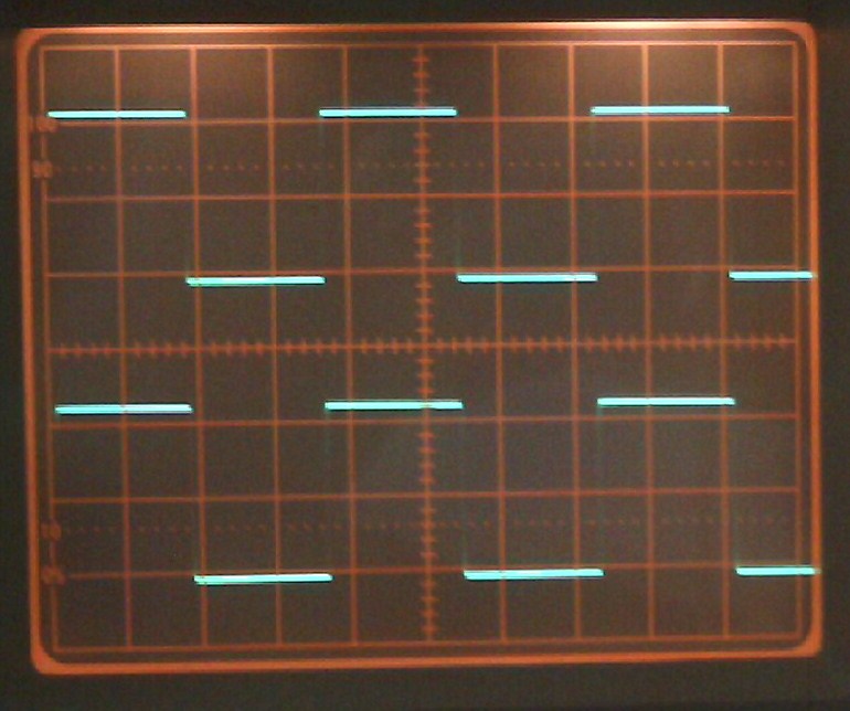

Hi Andrew,
Got the camera out, and took some real screen shots.
NOTE, The top trace is the input to the power amp but this signal has been through the preamp first ( it is an integrated amp after all ), where the preamp also has a "tailored response". The amp was delivering around 1.6 watts R.M.S. into 5 ohms.
I would suggest that anyone viewing these looks back at post #153 for a 1khz signal from CD which if that is what you use as a source is as good as it gets (meaning not very good compared to a function generator).
This shows the response at 1 Khz
