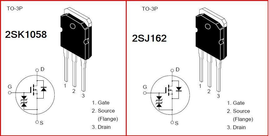

mooly, i think i need to mske sure for mosfets connection. here can't read properly too small font.
2sk1058 on the -v rail
G = goes to R21
D= goes to -v rail
S= goes to R24
2sj162 on the + rail
G = goes to R18
D= goes to +v rail
S= goes to R23
is this correct connection?
Hi Space,
That was quick 🙂 First things first. Before you switch on disconnect ALL 6 wires that go to the FET's. You can power it all up without these connected, make sure nothing is connected to the input and output lines.
Connections to the FET's. The 2SJ162 is the "top" one that goes to the positive rail. The SOURCE goes to the +45 volt rail and the DRAIN is the output that goes to the 0.22 ohm. The 2SK1058 is the "bottom" one and again DRAIN is the output and SOURCE to - 45 volts. The 270 ohms that go to the gates, these MUST be placed on the pins of the FET's VERY IMPORTANT. Also don't have all those wires twisted together keep them separate and short.
With the FET's NOT CONNECTED, power it up and check that the output is at ZERO volts DC. Check that there is 12 volts across pins 4 and 7 of the IC and that there is about 0.7 volts across R5 the 100 ohm. I can't see a preset (R8) in your picture. You MUST use a pot to begin with. If you have no pot then for now short it out, that is link collector Q5 and collector Q3. DONT use a fixed 470 ohm.

Refer to the picture I posted for the pin outs. The 2SJ162 is the top one connected to the positive rail. The 270 ohm gate resistors must go on the FET itself, not on the PCB. The source which is the middle leg goes to the positive rail. The drain goes to the 0.22 ohm.
Do the same for the 2SK1058. Again the middle leg goes to the negative rail and the drain to the other 0.22 ohm.
