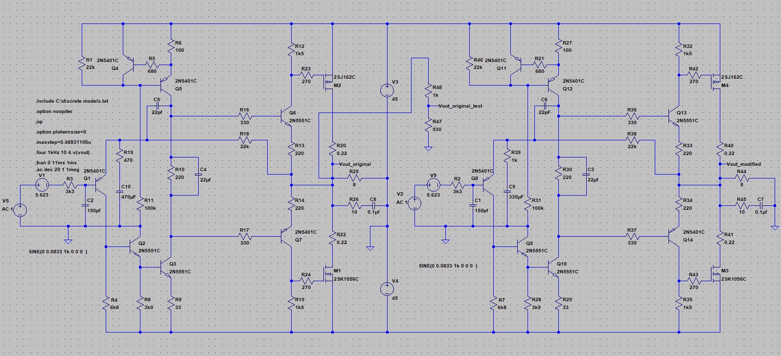

The only minor niggle I have with this amp is that the gain is about double the ideal for my system.
I usually use feedback values of 22K and 1K wherever possible to give a voltage gain of X23.
I am wondering if it would be OK to reduce R14 to 10K to give a gain of just over X22?
Trouble is, this doubles the feedback factor. I then thought of reducing R10 to 3K3 to keep roughly the same feedback factor, but I don't think this will work because it doubles Q1 collector current (to ~400uA) and therefore halves Re and restores the original gain :-(.
So, is there a good way to reduce the gain of this amp?
Dave,
You can judiciously insert local fb at the input and the VAS stages to hold the global fb at the same level as you decrease the closed loop gain.
Alternatively, you can put in nested fb from the VAS back to the fb node.
I will check out the circuit and then chat with Karl but this is all doable.
Hugh
Thanks for the interest guys.
The only realistic way to alter the AC gain would be via the feedback return resistor which is the 470 ohm (R7). Changing the 22k feedback resistor upsets the whole DC operating point, changes the current in Q1 and alters the operating point of the TL071 although that should be able to maintain the correct bias point.
So you can try increasing R7 to suit, however increasing R7 and leaving its series 470uF will increase the settling time of the amp and so really the cap should be changed (lowered in value) to maintain the same sort of time constant.
Untested changes are always to difficult to predict, the big question is whether you feel the tonality is altered by changing the feedback factor... interesting 🙂
Dave,
Try a 680k metal film from the collector of T3 back to the emitter of T1, that is, across C7.
That will set the global feedback at the ratio of 680k/22k = 31, which corresponds to 29.8dB of fixed global feedback for the original circuit.
Adding 120R emitter to Q1 would not do it here because this is a singleton, not a LTP. Increasing the 22k series fb resistor increases the closed loop gain and reduces global feedback, but you want to reduce the gain. So if you reduce the 22k to say 15k, I'd use a 470k nested fb resistor.
I mention all this because nested feedback has particular benefit and and I will leave it to you to find out what it is.......
Hugh
It will work very well with your reduced gain.
I think the additional emitter resistor on Q1 will work...
OLG of Q1 is set by R10 (6K8) / re (effective emitter resistance)
re ~=Ic/25mA i.e. 125 Ohms at 200uA
Adding an external 125R emitter resistor will halve the gain, and improve the linearity due to local feedback (probably by exactly the same amount as the global f/b would do if the gain was left as original).
Anyway, I like your nested feedback approach better!

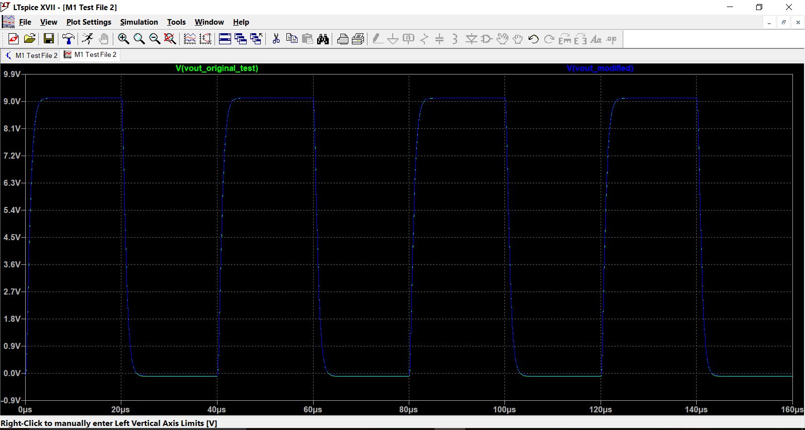

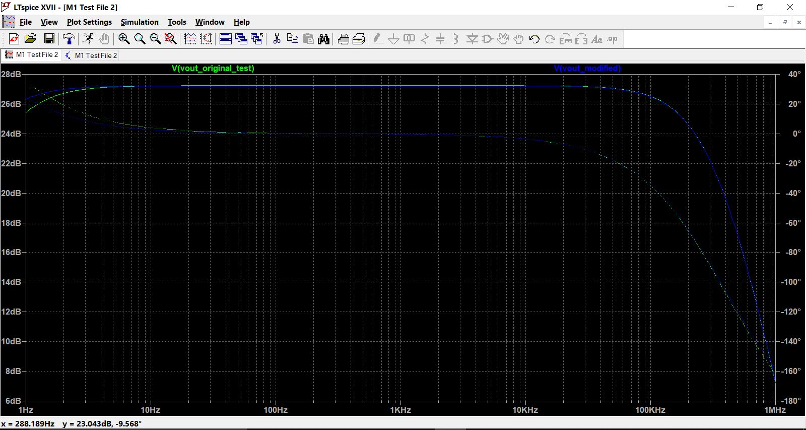

I had a little play with this in simulation, and (with the proviso that untested modifications can not be guaranteed) found the stability of the design such that it is pretty much unfazed by whatever you throw at it.
This shows the original and modded lower gain version done simply by raising the feedback return from 470 ohm to 1k and reducing the 470uF down to 330uF. The results speak for themselves. Even removing the input filter resulted in virtually no difference between the two versions.
I've attached the dual amp file so anyone can play around with this. The output of the original amp is taken from a resistive divider so that the two gains can be equalised and the traces overlaid for comparison.
