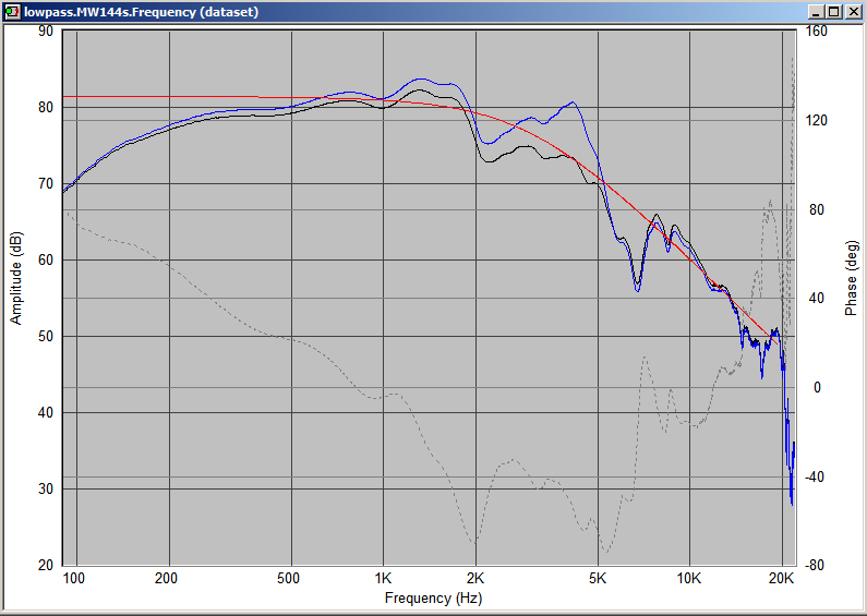

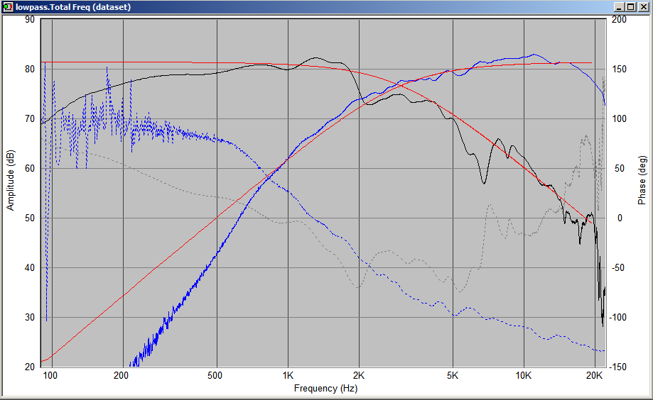

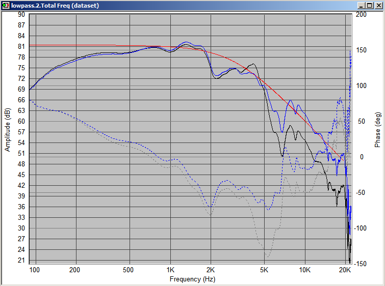

1st pic shows the current crossovers responses and the target (red) response.
2nd pic shows the low pass response compared to the actual woofer response.
3rd pic is the current low pass circuit. the tweeter circuit for the above is simply a 4.3uF cap nothing else.
4th pic is the comparison between the notch (blue) and a 220uH coil with 100m ohm series resistance.
having done the 2nd pic shows that the 4K notch considerably affects frequencies lower than the notch frequency!!
edit: I've just realised something else as well. I originally had two notch filters in the lowpass network, but removed one, I did not re-optimize after doing that! If I optimise the current low pass network I get quite different values and a quite different fit to the curve.
Tony.

Is the second plot just the woofer with the crossover removed from the circuit?
If not, do you have that plot?
I just want to isolate the problem.
yes second plot, blue trace is just the woofer, no crossover components. I'm off to bed now so will view in the morning 🙂

The problem here is that man. data shows a 5dB drop at 2K while the actual drop here is 8 - 10 dB. I have measured and used this driver many times and have never had this degree of a problem. The earlier incarnations on these speakers (posts 73, 74) were quite good. I think that the notch filters are stuffing things up.
Terry
Terry

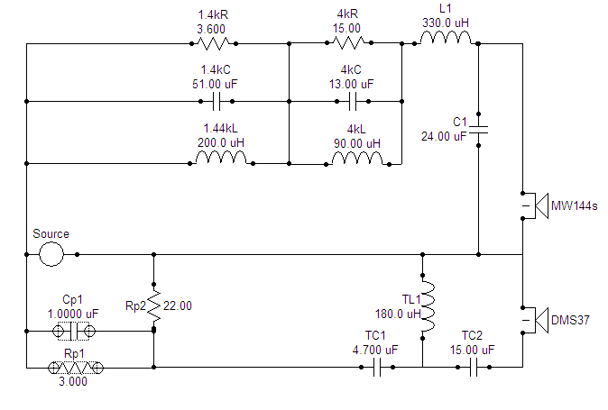

Tony, I was reading your comments on the other thread and thought I'd take a look. It seems you are dabbling in the cone breakup region here and the response you measure won't give the true picture owing to off axis and energy storage issues.
I'd like to make a suggestion. The woofers have a predictable small bump around 1k3 followed by a fall at 2k. Start your rolloff to drop the 1k3 bump and to exploit the 2k drop as part of the crossover. Get the driver down by 6dB before you hit 2k. Then make sure that from 3k onward is down as far as possible. This will operate your woofers where they should sound smooth and content.
I'm not sure how this will place your tweeters but this will need to be dealt with. Using the woofers to fill the hole will only bring issues. The woofers are already starting to become directional where I've sugested you cross, if you let them run higher it will additionally go all unpredictable in the breakup region.
Hi Allen, Thanks for the suggestion! I hadn't seen your comment until just this morning, Hopefully what I've just implemented is along those lines 🙂 I've only listened mono because I've only done one crossover so far. It sounds very smooth and even when I cranked it up I didn't hear any nastiness.

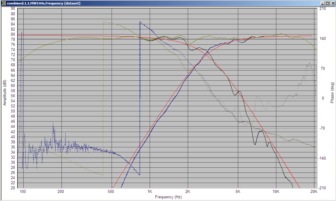

Picture of the final crossover is below. It is at 2.8Khz and is 4th order bessel acoustic slope. The off axis measurements I did before (with the original crossover) showed very consistent behaviour without any nastiness, so I'm doubtful it is breakup (4khz and up is though I think).
Also attached is the simmed response. Once I get a real measurement I guess I will know if it was truely successful 🙂
Tony..

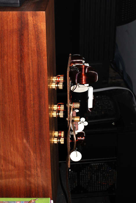

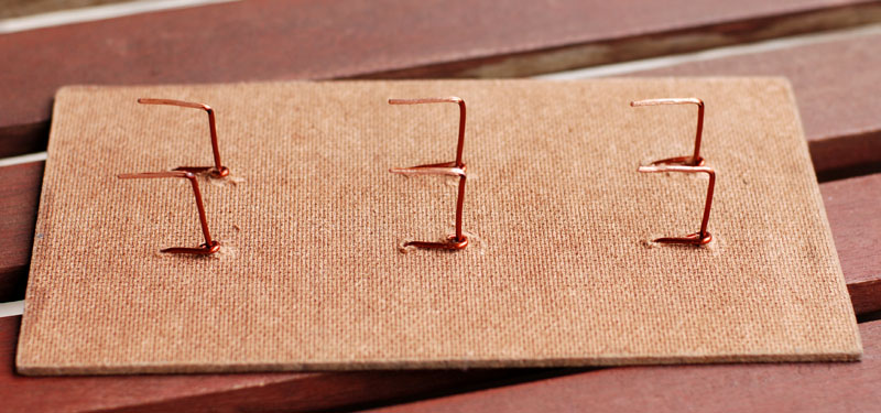

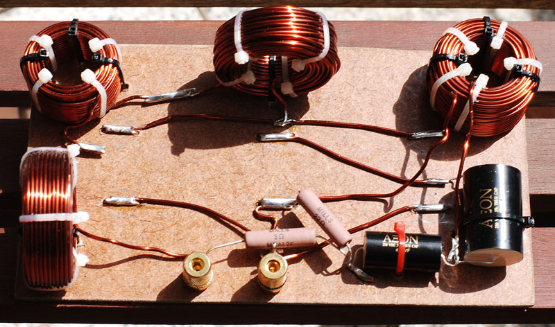

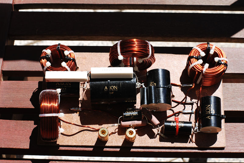

A few more images 🙂
1st pic shows the individual responses of the simmed crossover and how they fit to the target 4th order bessel at 2.8Khz. I'm particularly pleased with the phase tracking through the crossover region, and spent quite a bit of time fiddling in the simulation to get it so.
2nd pic is sim for the old crossover which was nominally 2nd order bessel at 3Khz.
third pic shows my mounting solution for the crossover 🙂
fourth pic shows partially completed crossover board. Yes I made the coils myself....
fith pic shows the completed board.
and sixth pic shows it mounted on the back of the speaker.
Note I had great faith in the sim, in that I built the board without first doing a mockup. At this stage I'm not disapointed, but won't know the full story till I've done the second one.
Tony.

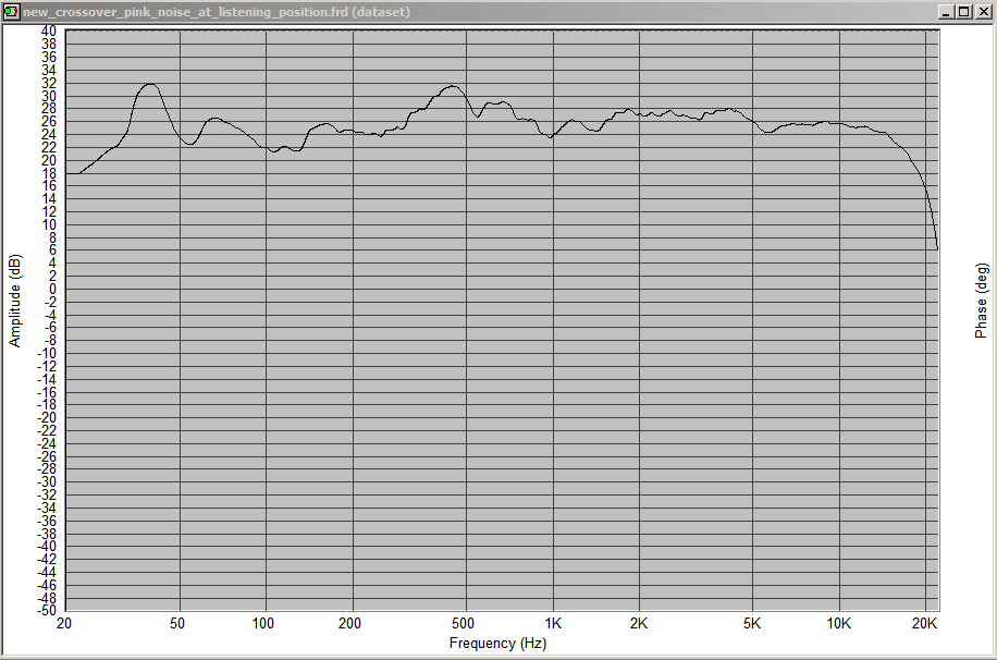

I've attached in room response of one speaker at the listening position. This one measured with REW in RTA mode with pink noise. The big spike at 38 Hz is interesting!! Not too bad considering the room has no treatments of any kind. It's been 1/3 octave smoothed. Definitely quite a bit of room gain, as the output below 100Hz is not that much, the box resonance is around 90Hz.
Tony.

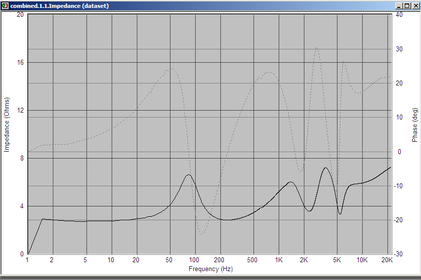

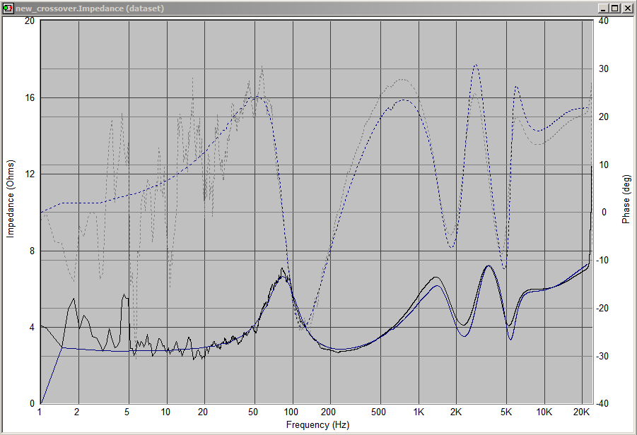

Here is a sim vs actual for the impedance of the speaker. No gated acoustic measurements as yet, might be a while before I can set up for that.
Note I didn't reboot, and fiddle with the sound card settings to get the real measurement (black) hence it is a bit ragged (and that is 1/8th octave smoothed) It should be smoother than that. The sim is based on original 1/8th octave smoothed measurements of the woofers and tweeter impedances separately.
I think the correlation is not bad, dips and peaks are a bit off in the sim.
Tony.
Nice correlation. By the way, did you include the DCRs on the simmed inductors? Only reason I ask is because I found out that when I changed inductor values in SW it scaled the DCRs. After a few changes this produced some excessive values which I sometimes failed to notice at first, and found a nuisance so I stopped doing it this way and used discrete resistors. Could also mention ESR on the Cs.
Hi Allen I did put in the DCR of the coils, though I should double check it. I didn't put in ESR of the caps, I should probably do that. It will be low but still will probably have an influence. The ability to do DCR on the coils was one of the reasons I preferred SW to PCD, which you can only specify DCR on coils in the main crossover and not on ones used for notches.
Tony.

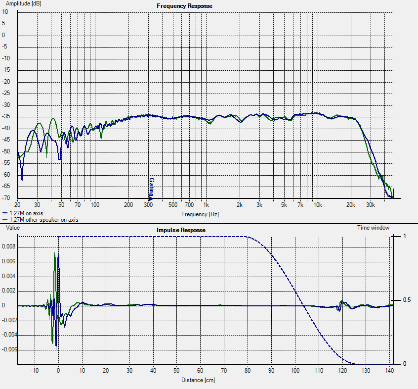

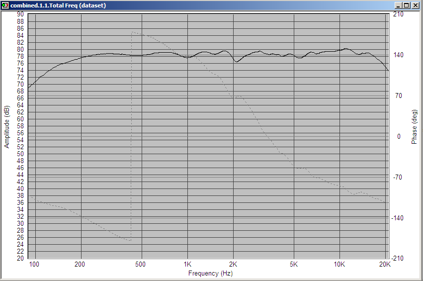

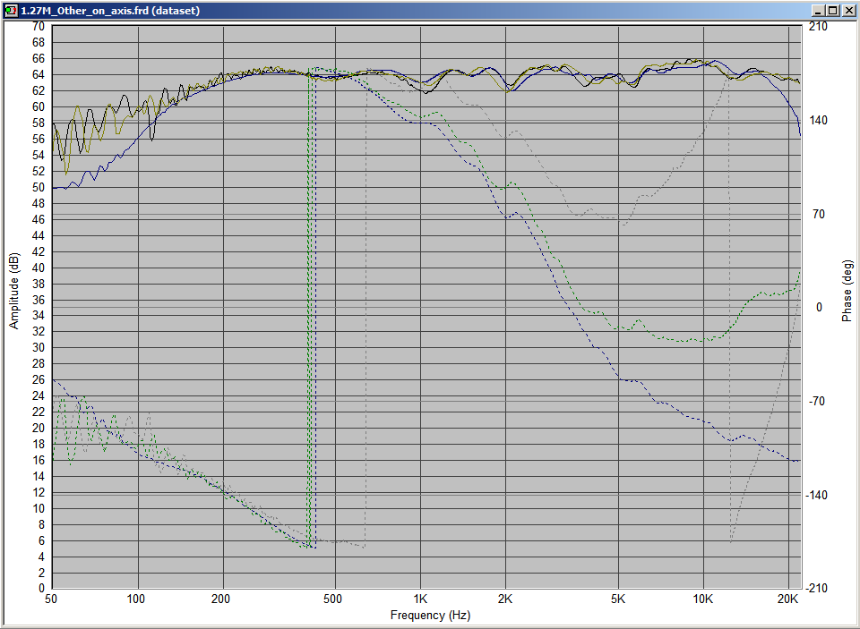

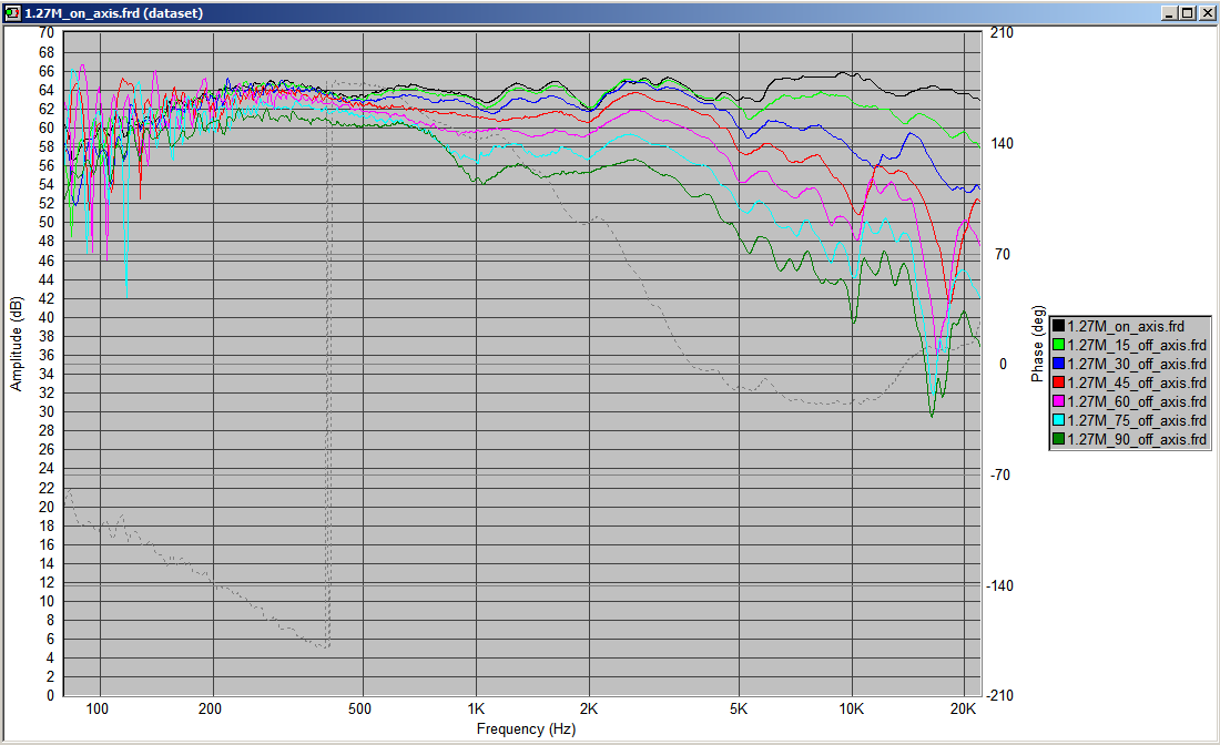

OK time for an update 😀
My parents came to visit a week ago and I sat them down and played Ella and Louis (the whole album) and then, "Private Investigations" off Love over Gold.
They had both heard the previous incarnation, to which they had said they sound nice, but that was about it. This time my mum said. "you've nailed it" They are so clear, and all the instruments are well defined and not mushed together" She also said that the balance was very good (she had previously commented that they were a bit shy in the lower frequencies, which was backed up by the objective measurements.
I've also been very happy, and yesterday I built a new speaker testing stand http://www.diyaudio.com/forums/equi...w-cost-speaker-testing-stand.html#post2776334 and did the obligatory objective measurements.
Below the first image is the holm impulse measurement for comparison between the left and right speakers. The measurement was taken at approx 1.3M as can be seen from the impulse response I didn't have the second speaker in exactly the same location as the first.
The second image shows the on axis and every 15 degrees off axis through 90deg for one speaker.
The third shows the simulated result that I showed before (blue) and the actual measurements Black and Green) I only did quick measurements this time, and I think there is something suspect with the phase, but it's not a bad match for the original sim, especially considering the measurement has been taken using a different stand in a different location and at a different distance 😉
Anyway at this point I'm very happy, and need to get on with the active crossover for the bass units so I can cut them in at around 300Hz.
Tony.
