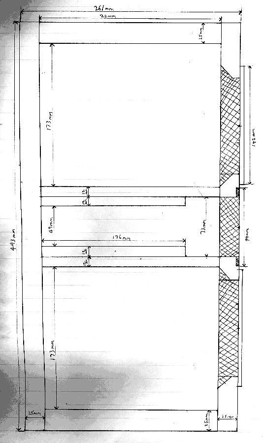

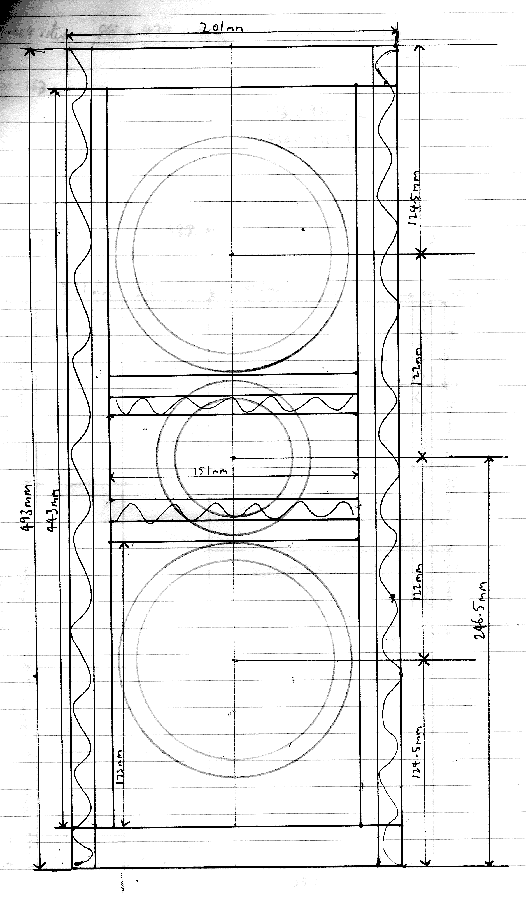

Just another Moderator
Joined 2003
Ok here is the second cabinet drawing. I actually changed the positioning of the woofers slightly the dimention showing the distance between the center of the tweeter and the center of the woofer is 122mm which allowed for 4mm between the edge of the woofer and the edge of the tweeter, I cut it to 120mm giving a 2mm distance between the edges of the drivers.
I decided to not offset the drivers due to stuff I read on Duntechs web site on what this does to the dispersion of the sound. After simulating in BDS I decided I could live with the extra ripple that I'd get, and thought I could try the felt trick to reduce diffraction effects, I do plan on chamfering the edges of the baffles.
Also not shown in the plans is corner bracing, I put quarter round in some of the corners, this was a last minute decision and could have been done much better (mitering etc) but it adds some strength :) I also glued a 25mm square MDM block along the front baffle below (or above) the drivers, I've since decided this was not such a good idea, and have cut it back somewhat with the dremel ;)

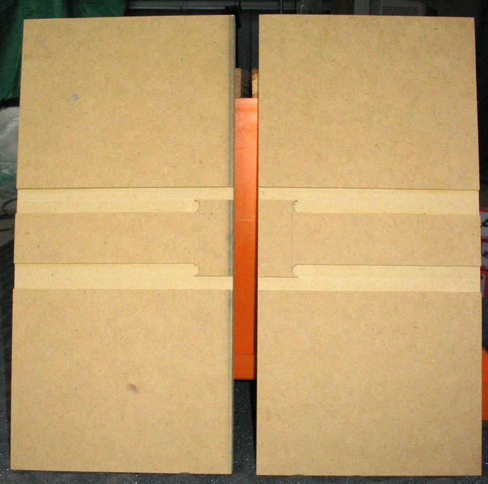

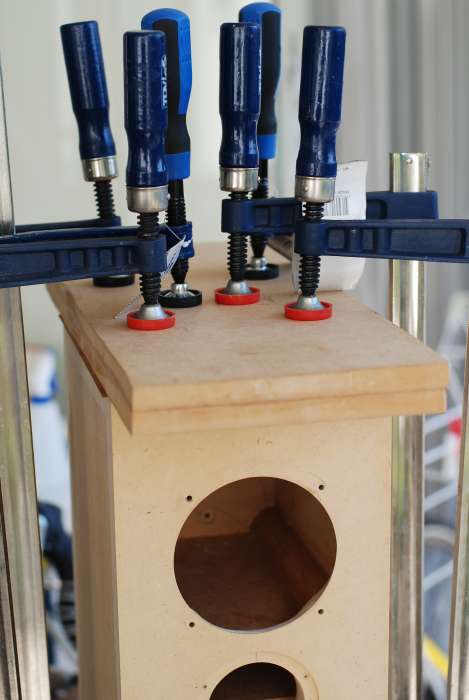

Joined 2003

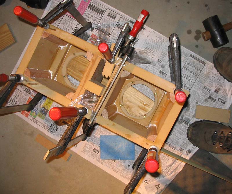

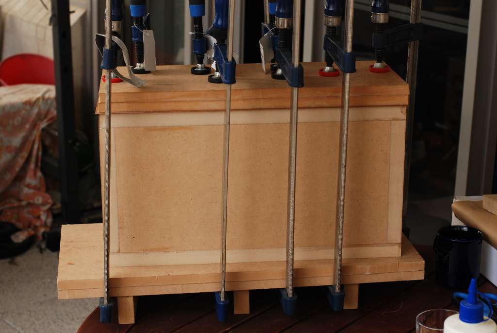

OK and one post to show I actually have built something ;)
The partitions between the midbass' and tweeter are made from two sheets of 12mm MDF laminated together. The reason I did this was so I could get the MW144's close to the tweeters without being too close to the edge of the partition. By using two pieces of 12mm MDF I could make the tweeter side peice a bit shorter and hae room for the tweeters basket, the partitions also serve the purpose of bracing, and allowed me to use golden ratio (one of not the) dimentions for the midbass enclosures dimentions.... funny thing that, I actually decided to make it using all prime numbers, when I did a search to find out whether this was a standard practice, I discovered that my particular primes were one of the acoustic golden ratios :)
I actually did all of the gluing in one go for what you see in this pic... was quite frantic, and I was sweating quite a lot by the time I finished, probably took an hour from start to finish...
This was the box that I remembered to drill the holes for the speakers, and insert my hex nuts into before I glued it together ;)
Tony.

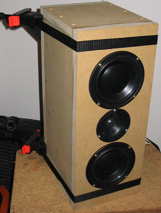

Joined 2003
and the current status
just to be complete I thought I better post a pic of what it looks like at the moment......
the straps you see are holding the rear baffle on.... I haven't glued it on yet as I'm not yet 100% happy with my driver fixing bolts and nuts... I've been doing tests with not 100% sealed boxes, but the tests I've done have been promising. Will hopefully get the bolts sorted soon, and then glue the backs on, and start applying the veneer, and finally champher the front baffle.
Then the serious tests for the crossover design can begin!!
Tony.

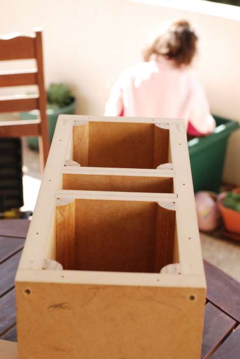

Joined 2003
Oh and another thing that deviates from the plan, I rebated the sides where the partitions fit in. Not really visible in the pic that I posted of it being glued together.
the rebate itself is only about 3mm deep, but it made it much easier to slide the internal baffles in and make sure they were straight!! My prototype box I just but jointed them and getting them square was a real pain. Had some problems with the fence on the Triton workbench not being 100% square which resulted in about .5mm difference front to back (between the two sides) but it wasn't enough to cause any problem.

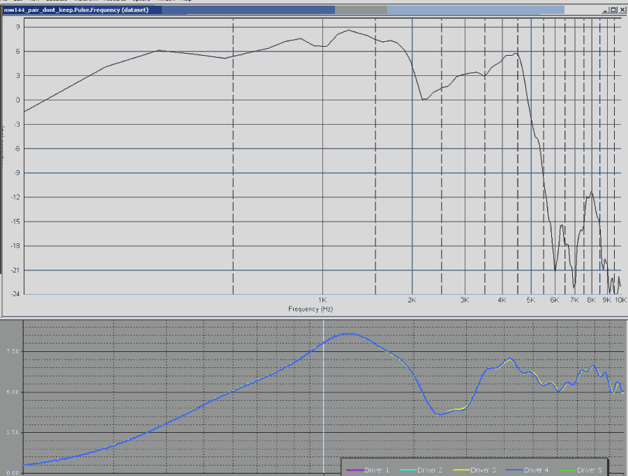

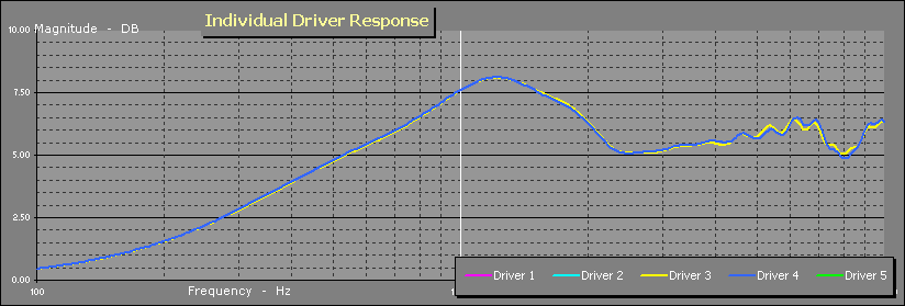

Yesterday for whatever reason (procrastination??) I decided to revisit my BDS sims as I had never been that happy that my measured response seemed to agree with the simulated baffle diffraction response.
What I found by accident was that when I used the lowest complexity source (ie point source) but still used quadruple sampling, I did infact get what appears to correlate with my measured response. The magnitude is different, but I think this is driver related, but there is a definite (I belive) correlation between the sim and the measured result. Note that the scales aren't the same, but by skewing them like this it is easier to see a correlation. The thing I'm happy about is that when I sim with a 22mm chamfer (the size I'm probably going to use) the response flattens out significantly, how much this will help in the real world I guess I'll have to wait an see :)
attached sim and actual measured (gated) repsonse of the woofers.
so at least with this project it appears that the best model to use for the drivers is the point source one!! Interestingly the tweeters seem to match more closely when using the combined source model, I would have thought the tweeters would be closer to a point source than the woofers :rolleyes:

I'm using BDS (Baffle diffraction simulator) for the sim graphs I posted, for the actual modeling of the enclosure I used unibox. Both are excel spreadsheet based, which unfortunately rules some people out.
BDS here ---> http://www.pvconsultants.com/audio/diffraction/downloadbds.htm
Unibox here ---> http://home20.inet.tele.dk/kou/ubmodel.html
there is a lot of good stuff on the FRD consortium page ---> http://www.pvconsultants.com/audio/frdgroup.htm where I found both of these modelers :)
The magnitude of the difference between the simmed and the actual is quite a bit different (unfortunately worse in the real measurements) but the shape of the curve is quite similar, too similar me thinks to be a coincidence :)

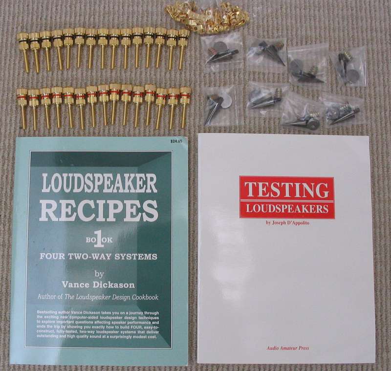

Well my order from from Brass and Granite audio just turned up :) very happy!!
appart from the need to go out and buy a router and some bits (as my Dad's is 7 hours drive away) I don't think I have any excuses left!! (oh and I need to go get my M4 Button heads which should have come in today too :)
as you can see from the pic I bought a few extra terminals (though I will be using 6 pairs on these MTM's I'll have enough for the Woofers too, a center and two rear effects speakers if I ever get around to doing a full HT setup... thought I might as well get the most of my shipping $
Glad I didn't glue the backs on before getting the terminals, they have 30mm shafts so I will need to countersink the inside of the shaft hole to take the first nut.... I'll have to be very carefull on the depth too... hmmmm I'll need to think about that one, as I don't have a drill press... might be time to get the cheapy one from bunnings that you can mount a handheld drill in.

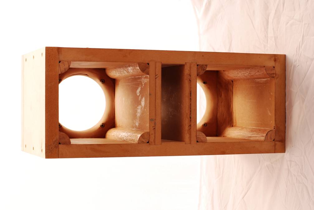

Joined 2003
Well It has been nearly four years, but I decided it was time for an update ;) I pretty much did nothing at all on my speaker project from The last post, Nov 2005 until probably about 6 months ago.
I thought that I needed to veneer the back bafle before I glued it on due to the tightness of the tweeter compartment and the feeling I could not connect the speaker terminals after the box was glued together, My veneer after being rolled up for nearly 4 years was rather curly when I cut it. I tried to flatten it but failed, finally tried a different approach (spraying with 90% water 10% glycerine and clamping for a few days) and it flattened out nicely. However I decided to try mounting the terminals with the backs clamped in place and found I could do it with no problem. The thing that prompted me to do this was the worry the baffles would warp after veneering if they weren't already attached to the box.
Anyway aside from all that I had never been happy with the dirver cutouts, or the fit for the rear baffle. I decided to attack the chamfers on the driver cutouts with a tungsten carbide tip on the dremel, and now have much nicer flares on the inside of my front baffles. After a lot of sanding (only one box so far) I got the rear of the box so that when the baffle was sitting on it there was virtually no differences (few thou at most), I was happy enough with it and this afternoon glued the rear baffle onto the one box that has been completed.
Tonight I also soldered on the connectors for the internal wiring for one box (just the two cables for the woofers, I'd already done the tweeter cables for both boxes.
I've attached a few photos of recent activity, showing the old flares and the new ones, and also my makeshift sanding block ;)
Also the shot showing the original flare, if you look on the left you will see another mod I made that wasn't on the original plan. I put some extra blocks in, in the tweeter compartment which are on the sides and glued to the font baffle.
Tony.

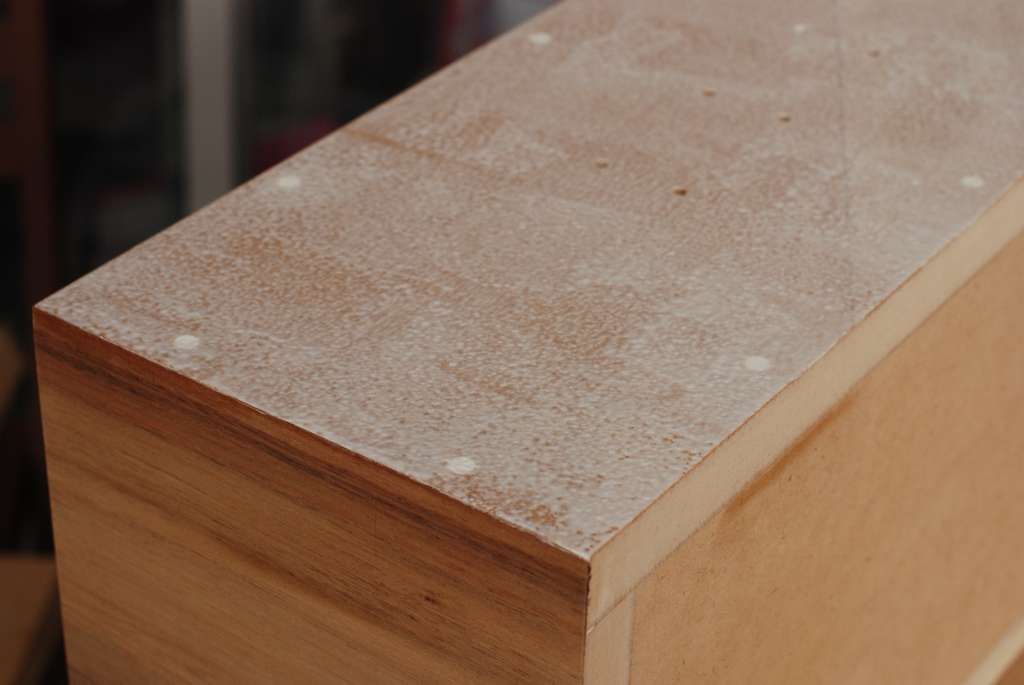

Joined 2003

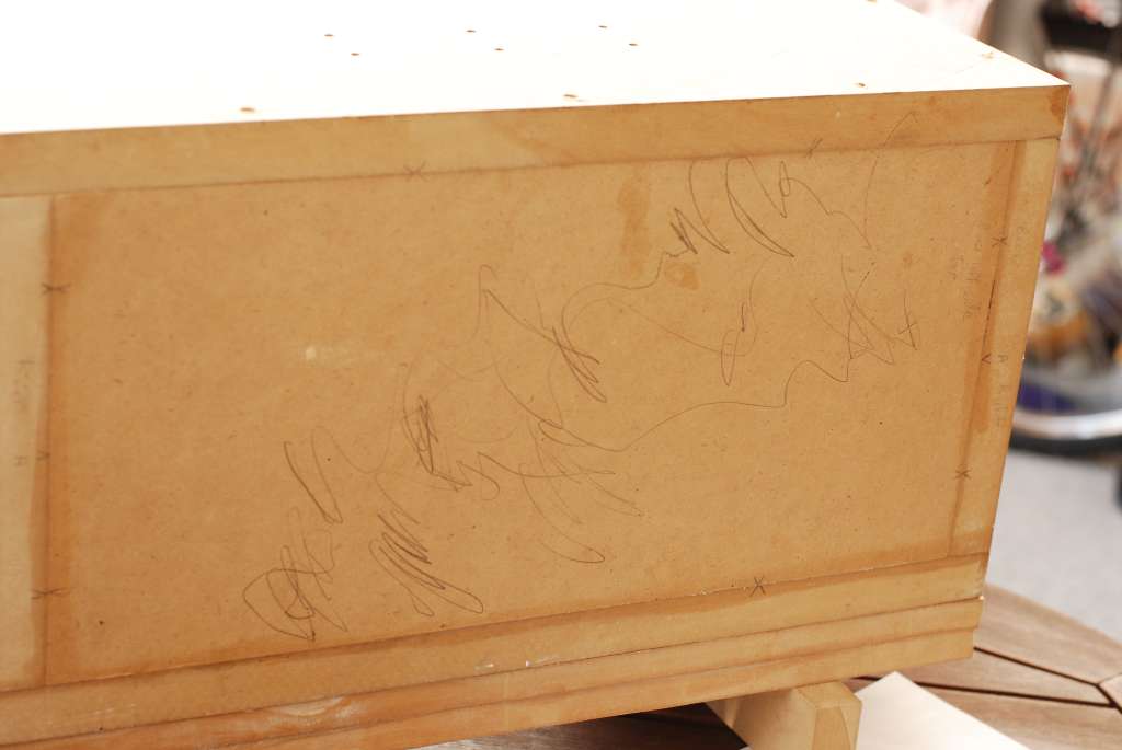

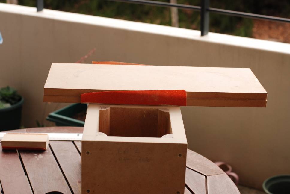

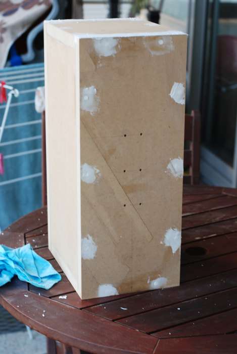

OK Well I have made some progress since the last post. I have done a LOT of sanding since then. Glued the rear baffles on. More sanding, Filling, more sanding, and today I have decided to take the plunge and try putting the first peice of veneer on.
I'm doing it on the bottom of one of the cabinets. I originally wasn't even going to bother veneering the bottoms, but decided that A) it would mean that it was properly sealed on the bottom, and B) it was a good place for my first attempt, as if I completely screw it up then at least it isn't visible ;)
The first problem was that the front baffles were around 1mm to short (as mentioned earlier in the thread, I tried building up with filler but it hasn't worked particularly well, and I'm going to be chamfering the front baffles any way so decided to just go ahead anyway and forget about the front bit ;) Chances are this is more likely to be an unmittigated disater than a complete success ;)
I noticed last weekend when sanding, that the sides of my cabinets have small dips in the middles of the pannels.. I'd really like to have them dead flat, but I just don't know if I can do that much sanding :( , and after my dodgy filling I don't think filler is an option, but I'll probably regret it if I don't so I suspect there is more sanding to go before I takle the veneering of the main parts of the cabinet.
Anyway here are some more photos of the progress.
The 1st shows that a speaker box is an attractive drawing surface for a 21 month old ;) the second is the back of the box after a LOT of sanding almost perfectly flat and ready for gluing the baffle on. Said 21 month old can be seen in the background playing with the dirt in the potplant... Third shows dodgy attempt at filling the area where the baffle is uneven. fourth more filling (I screwed the second baffle after a nightmare of a time getting the first one lined up. Thanks To AndrewT for reminding me of the value of screwing and gluing. and finally the fifth one shows my efforts today. No glue seepage which is good in one respect as their won't be contamination of the other veneer if there is no seepage when I get to it, but bad in another as I'm not sure if I have used enough glue! I guess time will tell!
Tony.

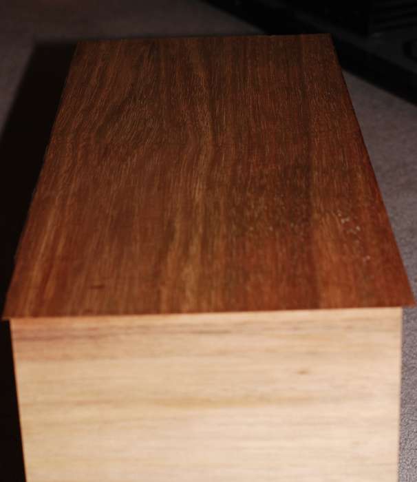

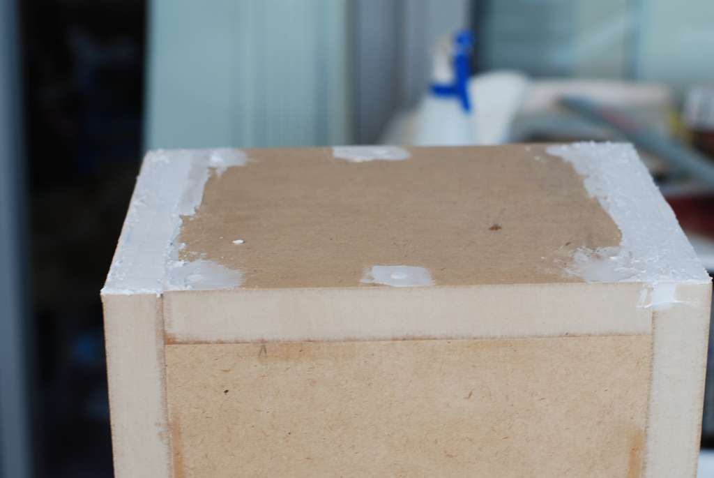

Joined 2003
Well that went better than it could have ;)
Veneer seems to have stuck solid. No bubbles it even seems to have stuck down at the ends where it rolls over a little (I find it it is very hard getting a completely flat sanded surface, always seems to round off at the edges somewhat).
I went to do the second box and discovered to my horror that the top of it had a really deep (I assume sanding) gouge in it :( so I once again got out the filler and filled it up. Though I took a different approach this time. Rather than using the spatular and over filling and sanding down hoping it would be flat, I ran the straight edge over it and it pretty much took away all the filler it didn't need and left what it did.. heres hoping anyway. So the second box is now going to have to wait till next weekend, as this filler takes 48hours to properly cure.
Pic attached of the result.. Will trim once the glue has had 24 hours to cure.
I used Bostic MDF glue slightly thinned with a little filtered water and applied with a small foam paint roller. I then placed the piece of veneer on the surface, smoothed it out with my hands, and then rolled with a wooden rolling pin. finally put the caul on and clamped for about two hours. I'll try trimming it with my veneer trimming bit and router... hope that goes ok!!
fist pic is the other piece of MDF for the bottom of the second cabinet, not 100% flat, but very malleable after treating with 90% water and 10% glycerine, and flattening for a couple of weeks. The second is the first box with veneer attached, showing clearly the rounding on the ends :( Oh well at leat it won't be a problem at the front once I chamfer the baffle :) also note the first is probably a better indication of colour. Was taken in full sun, the second was in the shade after a lot of smoke from a bush fire came along.
Tony.

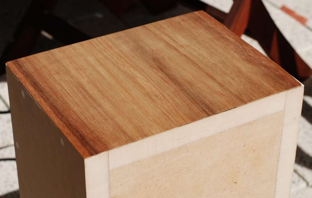

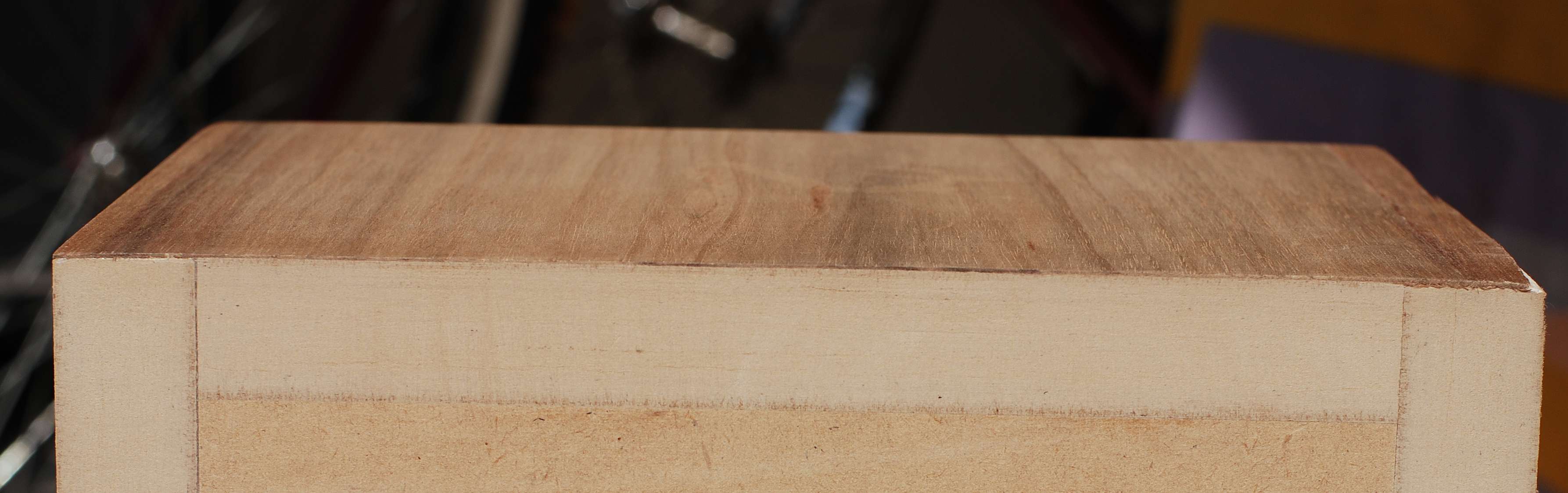

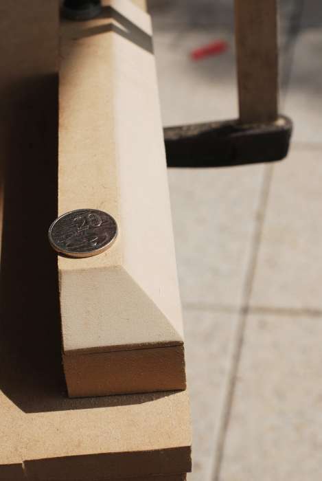

Joined 2003
slowly making progress :)

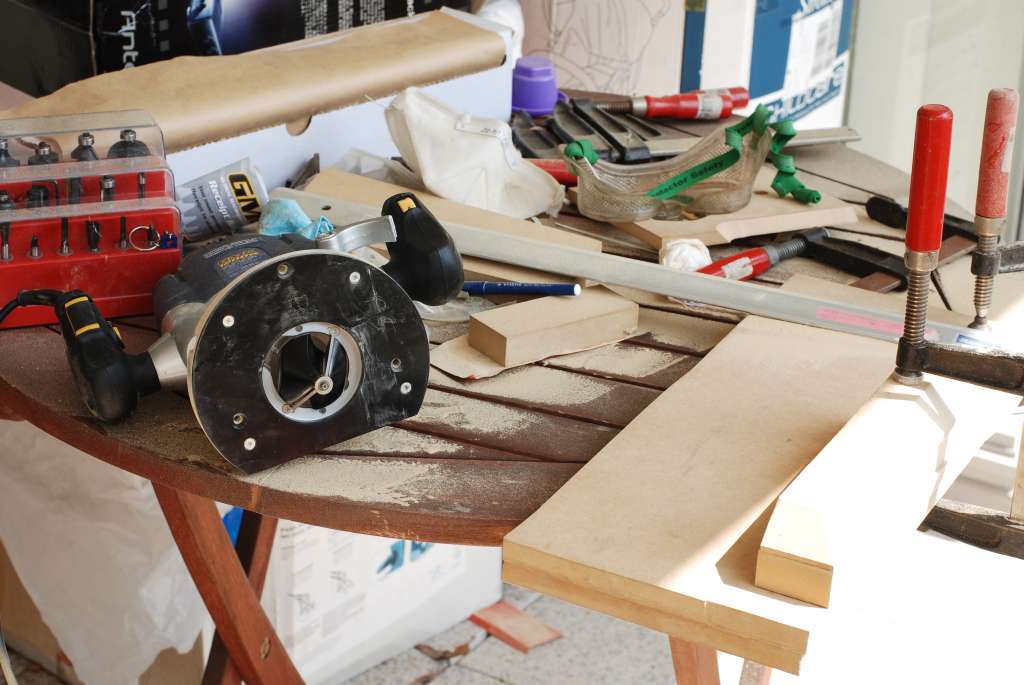

Well I decided to get out the router and use the veneer trimming bit today (note I have never done any of this before so it is a learning experience) :) It worked very nicely along the grain, but I was a bit concerned with the result at first when trimming accross the grain... ended up looking very splintery and rough, but a quick go with some 220grit glass paper and a sanding block cleaned it up very nicely and all was well.
One very important thing I discovered was not to have the speed on the router set too fast! I have a variable speed router and it seems that speed setting two is about right. One was too slow and above three starts to burn the edge of the veneer (as can be seen in the attached photo).
Since I had the router out I decided to do a test with my chamfering bit (it is a huge one, 1/2" drive gives a 22mm chamfer (that is in 22mm and down 22mm not the distance along the chamfer). I got it for Christmas 4 years ago and till now has never been used. Again some important aspects. It worked best on about speed setting three. Additionally the direction of travel of the router is critical, it must be moving so that the leading edge of the bit is not biting in (this is quite possibly why I had the problem accross the grain with the veneer so will try this on the next bottom piece), if so it gets a very jerky and uneven cut. effectively cutting with the trailing edge is required.. Using a piece of scrap to work out which way works is mandatory! :) again attached is a pic of the piece of scrap which I sanded lightly with 220 grit glass paper after finishing the cut. I think the result when applied to the baffle will be quite acceptable :)
The veneer split somewhat on the font when I trimmed it, but this did not suprise me in the slightest (as previously mentioned this edge had been built up with filler and still wasn't flat). As the chamfer will be 22mm back, almost all of the problem area will be cut away anyway so I'm not concerned.
Tony.

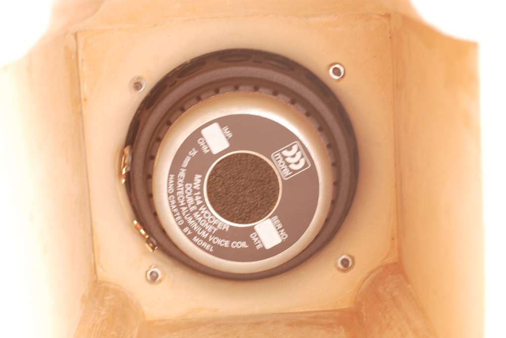

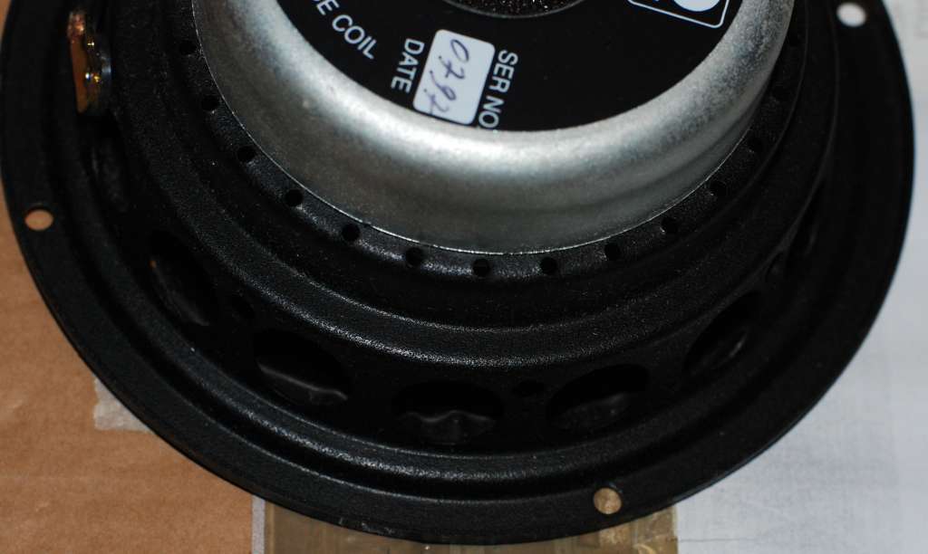

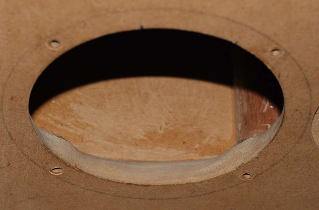

Joined 2003

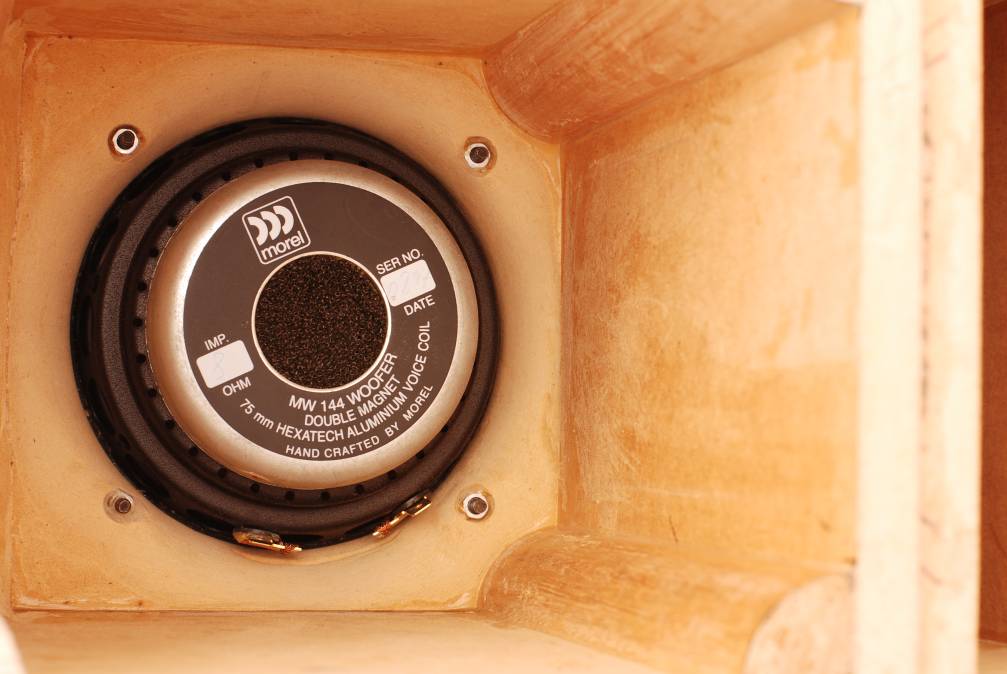

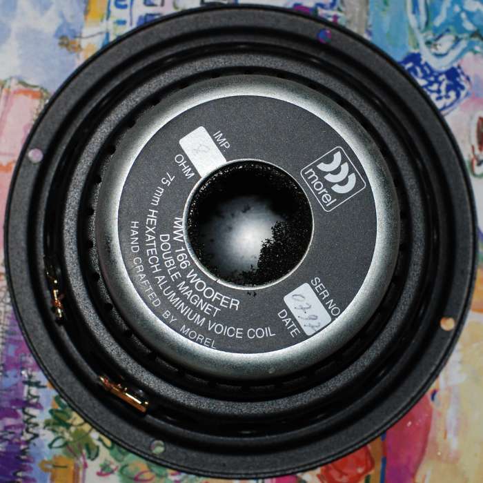

Hi Terry, ummm yeah it probably is... This was something I was concerned about originally even with my prototype but these drivers have strange flanges that I hadn't encountered before and I really wasn't sure how to deal with them. The only way I could see that I could get a seal on them was to use the flange on the inner edge right next to the basket.
I've attached a bunch of photos here which show the woofer (note it really is an MW144 it is mis-labled!) The drivers did not come with gaskets (from memory Terry Paget (Aus distributer told me he uses silicon, I'd have to go back through the emails it was a long time ago!).
SO probably I should have a thick narrow gasket just in the channel where the screws are, and my cutout should only be that wide (it did worry me that only the very thin rim of the basket would be in contact with the baffle if I did this)... That was what I thought originally, but I'm pretty sure TP told me to use the inner surface for the seal, could be wrong though, I'll have to find the emails...
If that is the case All is not lost, I can draw another circle as an absolute limit where to cut to and probably just dremel out to that. Some 6mm thick neoprene carefully cut would probably suffice for a gasget.
Thanks,
Tony.

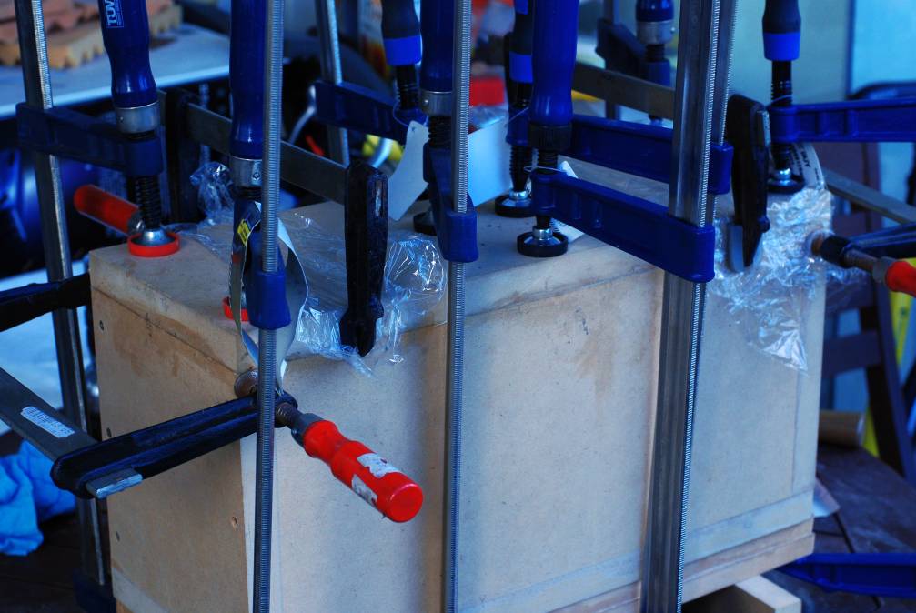

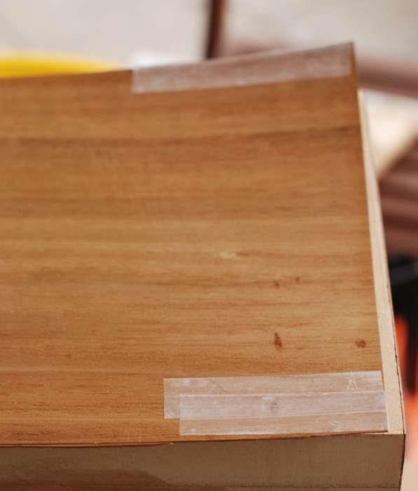

Joined 2003

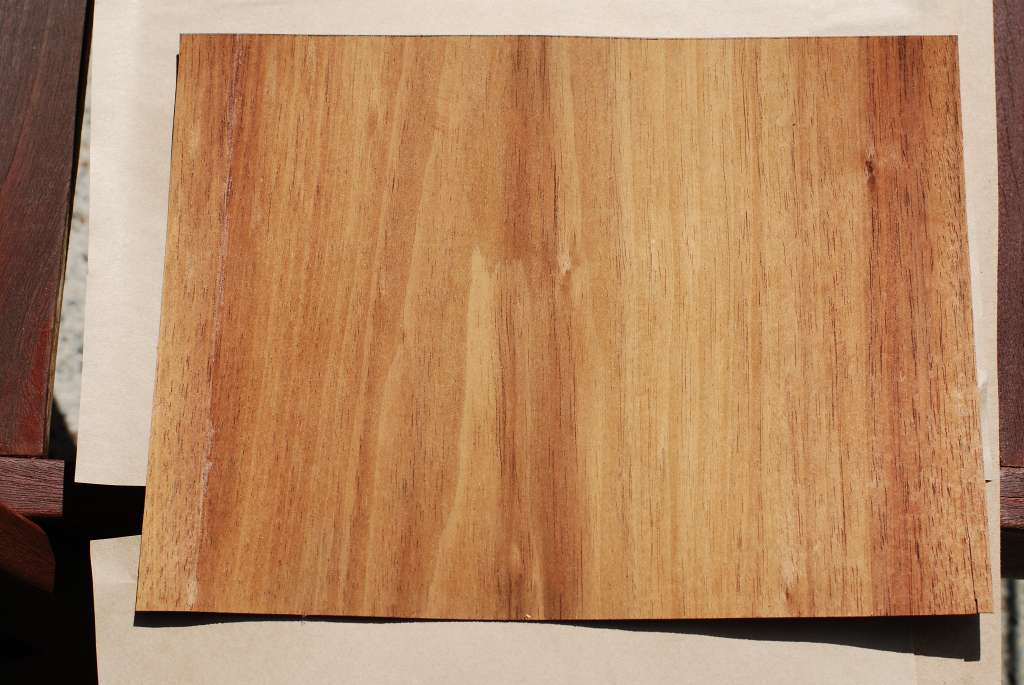

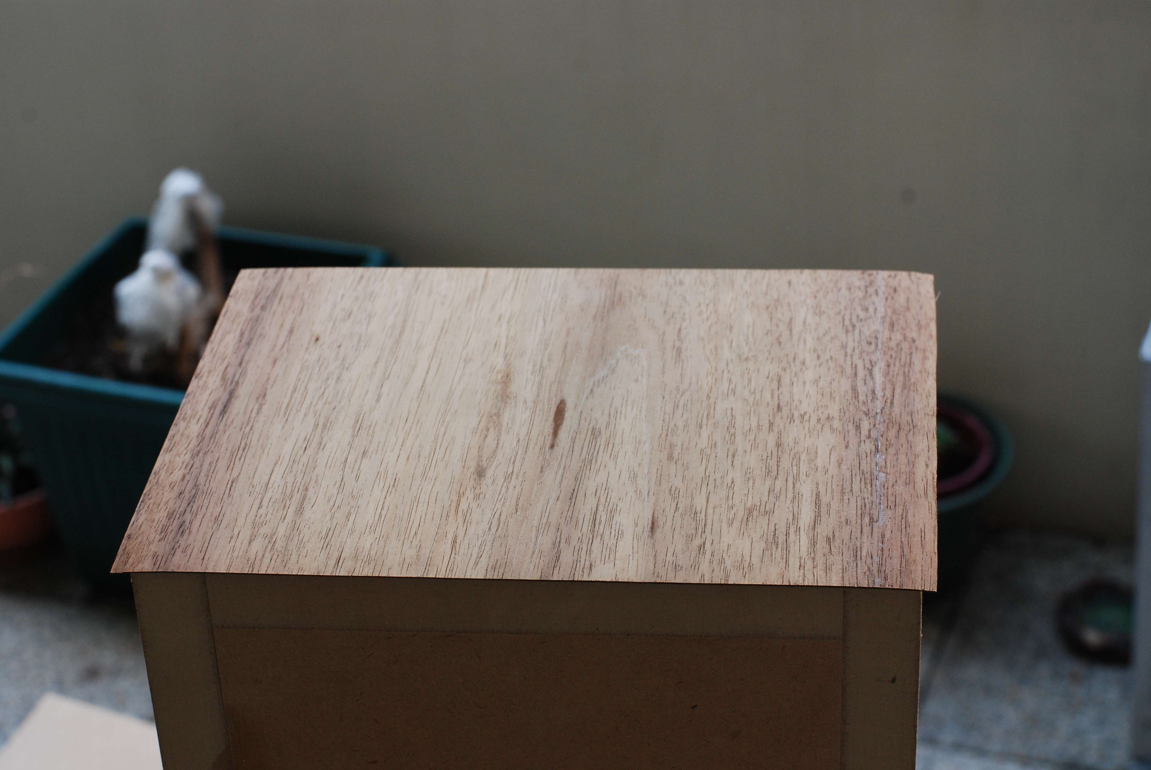

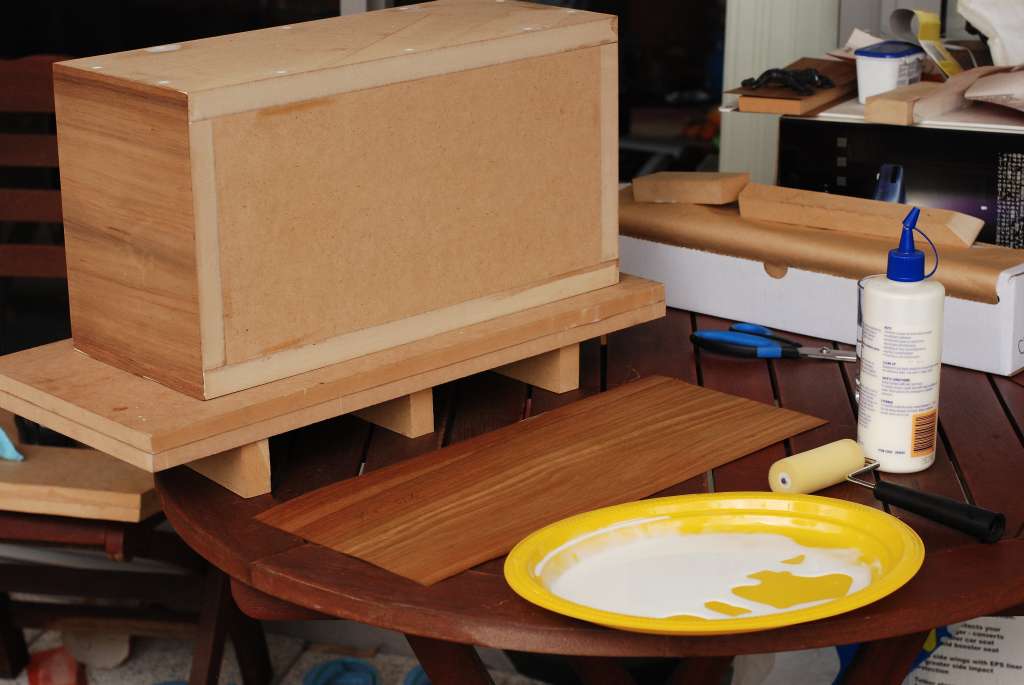

OK well it seems that the veneering of the back of the box this afternoon was successful. I guess once I trim the veneer I will have a better idea.
I've attached some photos of this afternoons effort, sans the one where the veneer curled right up which I didn't take because I was too busy panicking that the glue would dry as it was a warm afternoon.
The first problem I had to deal with was that I had some splits in the ends of the veneer, these were dealt with by placing some 3M magic tape on the non glue side, being carefull to make sure the split was as tightly together as possible before applying the tape.
I cleaned down the MDF with a damp sponge cloth, and also both sides of the veneer, being careful to fully ring out the sponge cloth so as to not get any surface too damp.
Then I mixed the glue with a little filtered water and applied with the paint roller. Smoothed down the veneer with my hands and it flattened out nicely. forgot the rolling pin as mentioned in a previous post, and discovered to my horror that the veneer had curled up by the time I got back, and wouldn't stay down by itself... in hindsight, I think at that point I should have sponged down the non glue side and it probably would have flattened back out again, but I instead ran the rolling pin over it (to no effect) and then wacked the caul on and clamped it for approx 1.5 hours.
I would have left it a bit longer but for the thunder storm that was coming up, and decided it was time to bring it inside! The result appears to be a completely flat, no bubbles surface which seems properly stuck down..
another barage of photos below :)
1st shows taping of splits. 2nd the setup before proceeding (sans rolling pin). 3rd surface of box after applying the glue. 4th clamping. 5th the end result. Note that for the back surface I didn't worry about matching the grain (note it is running the opposite direction to the bottom pannel) the veneer for the sides and top were cut from one continuous piece so will wrap around so to speak. I figured it was less important for the back..,
Tony.
