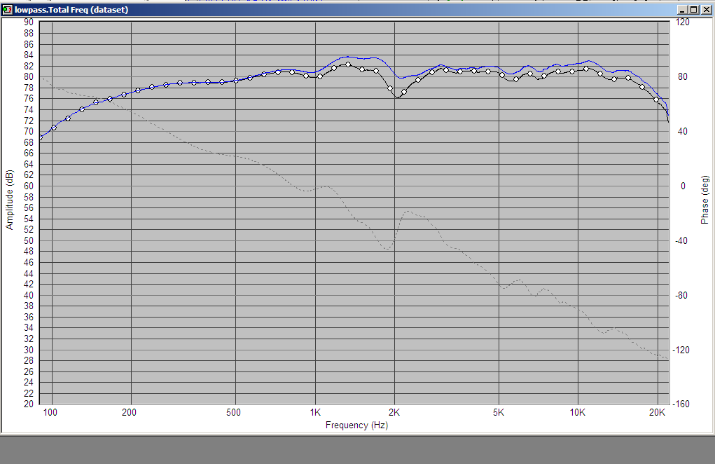

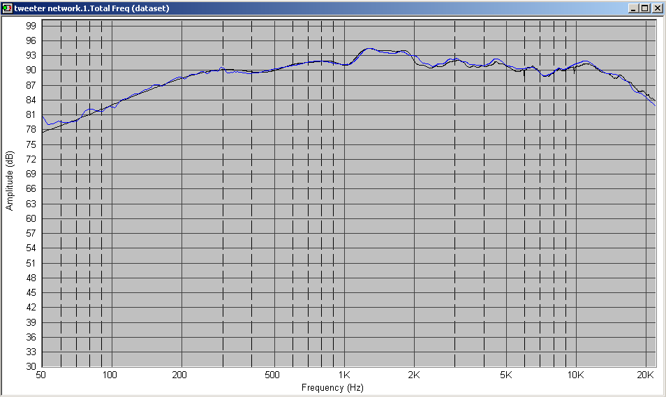

I actually decided to start a blank speaker workshop project and re-imported my measurements (individual drivers and the combined response with the current crossover) at least for this crossover the simulation is VERY good. I'll have to try again with the higher order and see if the funnyness persists (but now it is time for bed).
Hows this for a correlation between sim and actual measured response? Black is the sim, and Blue is the actual measured response. all measurements were done with the mic and speaker in the exact same position, crossover was already made, just swapped the wires for the three measurements, and then simmed the actual built crossover with the individual tweeter and woofer responses to get a comparison. Pretty damn close!! If I can get that good a correlation for the 4th order network I'll be very happy 😉

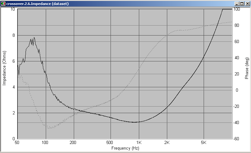

I've spent an awful lot of time simulating a new crossover, but I hadn't ticked the box to simulate the impedance... what a mistake!! luckily I've been procrastinating and hadn't bought the components for the 4th order network.
The impedance curve of what I'd pretty much settled on is terrible. around 1.3 ohms at 800Hz.... Back to the drawing board!!
Tony.

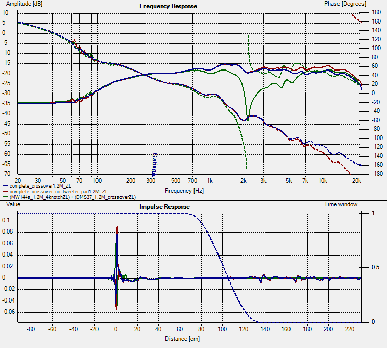

My goodness it's been nearly a year since I posted here!! scarily I haven't done anything much at all. The speakers are fine (more than fine) for TV and watching movies which is their main duty, however I've not been satisfied with them for certain music. Ironically I think one of the earlier incarnations of the crossover was better.
My interest has been re-kindled by the can you have sparkling treble but without silibance thread and more specifically by a post that Lynn Olsen made #17
I think that my crossover point is too low, and I'm getting modulation of the higher frequencies from the lower frequencies that the tweeter is trying to produce.

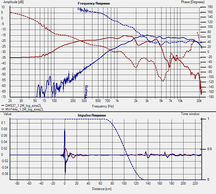

I did some measurements on the weekend and have attached some below.
The first pic shows the measurements of the MW144's and the DMS37. I used swept sine at 1.2M distance, and starting frequency of 100Hz.
The second pic shows measurements with (blue) and without (red) the padding on the tweeter.These are actual measurements of the speaker with the current crossover.
The orange trace is the result of measuring each of the tweeter and mids with their respective crossover components individually and then summing the response (with tweeter inverted) in holmimpulse. I didn't think to do ta crossover measurement with tweeter inverted on the day.
What this tells me is that the crossover frequency is actually lower than I thought, (it was supposed to be 3Khz originally) at around 2.2Khz, it also indicates that the tweeter is contributing to the overall sonics down to a shockingly low 600Hz 😱

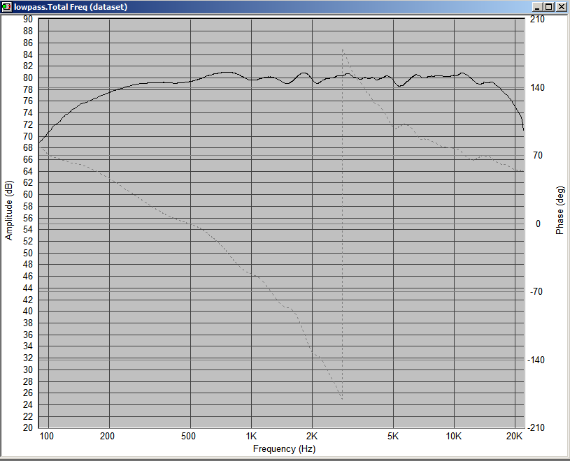

Picture three shows the THD plots for the current implementation...

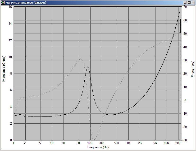

The fourth picture is the impedance plot of the MW144's measured in the exact same position that the acoustic measurements were taken. The thing I find most strange about this is that it shows no signs of anomalies in the 1-4khz region.

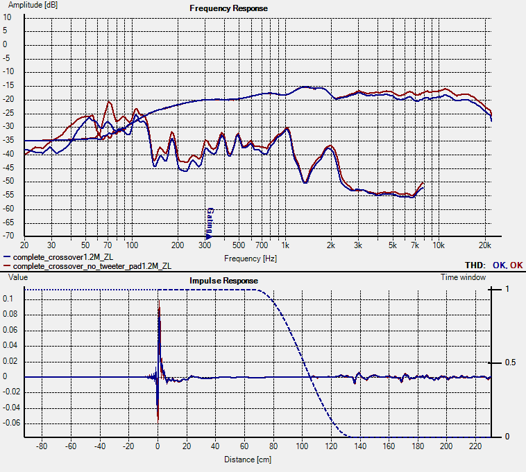

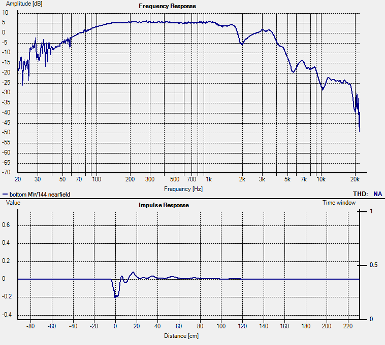

The 5th picture is a nearfiled measurement of one of the two MW144's taken a while ago, and yes that is the raw response, no gating no smoothing.

Hi Tony,
That trough at 2K should not be there! That driver is much better behaved than that. One of the hardest things to do is to measure drivers accurately.
The tweeter should not be operating down at 900Hz, hell, no tweeter should 🙂
Terry
Terry

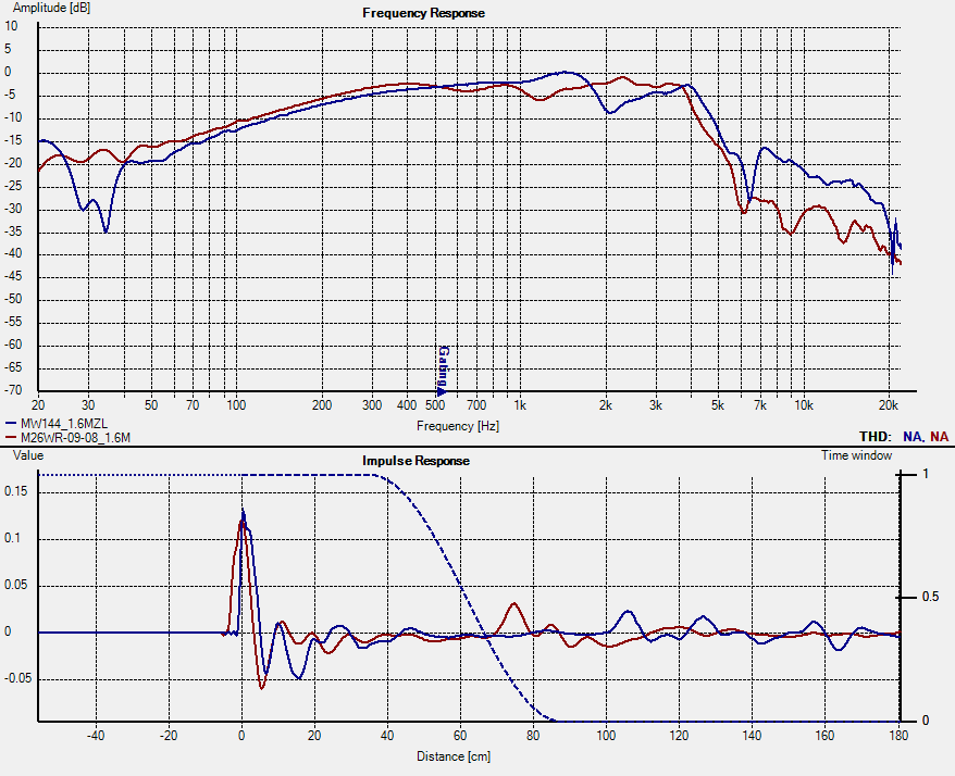

Hi Terry I know it shouldn't be there, but it is 🙁 try as I may to change my measurement setup it always remains, sometimes it changes a little but it doesn't change much.
When I was looking for other measurements I thought that I found one of my vifa 10" that was showing similar tendencies but I checked the original measurements and not so.
Below graph shows Vifa 10" red vs the MW144's blue, levels adjusted to get the curves close to each other. As you can see the vifa is showing no signs of a problem in the 2Khz region. These were both measured in the same spot (well as close as possible considering the considerable difference in size of the enclosures) on my balcony about 6 months ago. O think this shows that it isn't the mic or the measuring setup that is causing the dip on the MTM's it is something with the actual speaker, but try as I have I have not been able to work out what...
I think it improved a bit when I took more material out around the back of the cutout, perhaps I still need to do more. However even a measurement done boxless shows some of the same tendencies, however that was a nearfield measurement, I should have done a 1M one (or perhaps 50cm).
The datasheet for the MW144 on morel Israel's site actually shows a 5db suck out at 1Khz somewhat like what I'm seeing at 2Khz, I know the older datasheets showed a much smoother response though.

Is that response with or without x-over components. I have measured many MW144s and never had a dip of this sort of magnitude. That is 10dB! It's like a deep ocean trench. Look at box dimensions and driver to edge dimensions. If it was purely driver related I would expect to see a glitch in the Z graph.
Terry
Terry

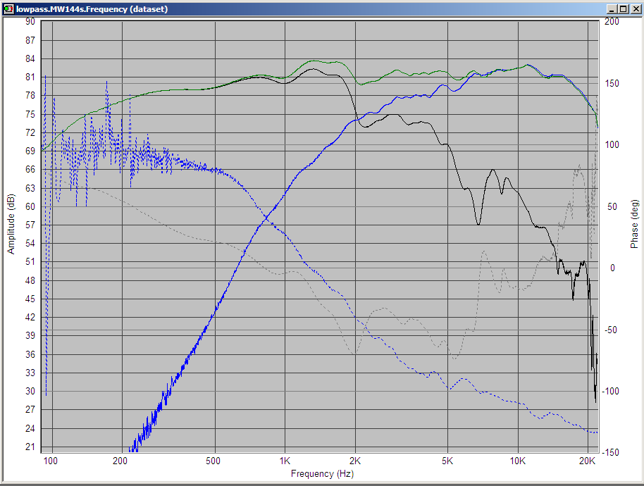

Hi Terry, without crossover, and yes that's exactly what I thought, why no impedance glitch. The simulation for baffle step shows a dip at 2Khz and the rise from 1Khz but no where near what is present.
I just checked and the centre of the dip is around 2175 Hz. that is 157mm which is pretty much exactly the width of the baffle (to where the chamfer starts) the total box width is 200mm. It is also (in an unfortunate twist) almost exactly the distance from the bottom or top edge of the surround of the MW144's to the top or bottom chamfer of the box... Not something I considered when doing the design, I might have to get my original prototype box and doing some measurements with it, as it was taller and narrower than the current boxes. I really really don't want to redo these boxes though

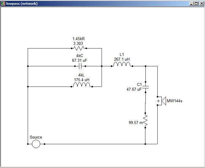

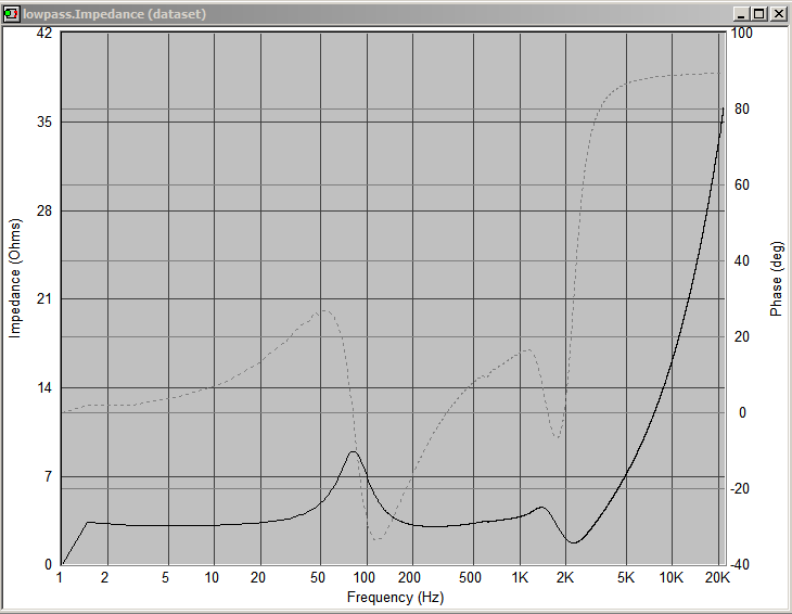

I had a go at another simulation of a 4th order (acoustic) L/R crossover. looked good till I checked the impedance curve...
1st pic is the combined simulated response second pic is the simulated impedance for the low pass 🙁
3rd pic is my attempt at the lowpass filter, basically a low Q notch at 1.45Khz and then something resembling a 2nd order filter after that... perhaps some playing with inductor and capacitor values can get rid of the impedance dip at 2Khz... damn that 2Khz!! 😉 The 99 milliohms in series with the cap is to stop speakerworshop from creating a resonance between the cap and the coil.

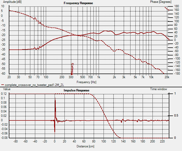

Hi Tony, Go back and have a look at your posts 73 and 74. Note the y axis. Now compare to your latest ones, note the y axis again.
Terry
Terry
In fact the fr graphs in post 108 are +/- 2.5dB which is an excellent result. when smoothed these would be +/- 2dB. Once you get a speaker down to these levels it is time to listen!

Hi Terry, I've actually been considering going back to that implementation in post 73/4 I got rid of the approximately 1K notch filter because it seemed to be introducing distortion, it could have been the cheap 100uf electrolytic I was using!
I'm generally happy with the sound, but some of my favourite albums sound really quite bad, Lynn Olsons comment about dense material causing tweeter distortion made me rethink a bit, which is what prompted me to start searching for a solution again. There is something not right because even at moderate volume (certainly not loud) my ears start to hurt with some cd's, I'm pretty sure that never happened with my old three ways which were far from optimal 😉
After doing some more simulation I found though that the crossover point should be 3Khz, it is just that the dip at 2.2Khz make it look like that's the null point when the tweeter is reversed.

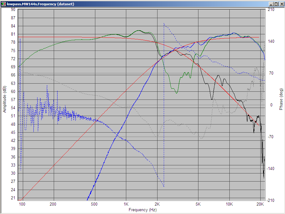

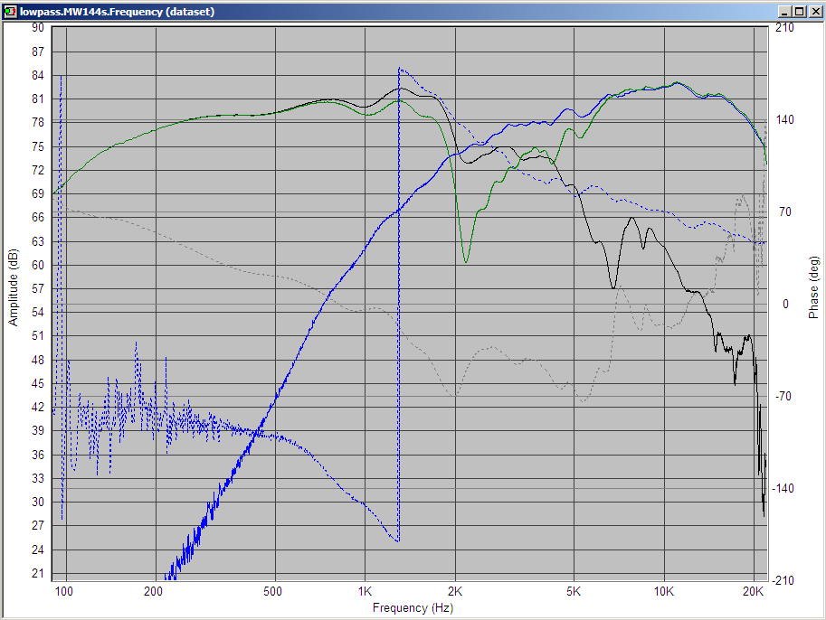

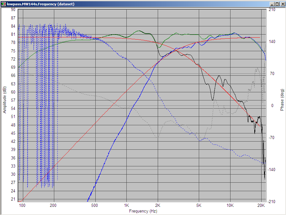

Thanks Terry. I did some more sims last night which I think are helping to narrow down the problem. I think the issue is with the phase in the crossover region. with the current implementation (and I'd swear last night the sim showed an exact phase match at 2Khz but it doesn't now) the phase tracking is a bit off. I made some changes to the high pass network and got a better phase tracking through the crossover region, but with the result that the big hole at 2Khz is now very obvious. I suspect however overall it should be better.
Note that all below are 2nd order bessel at 3Khz green is the summed response.
1st pic current crossover showing filtered low and high responses with phase, and green the summed response.
2nd pic as above with the tweeter reversed.
3rd pic high pass network modified to vary the phase still 3Khz end order bessel acoustic.
4th pic as above but tweeter reversed.
5th pic is the original vs new sim response.
I'll continue to play with trying to get the phase match better, I suspect this is where my problems are coming from, not from too low a crossover frequency as I thought it might be.

Try increasing the xover freq for the woofer only. Try taking it up by 300 - 500Hz. It seems to be rolling off too soon.
