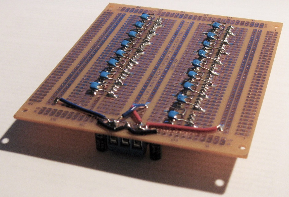

I've started doing some assembly. I've soldered in all the IC sockets, put 0.1uF bypass caps between the power supply pins of each, a 10uF cap on each rail to ground, the terminal block for power connections, and some power distribution leads.

I made some more progress but I am now a little unsure of the best way to proceed...
I need to run several "busses". There is one to supply the input to all the amplifiers in the output stage for each channel (left+right), plus another pair to carry the output current away to the 'phones. I decided that the best way to run the "output" busses is to bridge over to another identical proto PCB from each output trace via the output isolation resistor. I can then easily collect the outputs onto one of the bus strips of the PCB, and can keep the outputs away from the rest of the circuit.
For the inputs, I could run a wire around the top (bare) side of the proto board that is connected to the output of the drive amplifier (the first op amp). I would then run wires up from the input traces on the circuit side of the board to the top side, and solder them to the input bus there. That would help to keep inputs and outputs separated. But the wire would just be hanging out there.
Should I be concerned with noise + hum pickup for a wire not near a ground in this circuit, or is this not a big deal?

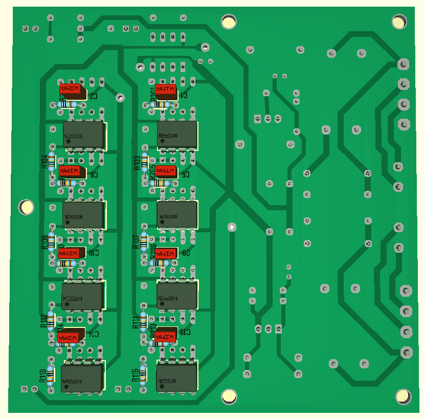

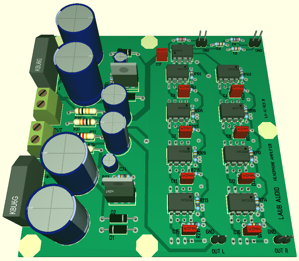

I found a break in the action to do some more design work on my headphone amplifier. I decided to abandon the proto board and instead design and fab a proper PCB for the amp and on-board power supply. I'm using the same 101x101mm footprint that I have used for other projects.
The AC supply uses independent dual secondaries. These feed two rectifiers and are followed by CRC filtering, which lead to LM317/LM337 regulators. I used star grounding, with separate stars for the regulated ground and main PS filtering caps. Although the stars must be are connected, this should help to keep the regulated ground quiet. According to one of my references, this physical arrangement keeps the rectifier current pulses from circulating through the ground, which reduces rectifier noise. The CRC arrangement should help this as well. The regulators will be connected by a bracket to a low profile heatsink that will make up the top of the chassis.

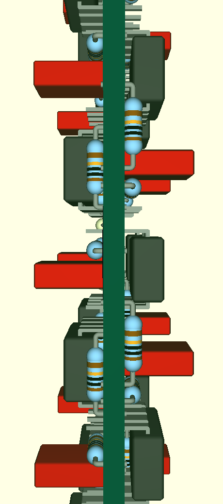

When initially laying out the amplifiers on the available board area I could not fit all the 5532 packages that I intended to use. There are 32 amplifiers in parallel per channel, so that's 32 DIP-8 packages in total. I also wanted to have on-board power regulated supplies. Constrained by the small amount of space, I had to get creative!
Using my design software, Target 3001!, I Was able to come up with a novel way to tightly pack the 5532s: alternating the placement of the DIP packages between the top and bottom of the board. Also, where there was a DIP package on one side, in that same PCB real estate but on the opposite side I could locate the bypass cap for the op-amp as well as a resistor, if needed. This also made it possible to orientate adjacent packages so that their pins were identical, e.g. pin1 of one DIP package was next to pin 1 of the next DIP package, pin2 next to pin2, and so on. As a result I could place these pins right next to each other. As I began to build up the layout, symmetries appeared that made it possible to pack everything in to the limited space very efficiently.

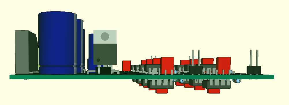

I have to say that the "3D View" feature of Target 3001! came in very handy during this whole process. It generates a 3D mockup of the board that you can pan and rotate to look at various parts of the board as it will look when its been fabricated. This helped me find several misplaced labels and get some feel for the placement and routing that the 2D layout does not provide. Screen shots taken from the 3D view of the board are attached, below.
There a view of the top of the board, one of the bottom, and a "side" view to highlight the placement of parts on both sides of the board.
I sent the design to the fab and it should be back here in a week or so.

I've been working on the same thing Charlie except that I'm using a few hundred and surface mount. Its modular so I'll be trying it out as a headphone amp and power amp. In regards to trying to get creative you might find that with efficient layout you can get away with one cap per two opamps per rail. Also (you may already be doing this) Self was using one cap across the rails between two opamp packages. The cool thing was that if it crosses the rails between two opamp packages then it can go from pin 7 on one to pin 4 in the other. Traces are then single digit mm long.
A few hundred... wow. What rail voltages are you planning to use? I think that you will find that to be the limiting factor when used as a power amp... And how are you planning to get the heat out? If you can increase the density using the SMD version you can probably use one cap per two packages (maybe between them?) and it will still be "close enough". IIRC less than a 2-3 cm is fine.
I am using the cap between PS rails and in my layout I can place components (like this cap) under the IC package directly, making the tracks from PS pin to cap to PS pin very short. On the other hand, the PS rail tracks between the output caps of the regulators and the 5532s is rather long. Hopefully this will be a non-issue. That's why you prototype!
