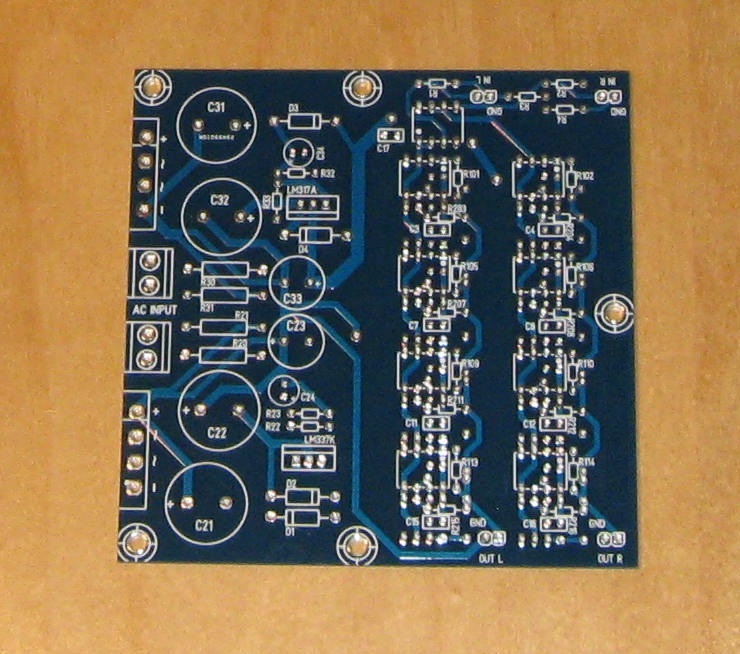

UPDATE:
I finally got the circuit boards after a bit of a delay. I might try to build one up but I have a couple of other boards that I need to build first. In the attached rather grainy photo the PS is on the left and the op-amps on the right. Half are on the top and the other half are on the bottom out of view.

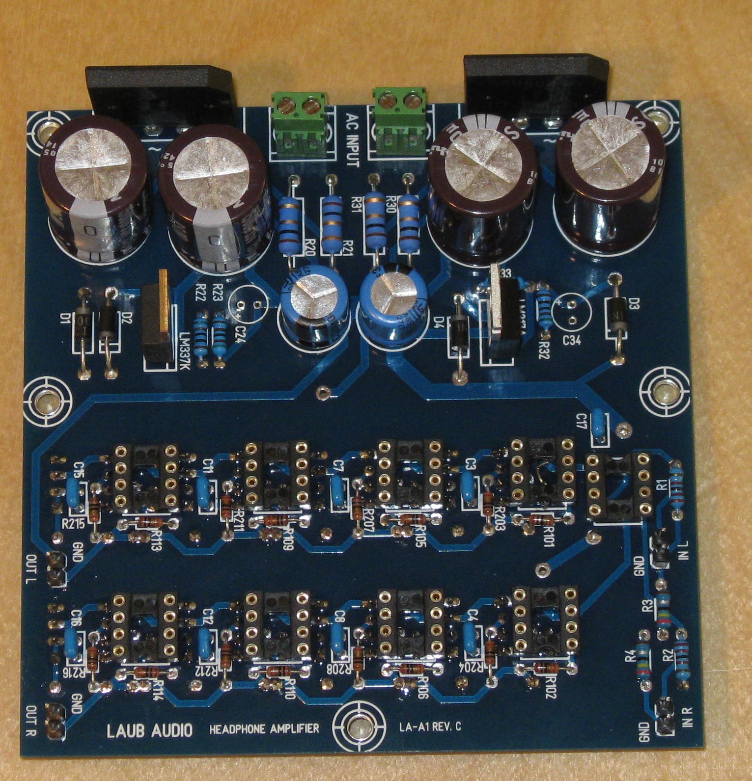

I finally can come back to this project. I had to put it on the back burner while I worked on some other stuff, and then I packed up and moved my house contents... this explains the month long delay.
The pic below shows the board near completion. I've finished populating it, but have realized that I made an error with the polarity of capacitor C24 (upper right in pic). It's reversed, but it's just a simple matter to solder it in the "other" way, and I can edit the silkscreen to properly show the correct polarity (for the other boards that I had made) so this is really a minor issue at best.
I will replace the cap and install the new one with the polarity corrected. At that point after a little checkout I can test the board and will report the results here.

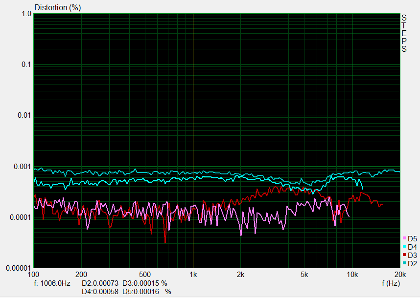

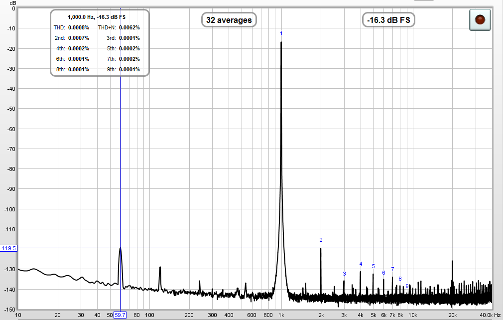

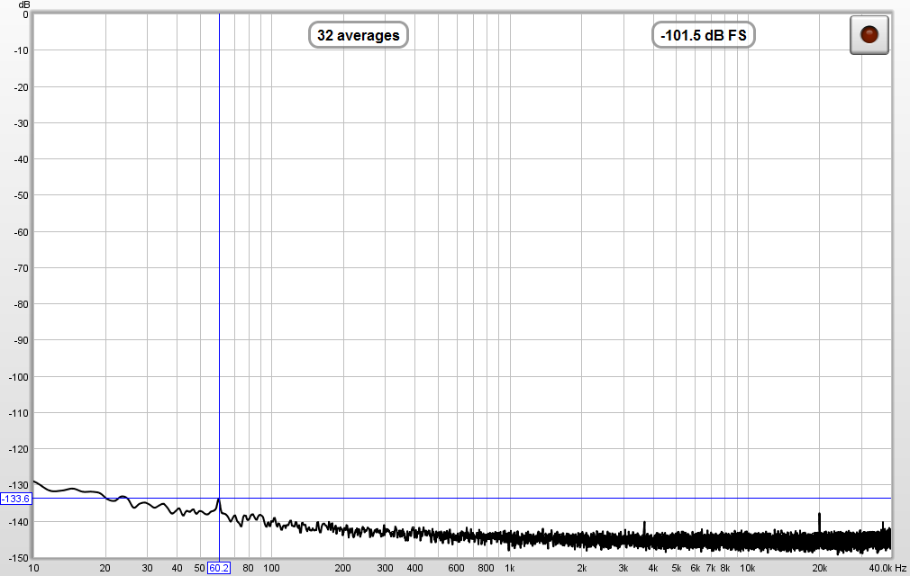

Finally, some test results to post!
I populated the board with the LME49720 input buffer and four NE5532 op-amps (the Texas Instruments version). I put all of the 5532 buffers on one channel and left the other channel vacant, and tested in this configuration.

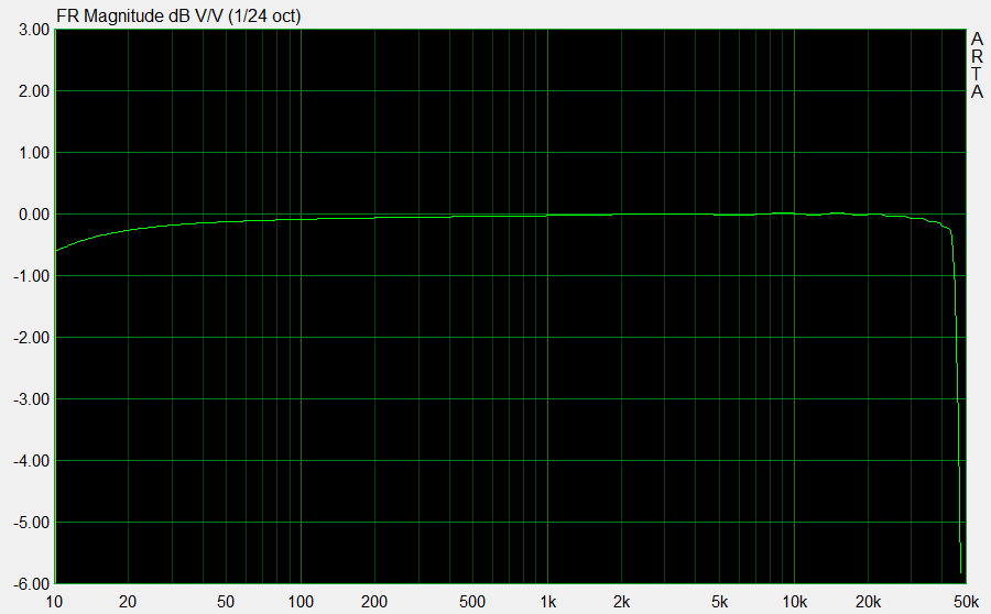

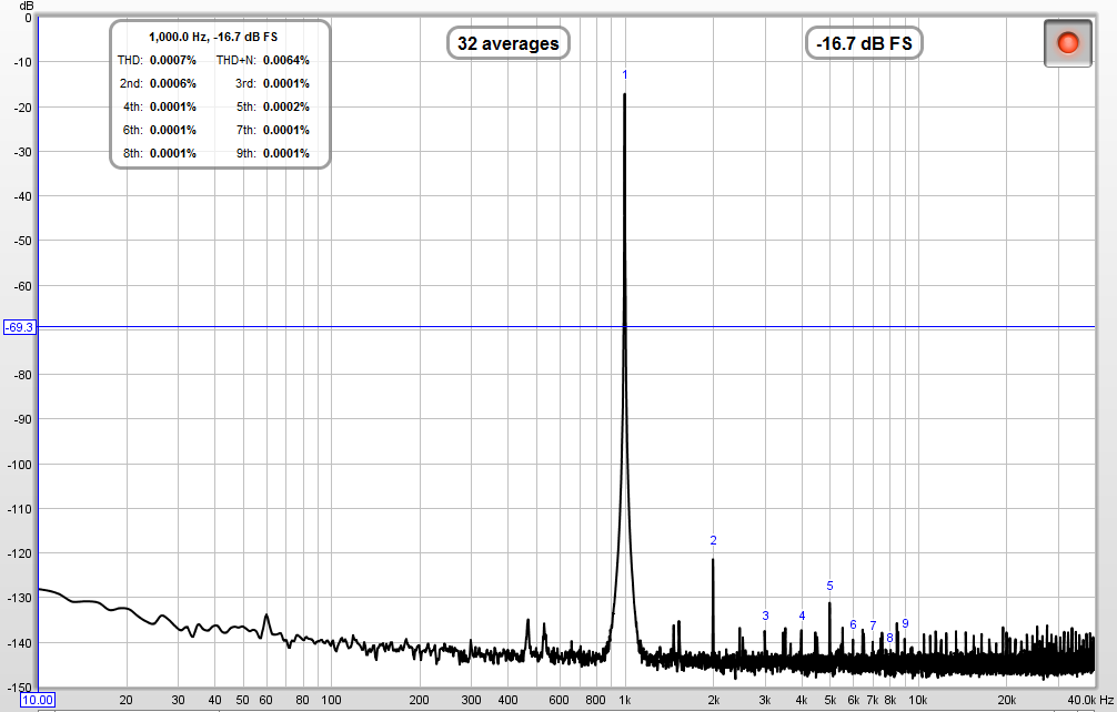

Attached are the measured frequency response, distortion, and a spectrum with a 1kHz input. I measured the output at 1.06Vrms during the spectrum measurement.
I'd say that this looks pretty good for a headphone amp. The frequency response (on the low end especially) is even flatter than this measurement would indicate as the amp is DC coupled. The harmonic distortion is at or below 0.001% for all orders and power supply related components are very low. Mains frequency is almost at -120dB! I still can't figure out what that spike is at 20kHz it's something that has popped up in my measurements only since my move.
Only half of the output buffers populated for these tests. One nice aspect of this design is that you don't have to fully build it out unless you want the ability to drive very low impedance headphones (e.g. 32 ohms) or possibly multiple cans in parallel.

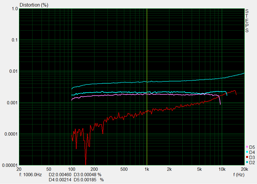

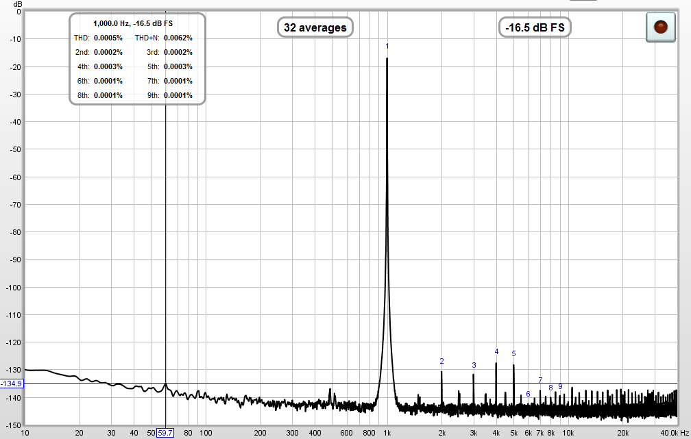

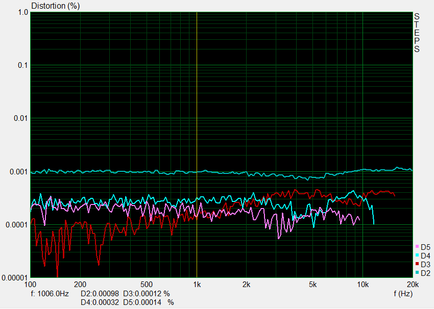

I decided to throw on a load and see what happens. I cobbled together a 30R load from some 10 Watt wire would resistors and retested.
The results are about the same, if not better, compared to the no-load measurements. See attached. Distortion is still 0.001% or less. The surprising result is that the power supply mains and harmonics have more or less disappeared from the spectrum and even with no input signal the spectrum looks very clean.
In retrospect, the output voltage is only 1V. Only the load seen by the output buffers has changed and the 5532 is known to perform very well into very low loads. When you add in the fact that the output only needs to reach 1Vrms, you can easily see that this is well within the capabilities of the board, populated with 4-op-amps (per channel) out of the maximum 8.
Unlike the previous no-load conditions, I can feel the regulators getting slightly warm. The 5532s run barely warm under the +/-15V rails into this load. It will be interesting to see what happens when the board is fully populated as the quiescent current of the 5532s is not insignificant.
Attached are screen shots from the measurements taken with a 30.3 ohm load connected, one channel only, populated with four 5532 packages:

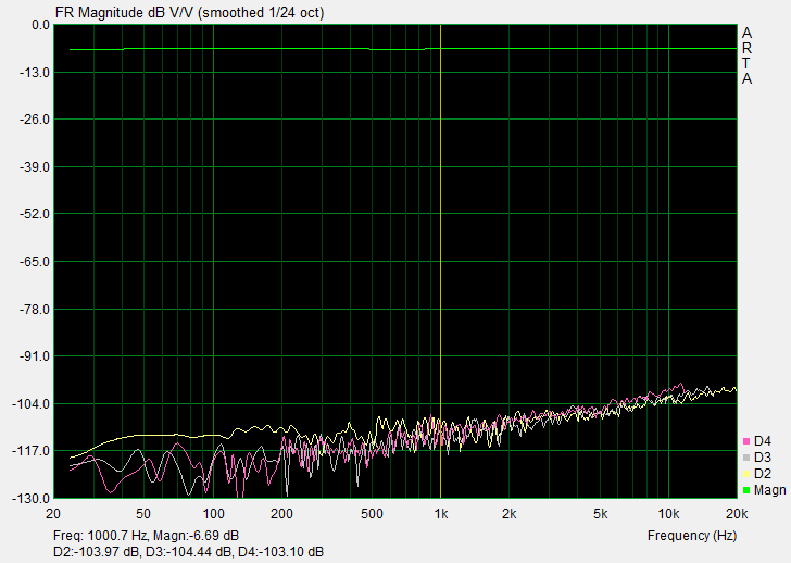

LA-A1 with 4 op-amps per ch into 30R no signal spectrum.PNG58.5 KB · Views: 237
LA-A1 with 4 op-amps per ch into 30R STEPS distortion.PNG42.2 KB · Views: 611

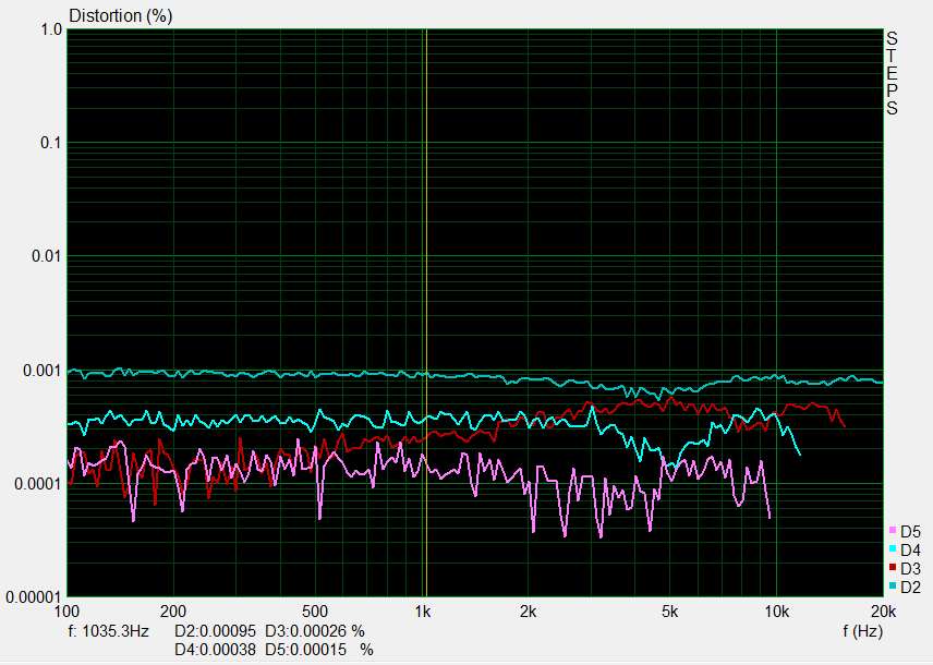

To compare, attached is the distortion measurement taken when the board is populated with only one 5532 op-amp per channel. You can see it is rising with frequency and is about 5 times higher at 1kHz and higher order products are increasing as well. Not that you would likely notice. The distortion is still quite low. It's pretty amazing that the 5532 is still this good when this heavily loaded (70R per amplifier)!
Now measurements with the maximum eight 5532 op-amps installed (still only one channel populated). The distortion levels actually decreased a bit compared to when 4 op-amps were used. The spectrum still looks very clean. The loading on each amplifier (16 total per channel) is about 490R. The drive level is again producing about 1Vrms at the output and the load is 30.3R.
The regulators are now pretty warm to the touch, but I can just keep my finger on them. I should definitely add a small heatsink if/when both channels are fully populated with output buffers. The TO-220 tabs could just be connected to an extruded alu case and that would be enough. The 5532s are not warm - I think I was mistaken before. The rail voltages are actually only about +/-14V and this helps to keep them running cool.
