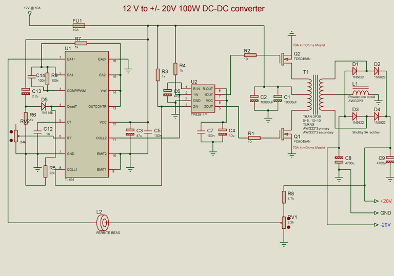

which diode's suitable for D4, D5 and in the Boostor?

in dc-dc smps uses U2 = TPS2811P gate driver, can i change to IR 2111
Boostor or SMPS, which one?
Use the MBR2045CT (both sections paralleled)

in dc-dc smps uses
No ideaU2 = TPS2811P gate driver, can i change to IR 2111
Both can work, the SMPS is more sophisticated and flexible, and regulated, but it is also more complex and requires the winding of a transformer
In this variant, yes, but I don't remember whether it has been tested physically or not, so be cautious in your experiments.

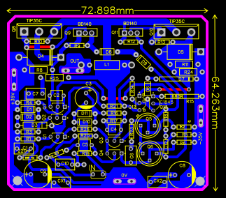

New compact PCB
Hello Folks,
Since there were no pcbs which can take KSC1845 for Q12 and Q13 (as BC546 is not suitable for voltage higher than 25) , Wanted to modify existing pcb. I had previously built circlophone using Alexmm's pcb. Hence I picked the same for my modification.
Notes :
1) 73mm X 64mm - Slightly larger than powerflux's pcb (which is smallest so far)
2) Component placement and routing is heavily influenced by Alexmm's,though I laid all the track a fresh
3) KSC1845 for Q12 and Q13
4) Drivers and outpts are on same heatsink
5) Not tested. only verified against original schematic . Will be testing it in few days
6) Exactly as per the original schematic published by Elvee
7) All resistor are sleeping position 😛 except R8,R11 and R24 which may needs to be installed vertically .
8) No C11, which is optional
Comments and criticisms are most welcome

Hello Folks,
Notes :
Regards
Goutham
The final version of the "classic" Circlophone remains that of the first message.
Many other variants have been proposed, by myself and other members, to address specific applications or use particular components, but the plain old C is still current and up to date.
You can find more details in the thread initiated by Daniel: Builder's information for the Circlophone
