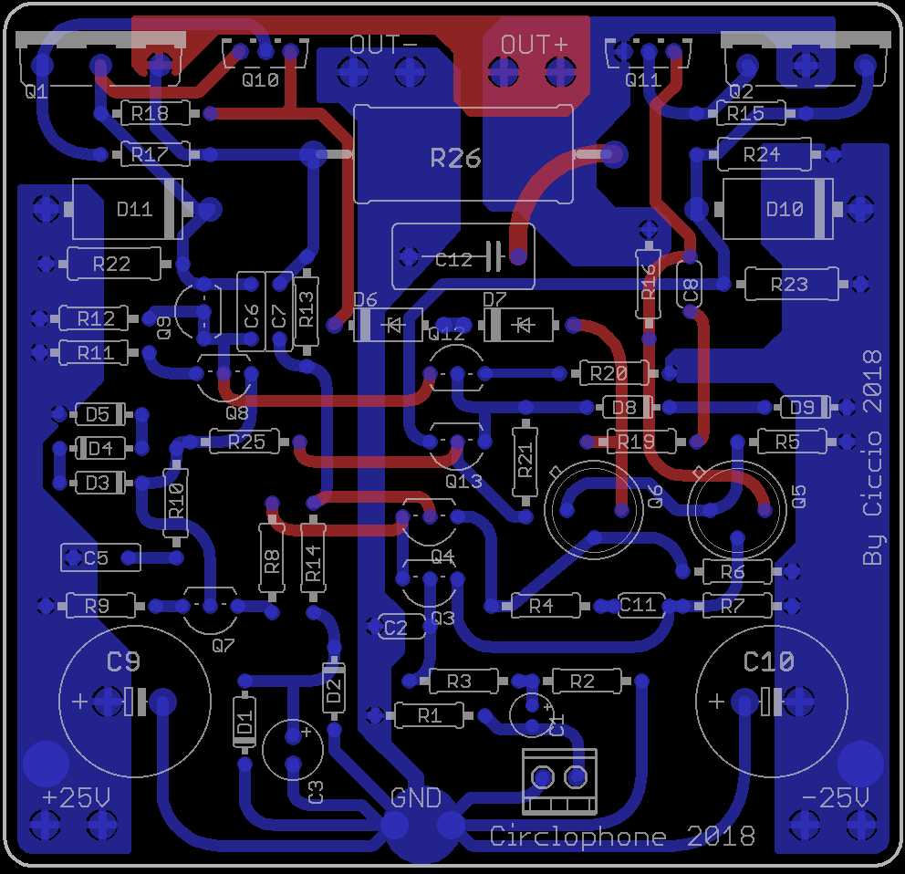

Does any one have PCB layout of original Circlophone schematic. If so please post.
here it is...
Thanks for the post. Is there a single layer layout also.
no double layer only.
I have 3 pairs of pcb that I have more, I send only in Italy if someone is' interested only slightly different from the photo posted here

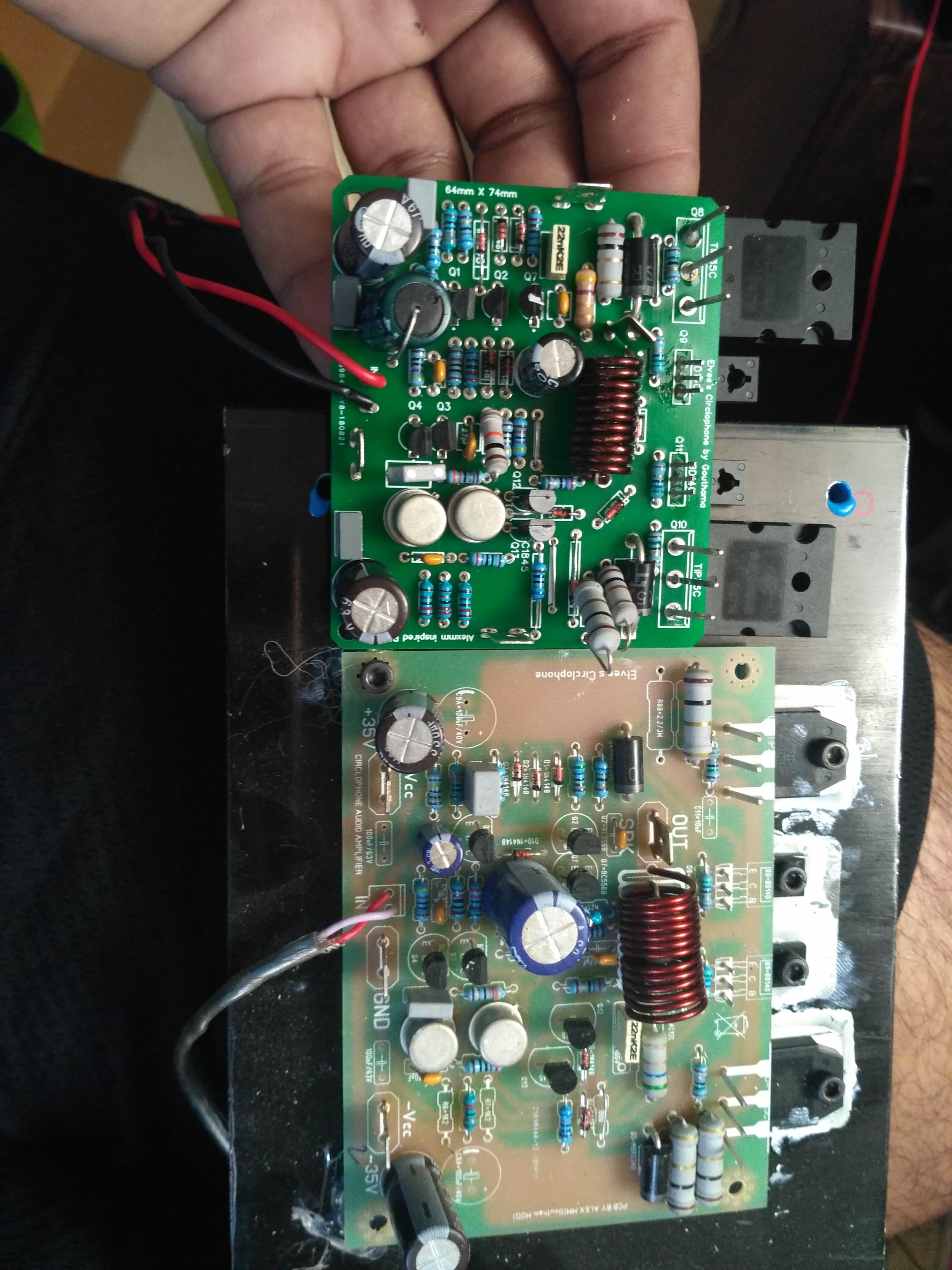

Circlophone in New (smaller pcb) avatar.

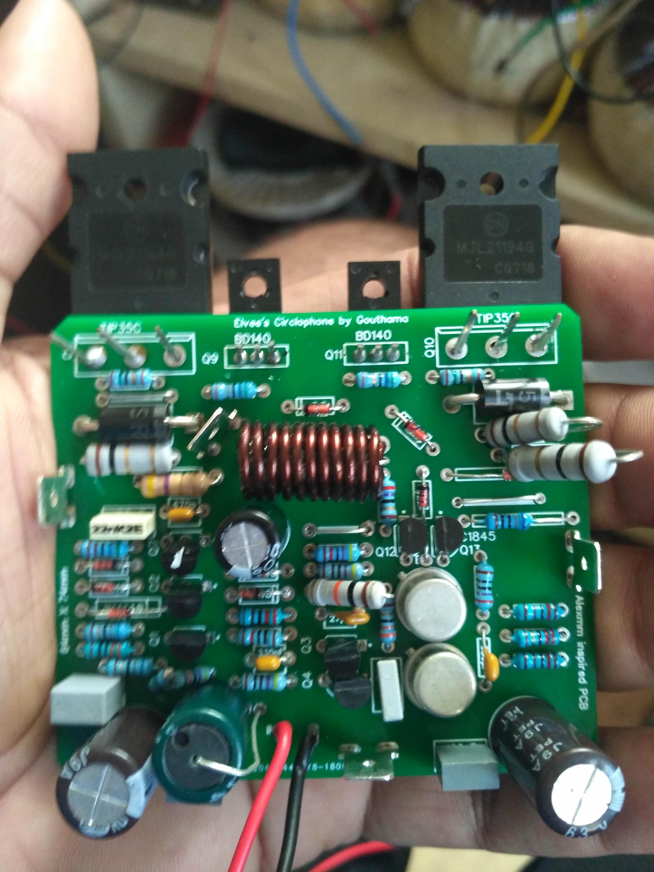

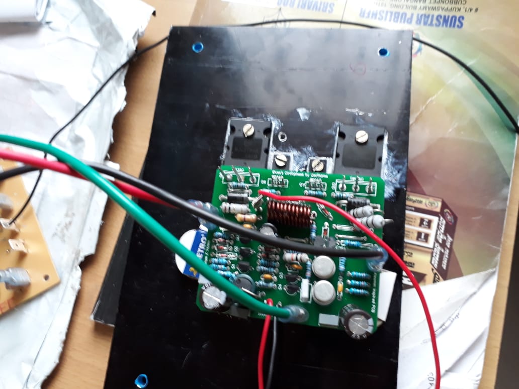

My take at circlophone pcb. (inspired by Alexmm). Fully tested and functional.
Running without a glitch on fake Mjl21194 .
