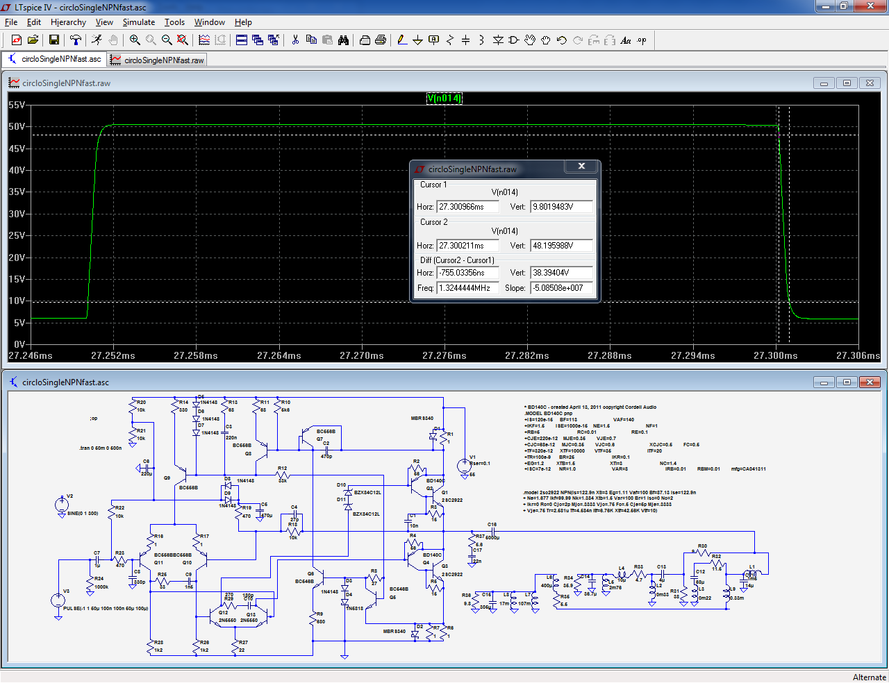

A high fT is desired for a "fast" feedback. Those ole tubes are "internally" very fast , the practical amps are severely limited by the transformer at the output. The current feedback topology is insofar better suited for BJT amps as it quite easily allows lead/lag compensation
But anyway, i use just those BJTs in simulation which i actually have. At first. If there are indication of stability issues, continue with other models.
Btw it is a good practice to check the validity of Spice models ... i found models of BJTs which started conducting at Vbe less then 0.4 Volts...

All of the variables are the same, except for the last three:
Vceo=250 Icrating=16A mfg=OnSemi
Will that make much of a difference to the model?
Those parameters do nothing except tell LTSpice what to display in the transistor selector. Other than that they are the same (if not, I would need to fix that).
Random SC2922 model found online: 2SC2922 npn Is=122.9n Xti=3 Eg=1.11 Vaf=100 Bf=87.13 Ise=122.9n Ne=1.677 Ikf=99.99 Nk=1.384 Xtb=1.5 Var=100 Br=1 Isc=0 Nc=2 Ikr=0 Rc=0 Cjc=2p Mjc=.3333 Vjc=.75 Fc=.5 Cje=5p Mje=.3333 Vje=.75 Tr=2.581u Tf=4.584n Itf=6.76K Xtf=42.56K Vtf=10But anyway, i use just those BJTs in simulation which i actually have. . . .Btw it is a good practice to check the validity of Spice models. . .
As usual, there is no news about the spice model's validity.
Here's a short list of valid outputs: BD249C, MJ802, MJL21194, MJW21196, MJ21194, MJ15022, MJ15024, MJ15003. . .If there are indication of stability issues. . .

The schematic from post 1, showing C11. . .if you use fast (Ft>5MHz) transistors, the capacitor C11 shown as optional on the schematic becomes mandatory to remove local instabilities. . .
The model was again copied wrong (.model at the beginning left out). Furthermore, no power transistor in this class has 2pF Cjc and 5pF Cje. ABORT!!!
Provided i don't make a big mistake here....forcing a base current of 2 mA yields ie of 145 mA not that bad but Vbe reads 359 mV....that is the 2SC2922 model simple test...
the models provided by Bob Cordell ( and my own model of a general purpose npn ) make good sense.

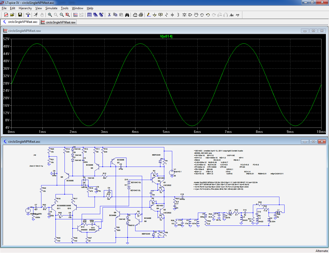

Despite the inaccuracy of the Spice models it appears that the harmonics spectrum is well behaved versus power and frequency. Thus without SOAR and short protection required the circlophone is a really good amp for active speakers. But i am not sure about "rise time".
Besides that most audio signal sources are rather limited in terms of rise time, if a broadband speaker has a rise time of 13 µsec for - 3dB (which is very fast) the amp should at least be twice as fast but other audio scholars claim 10 times as fast. If so the target is ( given 55 volts single rail) about 20 volts/ µsec.
Whether this makes sense or not ( what is the max rise time of a CD ??) the Circlophone is apparently slower , if my sim ist not wrong.

With +/-20V supplies and 2N3055's as OP, the +SR is 24V/µs and -SR 20V/µs (actually measured).
Apart from the unrealistic 2SC2922 model, the oscillation seems to be caused by a known issue: a minor parasitic pole in the common mode loop caused by R15.
It happens with certain mixes of transistors, and the simplest fix is to eliminate R15 completely: it has no active role and just improves ruggedness and strong EMI immunity.
Regarding the slew-rate, the base version is shown with a heavy, one-size-fits-all compensation, capable of accomodating very slow OP devices like the 2N6259.
With better devices like yours, you can safely reduce C10 to 180p.
The SR then becomes 50V/µs:
Seriously guys, that 2SC2922 model is so bad, it would be more realistic to just use one of Cordell's power BJT models.
Thanx however using Cordell models the sim did not show any instability.With +/-20V supplies and 2N3055's as OP, the +SR is 24V/µs and -SR 20V/µs (actually measured).
The 2SC2922 model fails almost every test especially the ft vs ie tests.
So better drop it.
