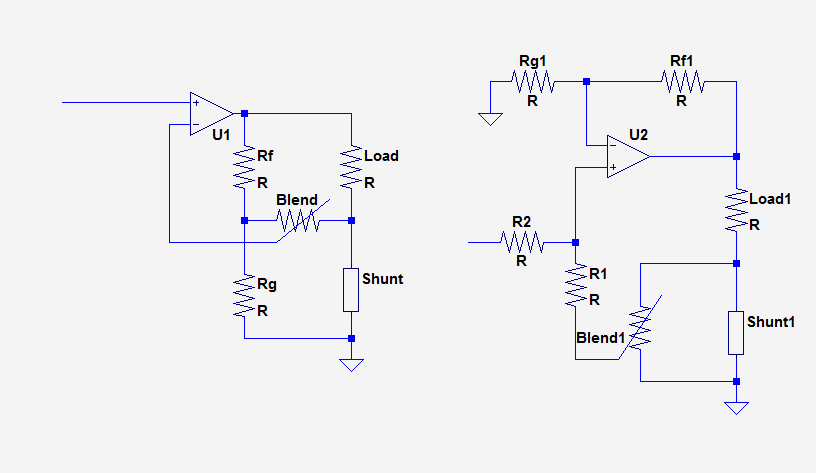

Before continue ( with PCB) i need to know how to give the circlo a "negative output impedance" - by positive feedback, and how to turn it into transconductance amp
Since the circlophone has the normal, explicit in(+), in(-), out configuration, you can use the usual tricks:
Two typical examples below, first one varying between Zo=0 and ∞ (transconductance), and second one between Zo=0 and -(any arbitrary value).
By selecting suitable values, the transition can be smooth (inasmuch as the speaker's impedance allows).
With a bit more of noodle twisting, it is possible to combine both circuits, and it is also possible to keep the load grounded, but it is more expensive in terms of component matching and CMMR

Yes thanks. The load need not be grounded in active speaker. I am about to implement Stahl's patent for the woofer. Negative impedance amps should be -naturally, so to speak - unstable especially when driving reactive loads. The simple goal is to compensate the resistance of the voice coil ,thus that a particular woofer fits ( Thiele Small and such) in an alignment even if the box volume is too small.
Ok will try a sim with a Spice woofer model ( first closed then ported box)

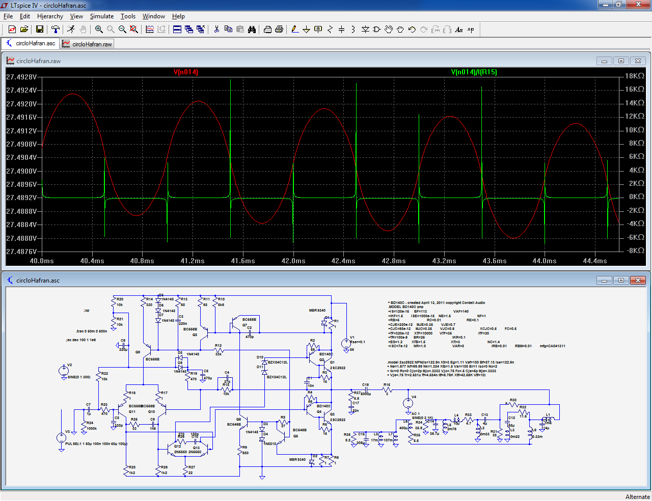

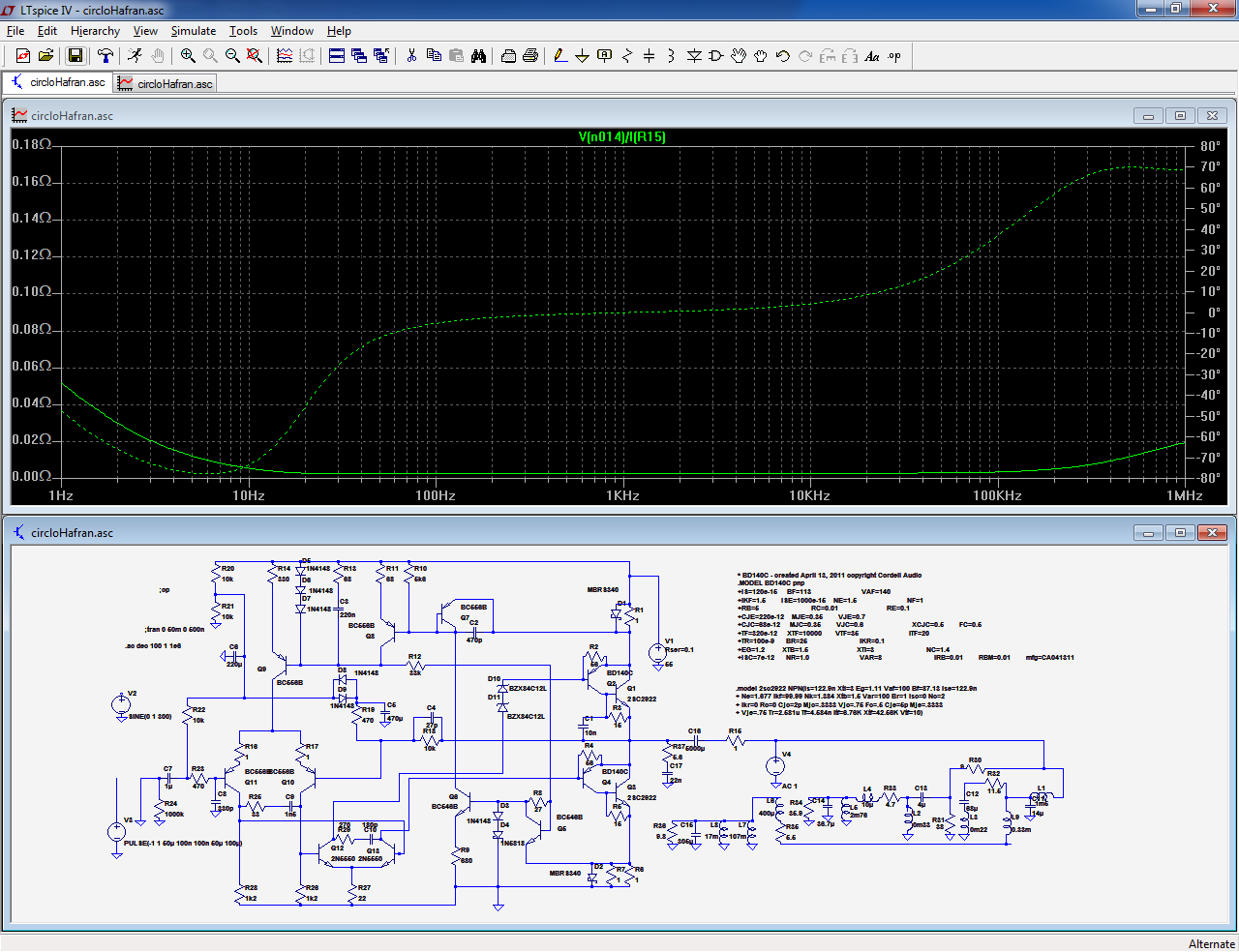

The circlo sim unveiled a problem. I changed the single rail sim to npn with trusted BJT models but the problem remains. To determine output impedance, in practice a sine voltage source is connected to the amp output via a resistor typically 5 to 8 Ohms, the amp input shortened. The sim of such a setup works with several Spice models of amps, showing - as expected- some distortion. But the Circlo sim cannot handle that.
Seems to work well enough for me:
Edit:
Also works for time domain, but not for the computed impedance trace obviously, because of the indeterminations caused by the 0-Xings

Ok. Looks much like another issue with Spice models..... Alternate solver gives "better" results. Anyway, this test should unveil more about the amp's feedback, compensation etc. than a "forward" test. Some audio magazines and an US audio scholar ( do not recall his name) claim that keeping the OPS out of the global feedback loop reduces so called reactive distortion significantly. Don't know whether this shows up in a Spice sim.

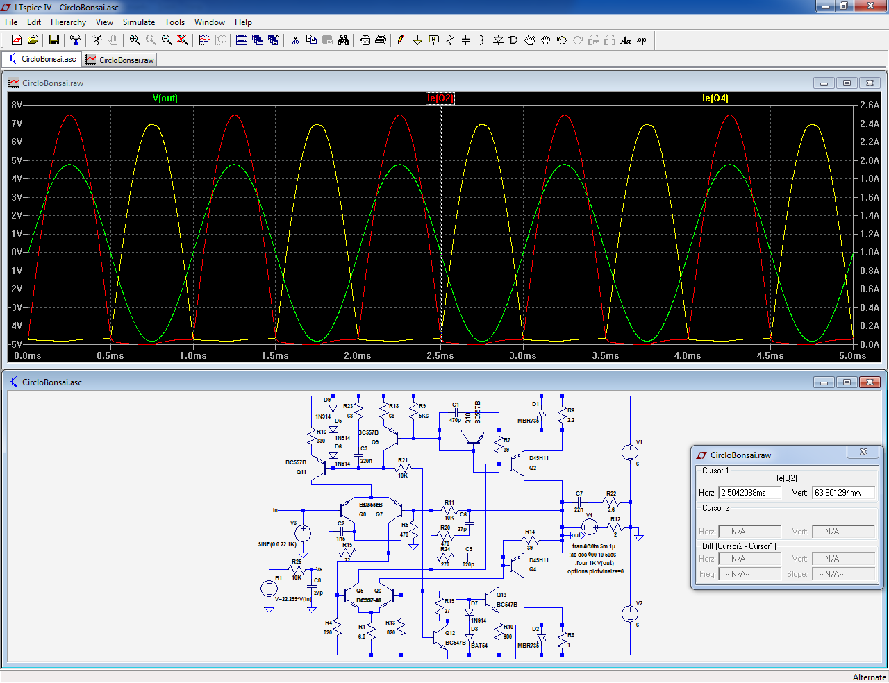

Here is an attempt at a midget Circlophone: CircloBonsaï.
The modifications consist mainly of simplifications: singles as OP, no zener, and a few resistor values adapted.
The Iq has been reduced to 65mA
With 12V total supply (+/-6V), it delivers 10Vpp into 2Ω before clipping, that is 6W average power.
2V total waste is not bad for a general purpose amplifier, but cannot compare with specialized amplifiers for car radio and other low voltage applications having common emitter output.
The OP can be high Hfe types like 2SC1983 or its P counterpart, BD434, etc.
The circuit could also undergo a complete sex-change operation, or operate in a single supply config as shown above: this would give a slight advantage for output power, because the positive side has a little more headroom, and with a proper bias, 10.5~11Vpp output would be possible.
