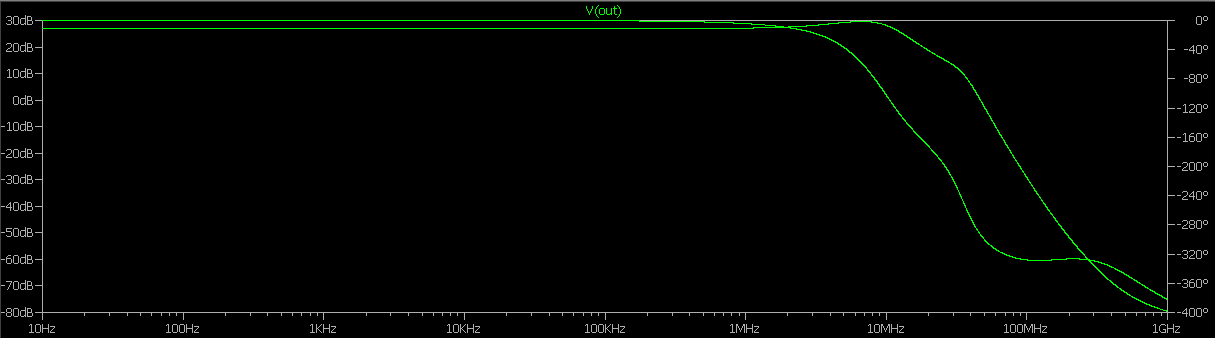

What about this?
  • Circlophone-MOS-CCS-BUF.asc
It was stable, but the phase margin was a bit short, in the region of 44°.
I have made some changes, and now it is well over 100°:
Thank you Elvee. Square wave has excessive overshoot issue with this one but I'm not sure that is it a bad indicator or not. I just added some pF parallel to fb resistor but it didn't help.
EDIT: Very low main compensation cap (C4) like ~10pF fixes it, but phase margin is in question again. Reducing R24 also helps.
