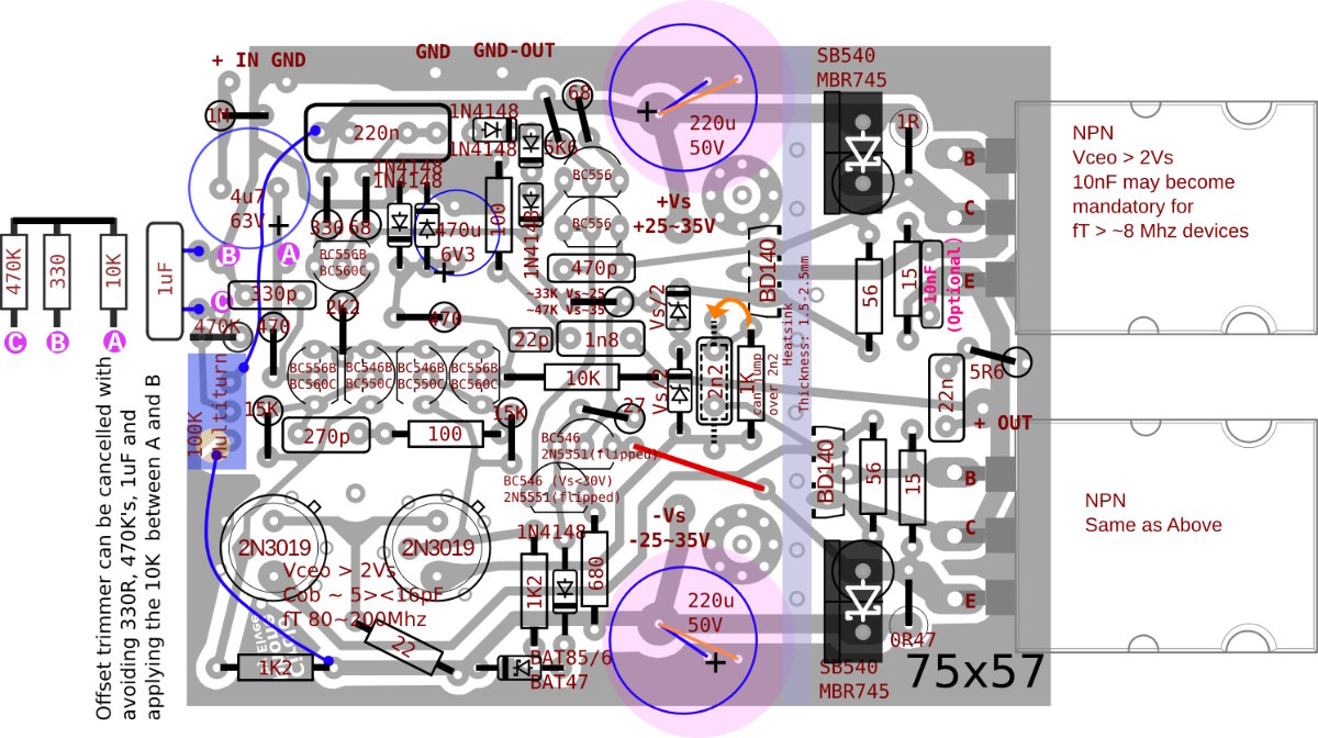

CFP Circlophone PCB files
Hello all,
I finished my new CFP build without any problem so far. There is no reason to fail if any serious mistake hadn't made. I suggest to carefully clean remaining flux scrap, especially bottom of input pair alignment.
Attaching power schottkies on heatsink is not necessary. Power schottkies and driver transistors should be isolated anyway. If 10nf become necessary, it can be soldered directly B-E pins of upper power transistor also.
Hope you easy build for this Circlophone.

hi Daniel,
The input complementary feedback pair = BC560C/BC550C
The phase splitter = 2SA1209
The outputpair combo = 2SA1837/MLJ21194
Powersupply voltage = 36V
best regards,
Piersma
Here's a quick double check. . .
CFP schematic doesn't show D8, D9. For 36vc unloaded? rails, I estimate (D8 of 16v) + (D9 of 18v) = 34v, assuming that 36v unloaded rails measure is probably more like 34v loaded.
For R21 (bias), I estimated 47k, although nearby values work.
Please double check VCEO voltage capacity at Q12, Q13, transistors (needs 80v or higher like KSC1845 or 2SC2240-BL) and current capacity at D4, D5 diodes (needs 5a or higher like MBR735, MBR745).
More device information is summarized at the builder's thread.

hi Daniel,
For simulation purposes D8 and D9 are not neccessary, in real life you really need D8/9 otherwise Q5 would have to dissipate to much power. Q5 needs to stay within it's SOA. In my case i used 3 x 12V zeners, and for Q13 a 2SC2705.
For comprehensive eplanation Elvee will probably jump in.
best regards,
Piersma

Nice implementation, and good choice of transistors, I suppose you mean 2SC2911 for the phase splitter.
However, the collector capacitance for this transistor is slightly below the recommended range of 5 to 15pF. This might cause minor stability issues (or not), depending on other semiconductors and other things.
The collector capacitance acts as an auxiliary self-compensation, which is why too low a value might be problematic.
If it happens, it will be in the multi-MHz range, very small and harmless both for the amplifier and the speaker, so nothing to worry about, and the cure is simple and straightforward: simply add 4.7pF C-B capacitors.
