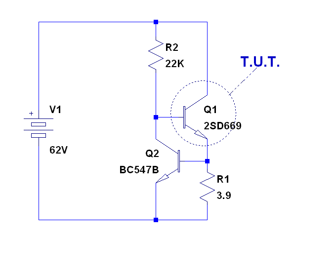

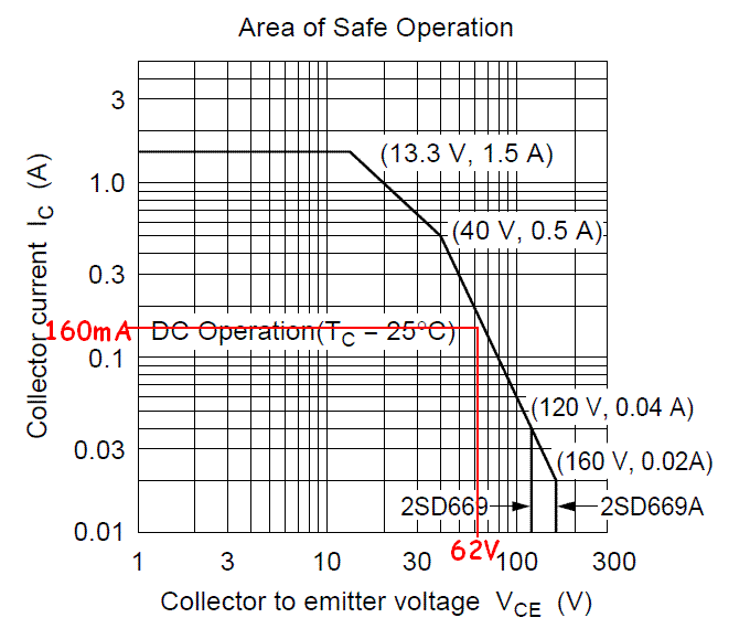

I tested the idea of weeding out fake transistors by pushing them to the limit.
Basically, the circuit is a CCS connected to a lab supply adjusted to limit at ~250mA.
The transistor itself is mounted on a ~infinite heatsink: a 5mm thick aluminium slab, thermal paste and and tight clamping using proper hardware.
The operating point is choosen to be well inside the SOA of the real thing, here 160mA and 62V.
With this setup, it took less than 10 minutes for the fake to throw in the towel and go short.
The method is simple and accessible to those having limited test equipment.

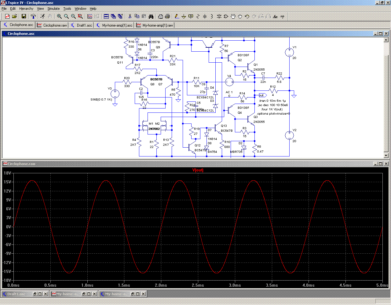

Have we ever tried the FET alternative?
Littlediode carries Central Semiconductor 2N5858 which is $6.38 each parts plus approximately $4 shipping.
That's really expensive! What is wrong with these good transistors those aren't in production line in these days? (or decades?)
For myself, my priority is bjt. If I couldn't find anything in place of Q5 and Q6 (which is not a easy case), then mosfets may come to next to try. Although, it will be interesting to see anyone used mosfets in place of Q5/Q6 successfully.
In sim, it works absolutely transparently, only the values of R4 and R13 need to be adapted to suit the different threshold voltage, but other than that, it looks like a simple plug-in replacement.
Any small MOS of sufficient voltage should do.
I'll give it a try one of these days.
