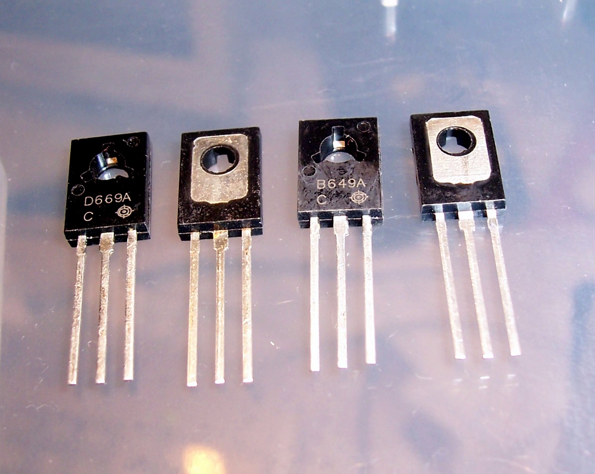

Thanks to Elvee for saving me from counterfeit transistors!
Here's a photographic comparison of fake versus real 2SB649.
As a reference for others, here are some pics of the fakes in question.
Unlike other fakes I have already seen, these are not "best efforts" to imitate the real thing: they have been carefully and cynically designed to dupe the unwary amateur at the absolute minimum cost: nice and clean case molding, and all easily accessible parameters like Vceo or capacitance OK.
But when you dig deeper, you notice that the Ft is only 34MHz (instead of 140MHz), and a scanning shows that the die size is that of the smallest small signal transistors, roughly 1/10th of what it should be.
If such transistors were used in the Circlophone, they would broadly seem to work at first.
They would give relatively poor performances, because of the pseudo-2SD669 low Ft, but the amplifier would sing, and the servo would catch up with most deficiencies.
But as soon as the volume is pushed up, things would go seriously wrong: with drivers so desperately undersized, their SOA would immediately be exceeded, with catastrophic results for the OP transistors, and maybe the speaker connected to the amplifier.
Beware, be always on your guard!

Wow, the fakes pictured in posts 756 and 763 are decorated much differently except for the glossy case, all square edges, same size and exactly the same collector plate. Do your samples also do HFE ~245 if checked with digital multimeter test port?
Is there some conveniently rudimentary/simple circuit that can be used for a current handling test so as to explode the fakes before installing them in an amplifier? For example a simple sort of current test that anything suitably sturdy will survive if given a heatsink but the pervasive fake devices do not pass?
If they are used in a 50mA CCS operated at 100V (with a proper heatsink), the real ones should survive indefinitely, but the fakes will be pushed far outside their SOA: this should be enough to separate the wheat from the chaff.

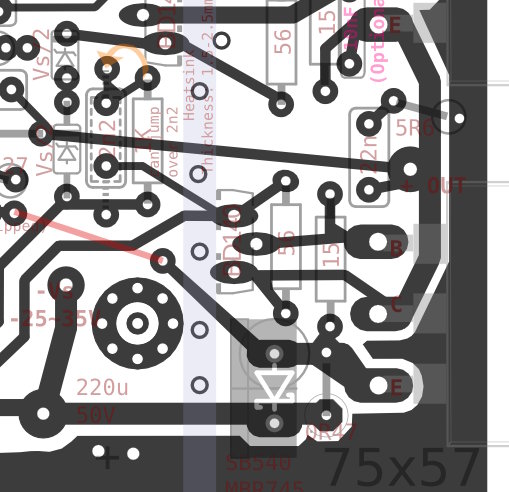

If you havent made your PCB yet, there is a small change that might improve it. I notice that the feedback is not taken directly from the output and the output is not in the middle of the track between the two ouput transistors.
As was described in an earler post this makes a significant difference to the distortion and whilst it is by no means bad as it is, you might see an improvment if you get it exactly matched.
I have seen 6dB improvemnts in very low distortion amplifiers just by getting this symetrical and the feedback taken directly from the output.

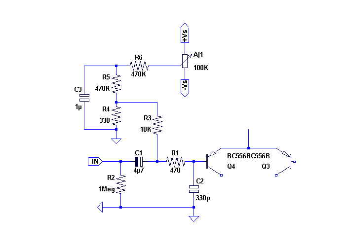

Here is an offset adjustment circuit. It can be used with C3 present or shorted.
Awesome!
And thank you for the explanation. Apparently, the effort of selecting optimized parts for a servo is not easier than effort of selecting a most pleasant model of capacitor and the audio quality results either way is the same at best, with other conditions probably favoring the cap as higher quality. Well, that certainly busts a few myths. Thanks!
If you combine the input capacitor (which can be a high quality one) with a shorted C3 and a low offset pair, or an offset adjustment, you get the best of both worlds: safety of an AC coupled amplifier, without servo or feedback cap issues.
That's the most reasonable and effective solution if you want to get rid of C3
Thank you!
The point wasn't exactly to get rid of C3, but rather to make tests and comparisons both with and without C3.
With matched input, and temporarily shorted C3, it should be possible to choose reasonable but somewhat adjusted values for both R16 and R17 to result in zero offset. Your 10k input load spec makes this easier than usual. After zero offset, a wider variety of capacitors will make good results for C3 and then D11 won't misfire when the starting point is zero. For the record, I wouldn't promote a going without an NFB cap, on a high gain amplifier, except as a useful testing condition.

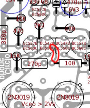

PCB status
I tested a build depends on my actual layout so far.. and it suffered by that enormous offset problem again. I thought there is no reason to facing with same problem with a new layout except that if I didn't repeat same mistake again. Then I tracked pcb layout again and I detected a very annoying faulty track at input pair alignment. I thought that I didn't touch there but I remember I have cancelled alternative connection of 270p at post #708 but without removing that extra track completely. I fixed it but It didn't help for offset problem. I think I injured some place on circuit permanently.. And I'm about to rebuild it from scratch again despite that all of time consuming cost. Sorry for who waiting for good news again.
