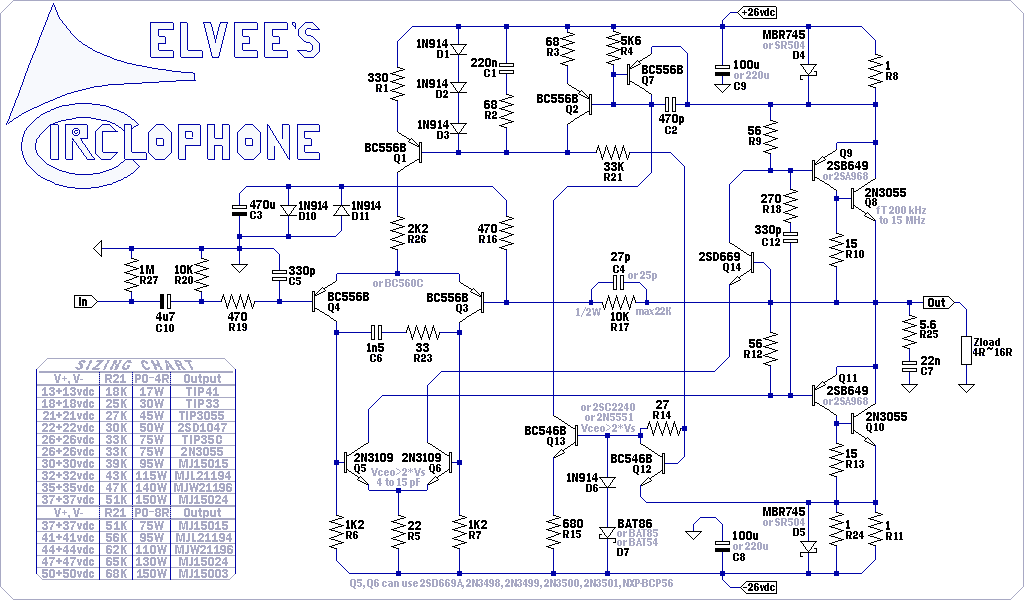

No problem, but you have to understand that derating indiscriminately at every component of the amp can only bring trouble. Derating makes sense for heavily stressed components, typically OP devices. . . . No resistor risk overheating, even at total supplies in excess of 120V. The 250mW rating remains adequate in all cases, though I would advise a larger rating for R17, in the interest of linearity.
The derating spree has a cause. I had changed the feedback resistor to 22k (albeit 20k is fine), and that higher gain has necessarily more energetic dynamics. Do I still need a 1/2w resistor or is 1/4w fine? Most computers and mp3 players distort, compress, blare or even clip slightly if run at max; and, Rightmark audio analyzer can confirm that on a case by case basis. So, really more pleasant playback was the reason that I changed the resistor. It works nicely. But, it works better than expected. It is like removing shackles and like trading a mouse for a tiger. That is worth an interview.
Probably, the 6db more from the speaker difference between my 45w amp versus a 150w amp, should not require a large increase of gain to facilitate that difference. I do not know, but it seems that we could decrease the 470R very slightly and perhaps use matched BC560C at input to enhance capacity for gain?

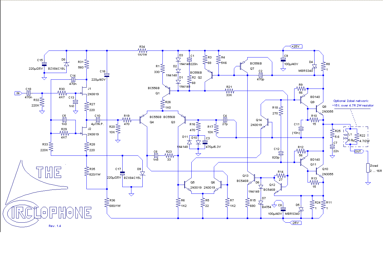

The schematic in post 1 is really great, but documentation has more questions to answer. Parts availability and easier shopping is the primary motivation of the schematic below. It is easier to read than pagefulls of posts. I hope the D7 and R21 sections are suitable? If the power amp schematic below is okay, then I could proceed to page 2 of the documentation for Circlophone options and accessories. For the second page (accessories and options) it seems really nice to start out with jfet buffer accessory if that is doable?
150W is ~35V rms. If you want 200mV nominal sensitivity (that's 175mV including some margins and tolerance), you need a gain of 200.Maybe I don't need 200x? So, I have 22k feedback resistor on a 45w to 8R amplifier and for 75w to 8R, that doesn't need much more gain. So, is there a suitable way to do just a little bit more, like maybe some fine tuning or an especially suited device selection?
You can have some excess gain and leave the volume control half-way. That's no rocket science, there is no influence on "dynamics" or temperature or anything: controlling the overall gain by whatever method yields identical results (within reason obviously).
No, this is completely irrelevant: what you see are variations caused by secondary effects, mainly Early effect on the OP transistors and the finite loop gain of the common mode mode servo.Together with common mode feedback, one emitter must be at constant current.

Looks OKIf the power amp schematic below is okay,
I apologize for asking, are BAT85 (30V) and BAT47(20V) suitable for D7 with 31V supplies? Does D7 share Vs or 2xVs with 1N4148 or regardless with Vs? My working setup is on the shelf by now and I can't measure voltages just for a while.
I found NOS 2N5858's at a local supplier and bought 10 of them.
You can assume that this part is not exist.
Both are suitable.I apologize for asking, are BAT85 (30V) and BAT47(20V)
None of the diodes in this amplifier has any reverse voltage applied (except for the zeners, of course).
Using high gain transistors does not actually change the gain of the amplifier.
I think I see more or less what you mean: the bias servo system creates a structural gain increase of 6dB compared to a non-servoed stage, but this has nothing to do directly with R1, and the 6dB gain supplement doesn't depend on its value.Voltage decided entirely by R1 and opposite emitter.

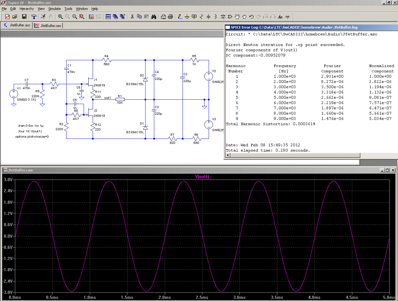

Input: The input resistance is approximately 10K. But, the source impedance must be kept well below that value. This is because the tail current of the input pair is dynamically modulated by the bias servo, and any imbalance in the input impedance will generate a parasitic voltage due to the bias currents of the input transistors. This will cause a "leak" of the common mode signal into the "noble" differential path, and will increase the distortion. For this reason, source impedance much greater than 1K should be avoided.
. . .A jFET buffer can certainly be added. . .
Thank you! That is a great idea, but I need some help with it.
The added jfet buffer is one way that I could ensure that the amplifier performance remains more likely constant between sources and not have me unnecessarily troubleshooting for a very long time like a puppy chasing its tail until dizzy. Help! How do I install this jfet? Could you provide a schematic example of how to install the jfet to the Circlophone at post 1?
I believe that the added part will help promote reliably repeatable results as well as greater compatibility to various sources of which there is vast variety. And, that variety needs tamed a bit. Jfet buffer?

Something like the Pass B1 would be suitable:Thank you! That is a great idea, but I need some help with it.
P.S.
At that point, the very next question would be ideal specs for jfet shopping.
www.passdiy.com/pdf/B1 Buffer Preamp.pdf

What about an op amp buffer? You could give it some gain if you wish, and drive it from zenered or regulated supplies from the main amplifier supply depending how high it is. This would provide very low output impedance and solve your problem very simply.

Here is a suitable buffer to match the Circlophone, clever enough not to degrade its performances:

Inserting Q7 and Q8 in the LTP should be possible cleanly, with a bit of reflection.It seems it is not that easy to graphically modify current pcbs respecting cfp modifications.
The mod in the feedback cap can be wired "in the air".
Reversed? What do you mean?RC zobel at output reversed in CFP version.. misprint?
5R6 and 22nF.. 5R6 is connected to output at original but it is connected to ground at CFP. Vice versa for 22nF.
