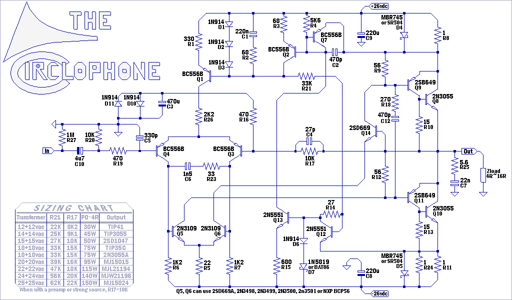

Thanks for the specs on that. I will fix the schematic so that next time you see it the feedback shunt diodes are like post 1. That whole scenario of partial diode switch on is only a concern if someone oversizes the input cap a lot, or undersizes the feedback shunt cap a lot in which case the voltage could peak up at knee voltage (albeit almost never full switch on, yet still partially active). But in this case your D10, D11, diodes actually minimize bass distortion in trade for a temporary and extremely slight bit of raspy during each momentary occurrence. Just using the right size input and feedback shunt caps seems more appropriate than decreasing the protection, aka the right fix instead of the wrong fix. Sorry for my error there. Thanks for explaining the D10, D11 function.
To avoid very severe spikes damaging the B-E junctions of Q4 and Q3, one could add a pair of back to back diodes between the bases.
This will not actually clip anything, but it will not impact the linearity, and it will make the input practically bullet-proof.
Each base already has a resistor to ground. I would cross the diodes
not directly from base to base, but from base to a few ohms down into
one or other of the fore-mentioned resistors.

It boils down to one resistor (R16 sch#1) to be substitued by an equal or
near value (maybe 500R) pot, and two silicon diodes of opposite orientation
wired in parallel. One end of this diode pair connected to (Q4 sch#1)'s base,
and the other to the wiper of this new pot R16.
7K8 shunted across 500R (the long way of course) would be same as 470.
. . .It boils down to one resistor (R16 sch#1) to be substituted by an equal or near value (maybe 500R) pot, and two silicon diodes of opposite orientation wired in parallel. One end of this diode pair connected to (Q4 sch#1)'s base, and the other to the wiper of this new pot R16. . .If you adjust all the way to the base end, it could oscillate or latch. If you adjust all the way to GND end, it provides no management for the case of output clipping (still might turn off an input transistor). You gonna be somewhere in the middle, and probably closer to the base than GND to have both these problems solved. . .
From the base of the + input, opposing parallel diodes connect to the wiper of a potentiometer that has been used as feedback shunt resistor of the - input. Correct? I don't actually have a 500R pot handy, so this awaits parts.

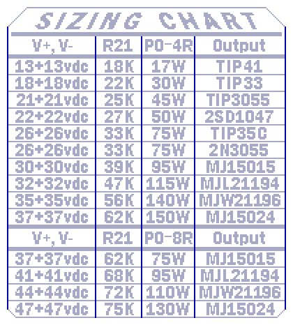

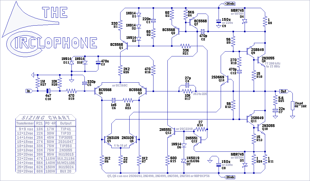

As promised, here is a schematic outfitted with a convenience chart to match up parts with potential (and your resistor divider could be added). Engineers won't need that chart, but constructors might like it. Notice the heavily de-rated output devices, could exceed safe operating area if pushed to somewhat audible clipping. For example, the reasonably clean 4 ohm power output is almost the same as the 8 ohm clipped output; however, the explosion happens if 4 ohms and clipping. At some point it would be useful to "ride the brakes" rather than ever larger output devices at ever lower voltage. Or, as an alternative, we could try some of those massive brick looking IGBT's that Fuji makes for RV generators. 🙂 However, I think that your two diodes and resistor divider is more reasonable. I would like to implement that without a trimmer dial; however, I'd need some example resistor figures (at least 2 data points) for success.

Here are two further possibilities for replacing R21: a plain vanilla 1 transistor CCs, and an improved one with a zener.

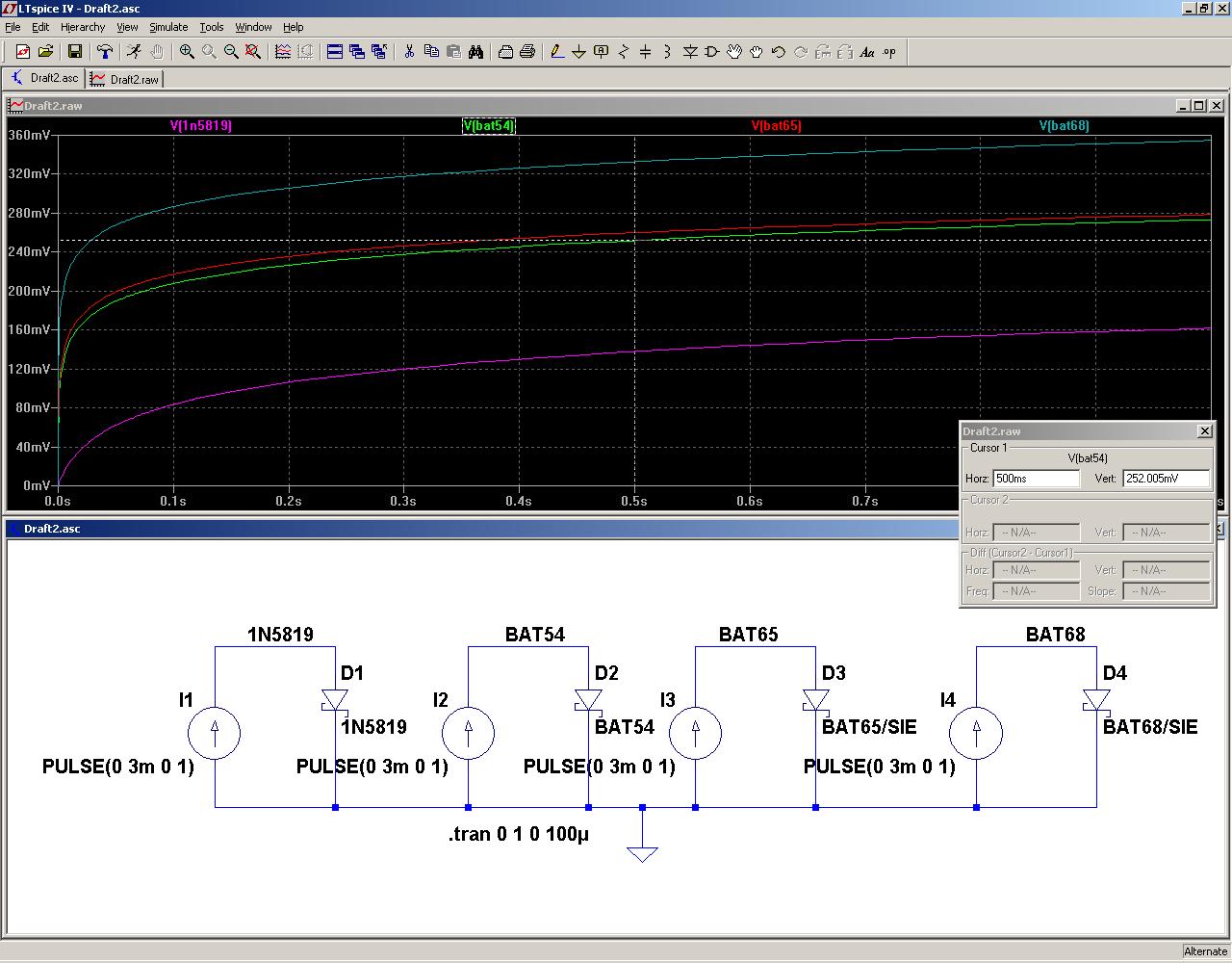

I missed something important yesterday: 1N5819 is not a suitable type for D7, it is a power diode with a very low Vf at low currents, and there is a very real risk it clips too early, fooling the bias servo into believing the current in Q10 is too low.
This will have disastrous consequences, as the servo will send the maximum current into both OP devices, destroying them in a matter of milliseconds.
Only signal schottky's should be used there, with a maximum current rating of 300mA or less.

The 1N5819 is NOT a signal schottky, it is categorized as schottky rectifier.

Where do you see that diodes "start" somewhere? They have a logarithmic voltage/current characteristic.
Here is a comparison between various types for a current swept between 0 and 3mA.
At 1.5mA, the Vf should not be lower than 250mV. The actual danger zone begins at 220mV.
Diodes like the BAT54 (300mA) just fit. The 1N5819 is completely on the wrong side of the fence

How do I calculate R21 from DC? I've used your guidelines posted here: http://www.diyaudio.com/forums/solid-state/189599-my-little-cheap-circlophone-4.html#post2688812 for some of the examples and then attempted to extrapolate the rest.
So, here is the chart by itself (temporarily large), along with a new question of how much DC voltage can we use when specifically 8 ohm speakers?
