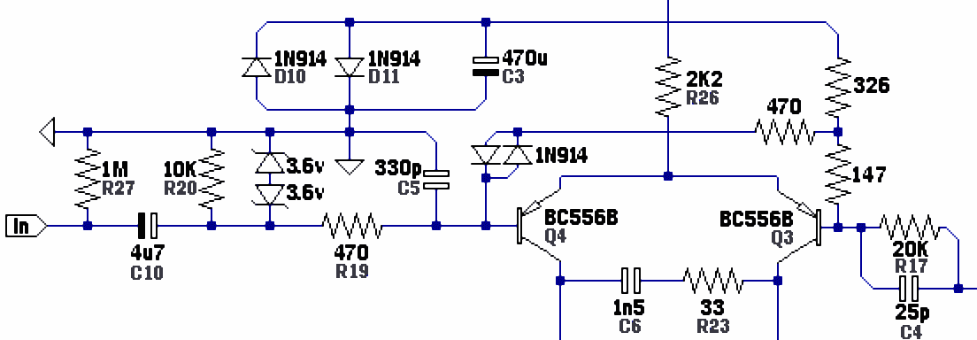

Here is the input system that I'm using right now.
I'm not sure if the zener protector (parallel with the 10k input load) is the right value for everyone? How much voltage does an ordinary CD player output? Well, the computer likes to output a lengthy, subharmonic noise during start up and power management cycling, causing "x-max screen saver" and the zener thing shown, reduces those problems, and it blocks some RF, since zeners are modestly capacitive.
This has Ken's soft clip adapter too. I've modified it to remove ringing by adding a 470R resistor series to the diodes. A 1k didn't work there (neither ringing nor soft clip), so I picked up the 470R from the desk and used it. A smaller value, like 330R, probably works similarly.
That soft clip adapter does soft clip as shown. Man, you can really crank it up. For reference, I have 31v rails and an effective 70w is no problem, but now it does that cleanly. The resistors on that divider are 150R with 330R but I hunted through a few with the ohmmeter till I found some that came up a bit short so that the total would be really close to 470R, since the divider has replaced R16.
