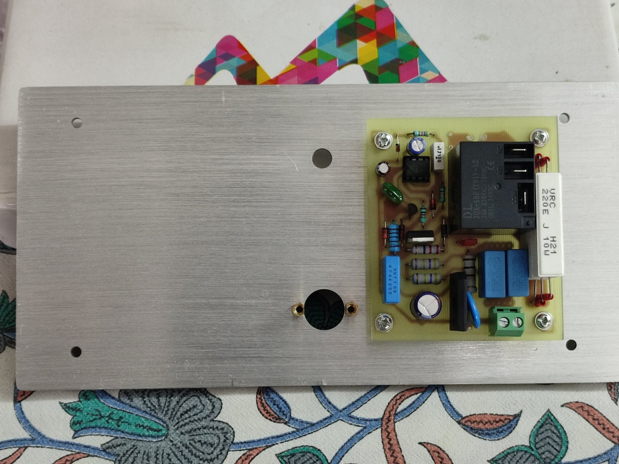

I still have to check my speaker protection circuit, this will be having the power on delay for speaker connect.

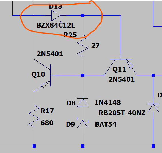

Could it be coz the blocking zeners are 10 volt each.

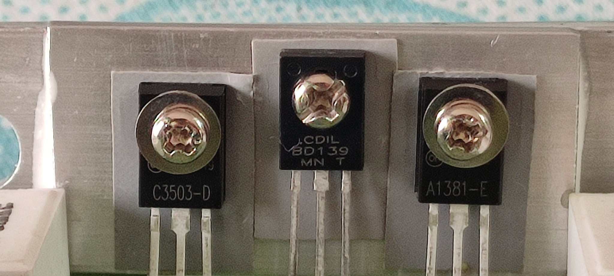

I am observing that even with mica sheet or keratherm I have resistance of 66 to 118Mohm but only collector to heatsink.
I tried it with compound and without compound
I am not able to get around this.

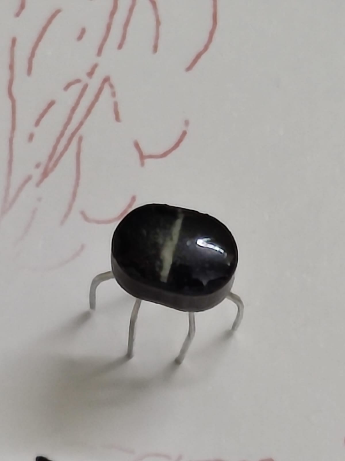

I have used MPSA42 transistor for CCS in the MOSFET build and have found that a sufficient amount of heat is dissipated across this transistor. Although this setup is stable for a supply voltage of 35v DC in my MOSFET version for a long time. I have an idea to reduce this dissipation and intend to put a 12V zener in series with the CCS circuit to block atleast 12v to reduce dissipation across CCS transistor.
I have observed in the simulation that with this arrangement the CCS current is reduced slightly and quiescent current is reduced by a meagre ~ 1ma, the THD is almost the same.
I need your advice whether this arrangement will be suitable for a higher rail voltage of say 50V DC and would be stable in the longrun.

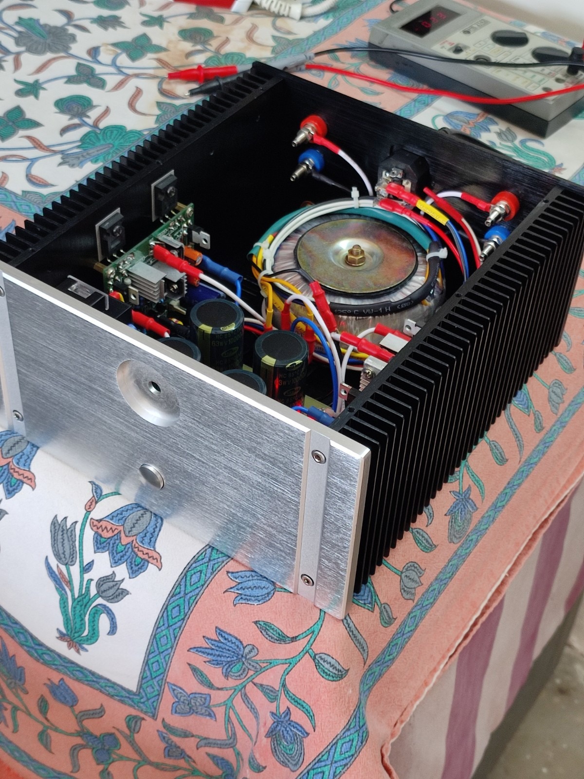

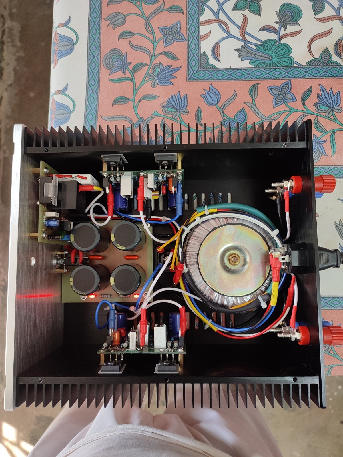

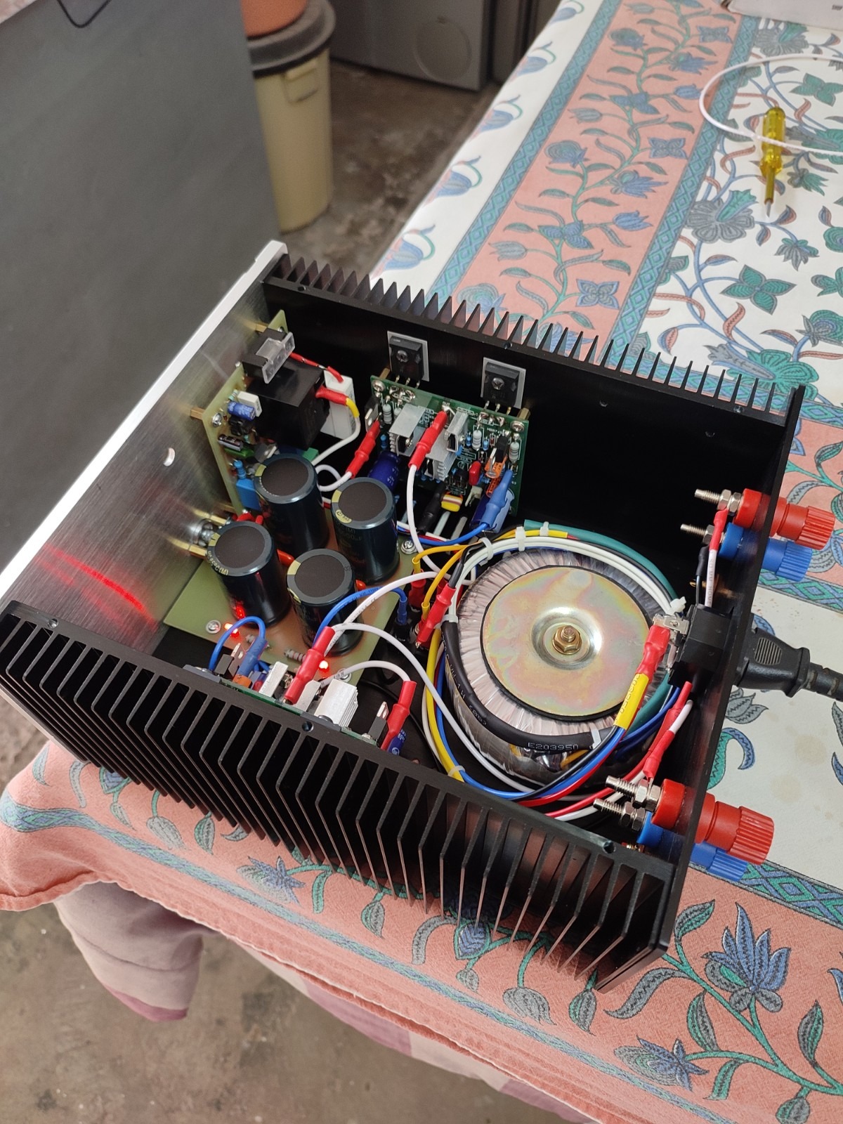

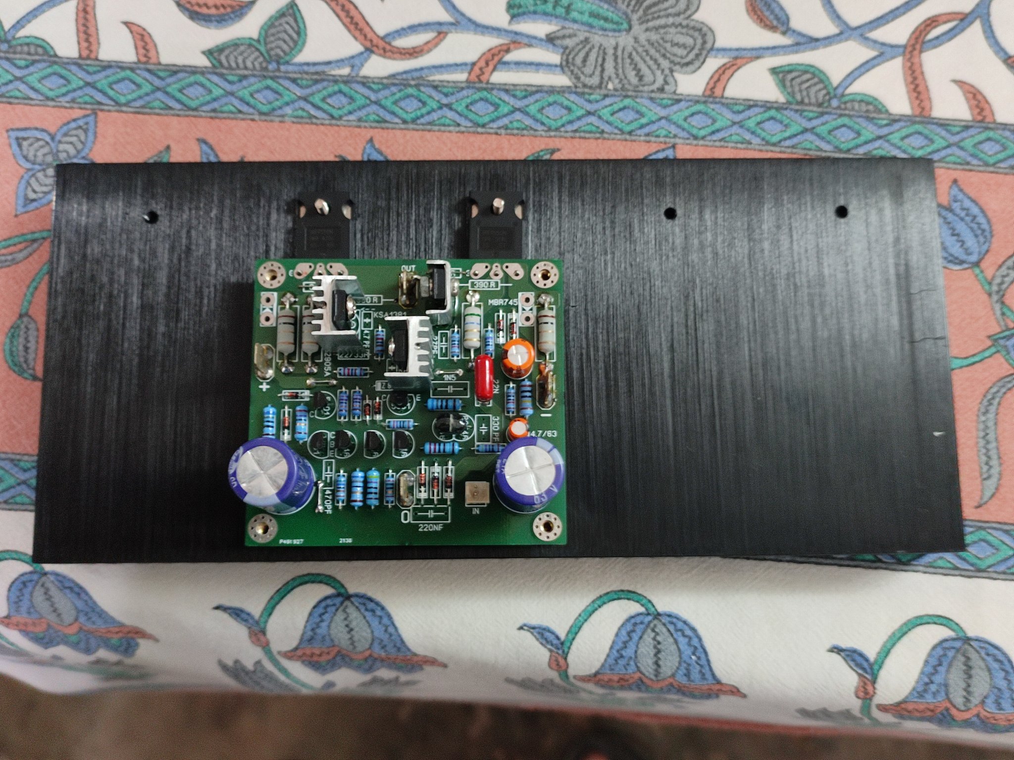

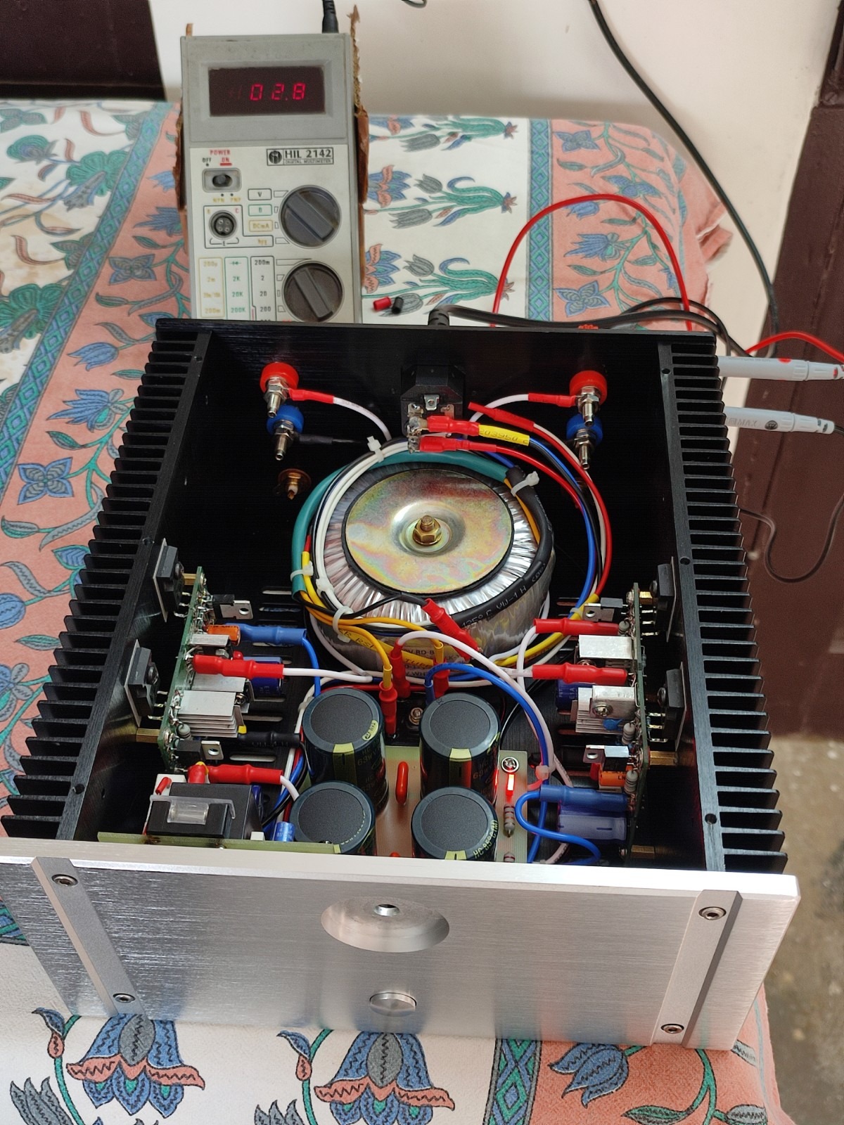

Nice build!Mr Elvee,
The excellent performance of my previously built MOSFET Circlophone prompted me to build another Circlophone but this time on a proper Class A all aluminium chassis. The last one was built of a salvaged metal cabinet where in I could not fit large heat sinks for output devices. Even with inadequate heat sinks the amplifier is working very well till today.
This time I have checked all components like resistors, capacitors to their actual value and even matched input and VAS transistors on component tester. I have glued input pair transistor BC546B with heat sink compound and bonded them with Araldite. In this build I have used Cascode transistor KSA1381 instead on Zener diode.
I have used soft start circuit to prevent inrush current.
Although this chassis has a provision for Volume Control but I will not use it since putting volume control at the input increases distortion even with a low value of 5K pot.
The build has following parameters;
1. Rail Voltage - 32V
2. Offset Voltage - between 3-4 mV (Both Channels)
3. Quiescent Current - ~164ma (input short)
Components Used
1. Transistor BC546 - CDIL India
2. Transistor 2N5401 - KEC
3. Transistor VAS KSA1381 (ON Semi)
4. Transistor Cascode KSA1381 (ON Semi)
5. Transistor CCS - MPSA42
6. Power Schottky - MBR745 (Taiwan Semiconductor)
7. Signal Schottky - BAT85
8. Output MOSFET - IRFP240
9. Current Sensor Resistor - 1Ohm MOF
10. Other Resistors - MFR
11. Toroidal Transformer - 24-0-24 5 Amp
12. Rail Capacitors - 2 pair of 10000MFD 63V (Samwha)
Both channels are silent with no input.
Again thanks for your excellent schematic design.View attachment 1153590View attachment 1153592View attachment 1153599View attachment 1153601View attachment 1153602View attachment 1153603View attachment 1153608

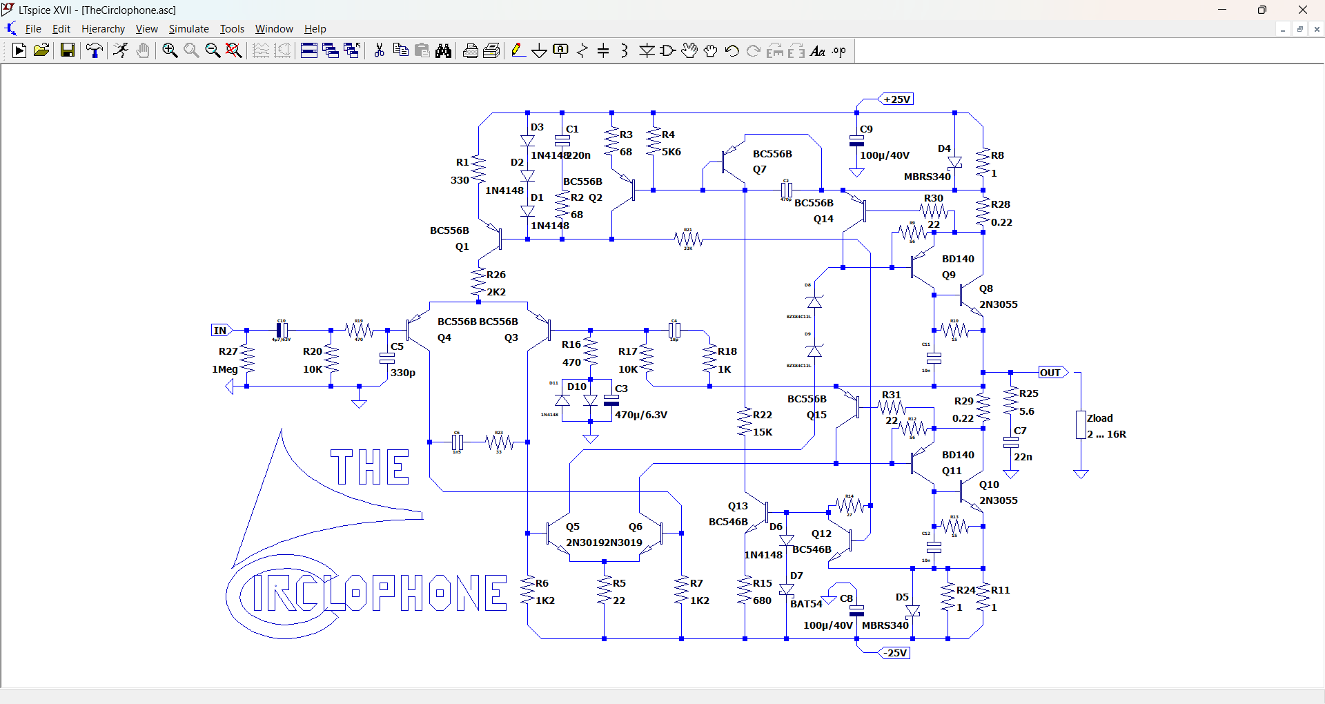

Following a request from Aditya, here is an example of an output protection circuit. It is extremely basic, and simply limits the output current (no SOA protection, etc), but you get the idea. You are free to add more bells and whistles of course.
Sorry for the quality of the graphics: importing a schematic into LTspice XVII from earlier versions doesn't work well, but you can see the protection transistors Q14 and Q15:
If possible, I would try to fit a copper sheet (say 2mm x (50mm)^2) between the output devices and the heat sink. By using a live connection between the drain tab and the copper, that way you can increase the heat conduction of the insulator across the copper and reduce the thermal bottleneck.
(It could also be aluminium. The worst case is where the insulator is connected directly to the device, so all of the heat has to pass through a small area before reaching the heat sink.)
It wasn't a criticism of his build, just a free idea I like to throw out there whenever I notice it might be possible to squeeze a bit more performance out of the heat sink.
I could not understand your suggestion correctly. You mean to say that put another sheet of aluminium between Transistor and the heat sink. but then there will be one more interface where heat sink paste or any thermal insulator would be required. In such a situation the inter sheet must be smooth and should perfectly fit on the heat sink without any air gap.If possible, I would try to fit a copper sheet (say 2mm x (50mm)^2) between the output devices and the heat sink. By using a live connection between the drain tab and the copper, that way you can increase the heat conduction of the insulator across the copper and reduce the thermal bottleneck.
Have you practically made such an arrangement and have achieved any benefit out of it?
I have used silicone insulators between transistors and the heat sink. My build is connected to the power supply for more than a week now without any speakers connected to it just for testing heat run issues if any. I am not facing any thermal conduction issues as such.
Thanks for your suggestion. I would definitely consider your suggestion in my next build.
Almost but with a live connection (maybe even soldered) between the transistor and the plate, and multiple plates if the transistors cant be connected together. Kind of like:
