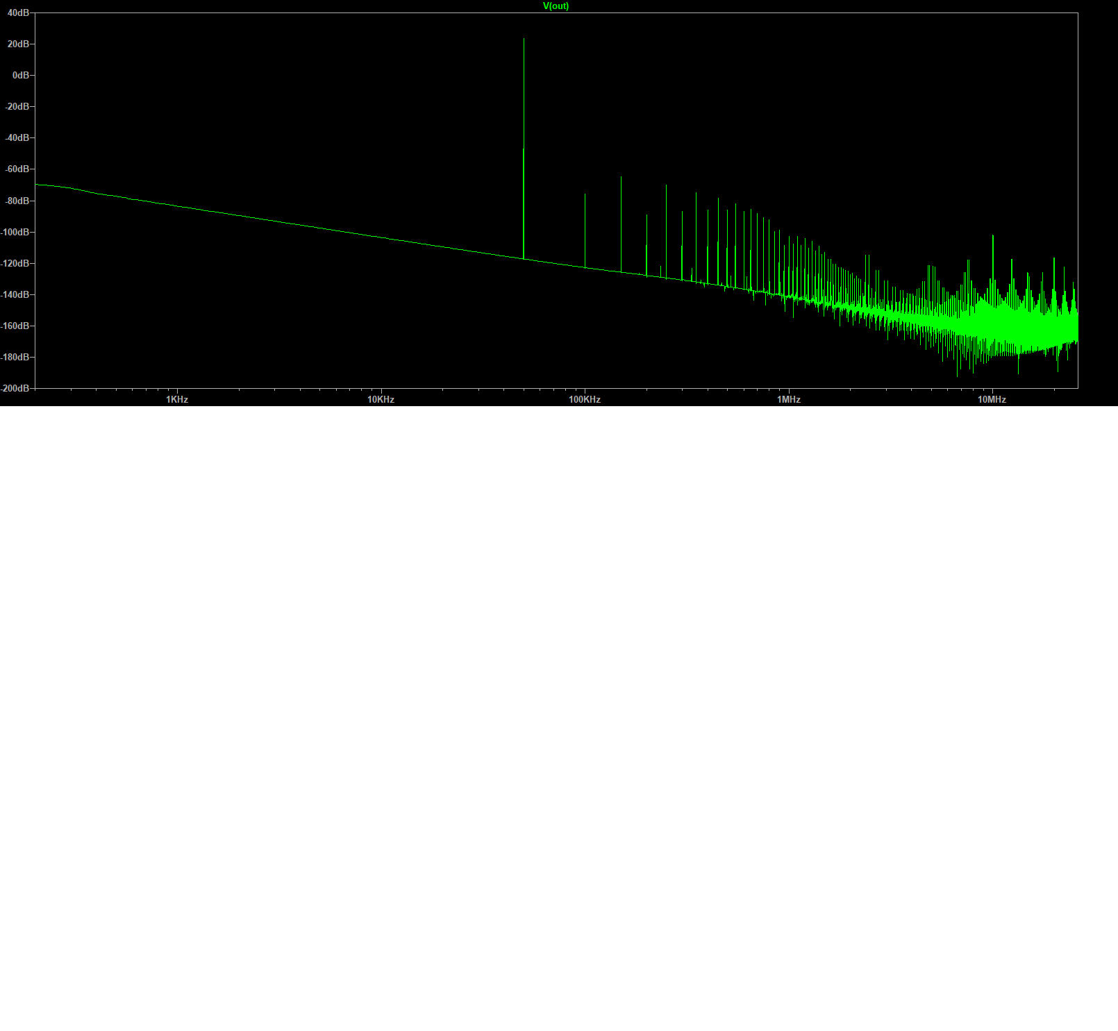

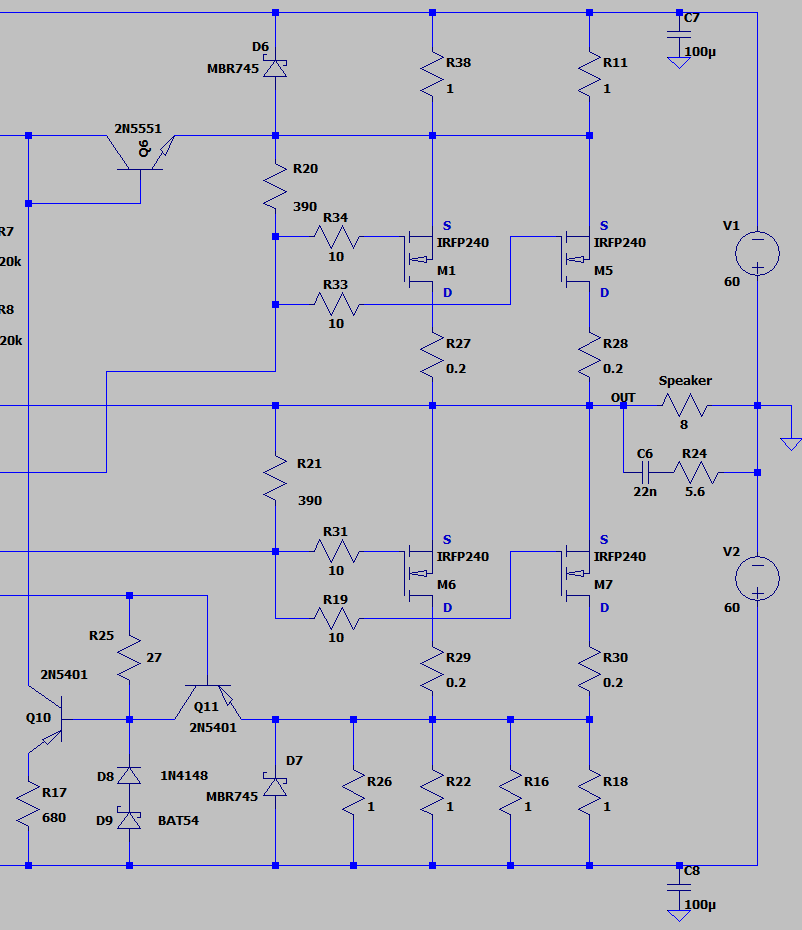

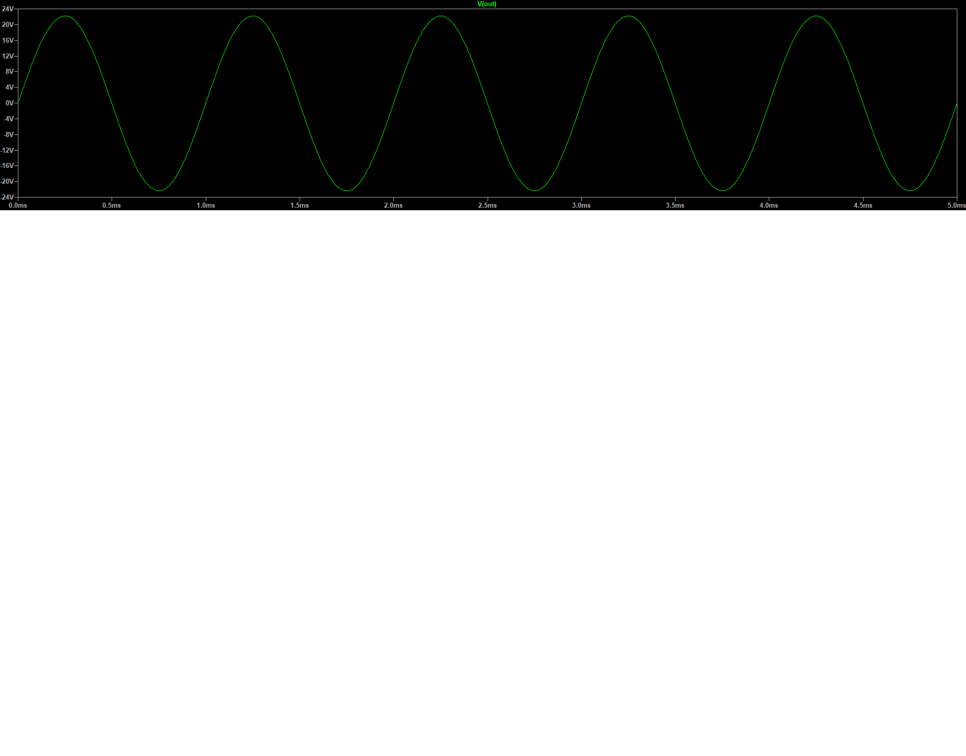

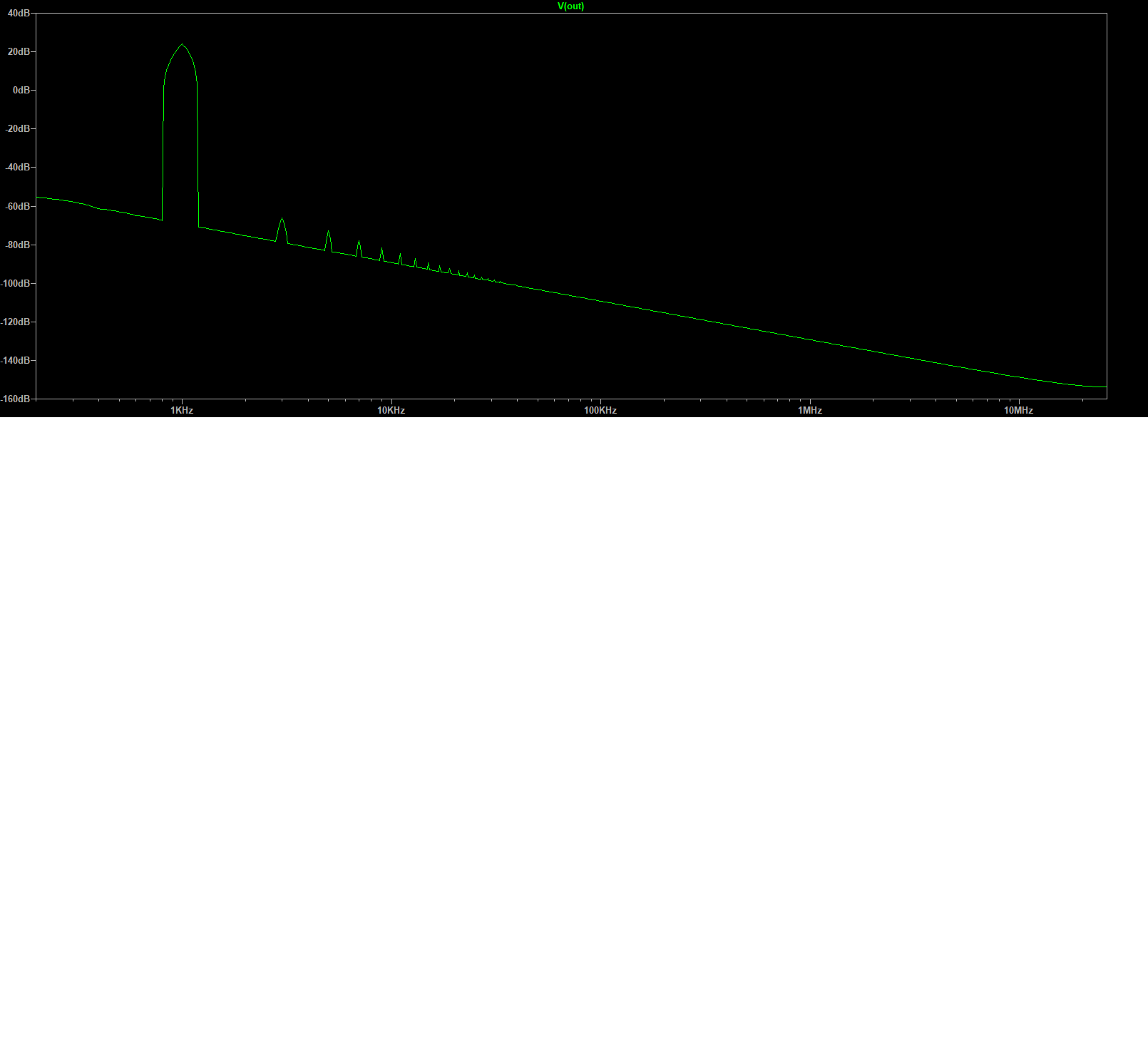

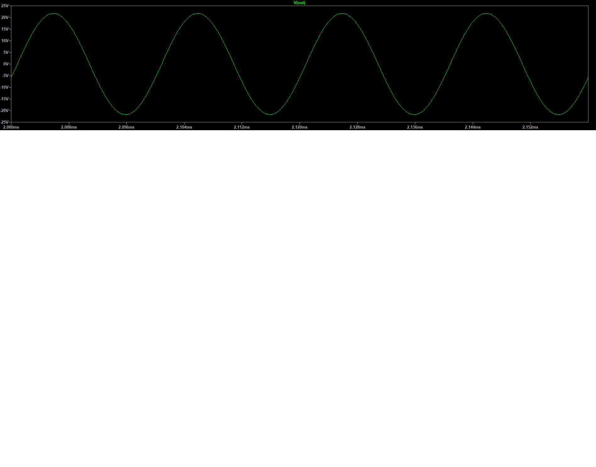

I searched data of so many MOSFET to make a high power MOSFET version of Circlophone using single device but could not find suitable MOSFET for the same. Some IXYS MOSFET have higher power and current rating but their SOA was not that good and are very expensive. I therefore decided to make higher power version by paralleling two IRFP240 MOSFET together.
I have added another set of current sensing resistors with the exixting one to keep quescient current of each MOSFET same. I have added 0.2 ohm resistor in each of the MOSFET Drain to limit the current and for better sharing of current. I have also added 10 ohm gate stopper resistor in each MOSFET Gate. I have procured higher current rating power schottky MBR1645.
The simulation results seem good. I am attaching the out put wave form and FFT waveform for 1khz and 50khz. The THD is around 0.003%.
I need your technical advice for this modification whether this is suitable from the point of view of stability. If you approve it then I will modify my exixting
prototype board for the same.
With MOSfets like the IRFP240, the matching is much more important than any balancing resistors: they just act like icing on the cake when the matching is done properly.
They are useful for avoiding differential thermal runaway, but if the FETs are mismatched they will do nothing useful
The resistors, if you use them, should be placed in series with the source: that's where the effect will be maximal
