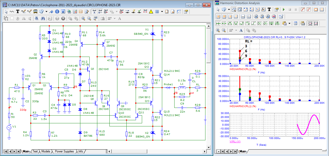

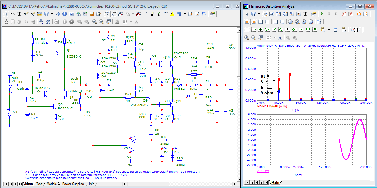

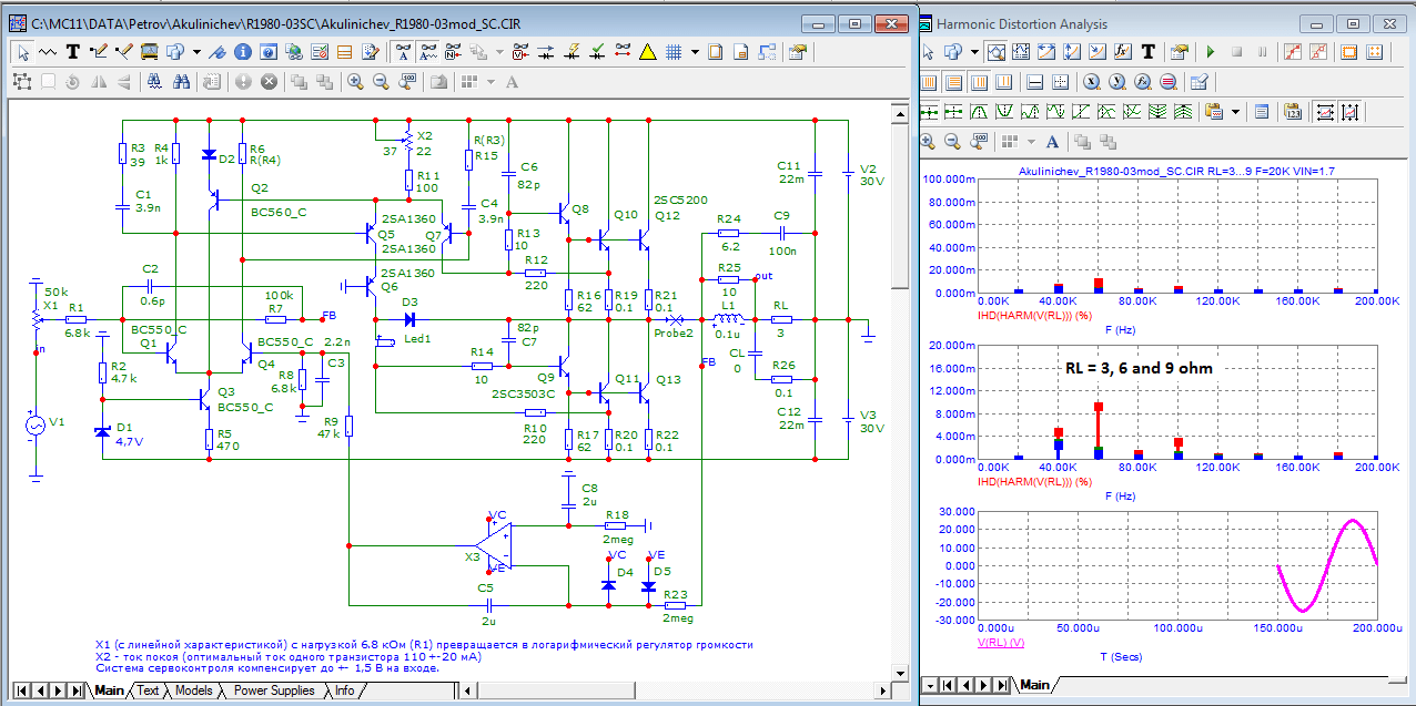

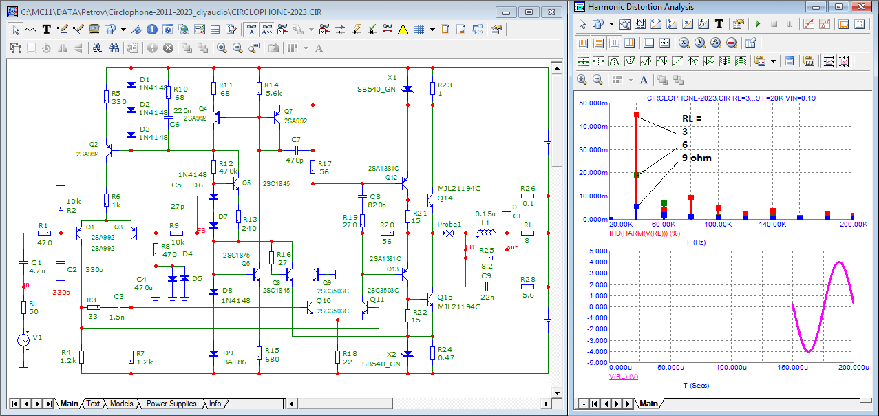

Everything has long been invented before us. Here is a model of a similar amplifier published in 1980.
Many developers attach great importance to the quality of work at low power.
Compare the two options.
And here we go again…
Please open your own thread comparing amplifier simulations rather than polluting this one. Thank you.
This is not my design, I just gave food for thought. If someone is annoyed by such information, then do not read, pass by. There is a patent for a similar amplifier structure, but I can’t find it now. Sometimes, instead of inventing the bicycle, it makes sense to look at what has already been invented. I end with this. Thank you for your attention.Please open your own thread comparing amplifier simulations rather than polluting this one. Thank you.

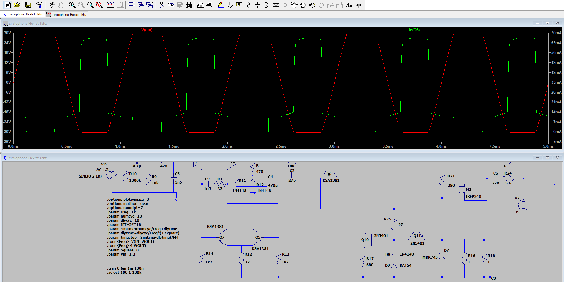

Mr Elvee, I need your expert openion on a possible modification to prevent VAS current overloading in case of an input over voltage at the input. In the MOSFET version I find that when the input signal rises to say 2V the VAS current in the cascode transistor rises to around 70ma from 13ma (slide1).

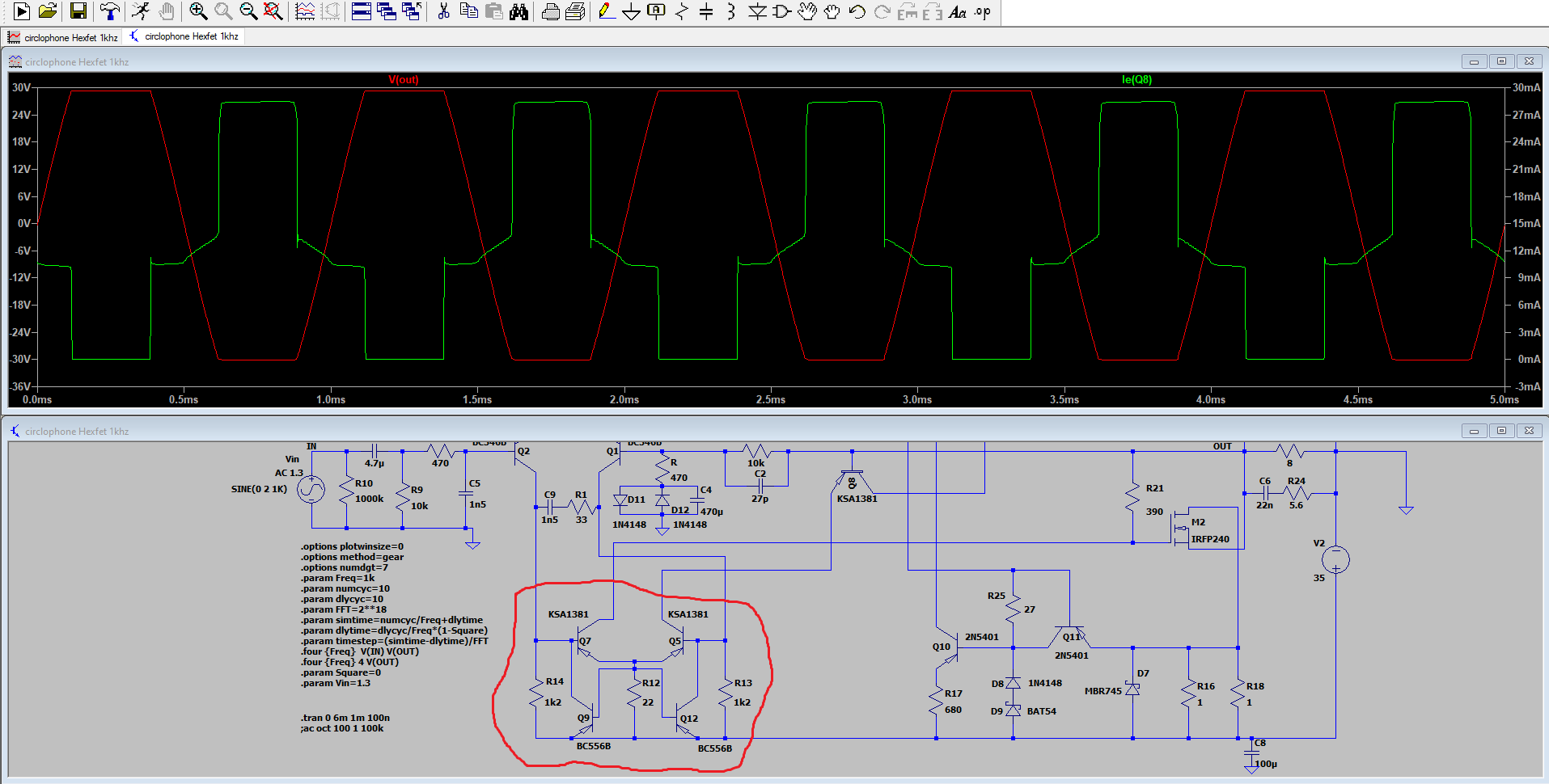

I have done a slight modification to the VAS circuit and added two transistors in the VAS circuit to bypass the excess current going to the base of VAS transistors in case of over voltage at the input (slide 2). I have found that with such an arrangement the current through cascode transistor reduces to around 30ma from 70ma at 2V input signal voltage. In such an arrangement the output signal is perfectly clipped as was previously without this arrangement. The THD does not change with this modification.
How would this modification effect the performance and can I implement this modification in my build.
I shall be thankful for your reply on this issue.

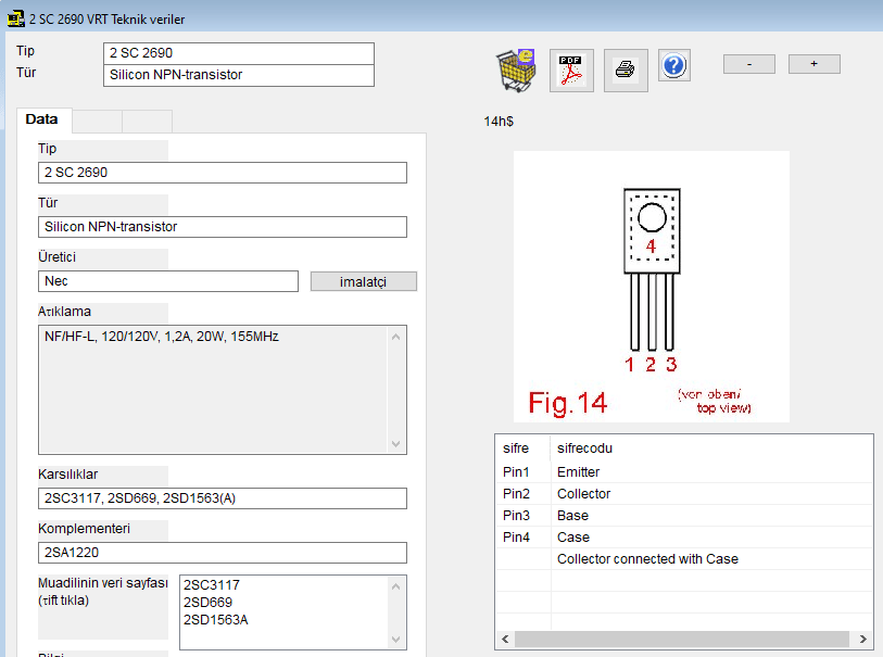

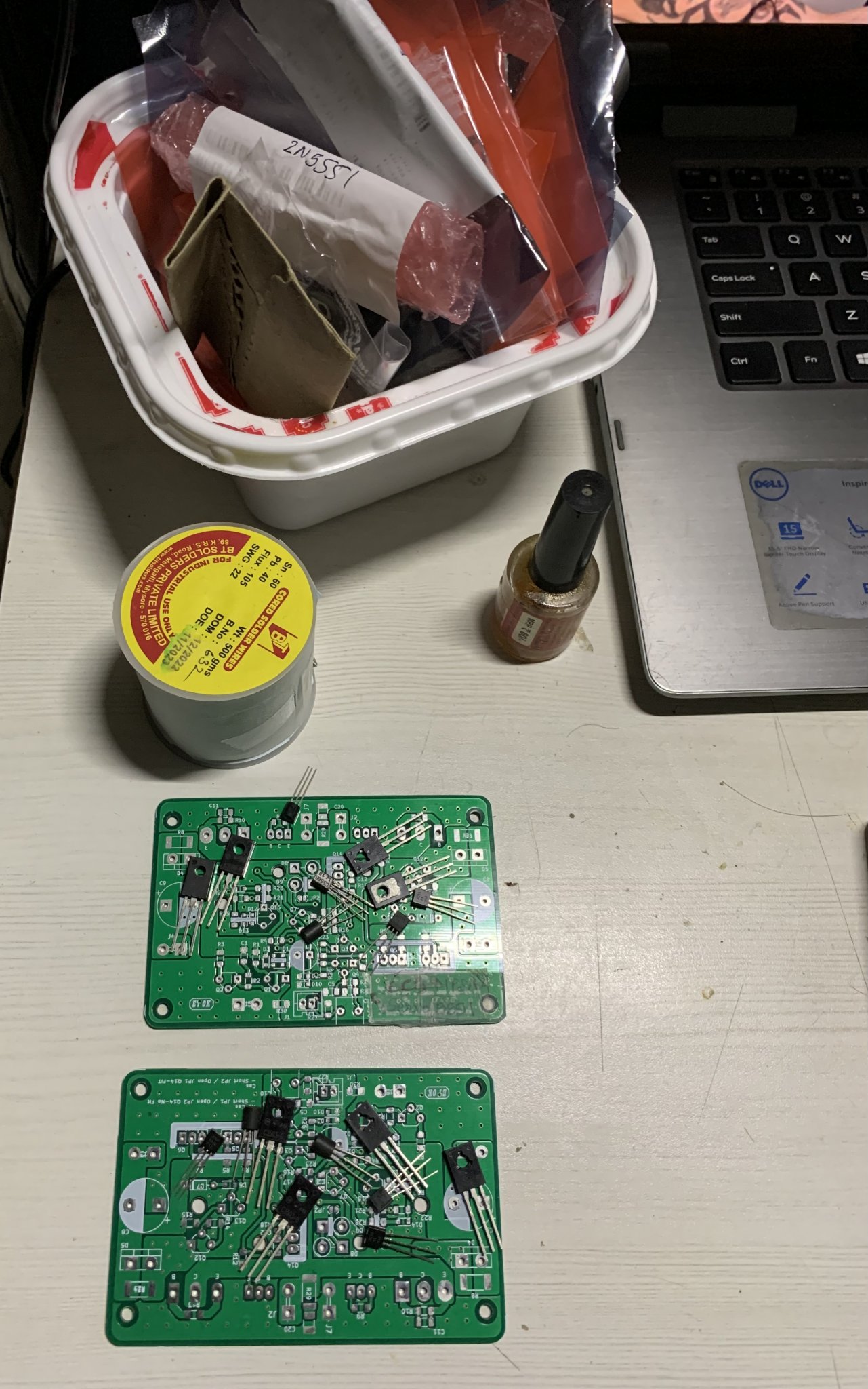

Hi OscarCongratulations for the, yes you can say full amplifier combo, looks very good ! Really very good (super) !
Also thanks for using the PCB layouts I provided.
Yes, the transistors 2N3019 are hard to get, I would have had to make a small change in my layout so that you could also use other transistors Q5,Q6 e.g. in the TO 126 housing. I use 2SC2690.
Thanks Oscar
You used 2sc2690 instead of 2n3019. In the semiconductor comparison table it says 2sd669 can be used instead of 2sc2690.
My question is, will we solder 4.7pf cap between 2sd669 base collector?
I am sure you can implement it: it is completely transparent during normal operation, and only kicks into action when overload occurrs.How would this modification effect the performance and can I implement this modification in my build.
IIRC, the problem has already been raised and examined, maybe by Kenpeter.
There must be an alternative solution somewhere in the thread, by yours is perfectly acceptable
The capacitance is 14pF, which is more than enough.Hi Oscar
You used 2sc2690 instead of 2n3019. In the semiconductor comparison table it says 2sd669 can be used instead of 2sc2690.y question is, will we solder 4.7pf cap between 2sd669 base collector?
The 2SC2690 has 26pF, which is marginally too high
ThanksI am sure you can implement it: it is completely transparent during normal operation, and only kicks into action when overload occurrs.

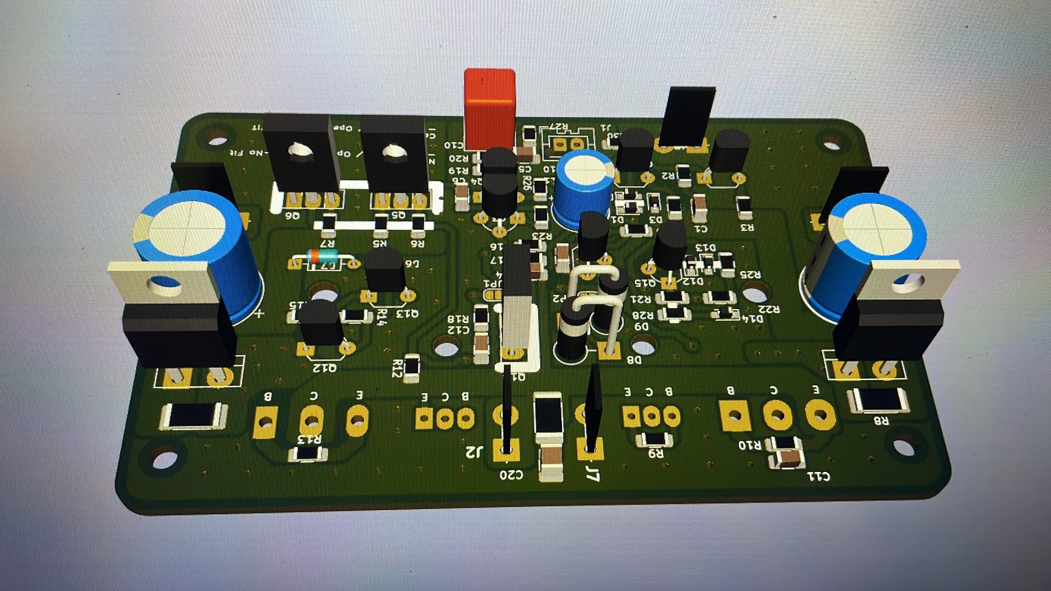

was working on a powersupply board with protection, finally i think its done. But DIY is never Done.
Edit - Right after i finished posting it, I realised I need to add LED for Speaker Protection.....
Should I add a 0.22 or 0.33 ohm resistor between the Power caps.
its a simple UPC1237 based circuit with T90 relay as well feature where in a user could use SSR instead of Relay.Looks a well designed board but for the benefit of the boarders what is the other circuit on the left side of the board. is it a speaker protection circuit and if so on what circuitry is it based?
once tested by me , This could be available as GB
It can help in reducing the current peaksShould I add a 0.22 or 0.33 ohm resistor between the Power caps.
