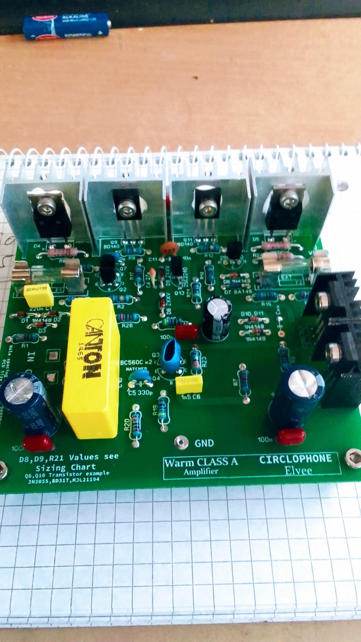

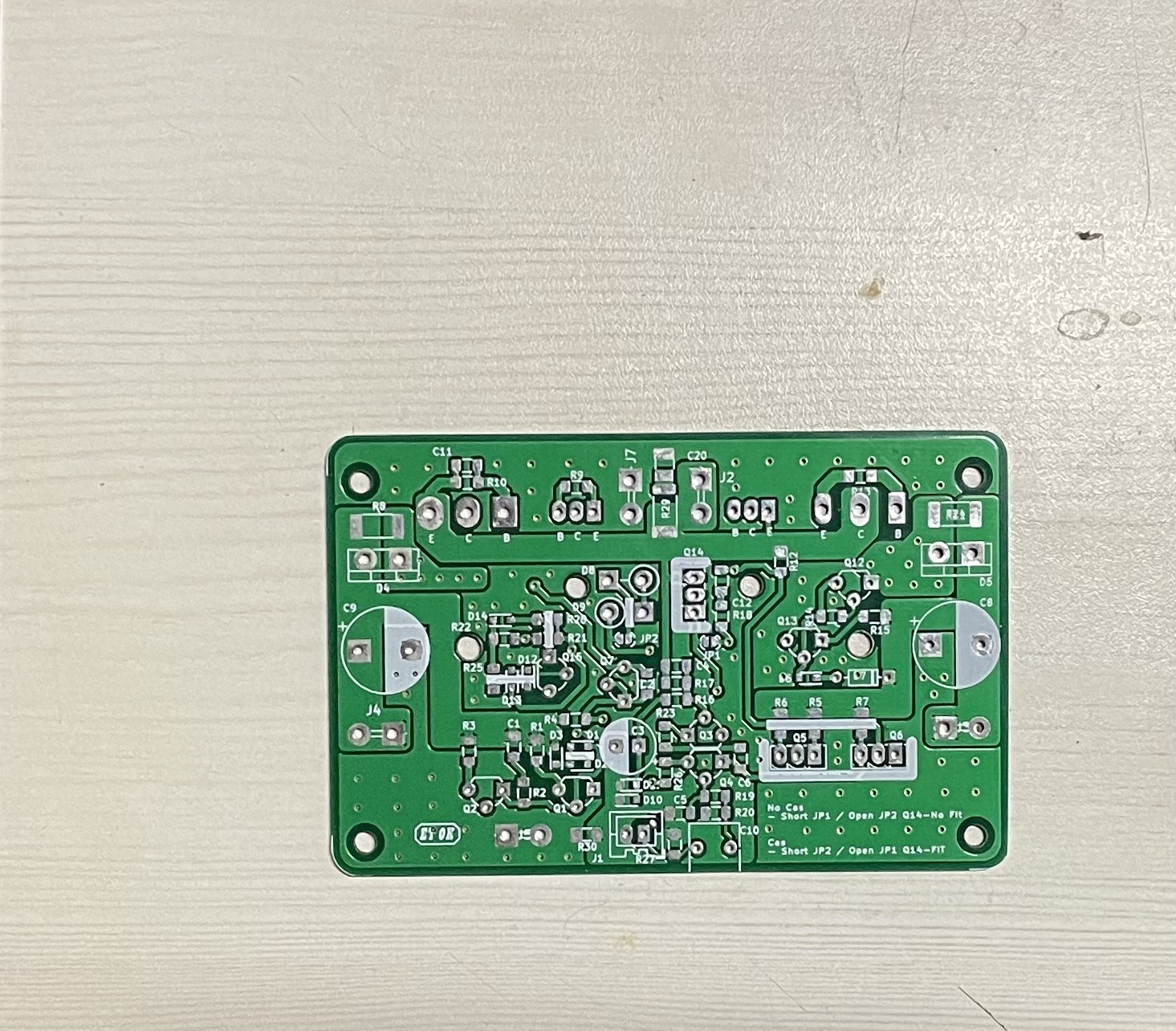

hoffe ihr hattet alle einen guten Start ins neue Jahr.
Hier ist eine neue PCB-Version von mir und Stallion.
Hengst, mein Freund, wollte eine Version mit Sicherungen und im Format 100*100mm.
Er möchte jedoch nicht, dass diese Version im freien Open Source landet.
Bei Interesse schreiben Sie mich direkt an.
Danke OSGO

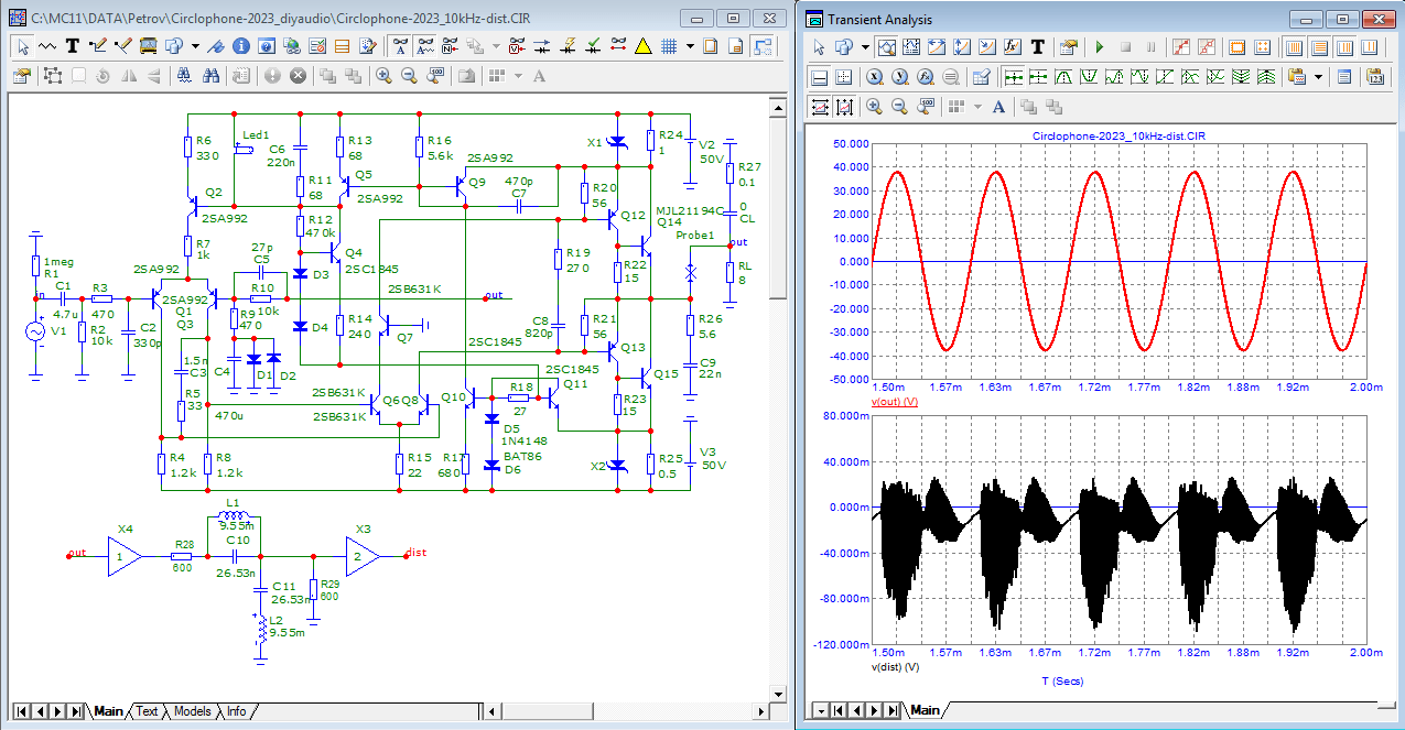

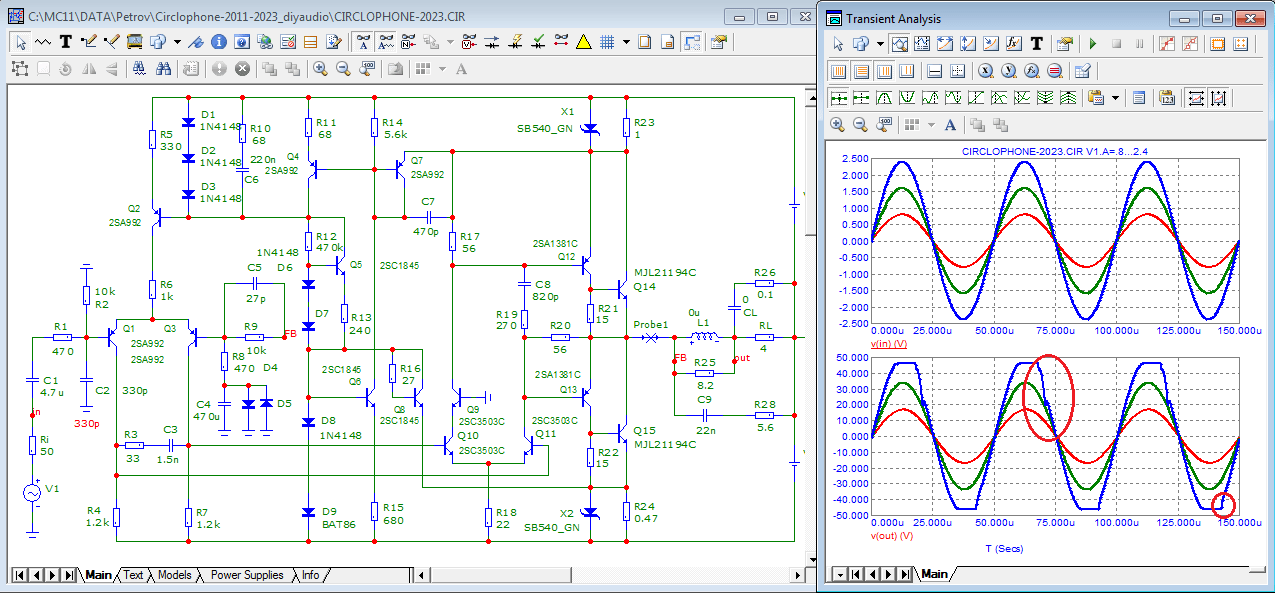

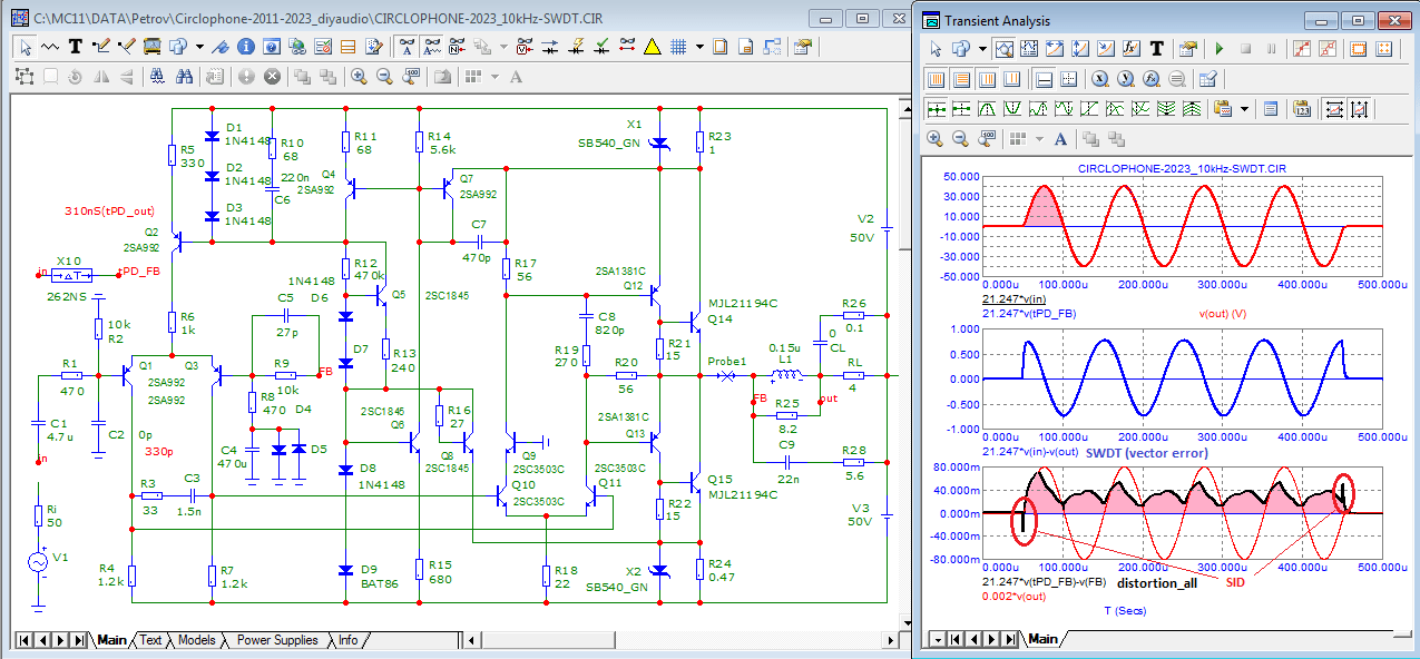

without inductance at the output, the performance for a real load is in great doubt - there are no phase margins.Hi @minek123

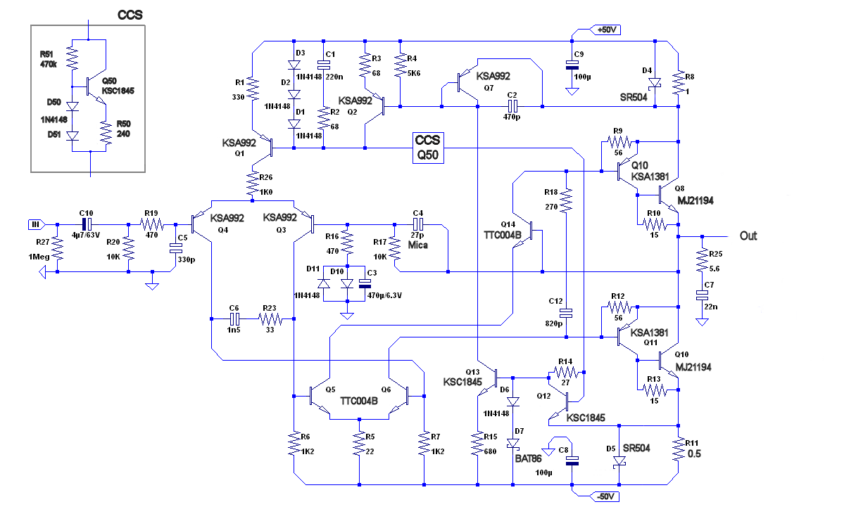

I am building my own board and want to use the Cascode implementation for the BJT Circlophone. I know you posted a schematic for the same in one of the previous posts.
1) How does it work, with reference to distortions compared to using 2 Zeners?
2) Also is there a difference in working for the CCS shown in the schematic vs the one below this line.
Could you or Elvee guide me to the correct one? The idea is to be independent of the supply changes if needed due to some unforeseen reason one being output power transistor availability.
Could Elvee or You explain how the Cascode transistor works? Does it work like a variable voltage-blocking Zener diode? I am pretty new in this discrete amplifier side.

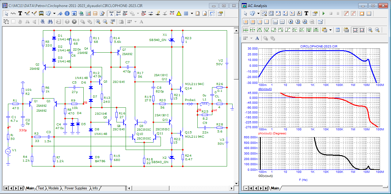

Large signal propagation delay time - more than 400 ns. Preferably no more than 100 ns.

Which software is used for this simulation as it does not look like LTSpice?

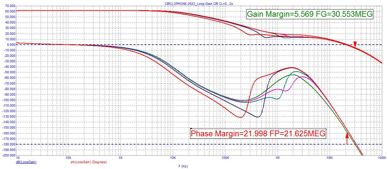

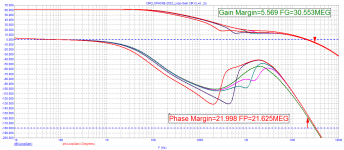

How is this Phase and Gain margin going to affect Circlophone performance in real world?

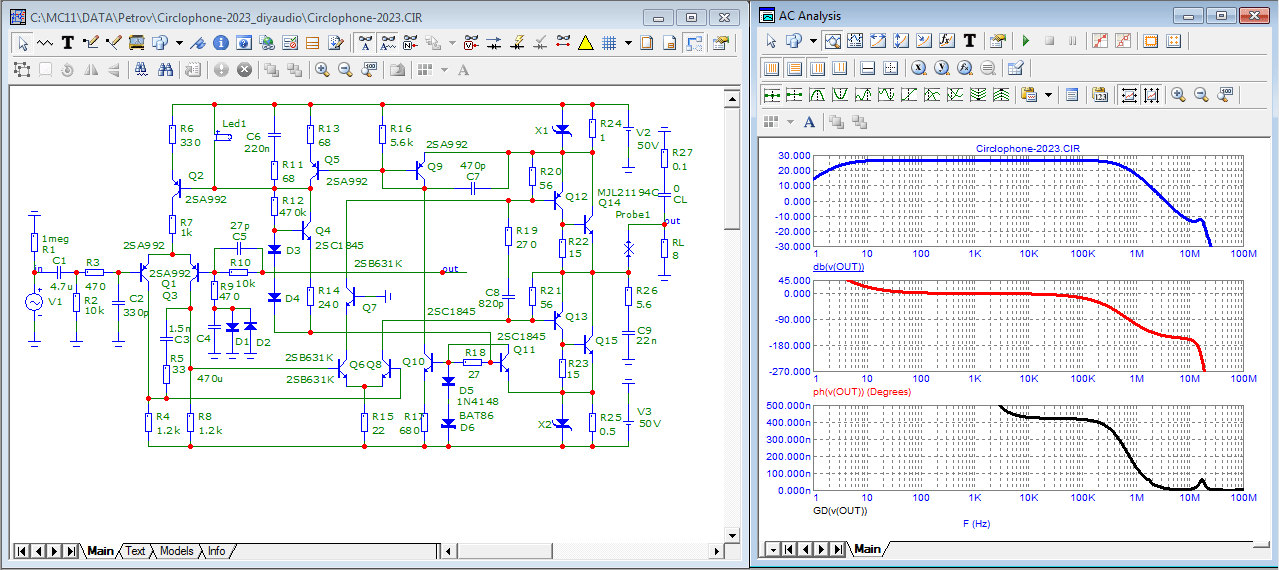

IIRC (it is more than a dozen years ago), I tortured my prototypes with all sorts of reactive loads, with a large square wave output signal, and they remained well-behaved without series inductance, but depending on the build, components, etc. your mileage may vary.without inductance at the output, the performance for a real load is in great doubt - there are no phase margins.

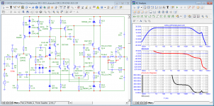

Propagation and group delay aren't exactly the same thing, but anyway delay by itself is not problematic: it happens all the time in transmission lines, free air transmission, digital processing blocks, etc.
What is important is the constancy of the delay vs. frequency, or in other words a linear phase.
Your phase plot shows that the phase remains close to 0° for the whole audio bandwidth, which is what really counts.
If the GD of 400ns disturbs you, it can be tweaked by changing the values of the filter and coupling caps, but from an audibility POV, the effect is going to be minimal

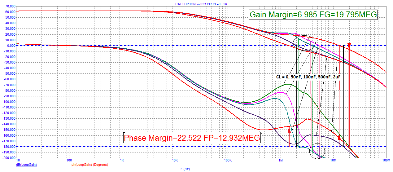

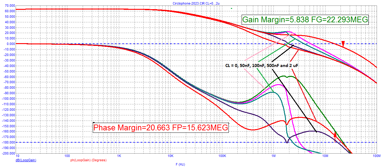

With regard to sustainability requirements, practice suggests that the minimum reserves to ensure sustainability should be as follows:Hi Petrov,
in phase - at least 30 degrees;
in amplitude not less than - 3 dB.
Moreover, these reserves should be at any real load. In tests, a reactive load is most often used in the form of a capacitance in parallel with an active resistor.

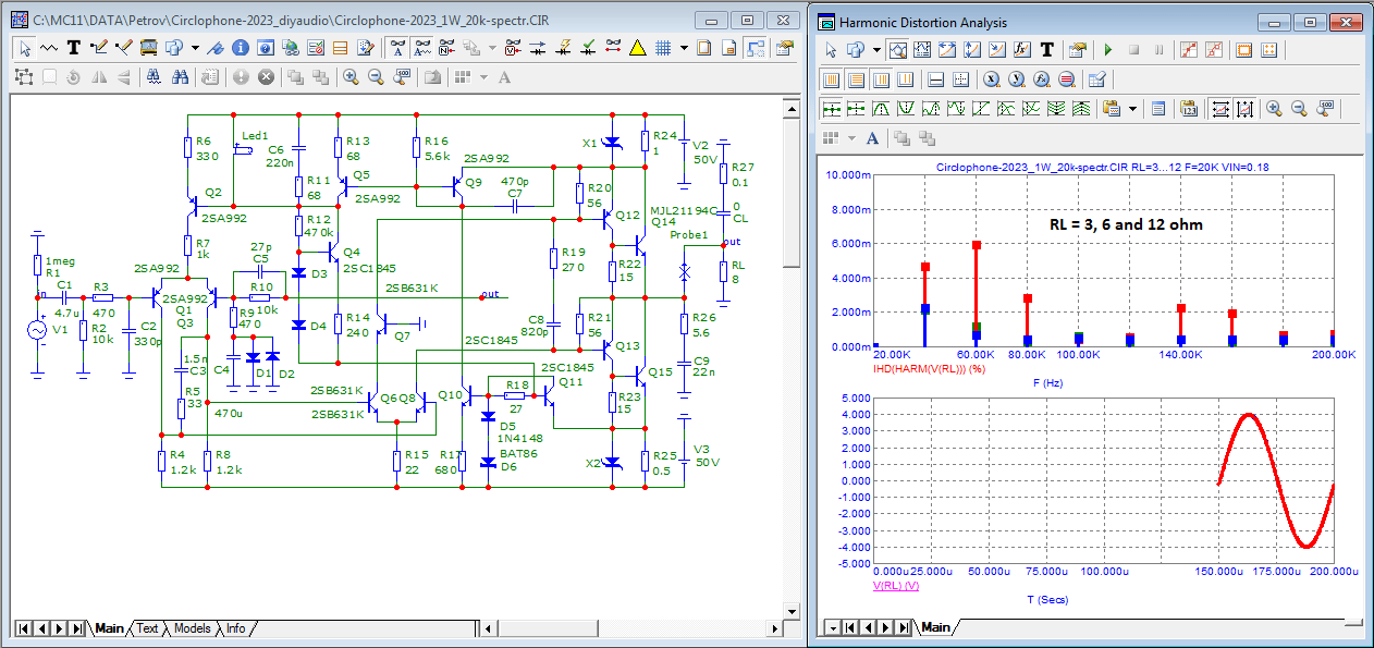

View distortion products at 10 kHz with a notch filter. You need to watch after 1.5 ms - after the end of the transients in the notch filter.
If you look at the output voltage, everything looks beautiful, but at the filter output we see distortion products from the soft excitation of the amplifier.
Try the same test with 50nF, 100nF, 500nF and 2uF reactive loads

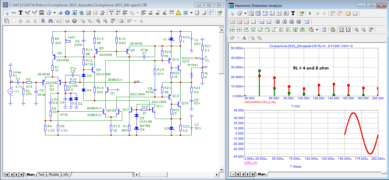

I double-checked the element values and ran amp model tests using Cordel's transistor models. There is no inductance at the output of the circuit, which is usually included to ensure stability when operating on a reactive load. A small inductance has a wire from the board to the output connectors. The linear inductance of a wire with a diameter of 1 mm is 1 μH. Therefore, even a wire 15 ... 20 cm long will have an inductance of 0.15 ... 0.2 μH. This inductance is often sufficient to ensure stable operation.

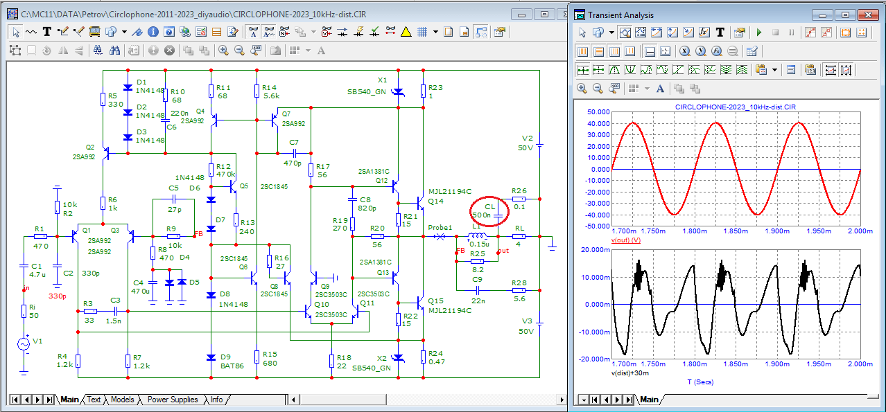

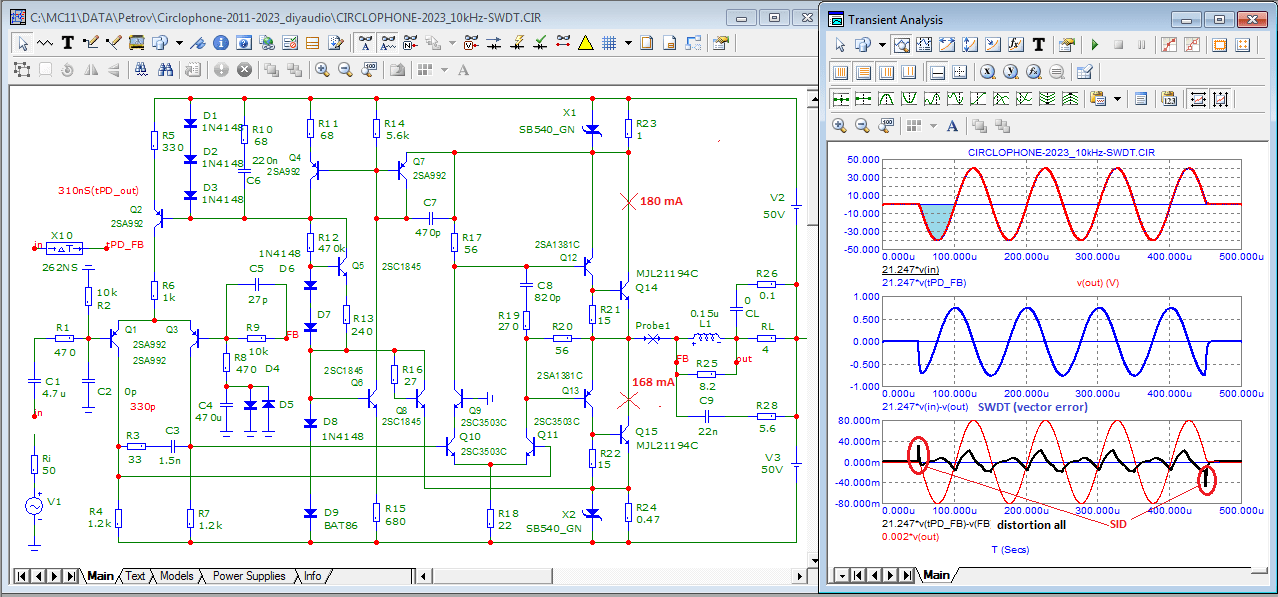

I simulated the operation of the model without inductance and with a small inductance.
In fact, models even from Cordell do not fully take into account all the features of real transistors. Therefore, the amplifier model can only give a signal (bell), which should be paid attention to when establishing.
Pay attention to the Hafler SWDT test.
With a positive first half-wave of the burst, there is a shift of up to 30 mV; with a negative first half-wave, no shifts are observed.
The model has small SID distortions (very short-term and amplitude not higher than non-linear distortions). I think that this is the merit of the high frequency of the first pole - above 10 kHz.
It should be noted that in a number of amplifiers, SID distortions exceed the products of nonlinear distortions by tens or even hundreds of times! I think that it is this type of distortion that has the greatest impact on sound quality.
