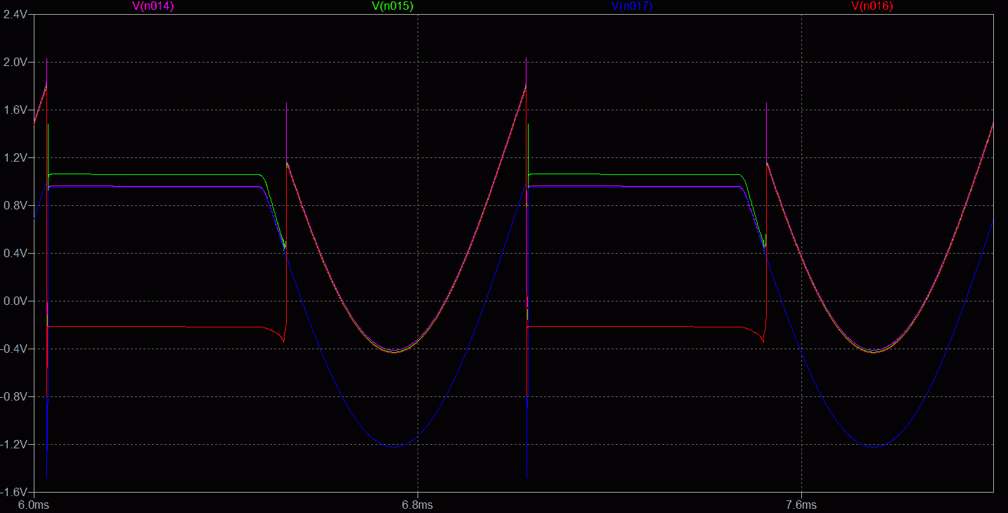

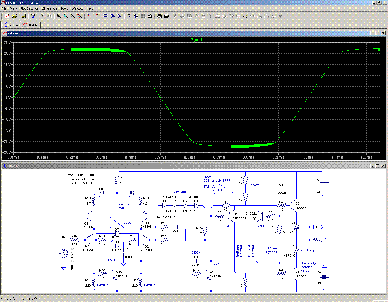

OK, I have disabled soft clipping, and overdriven to saturation and latchup.
You can see the active tail can and will rescue from the latched condition,
but only seems able to achieve this over half the input cycle. Better than
having to pull the plug and start over, I suppose....
While this was going on, the output looked a fully clipped squarewave, just
as you would expect from normal clipping. Output phase not reversed or
anything weird that would alert the listener to the temporary latch...

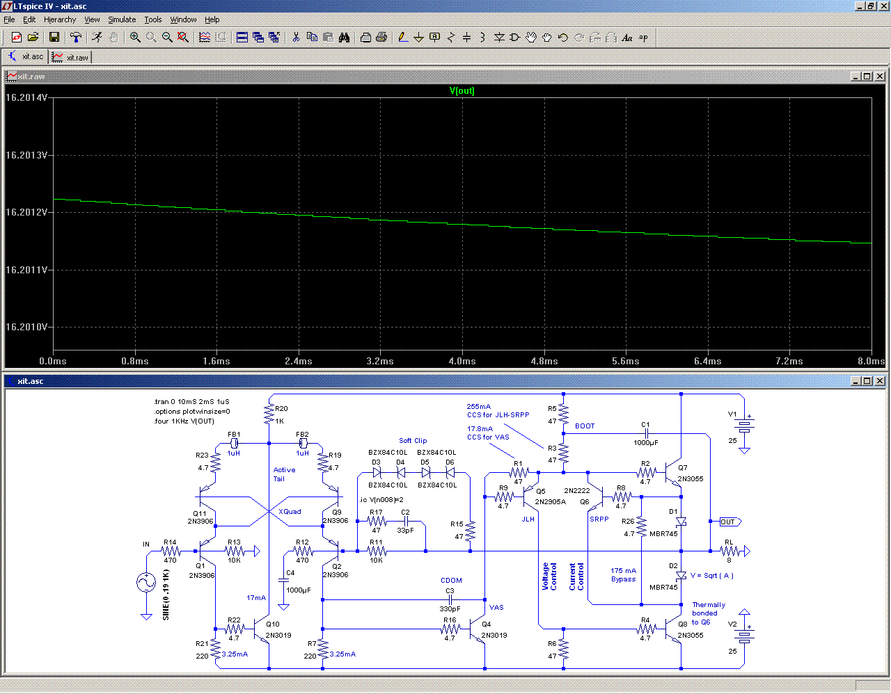

Here's what I got so far.
If you include the .ic, the circuit remains stuck.
This means that in practice it will, that's why clipping schottky's are indispensable.
Exactly what is this .ic thing are you including?
I thought you just meant measure collector current?
It is an initial condition.Exactly what is this .ic thing are you including?

An absurd experiment proved absurd... What was I thinking???
So I was wondering if I series x with another x, would -R's cancel?
And if both x' saturate in unison, reverse of reverse is no problem...
Doesn't latch anymore, but oscillates like mad...

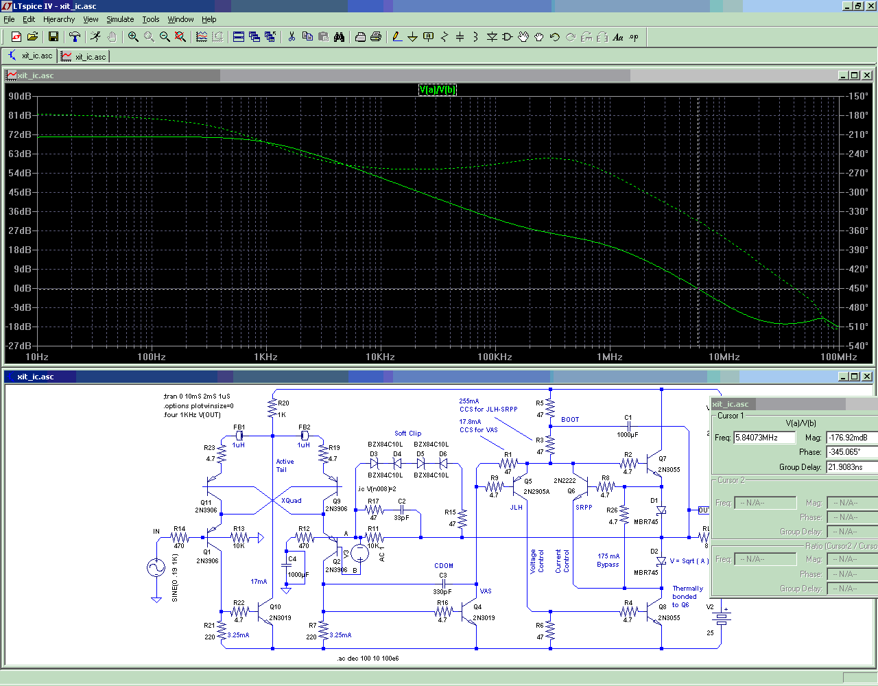

Probably time to make some proper loop stability analysis.
A quick and dirty check shows that the margin, under quiescent and unstressed conditions is ~15°. It is a bit short, to say the least.
When you make a pact with the X-devil, you can't get away without letting go something dear in exchange for the improved linearity and loop gain
I didn't opt for a X-quad in the Circlophone, yet (or because?) I already have a 15~20yrs experience with this topology.
But when you do your homework, it can be very rewarding. And Eva's version is a good tradeoff between performance, complexity and ease of use.

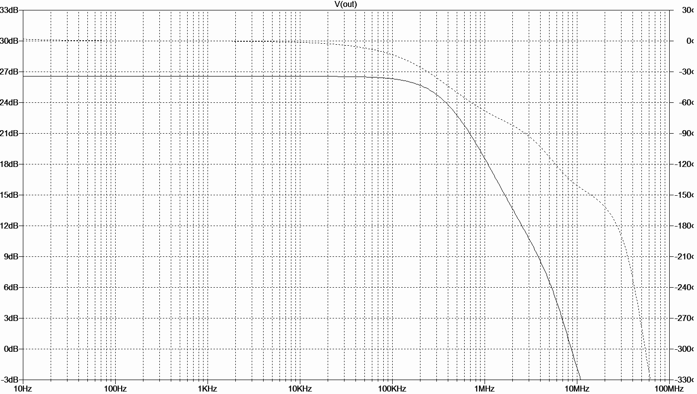

Add 47R in series with CDOM, and eliminate 33pf + 47R in the return path.
What are considered basic victory conditions for this test of stability?
I know 180 deg at 0db (unity gain) would be an obvious fail, but how
much gain we allowed at 120deg? 150?
Closed loop response is not very telling.Add 47R in series with CDOM, and eliminate 33pf + 47R in the return path.
What you really need is an open loop plot.
That said, it doesn't look bad: the amplitude has no peaking, although the slope increase at ~5Mhz could be of concern but combined with the phase response, there is no obvious danger signal.
For a quantitative evaluation, a real Bode plot is necessary.
The way I do it is simplified and unorthodox, but in this case, and if you understand what you are doing, it is more than sufficient for a quick evaluation.
Insert the stimulus at a single point of passage of the signal (ie, if it's cut there nothing can pass elsewhere), and make sure the source has a much lower impedance than the receiver, that way you can dispense with the complete transfer matrix required in a general case.
That's what I did on the pic above, in #234.
But that won't reveal anything, except marginal phase, since the analysis is made under quiescent conditions: oscillations occur only near saturation, and/or at unity gain.
To chase them and iron out any possible instability, you need to explore those conditions/combinations of conditions too.
But obviously, if stability is already marginal under gentle conditions, it will be worse under stress.
Which is why the static stability has to be addressed before anything else is attempted.

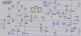

Joined 2009
sorry if this is a dumb question - but there's two very different design in this thread - the circlophone and the kenpeter design - what is the connection - the Kenpeter design looks unrelated to the circlophone ????
What difference? Maybe I'm not seeing it?
Both have secondary feedback in quadrature
to the noble loop. And for the same reasons...
Maybe you are confused cause Elvee's peasant
loop senses current from the outsides. And my
example senses this same current from within.
Otherwise same exact thing, completely different.
Besides, its all the art of rounding corners of the
schematic. Them hard simulated turns, all fun and
games till someone puts out an electron! Running
in the hallway with scissors, xquads or whatever...
Earlier in this thread, my peasant loop returned
this feedback all the way back to the LTP's tail,
exactly same as Elvee's. But I later found that a
much shorter peasant loop functions just as well.
