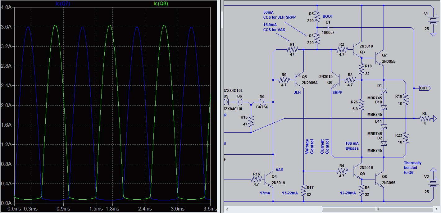

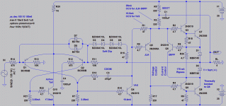

♫♪ My little cheap Circlophone© ♫♪
Direct comparison was becoming more difficult as the design
drifted away in a few details that weren't necessary to differ.
I put drivers back in, as they were needed to handle 4 ohm.
Sorry not the same BD140's. I kinda painted myself into a
corner where only an NPN would work, 2n3019 volunteered.
I also lowered the quiescent, so it crosses more similar to
Elvee's Circlophone. Could use a little more tweaking here,
as I think I still have my reserve current set slightly higher.

Something ugly happening in this output stage now in hard clipping, ???
Quick and dirty fix is to soft clip the VAS, rather than the global loop.
Just disconnect lower end R15, and reconnect to the wire on it's right.
Soft clip is no longer symmetrical, but the hard problem was worse...
Just till I figure some better way to fix it... I may have output drives
biased a little lower than I should.
Reconnect R15 to GNF, the way it was.
Add BAT54 from the top of R15 to VAS.
Cathode end toward VAS.
Still not perfect, that extra diode drop
in the lower Darlington is where it really
goes to hell in a handbasket. I may yet
relocate VAS clamping to that area...
This one looks quite nice and well behaved.
There seems to remain some work to do in the dynamic behavior/large signal department, as the waveform at 20KHz looks visibly distorted, but at this stage, actual physical tests would be needed to ascertain the effect, and refine the design if necessary since the sim may not be quite reliable for this aspect.
Compared to the Circlophone, it is somewhat simpler (3 small signal transistors less) and has slightly lower performances, but the most important differences are elswhere:
-It is built around Ken's pet obsession with schottky's to shape the crossing.
-It has a less deterministic control of the quiescent current and output crossing.
The Circlophone servoes very tightly those parameters in the low power/control circuits, whereas "Converge" works directly at the output level, utilizing the I/V characteristic of the schottky's as a template.
Both approaches certainly have their merits.
In the Circlophone I wanted to completely eliminate the dependency on components, thermal couplings and ambient temperature: you can use any schottky's, any power transistors, any low power transistors, it always work identically, any spread being absorbed by the servo. In fact, you could even include one germanium in the mix, it would still work.
In "Converge", the quiescent current will depend on the type of schottky, their temperature, the saturation current of the sense transistor, etc.
But it will give a special "taste" or colour" to the output stage's transfer.
It would be a good idea to launch a dedicated "Converge" builder's thread to put these ideas to the test.

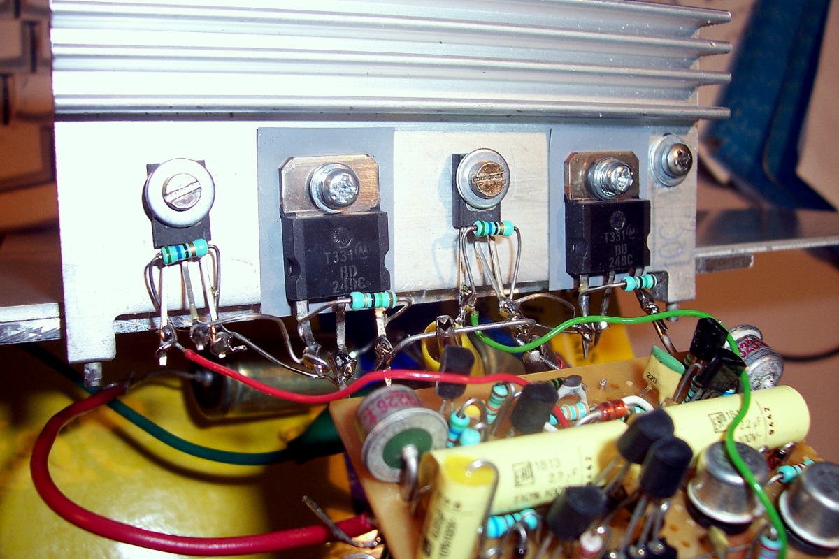

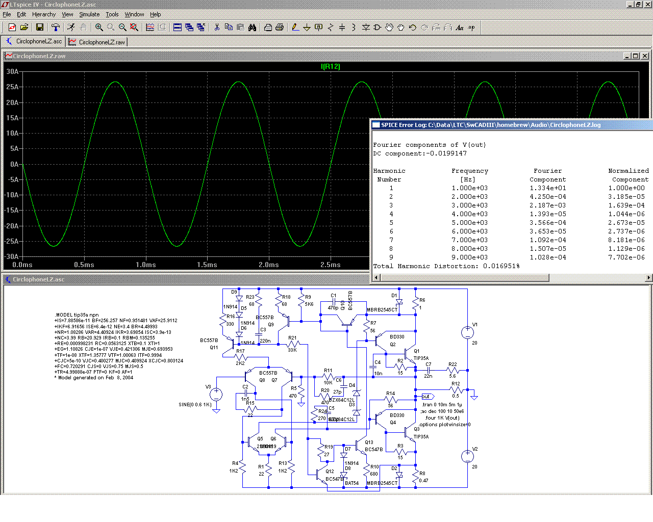

I have built one more variant, this time with BD249's as ouput devices.
The purpose of this version was to test the design under extreme conditions, in this case a very low impedance load.
Some "exotic" speakers have an impedance <1Ω, and few amplifiers are capable of driving such a load directly, without a transformer.
I made a test on a 0.5Ω load.
This pushed the transistors to their limits, at >25A Ic, but the Circlophone remained steady as a rock.
The sim uses TIP35's, as I couldn't find models for the BD249C, but they are very similar.
This illustrates how tolerant, flexible and healthy the design is.

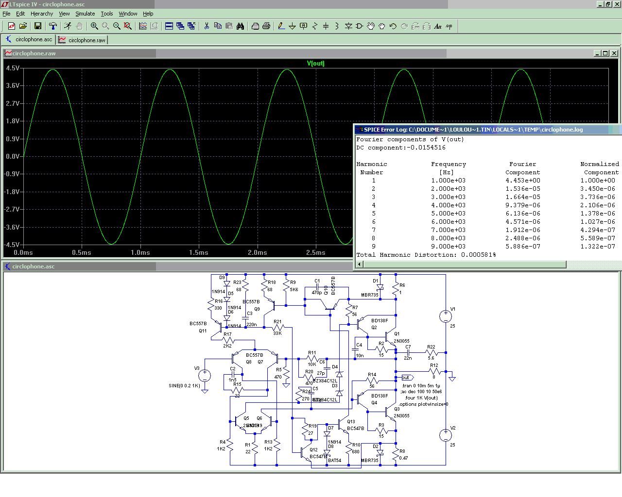

Of course, the THD is increased compared to 4Ω, but it remains quite acceptable, especially taking into account the fact the transistors are really pushed to their limits (and beyond).

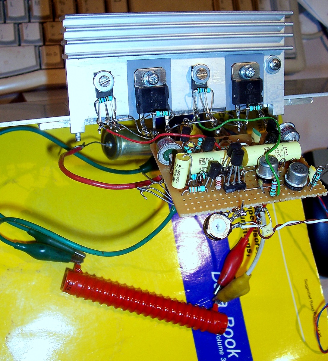

Here are some pics of the above-mentioned version:
The feat is made possible thanks, amongst other things, to the absence of emitter resistors: in a standard topology, with a 0.5Ω load impedance and 0.22Ω emitter resistors, practically half the equivalent of the useful amount of power dissipated in the load is wasted in the resistors.
In the Circlophone, the only obstacles to the current flow are high-current schottky's, and the transistors themselves.
The BD249 are rather cheap and crappy, and with better devices, loads even lower could be handled with a better efficiency.
But the Circlophone is not simply about brute force.
In a completely different domain, at a gentle power level and on more "normal" loads, the performance is on the par with a good, pure class A amp:

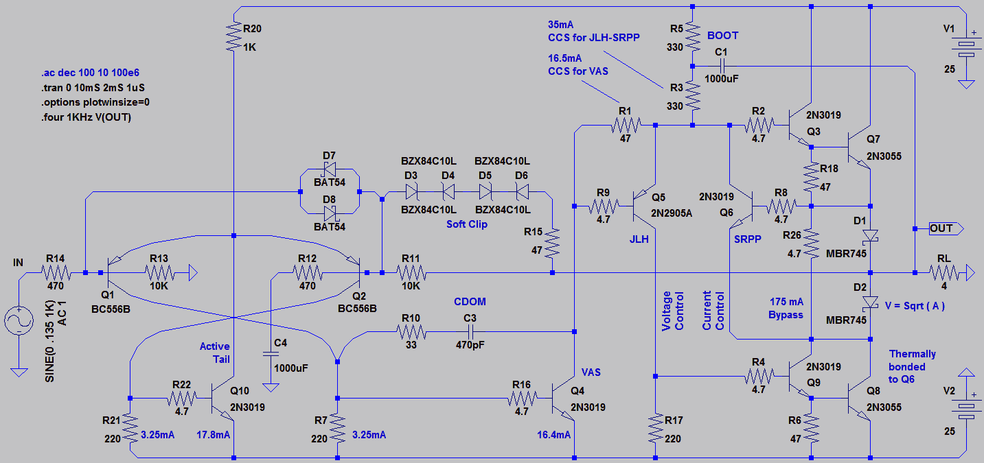

I can do deterministic too.
Abuse a threshold narrow enough, Schottkys must cross class C.
Then set your deterministic class A crossing with two resistors.
Plus always-on bypass current...
Near as I can tell, its bias logic exactly the same as circlophone.
Though can't quite set my bias as low, on account of bootstrap.
Input here was 0.7 so I could compare apples to Circlopone M's..

Sorry if I offended you, that was certainly not my intention.
Since you chose this thread to display your ideas, I gave my opinion, and made some comparisons.
I made comparisons, but I don't think you interpreted them correctly.
I just meant that you solve the problem using an "open loop" approach, where my solution is a more "closed loop" one, where things are more tightly under control.
This is not a value judgement, more the observation of a difference.
Both ways have advantages of their own, and it is impossible to decide in absolute terms which one is the best, if there is such a thing.

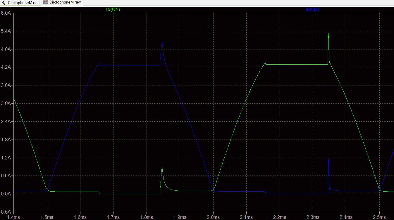

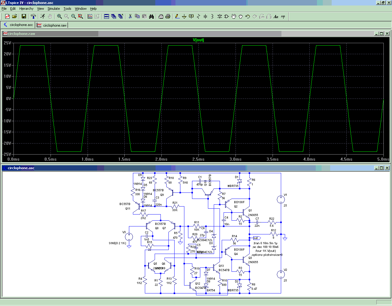

I haven't included "clean" or "soft" clippers: I just made sure the clipping behavior, as seen from the load remains clean, but without attempting to soften or improve it.
As you have pointed out, the slow transistors struggle to get out of saturation, and they are "nudged" by their counterpart to do so, but the process remains completely transparent to the load: the clipping is clean and the recovery is clean too.
See the pic of the output voltage during clipping (the actual waveform is identical to the sim).
There are spikes of current in the OP stage, but they remain moderate, and perfectly manageable by the OP transistors, and this has been abundantly tested in reality.
I didn't want to control further the clipping behavior, that's my design choice, you made another one, you are free to do so, OK why not, but I'm also free to do mine: I consider clipping should be exceptional, and that a clean behavior is sufficient, period.
If I said the dynamic behavior of your circuit could be improved, I didn't mean the clipping: I meant slew rate and power bandwidth.
As I said, clipping is a secondary consideration for me, but I think a decent behavior at 20KHz does have some importance.

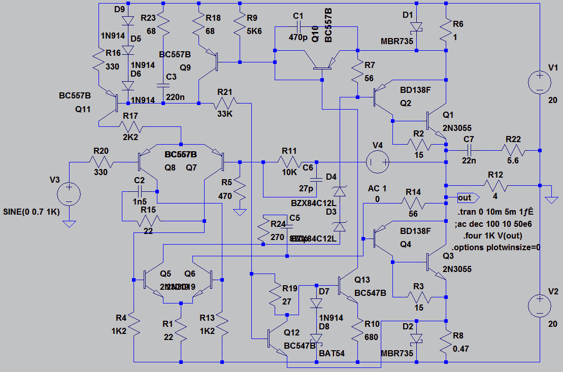

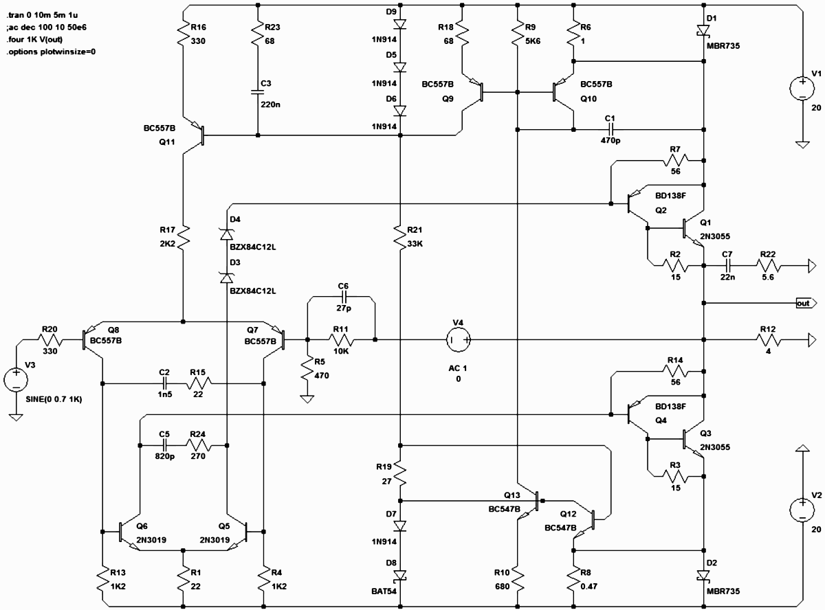

Here's a sample redraw, based upon Circlophone M.
Models are all still there, just above the screenshot.
During the redraw, I have come to question R19's
purpose? Appears only to bias Q12 into saturation.
Its exactly like this in the original, so I have to ask.
Was this an oops? Intended as a base stopper???
I haven't commented any part of the circuit yet.
  • CirclophoneM-redraw.asc.txt

Looking back, the original Circlophone drawing wasn't bad.
It grew slightly less organized as it evolved...
The original drawing is purely graphic, and didn't evolve. The functional versions are messier.
You did a nice cleaning job, thanks for the effort.
Anyway, here is the asc of the graphic version, if someone wants to play with it.
