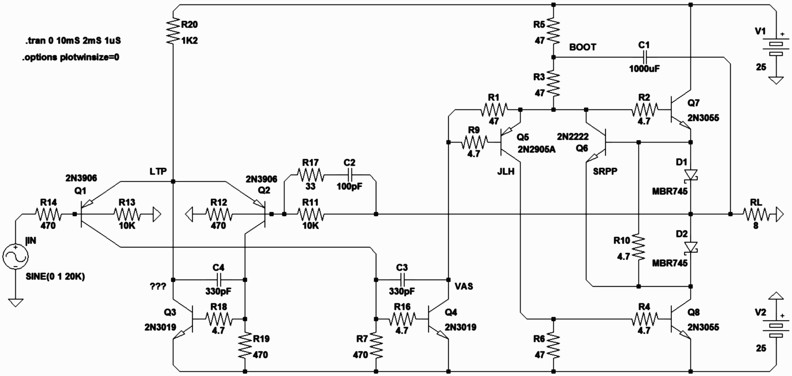

Single ended with the offset correction of an LTP:
Q2 is in a CFP, and operates at constant current.
Q1 sees low impedance tail strongly following Q2.
Q1 gets full amplification rather than usual half...
Q1 and Q2 balance at same current and voltage.
Go figure...

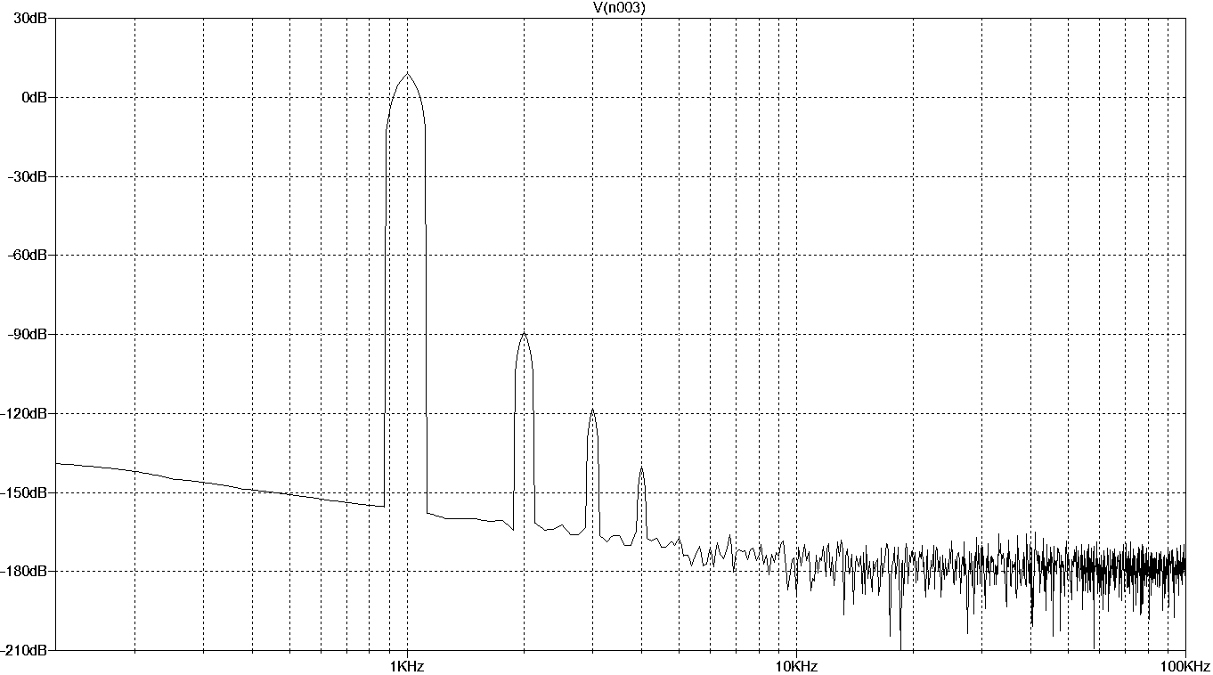

FFT shown at 1W 1KHz
Go figure...
You see, I was screwin' with dis here one armed LTP.
Frustrated that currents did not automagically balance.
Something should be able to modulate the tail to fix that.
Now Q2 is held constant current by R19 and CFP loop.
Q1 is held similar average current by R7 and Noble loop.
Single ended result was complete unexpected accident.
Unexpected too was doubling of Q1's gain, probably why
the closed loop distortion went down so much as it did..
Was at least 10db worse H2 H3 before this new circle
began chasing its own tail.
C4 might not be needed. I just stuck it there cause it
looked "symmetrical". No thought process involved.

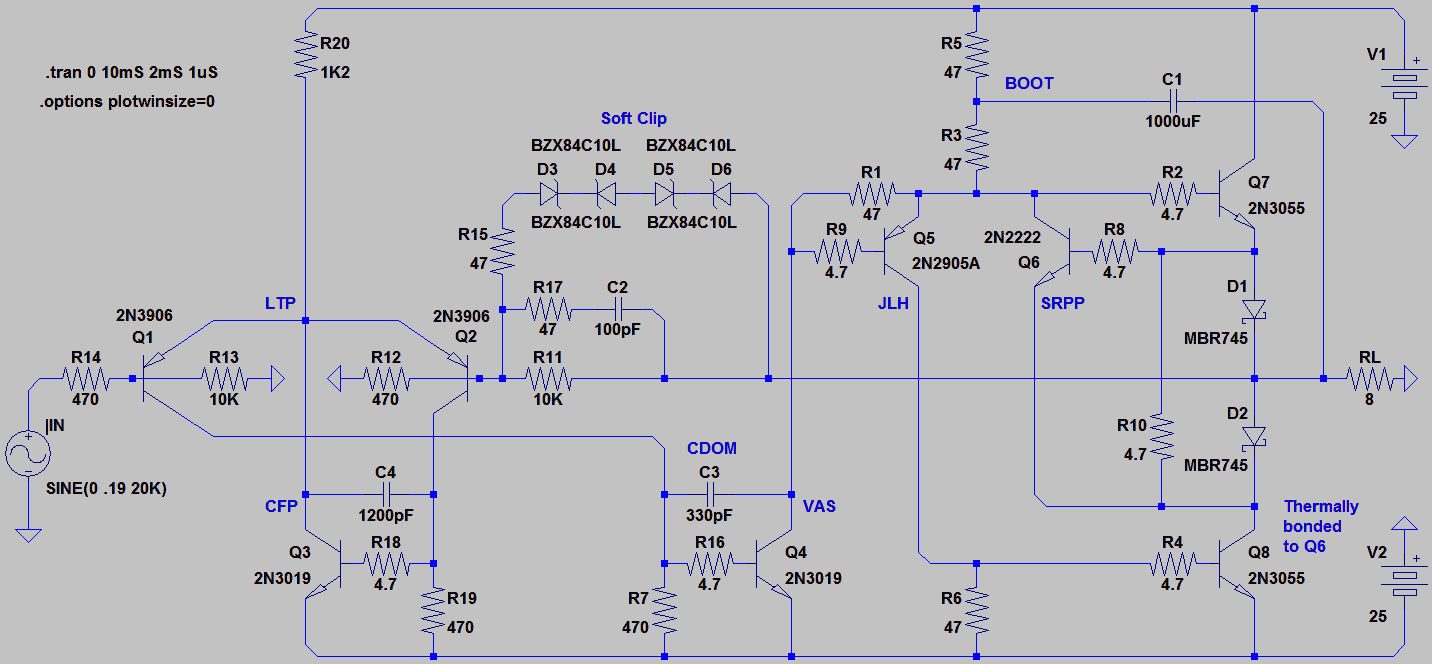

Kenpeter - I like it, simple and effective. At least in sims. Unfortunately, I don't understand how it works
Whoa, thats weeeerd. C4 might be essential!
ACurrents in Q2 are much smaller than Q1 as expected, but phase shifted.
Wasn't planning, didn't want, and who invited a phase shift to this party?
I think this might be caused by compensation cap C3 in the Noble loop.
C4 definitely works to re-align push and pull phases in the LTP.
Aligns best at some value between 1200pf-1500pf, much higher than C3!?!
But why should this value be any different than C3? I don't get it...
OK, I get it now... C3 sees VAS swing (Miller), C4 sees far less movement.

Messin to find ideal comp and junk... This 1W after reducing C2 to 33pF.
I'm guessin soft clip Zeners in parallel must have added a few picos?
Harmonic Frequency Fourier Normalized Phase Normalized
Number [Hz] Component Component [degree] Phase [deg]
1 1.000e+03 4.040e+00 1.000e+00 -0.26° 0.00°
2 2.000e+03 4.856e-05 1.202e-05 -104.81° -104.55°
3 3.000e+03 9.788e-06 2.423e-06 2.27° 2.53°
4 4.000e+03 1.788e-07 4.425e-08 149.89° 150.15°
5 5.000e+03 6.531e-06 1.616e-06 179.04° 179.30°
6 6.000e+03 1.198e-07 2.965e-08 161.53° 161.79°
7 7.000e+03 4.024e-06 9.959e-07 -1.21° -0.96°
8 8.000e+03 7.927e-08 1.962e-08 -161.45° -161.19°
9 9.000e+03 2.339e-06 5.790e-07 178.96° 179.22°
Total Harmonic Distortion: 0.001242%
And this at +/-19.5V peaks, just under threshold of soft clipping:
1 1.000e+03 1.914e+01 1.000e+00 -0.22° 0.00°
2 2.000e+03 1.367e-03 7.143e-05 -101.98° -101.75°
3 3.000e+03 8.989e-04 4.697e-05 3.44° 3.66°
4 4.000e+03 7.046e-05 3.682e-06 85.50° 85.72°
5 5.000e+03 6.071e-04 3.172e-05 178.42° 178.64°
6 6.000e+03 6.539e-06 3.417e-07 56.44° 56.66°
7 7.000e+03 4.896e-04 2.558e-05 -2.90° -2.68°
8 8.000e+03 3.884e-06 2.030e-07 -108.80° -108.58°
9 9.000e+03 3.726e-04 1.947e-05 176.43° 176.65°
Total Harmonic Distortion: 0.009676%
And C4 is 1000pf right now too. Allowin' just a little shift seemed to
reduce simulated distortion. Again, its a mystery to me why a phase
shift across the LTP would do anything beneficial???

.Single ended with the offset correction of an LTP:

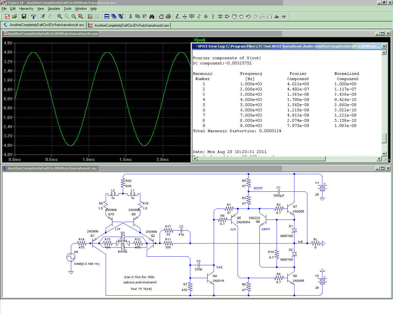

Clever scheme.
I find that C4 can be removed completely.
If you want to go even further in that direction (linearizing the LTP), another method is to use a crossquad.
The beast is difficult to tame, but it's worth the trouble:
THD @1W 1KHz can easily be pushed deep below the ppm threshold
Other than thermal backbond and fuses, can't figure a benign
way to soft limit current into a shorted load.
That wouldn't be very difficult by inserting current-sensing resistors in the supplies of the output stage, and it would interfere very little with the normal functionning of the amp.

The servoing action controls the quiescent current, without needing such messy things as Vbe multpliers or adjustable resistors, but it also goes further, and forces the output stage to remain in class A under large signal conditions.
Which demonstrates the concept does indeed work as advertised: ask odysseybmxin the PCB layout posted before they weren't even close.
The circuit is completely under servo control, thanks to the current-sensing resistors, R8 and R11 and their associated circuitry.
i understand now, i missed what to look for. the 'servo' is quite big (relative to the rest) 😉
thank you. i will build this amp in the following weeks. i've got a +/-32V SMPS from a Linn integrated system that has been lying around for months waiting for something interesting; and that has just been found 🙂
i've read the whole topic but i feel like i still missing something.
what about the thermal effects and biasing? normally, the biasing transistor and/or diodes or whatever should be on the same heatsink as the output BJT's. in the PCB layout posted before they weren't even close.
maybe i don't understand the circuit correctly (i'm fine with the other claims, there are more simple amplifiers like the ESP P3a that don't need matching or adjustment to work forever), but how does this stay thermally stable?
In my case: the SRPP biasing transistor should be on same sink as close
to Q8 as possible. Q8 gets a little hotter than its mate because it gets
no help from base to emitter current leak. Schottky diode stack should
mount to a separate sink. When SRPP transistor gets heated, but diode
voltage drops are cooler ambient, bias is shunted away from JLH splitter.
Total bias available for sharing by both output transistors is modulated.
This is where it behaves like the circlophone, yet completely different.
I would bolt collector of hottest transistor Q8 directly to live sink, with
no electrical insulating pad, only grease. Q6 and Q7 would require pads.
If you prefer to drill a TO-18 hole and stuff Q6 into it, then I guess Q8
would need a pad too. Only one transistor can be in direct contact....
unbeliavle how important are inductors and 1.5 ohm resistors😕
- ♫♪ My little cheap Circlophone© ♫♪
